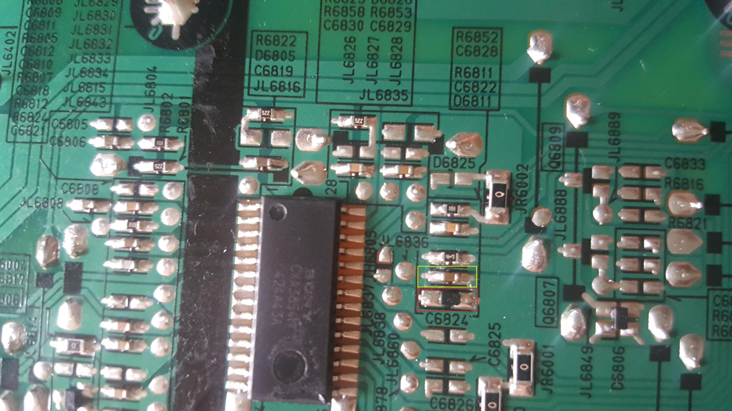

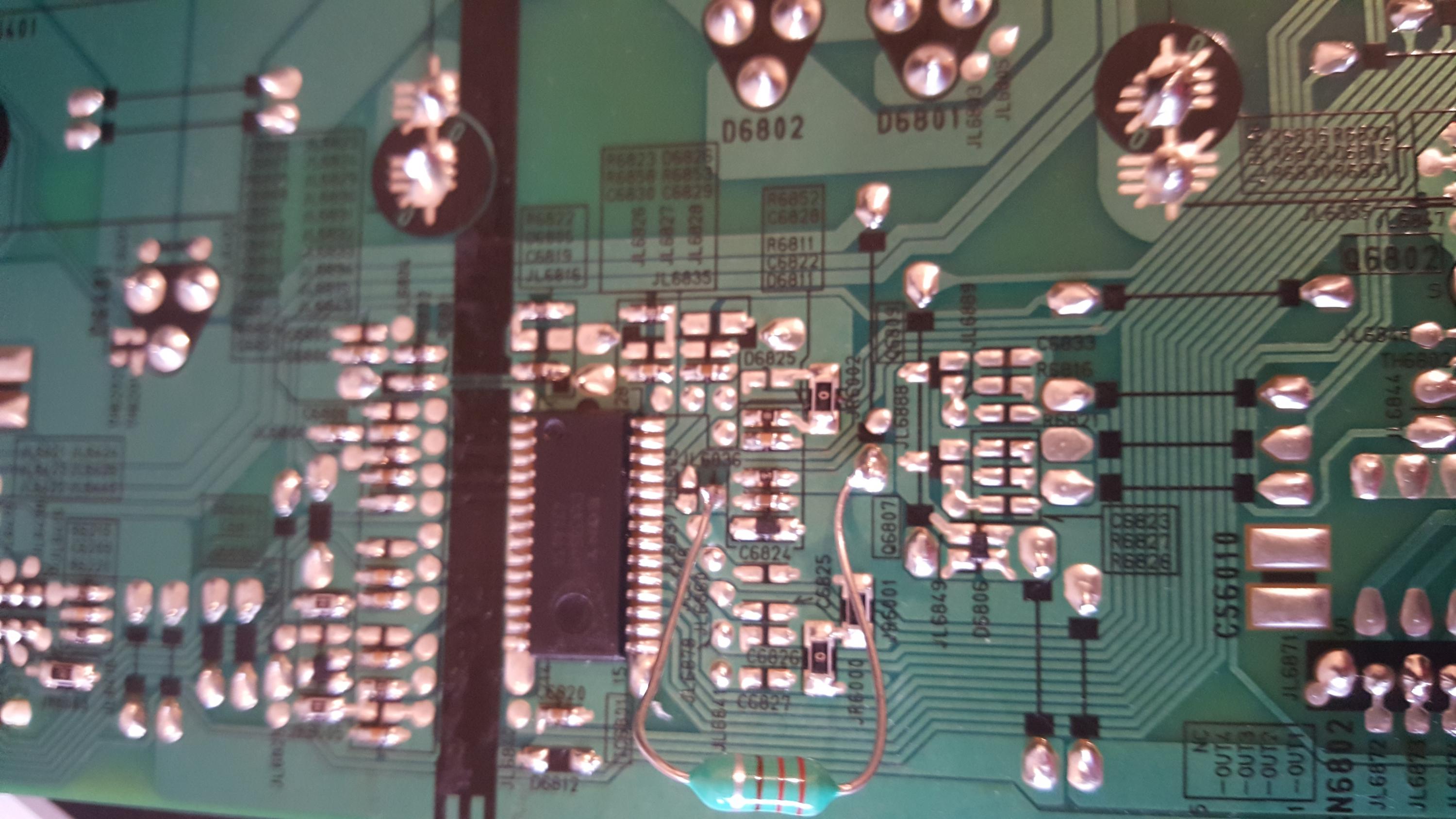

Re: KDL-60W600B won't open just Red Blinks 6 times
At this point you just need to find the way to put in that resistor to test, if the board comes alive then I hate to buy new board due to faulty resistor, ZENER, or the IC.
There are two big pads that you can solder the resistor to for testing.
