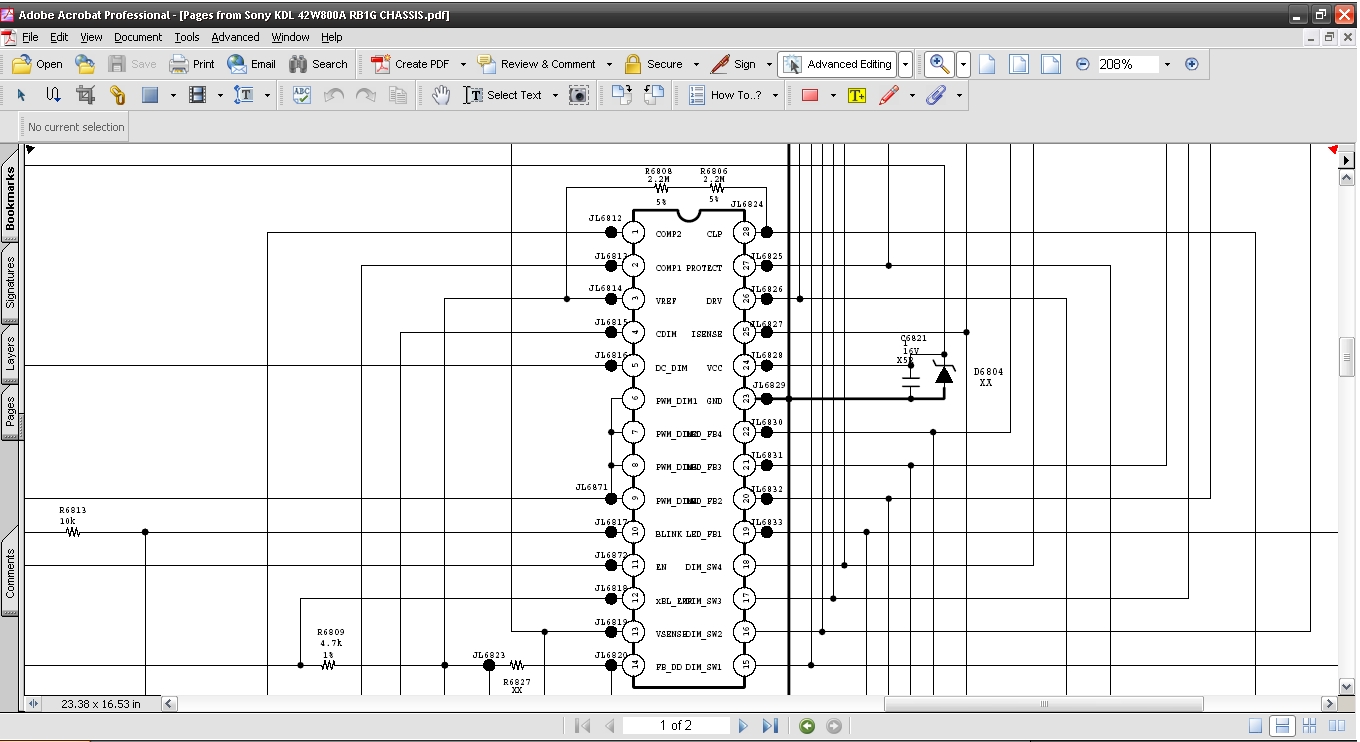

      #82
      Re: KDL-60W600B won't open just Red Blinks 6 times
      OK, I search the web and found SONY TV (KDL-xxW800 series RB1G chassis) uses power supply board that has CXA3854 IC on it, so we can at least check to see if it is getting the VCC of 12V at pin 24 or not when the TV is turned on.
      We can also find out if the BL-ON gets all the way to the EN pin 11 to turn on the IC or not.

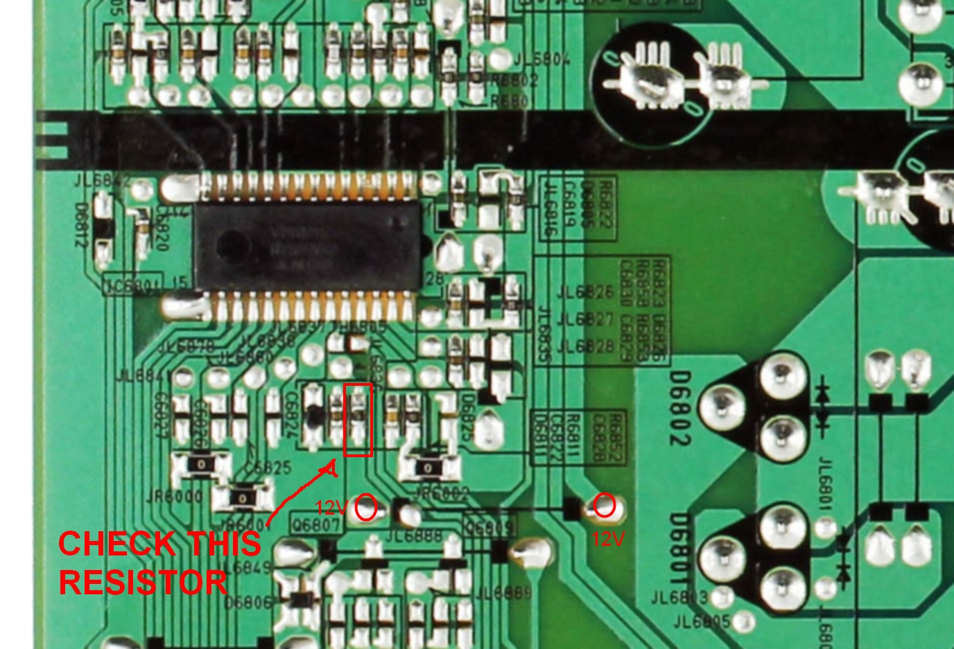

                    #89

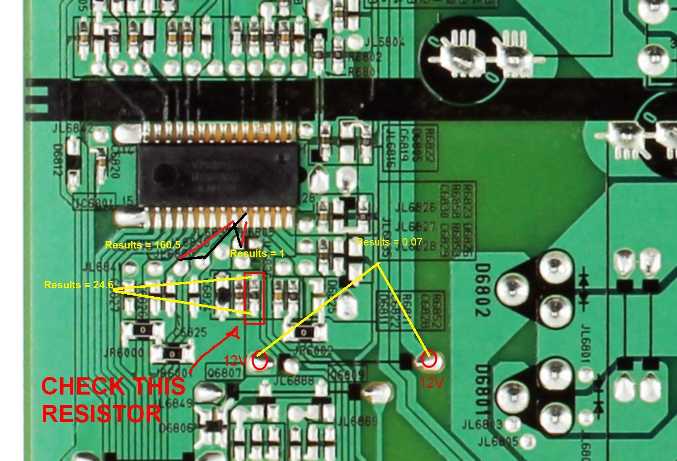

                    Please check the marked resistor in the picture, it should show <10 Ohms on your meter (meter set to 20 or 200 Ohms scale and put probes on each end of the resistor).

                      #90
                      will check resistor & post results here, thanks alot budm, & please accept my apology since i can't check & post results now coz i am on work, will back home & do check,
                      Thanks.

                        #91
                        Ok i checked & below are results,
                        Meter set to 200 Ohms range, Red probe on VCC PIN 24, Black probe on GND PIN 23
                        Results = 1
                        Meter set to 200 Ohms range, Black probe on VCC PIN 24, Red probe on GND PIN 23
                        Results = 160.5
                        Marked resistor in the picture results below
                        Meter set to 200 Ohms range = 24.6
                        Other two points marked in the picture results below
                        Meter set to 200 Ohms range = reading start from 5.2 & slowly slowly it goes down & it stop on 0.07
                        please check in picture yellow color reading,
                        Thanks.
                          #92
                          Results = 1
                          Results = 160.5
                          Thanks.
                          I did not expect that resistor to have 24.6 Ohms, I expect around 4.7 Ohms
                          OK, now we need to test the Voltage on each end of that resistor that shows 24.6 Ohm with ref to GND. You will leave the meter probes in place and then turn the TV on to see how much Voltage we have on each end of that resistor when the TV is first turned on.

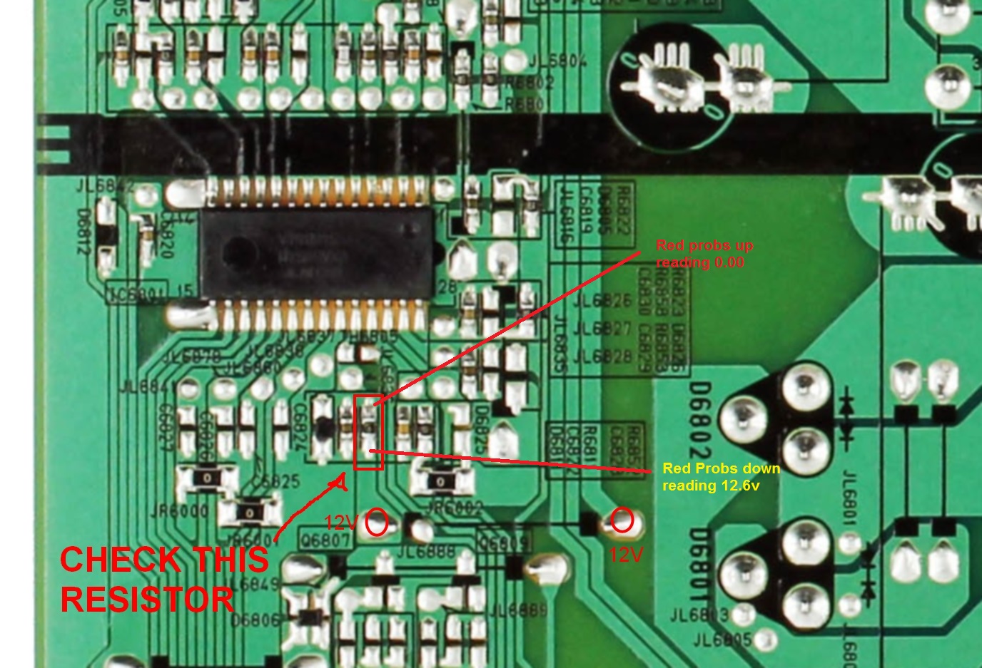

                            #93
                            Hi budm, thanks for furthur help,
                            below are results,
                            Meter set to 20 dc range, Red probe on up
                            Results = 0.0v & after turn on tv no changes & same 0.00v
                            Meter set to 20 dc range, Red probe on down
                            Results = 12.6 v & after turn on tv it drop to 0.00v
                            below attached picture for refrence
                            Thanks.
                              #94
                              below are results,
                              Thanks.
                              OK, I expect to 12V on the top end of that resistor since we did have 12V for seconds before the power supply goes into shutdown. So we have problem in that section, it can be that IC, or the two other component that are also connected to that pin 24 of the IC.
                              Can read any number printed on top of that resistor?

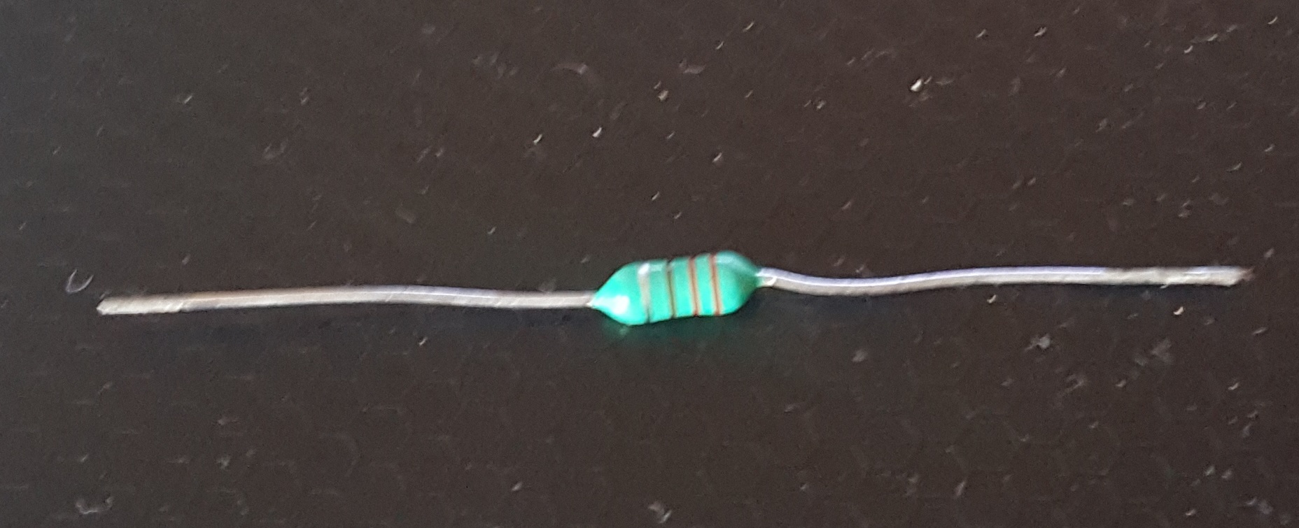

                                #95
                                yes on top of that resistor it can read 4-7 actualy 4 than arrow face on 4 than 7
                                below is picture can be take as refrence,
                                  #96
                                  OK, it is 4.7 Ohms, the same value as used the schematic that I found which use the same IC for the backlights control.
                                  So do you have 4.7 Ohms 1/4W or less that you can solder in place of that resistor?
                                  We are getting close!

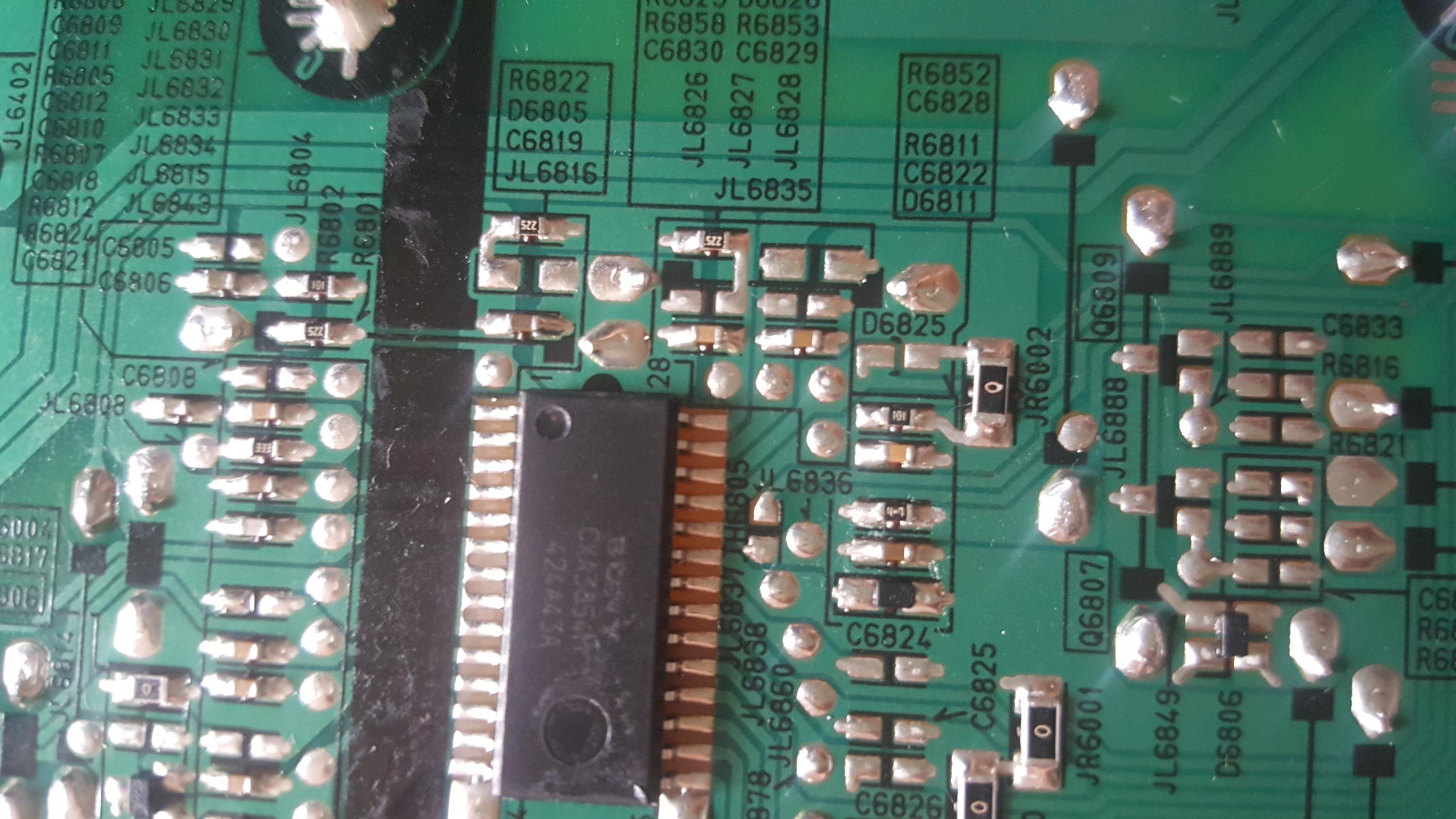

                                    #97
                                    yes i have 4.8 Ohms 1/2W, below is picture for refrence, so i can use it?
                                      #98
                                      For testing, but what you need to do is to leave one DCV meter probe to gnd and another probe on the end of the resistor that is connected to VCC pin 24, the apply power to the TV and turn the TV on and see if you will get the 12V or not. Hopefully that the IC is not bad which may have caused that resistor to go up in value.
                                      The 4.7 Ohms resistor R6811 is used as a protection in case the IC, the capacitor C6822, ZENER DIODE D6811 at the VCC pin shorts out.
                                      Per schematic, the resistor is rated at 1/10W (0.10W).

                                          #100
                                          Hi budm,
                                          Getting keep fail to soldering below resistor with soldering iron,
                                          https://www.badcaps.net/forum/attach...9&d=1502503446
                                          since place of the 4.7 Ohms resistor R6811 is very small & line of above picture resistor is thick, so no success,
                                          you think it’s worth to buy another PSU? coz i need to buy PSU from web so once bought, no return so you are peety sure that issue is in tv PSU right? It’s not LCD or any other board, Since we are trying from past 3 weeks, & now I am feeling your huge work & help finally find out we have issue with PSU,
                                          your advice will be highly appreciated, waiting for your reply,
