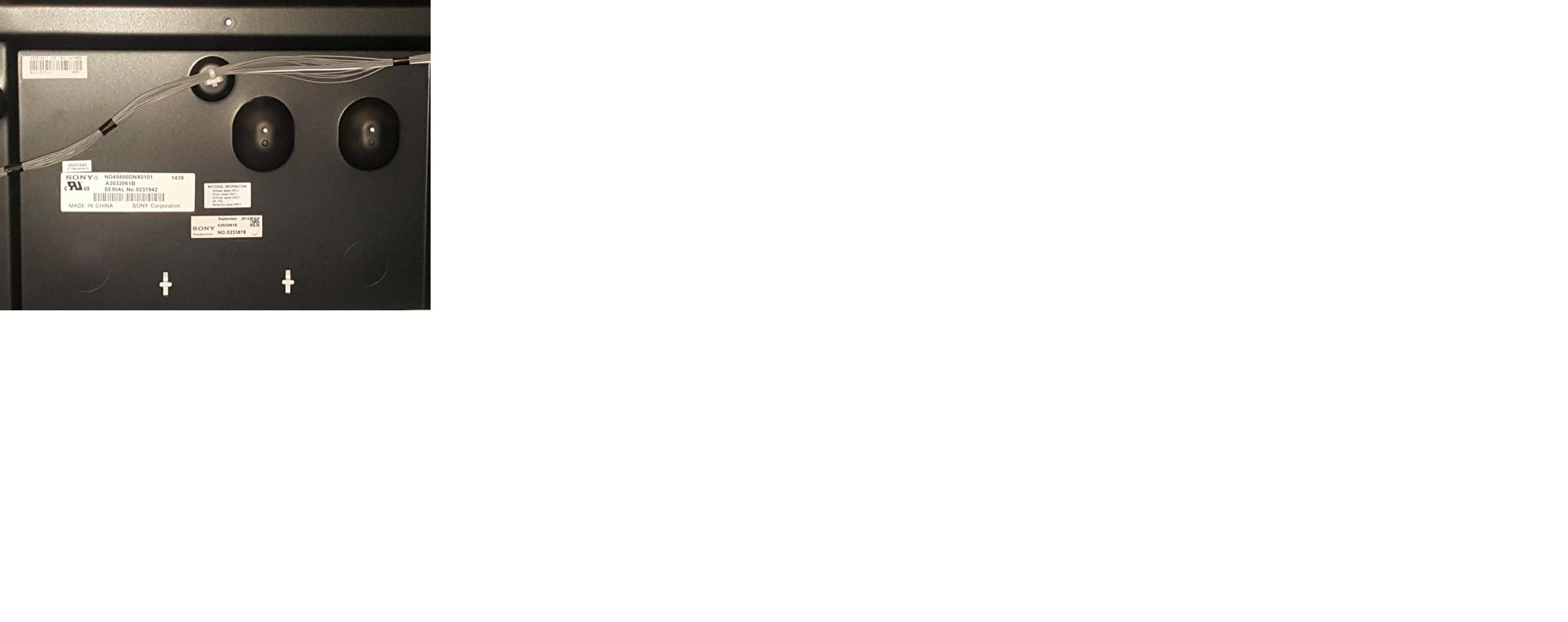

        BTW, please also look at the LCD panel for the model number of the LCD panel then we may be able to find the specification sheets that may tell us how many LEDs are used in the panel and what the Voltage requirement is for the LED's.
        • Ali101
          • Jul 2017
          • 152
          • Taiwan

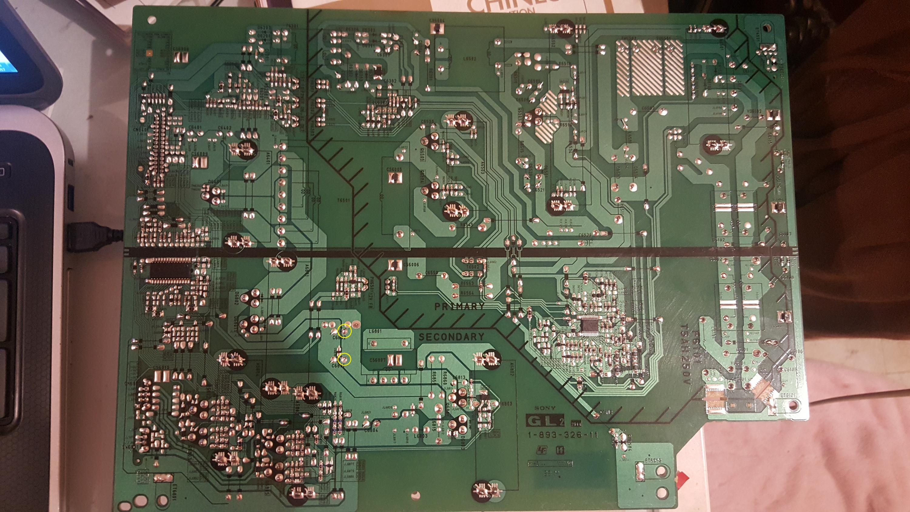

          #44
          Re: KDL-60W600B won't open just Red Blinks 6 times
          sure budm bro, BTW model number of the LCD is on back side right? if so attached file may help to find,
          Thanks.

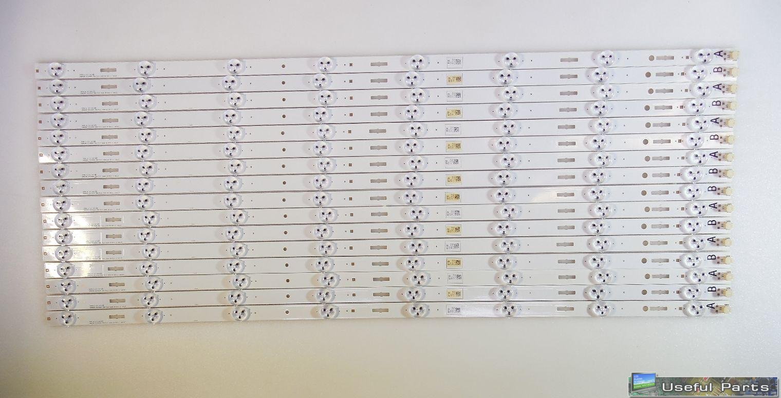

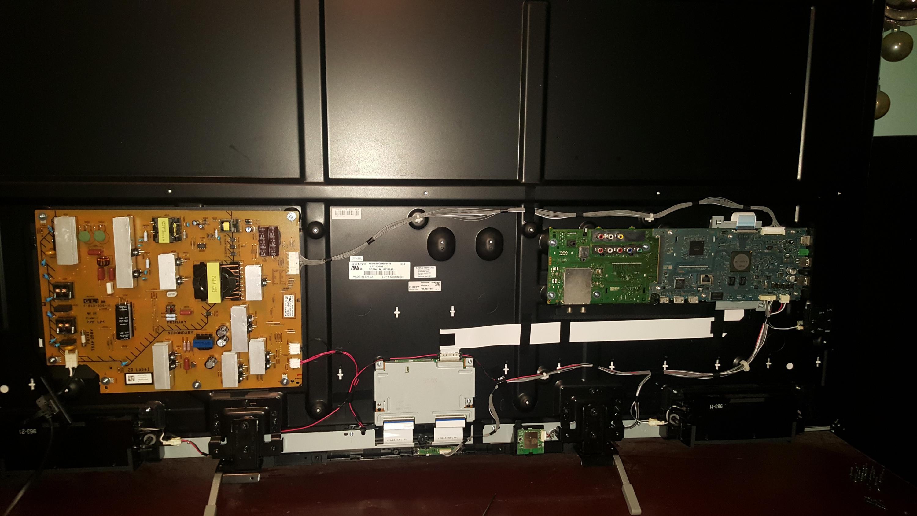

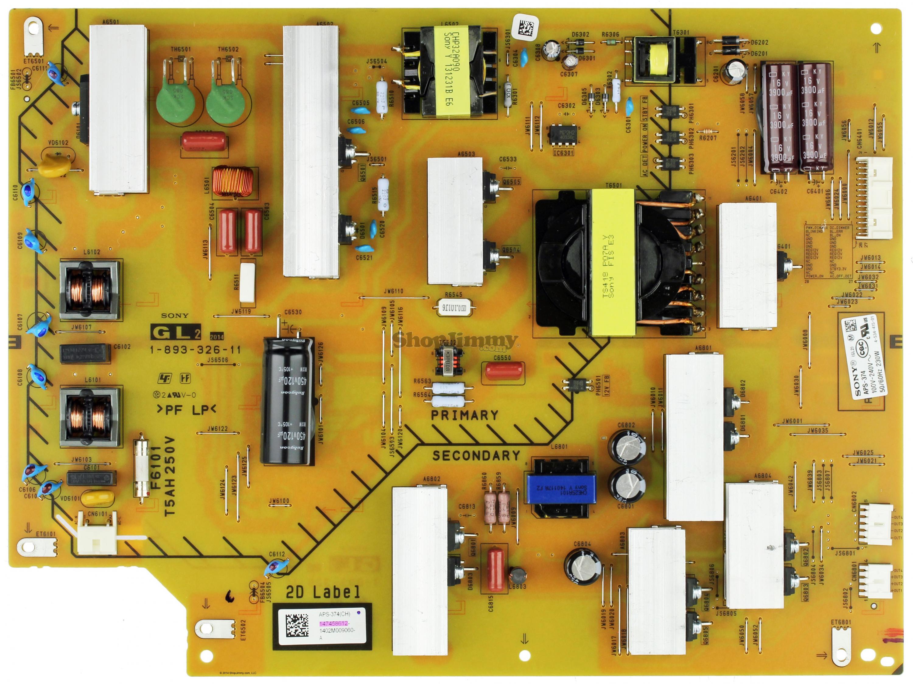

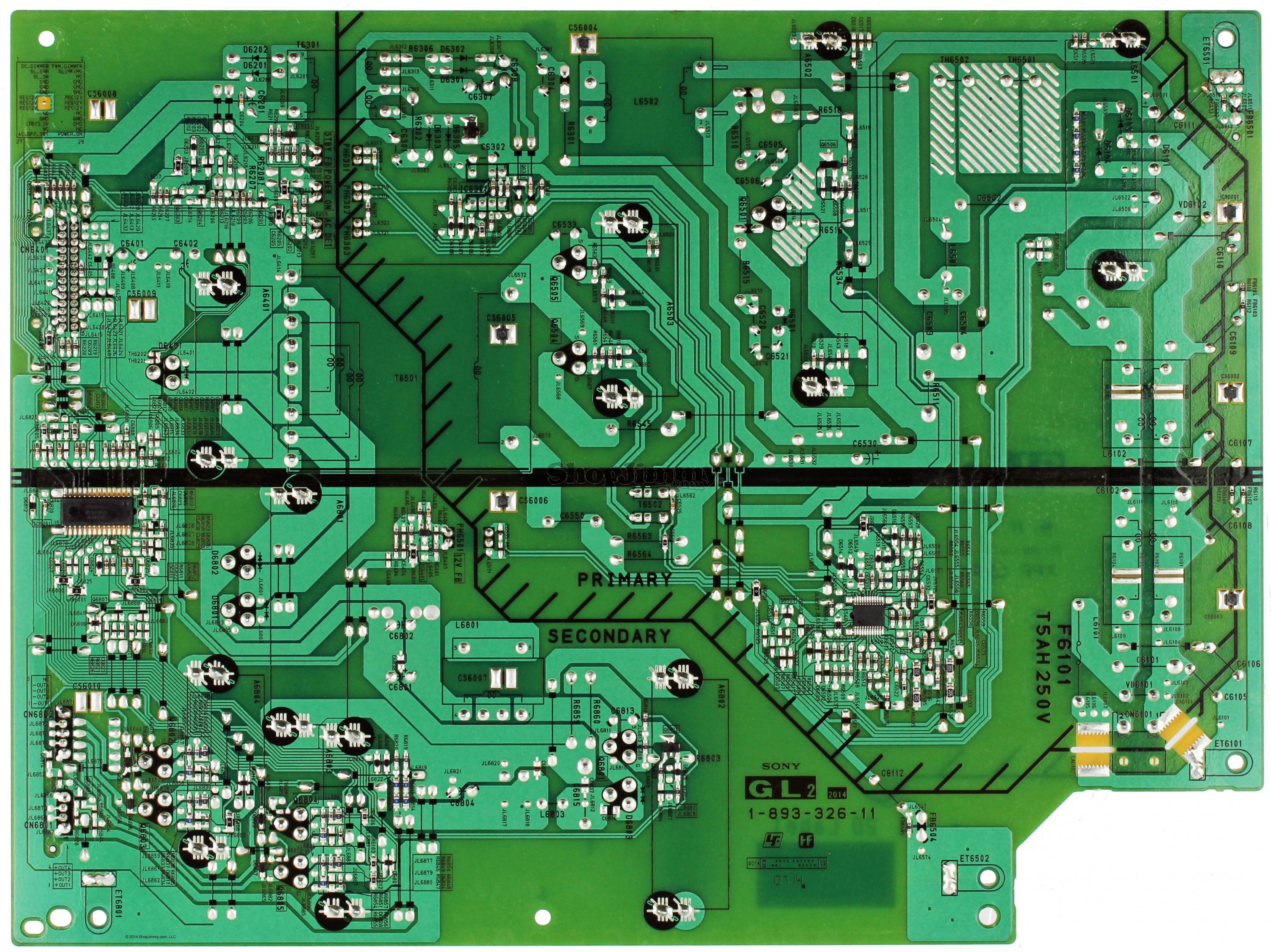

            LCD panel model "ND4S600DNX0101".
            No luck finding the spec. sheet.
            LED strips (16) 2014SONY 60A PLU1 3228 08 REV1.1
            http://www.usefulparts.com/tv-parts/...ny-kdl-60w630b
            http://www.ebay.com/itm/Sony-KDL-60W...item4b14aa7854
            So it has 4 strings of LEDs, each string has 4 LEDs strips connected in series, each strip has 8 LEDs, so the total LEDs for one string is 8 LEDs x 4 strips = 32 LEDs, so if each LED has Vf of 3V that means the total Vf for each string is 32 LEDs x 3V = 96V, so the output of the boost converter should be at least 96V + Vdrops for the PWM Controlled MOSFET (there are four of them: Q6802~6805) which I estimate to be around 15~20V range so the output of the booster should be over 100V.
            Power supply/led DRIVER BOARD APS-374 (CH).Sony 1-474-586-12 GL2 PS
            Pictures provided by shojimmy.
            So if the DCV reading on the capacitor C6801 shows 90V then we know that Voltage booster is not working.
            You can check the Voltage of the CAP C6801 on the top side of the board by putting the Black probe of the meter on the middle leg of D6801, and the red probe on the middle leg of D6082.

              #46
              OMG, budm, this is simply genesis work,
              since my board is little different so i check it to put red probe on below picture yellow mark & reading it give me is 89.5 V or sometime 88V on both (CAP C6801 & CAP C6802) and once TV turn on it goes down & stay on 25V to 30V, i set my Multi meter on 200 DC range,
              so does it means i need to replace these both (CAP C6801 & CAP C6802) or i should buy other PSU?
              your all help is highly appreciated, since i almost gave up from my tv but you give it a big Hope, God bless you bro,
              Thanks.
                #47
                Thanks.
                OK, you are getting about 90V on those filter caps, so 90V is the feeding Voltage to the booster circuit but its is not working, for it to work it will need BL-ON and Dimming control signals from the main board. That is what you should check next, we are getting close to find out what is wrong with the TV, it is difficult without having the TV and the boards in front of me to troubleshoot.
                BTW, check the REG 12V pin on the connector CN6401 to see if it goes up to 12V and then drops down or not.
