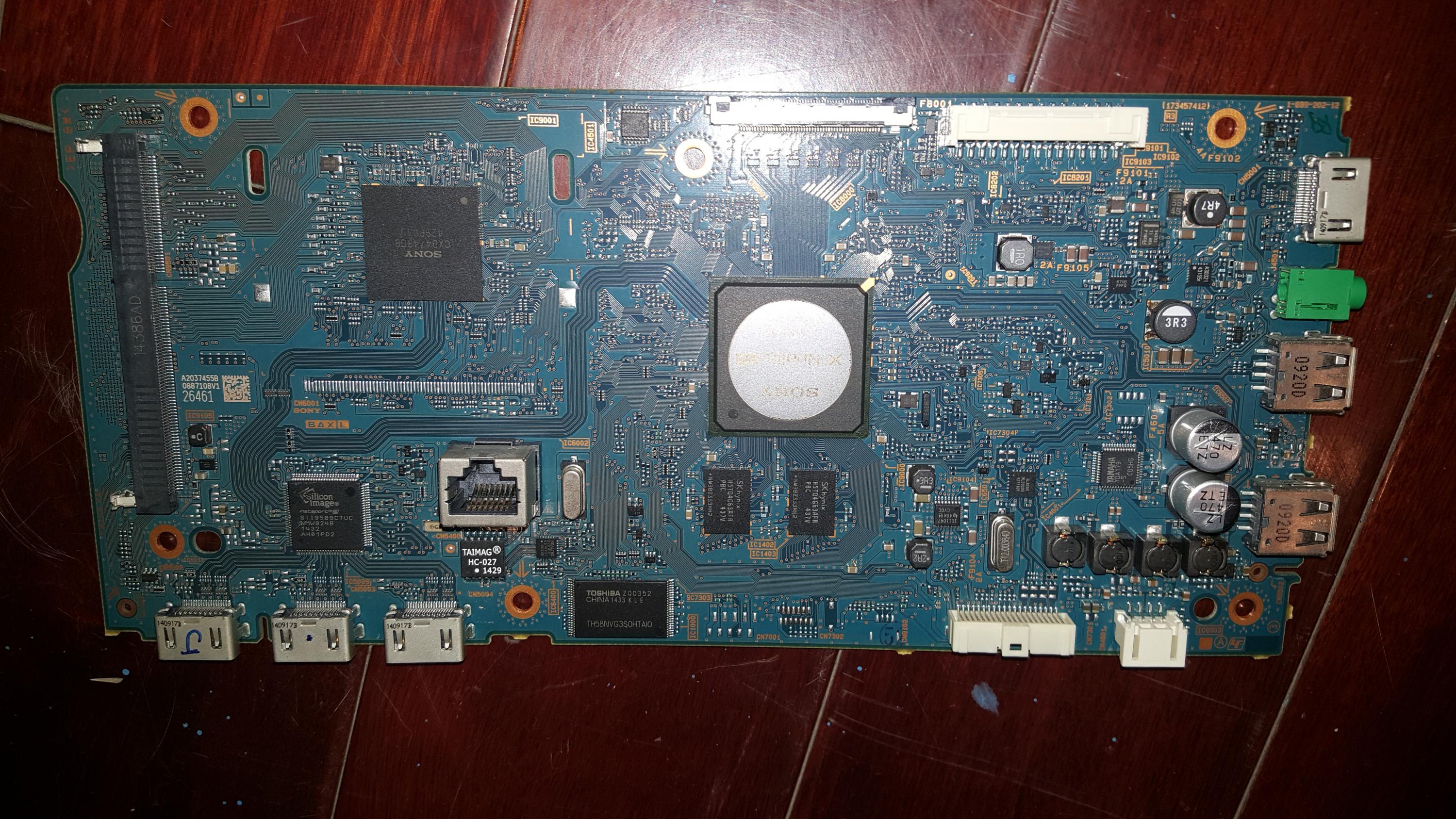

          Re: KDL-60W600B won't open just Red Blinks 6 times
          Dear budm, i had check PSU & BAXL with below results,
          Multi Meter Range set on 20 DC
          CN6401: on PSU
          Pin 1 = 3.5 V after turn on tv it goes 0.00 V
          Pin 2 to 5 = 0.00 V
          Pin 6 to 8 = 12.7 V after turn on tv it goes 0.00 V
          Pin 9 to 14 = 0.00 V
          as per chassis GND it says Check JL9106* at (BACKLIGHT_MON) of CN9101 on the BAXL Board
          so below is CN9101 resluts
          Pin 1 = 3.54 V after turn on tv 3.54 V is still there
          Pin 2 to 5 = 0.00
          Pin 6 = 3.56 after turn on tv it goes 0.00 V
          Pin 9 to 11 = 12.71 after turn on tv it goes 0.00 V
          Pin 12 to 15 = 0.00 V
          any advise will be highly appreciated,
          Thanks.

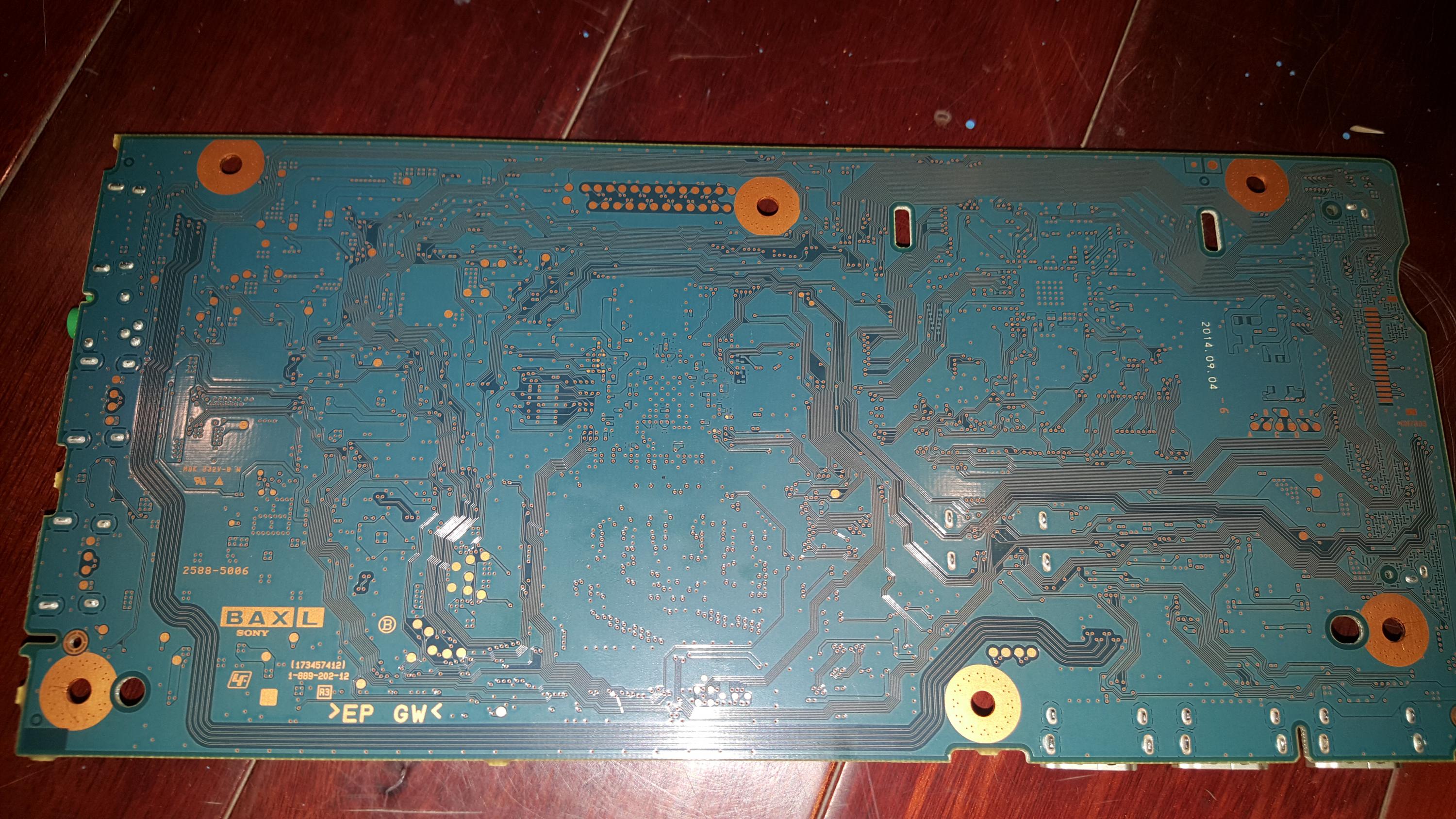

            As per chassis GND in BAXL i have no idea where is JL9106* & i need to check how much out put with what range of Multi meter set,

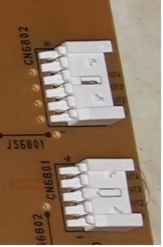

                                    Can you check the DCV between the two legs of the filter cap C6801? That will be the Voltage that is fed to the Voltage Boost converter for driving the LED's strings.
                                    Also need the Voltage rating of the cap C6801 and C6804, it is printed on the body of the caps.
                                      Originally posted by budm
                                      You can get LED tester, something similar to this:
                                      http://www.ebay.com/itm/0-300V-SID-G...item1c740cd5ab
                                      Thanks for help budm, appreciated your kind assistance,
                                      so i have to open LCD panel to check whether some led got bad? from all above tests/board readings seems like my LED panel have issue right?
                                      Not sure if filter cap is attached image, if so than below is reading i take while tv power on, but if filter cap is different than below image than your help will be appreciated to find & test further more,
                                      Thanks.
                                      CN6801:
                                      Pin 1=90 V, after turn tv on it drop slowly 89...88..87......3.2.1
                                      Pin 2=90 V, after turn tv on it drop slowly 89...88..87......3.2.1
                                      Pin 3=90 V, after turn tv on it drop slowly 89...88..87......3.2.1
                                      Pin 4=90 V, after turn tv on it drop slowly 89...88..87......3.2.1
                                      CN6802:
                                      Pin 1=13.5 V, after turn tv on it drop slowly 12...11..10......3.2.1
                                      Pin 2=13.7 V, after turn tv on it drop slowly 12...11..10......3.2.1
                                      Pin 3=13.6 V, after turn tv on it drop slowly 12...11..10......3.2.1
                                      Pin 4=13.6 V, after turn tv on it drop slowly 12...11..10......3.2.1
                                      Pin 5=0.00 V,

                                        We already know what Voltage you have on the LED connectors, what I need is the dcv on the cap I listed above so we can find out if the boost converter is working or not. Please re-read my request again and look for those caps on that power supply board.
                                        https://www.badcaps.net/forum/attach...1&d=1501157949
