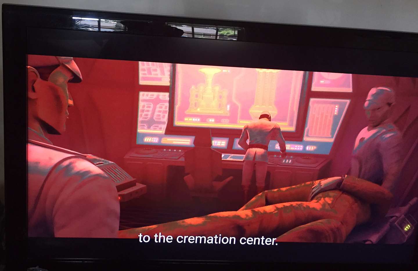

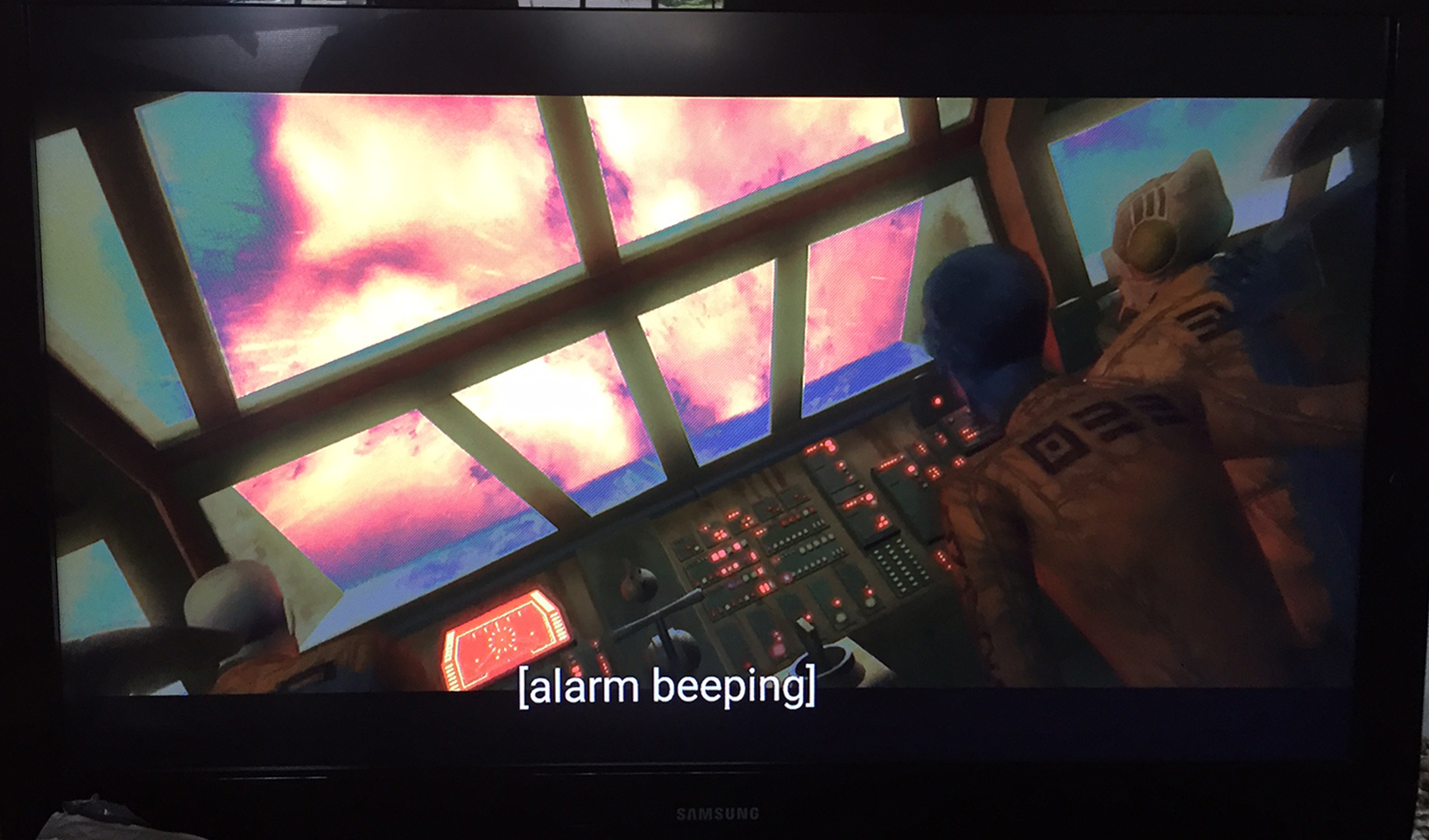

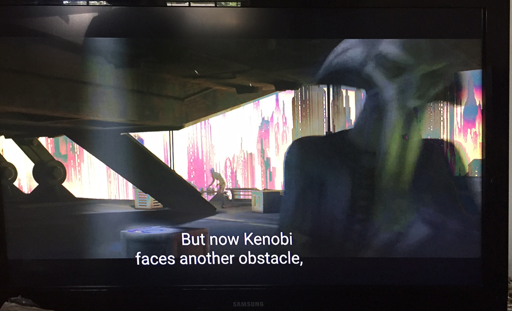

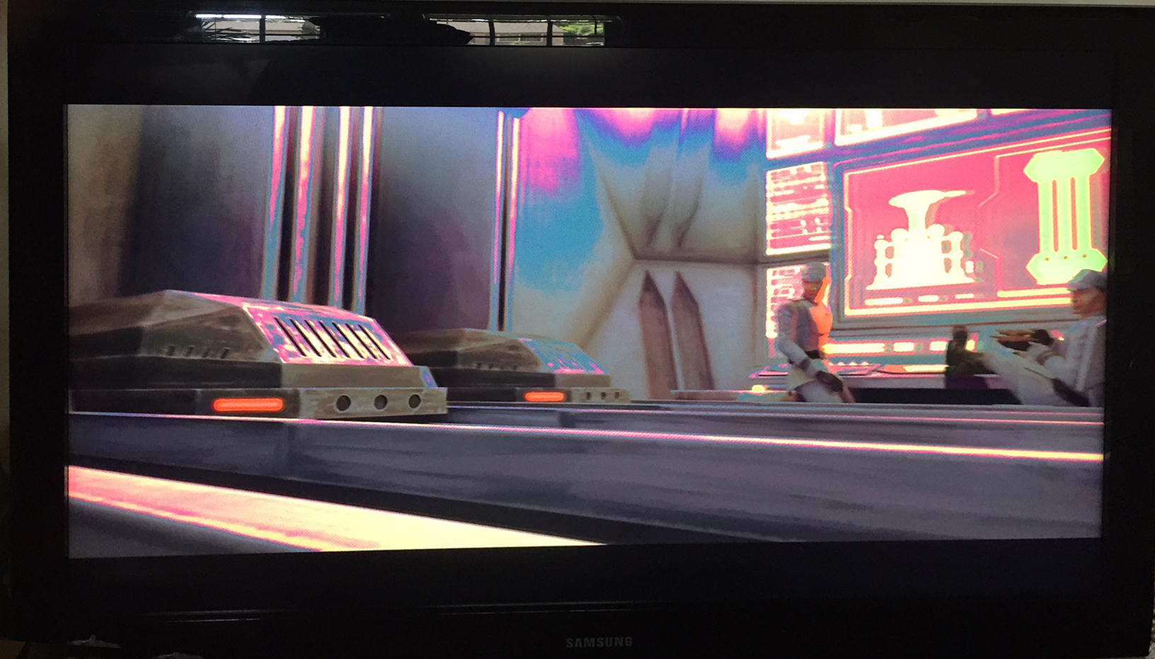

    This 46 inch TV recently started giving me problems. It happened few weeks after a move, so not sure if something broke during the move.
    Model: LN46A550P3F
    Model code: LN46A550P3FXZA
    The bright areas on the screen seem to be solarized. Dark areas seem fine. Images below.
