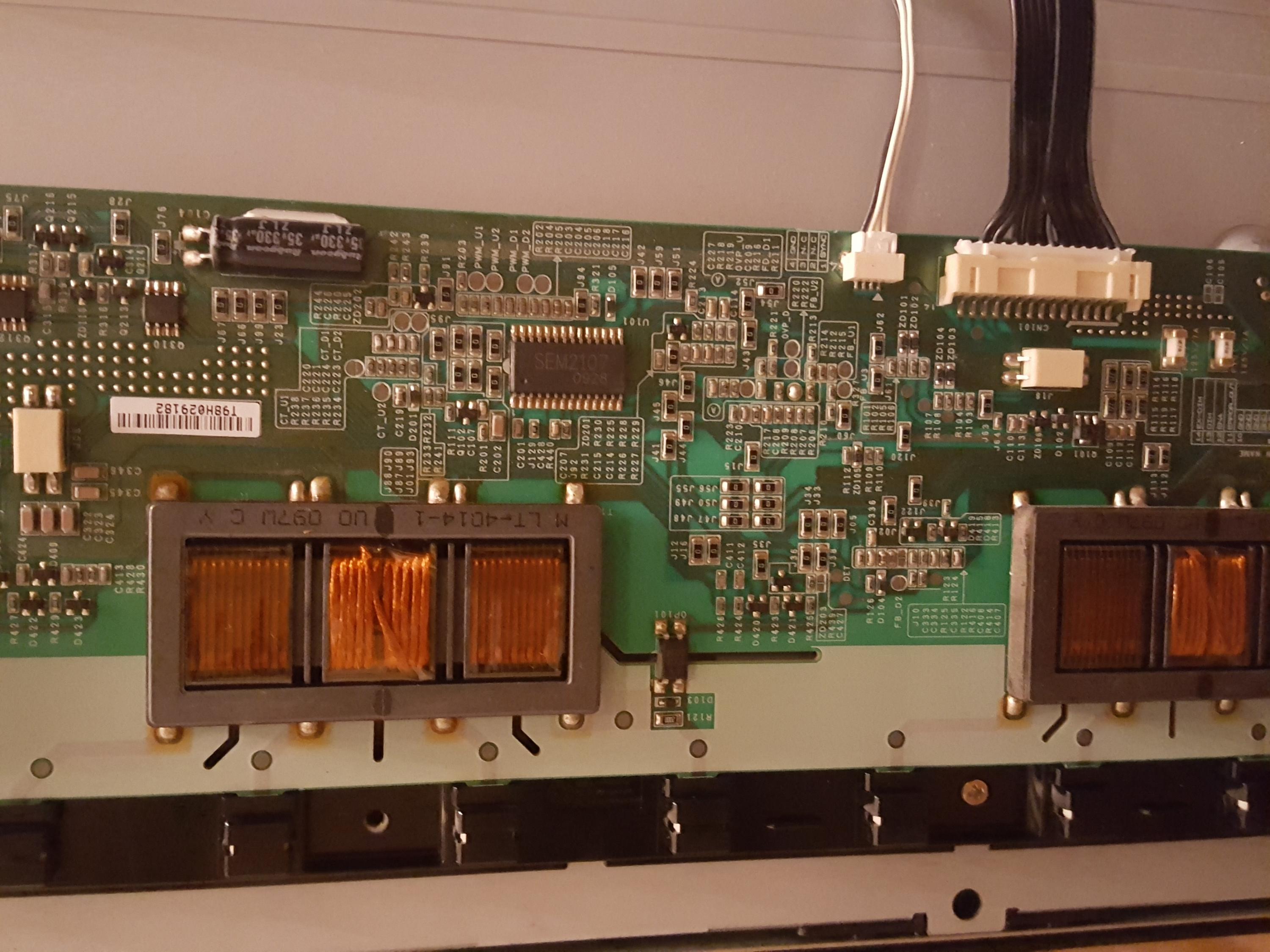

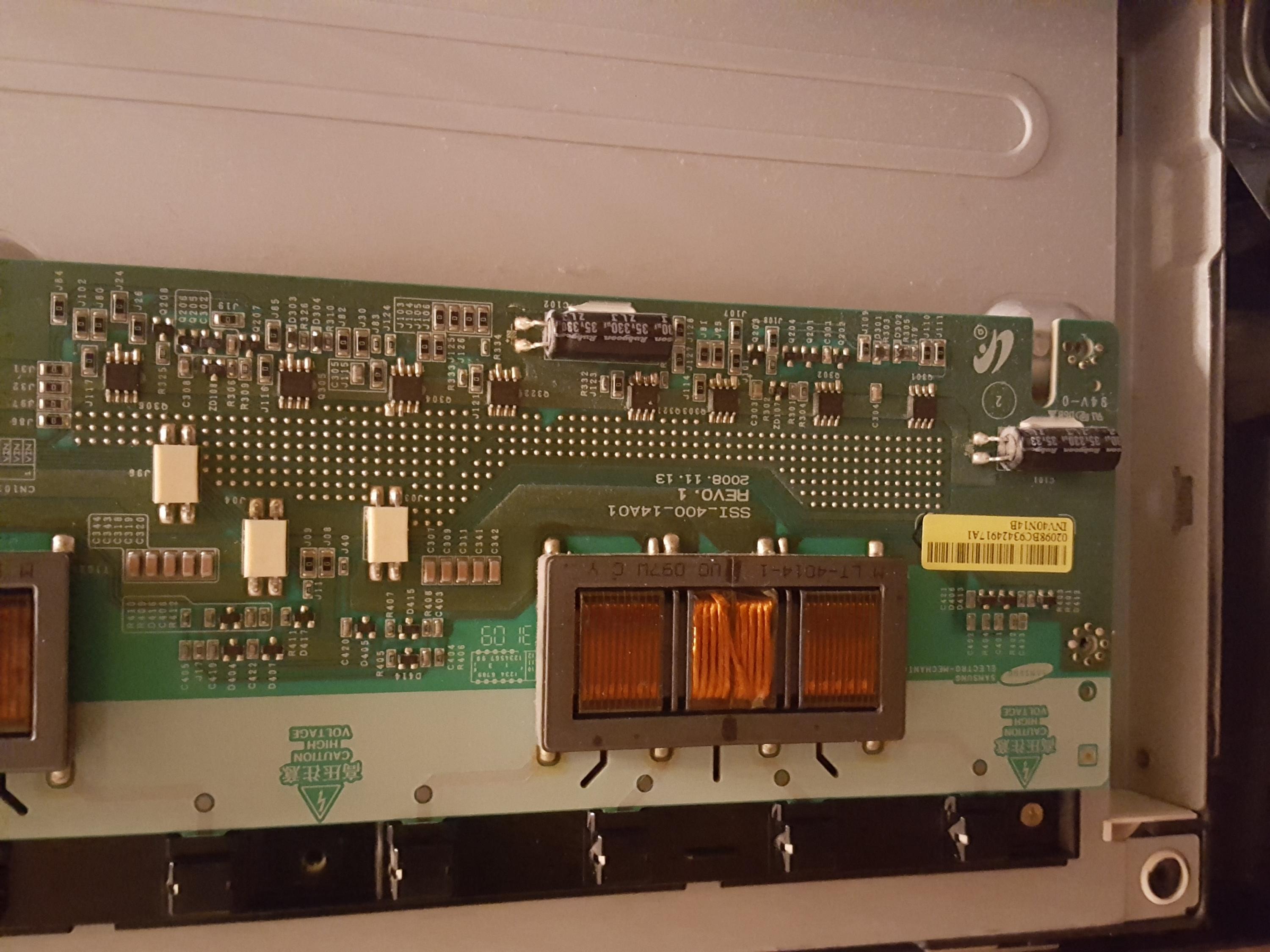

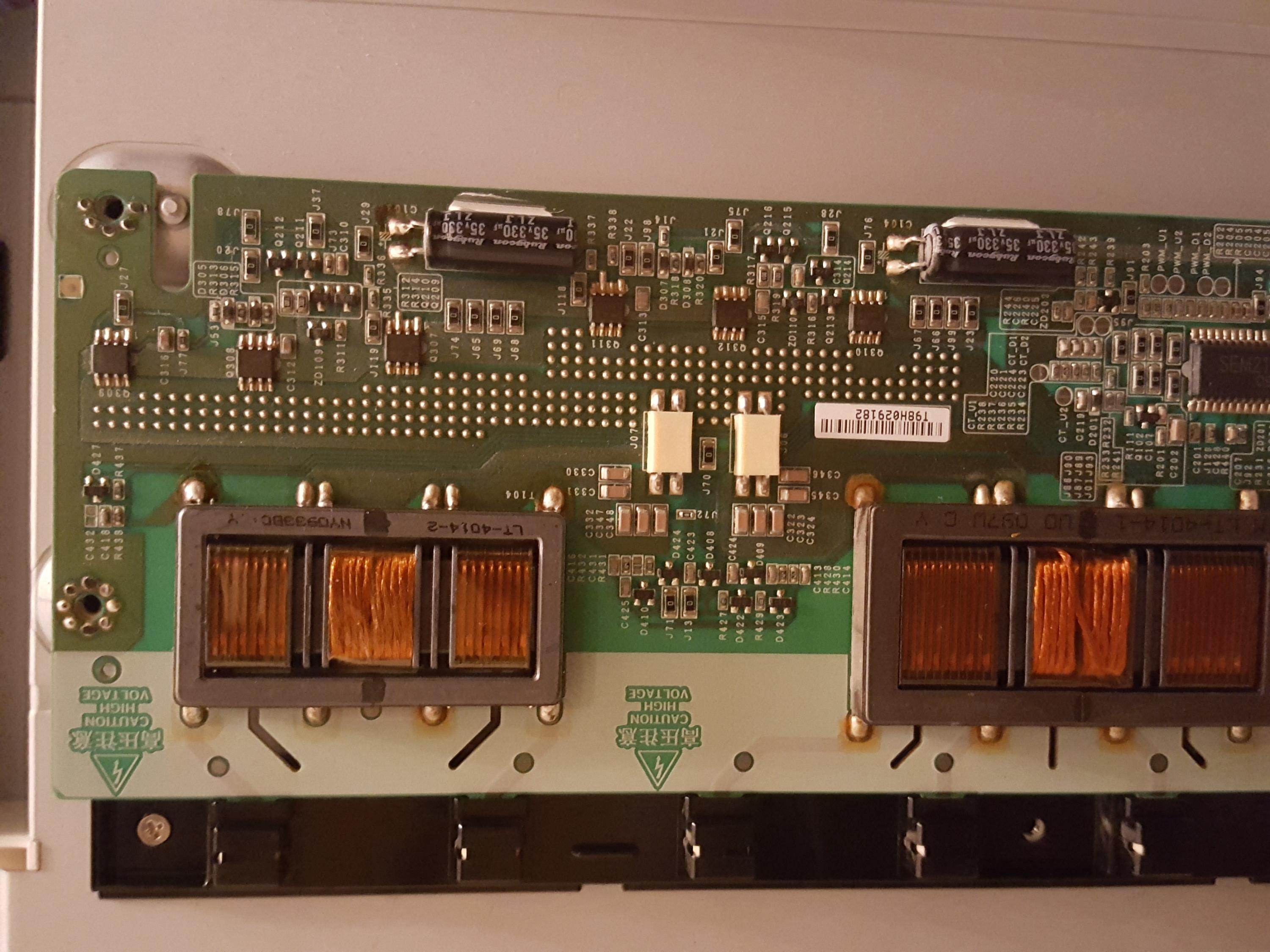

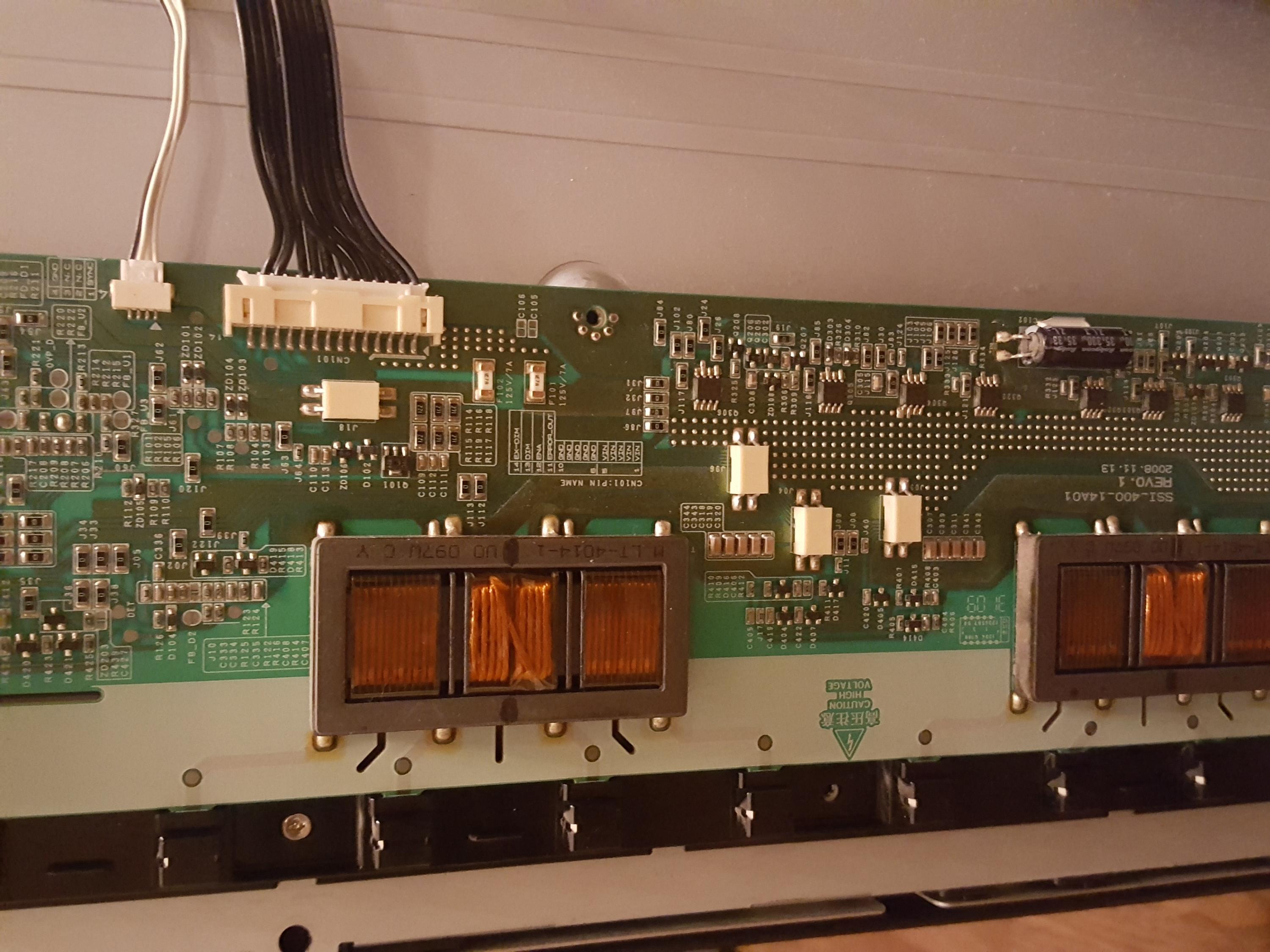

                                        #59
                                        Re: 40" RCA L40FHD41 No Picture + No Audio
                                        Ok, i took a series i pics of the board, its long so the pictures are numbered 1-4
                                        if you need better ones i can do so
                                        i know you can't see the tops of the caps on the inverter board, they aren't bulged - i guess that doesn't neccessarily mean they're still good. I can check them out of circuit or in?
                                        • attainteddragon
                                          • Apr 2013
                                          • 764
                                          • australia

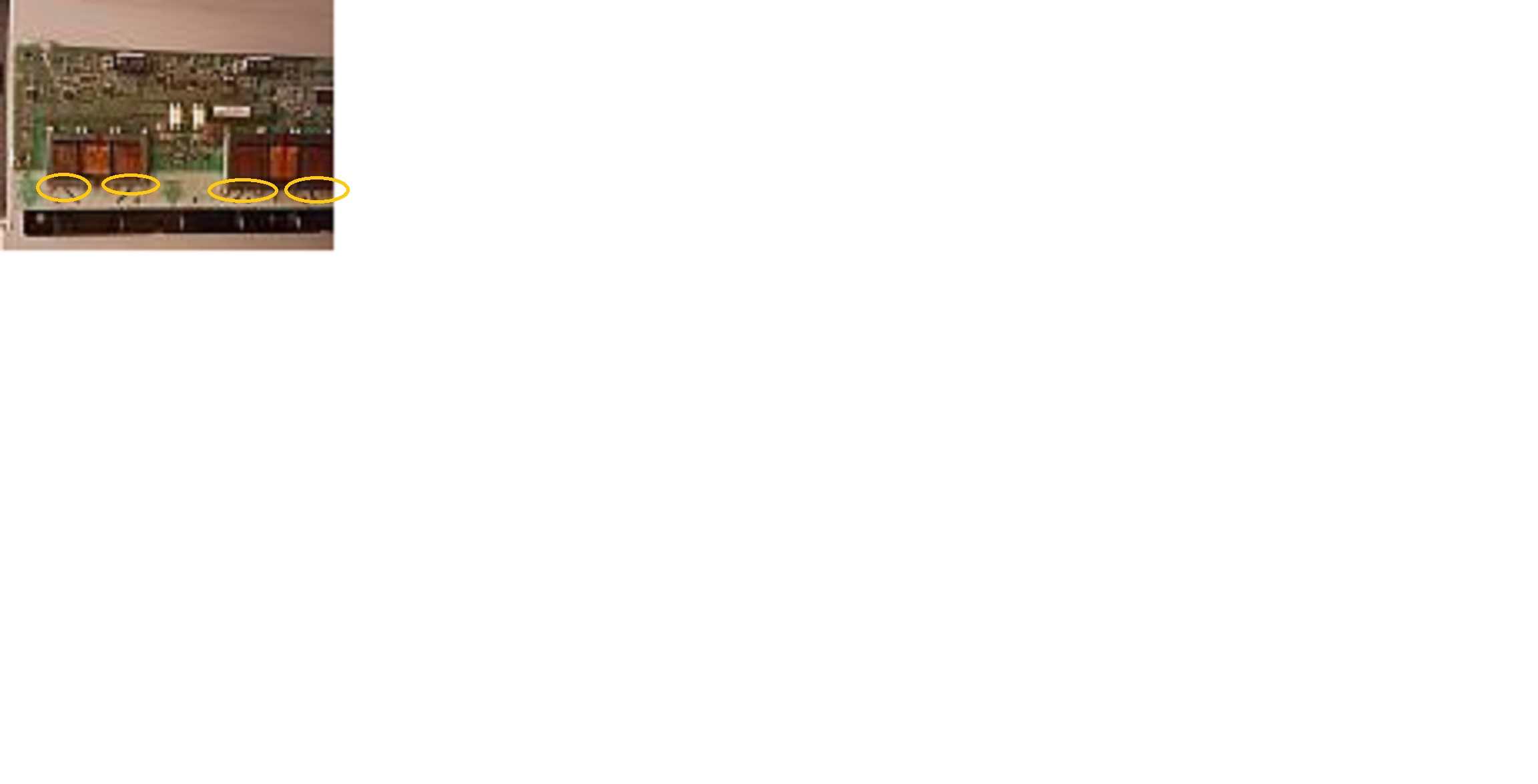

                                          #60
                                          on the transformers, resistance test the output pins that i have marked out.
                                          no power applied during testing.
                                          these are the output pins that drive each backlight ccfl. you would not put your meter anywhere near these with power applied. very high voltage.
                                          check all of the transformers, top to bottom. the top one will have a different resistance to the others, but we still need to know how it reads. you are looking foe one output that is noticeably different to the others.
                                          p.s. i'm guessing these pics are off of a phone, as they are tiny when i extract them to my desktop.
