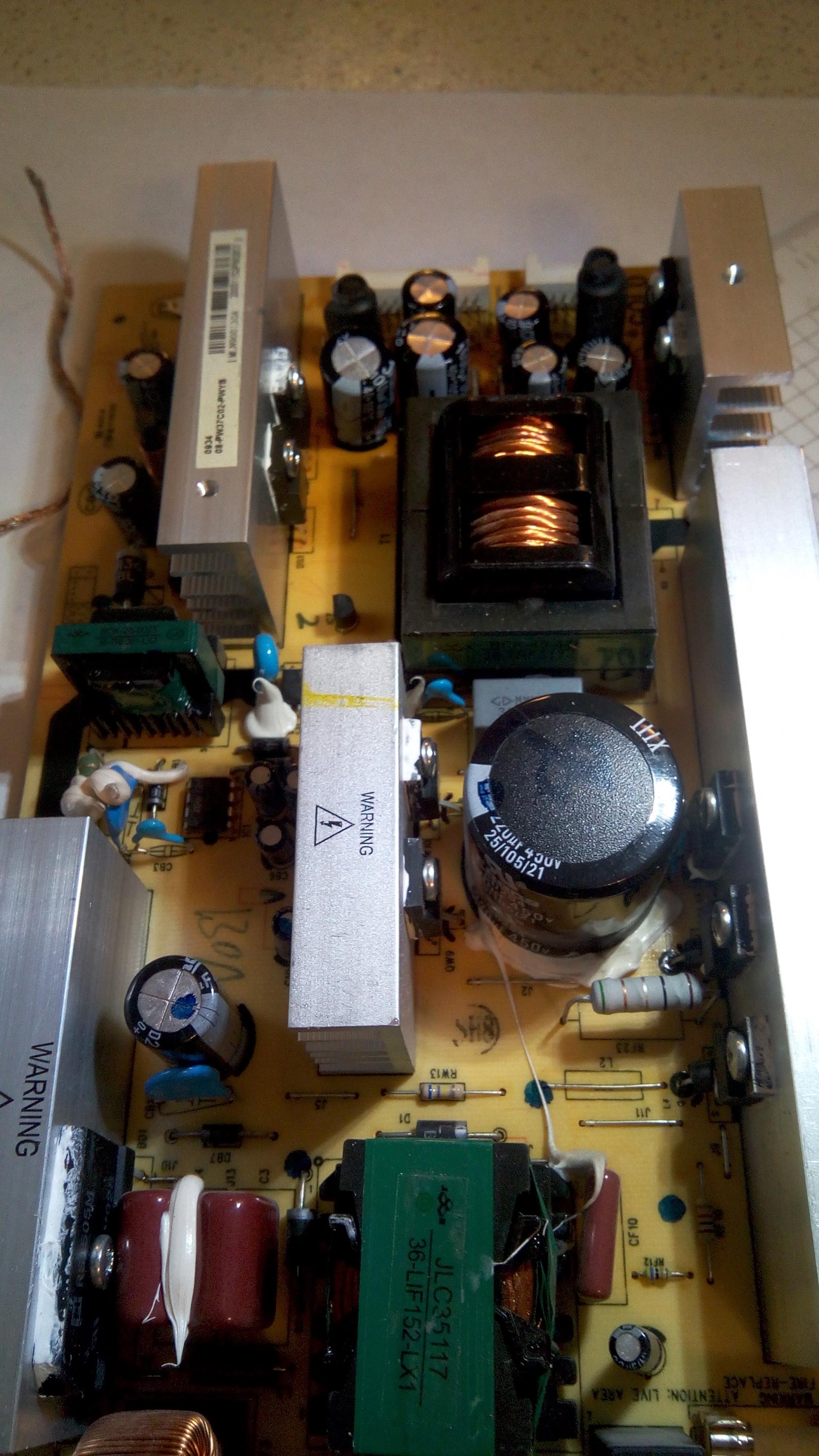

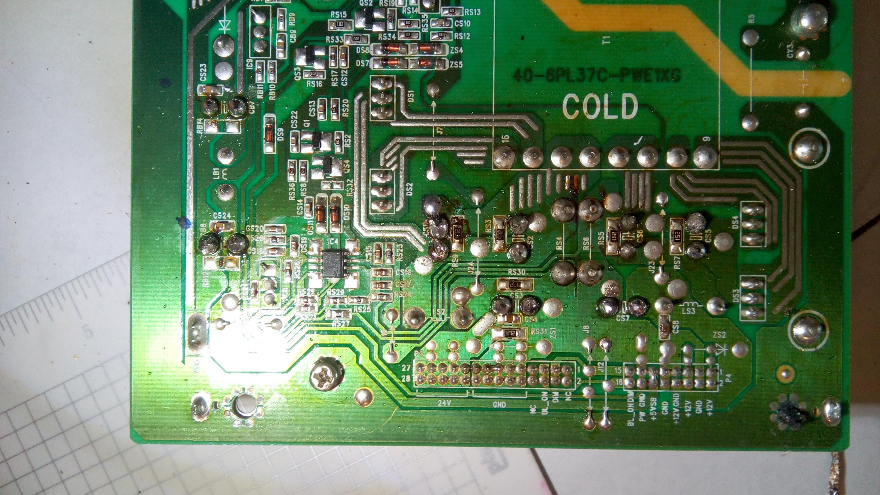

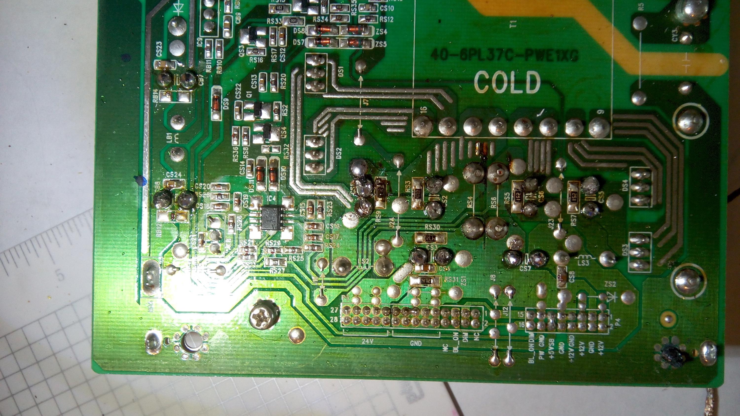

    Front and back
    • attainteddragon
      • Apr 2013
      • 764
      • australia
      Re: 40" RCA L40FHD41 No Picture + No Audio
      i would touch up the solder on the cap above rs9, could ark over on that cap.

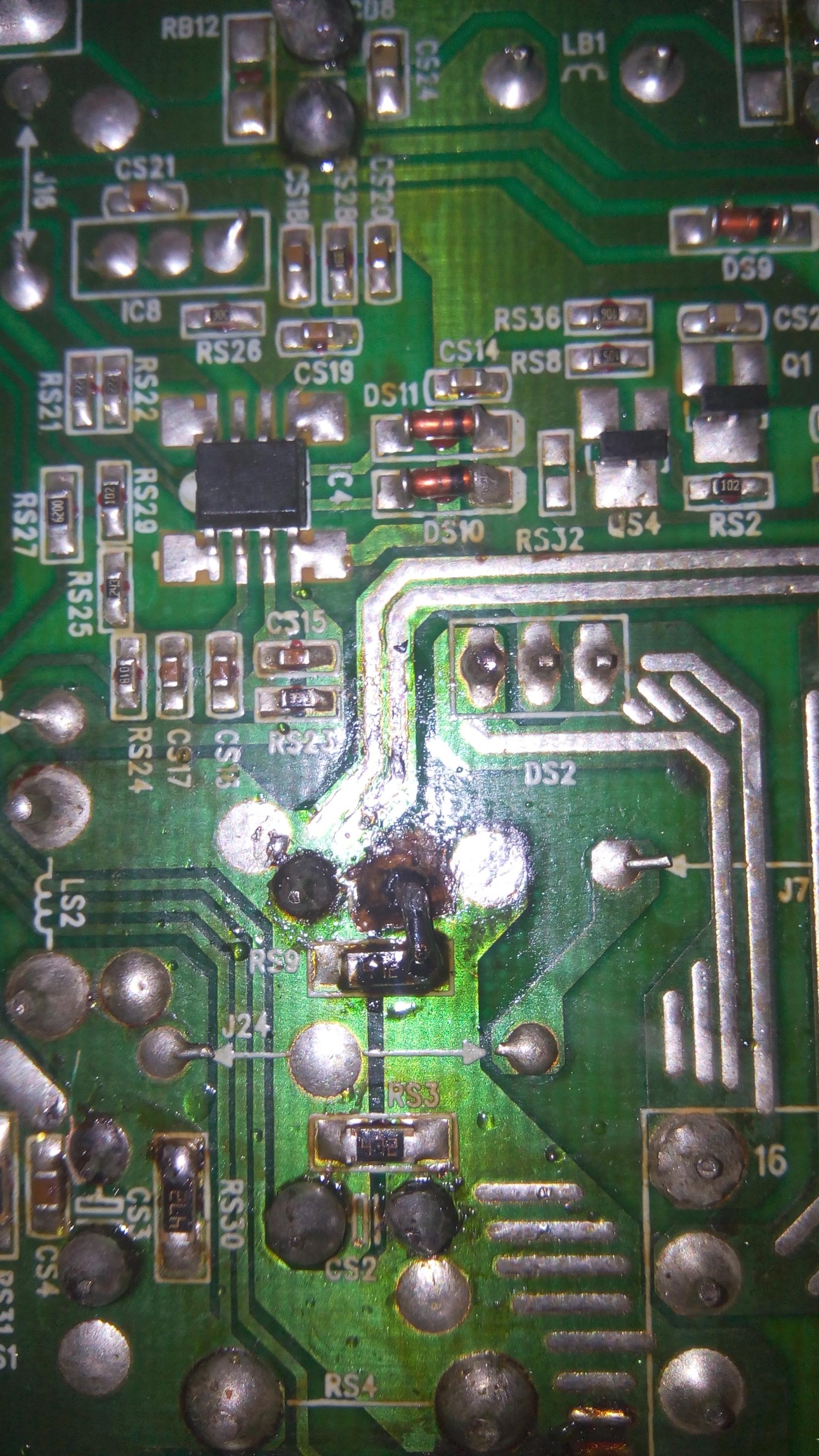

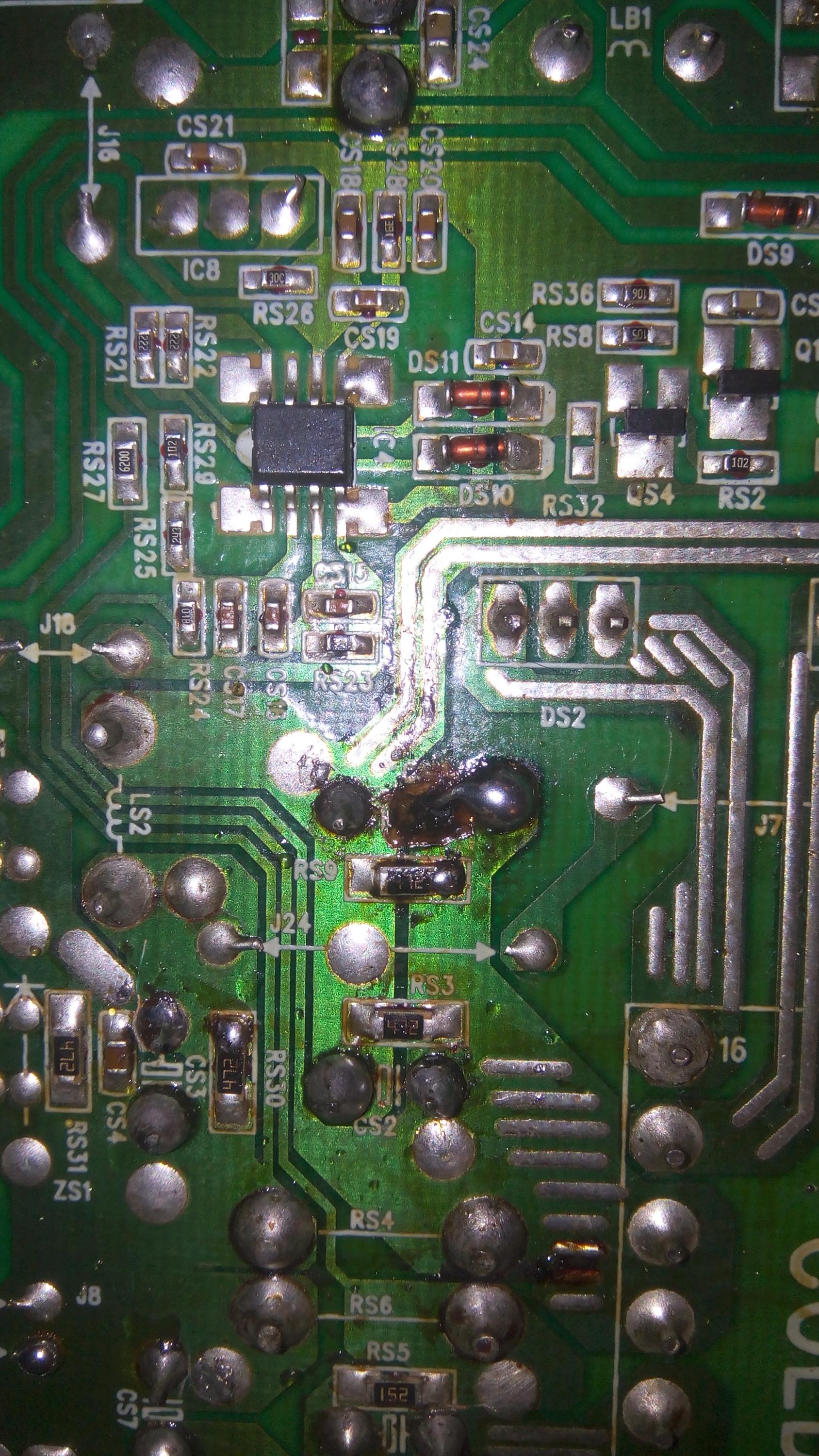

          When i was desoldering the original cap above rs9 my iron was too hot and removed the copper plating on that part of the board.
          I tried scraping the board to reveal more copper underneath (saw on internet) so i could have something to solder to but made a hole there.
          I tried to bridge that solder joint to what looks like a tiny transitor (followed the circuit path) - is that right?
          It didn't work so i desoldered that bridge and tried to solder the cap regularly while missing the copper plating on one of the joints...
          Any idea on what i can do about that ?
            soldering to the next component is fine.
            it just looks like there is too much solder. i would remove it, bend the legs out slightly and resolder. while your at it, j12 looks to have a bad solder joint on it.
            after that is done, it will be time to look at the output voltages that go to the main board.
                  Update #2:
                  I wanted to show you guys the work I did on one of the capacitors, the one above rs9 and how i have it soldered to the next component (resistor ?) - is this okay?
                  I know its utter shitty work, it was my first one i did and the rest came out better, i messed stuff up and this was/is my improvised workaround.
                  (solder flux shite everywhere)
                    #29
                    I would have bend the lead over to that large unused pad instead. I cannot tell how good the solder works i to the end of that SMD cap in the picture.
                    BTW, why the solders works look so dark instead of shiny? Even the leg of the cap looks dark.

                      #30
                      I really don't know why it's so crappy looking, i lowered the heat on my iron, maybe it's too hot still?
                      Flux residue resides alot, i tried cleaning with alcohol and small brushes
                      I will remove that solder and try the pad instead
                        bud, i removed the solder joints pointed out and soldered to the pad instead
                        yellow bars are gone, half of screen still red though, audio still works
                            since there was some initial pad damage i would check for continuity between the pins on those pads, just to make sure.
                                Here is what it looks like now before and after with the capacitor now soldered to the pad to the right; I did remove the solder connection from the SMD chip beneath and now instead am soldered to that pad that Budm mentioned above
                                Where should i check continuity?
                                • attainteddragon
                                  • Apr 2013
                                  • 764
                                  • australia
                                  #36
                                  that looks heaps better.
                                  just check across the cap. if there was any stray trace, it would show low ohms.
                                  on the ps, the connector that goes to the main board, we need to know the voltage on each pin in standbyand when powered on. use the chassis for ground.

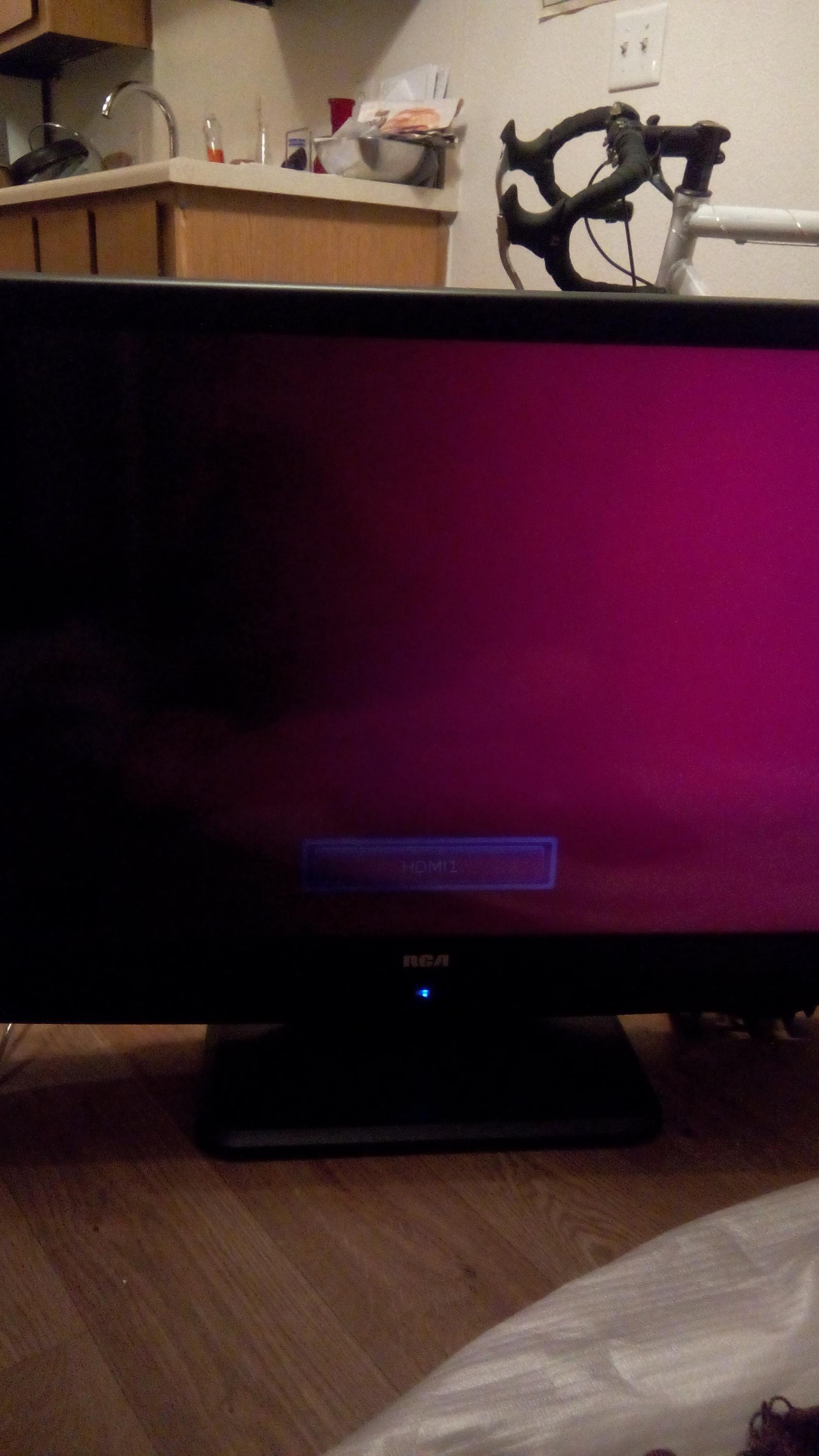

                                      Can we see the screen shot of what you are seeing on the screen? At this point I do not believe you are having power supply problem since the backlights are on and based on what you describe what you are seeing on the screen.
                                      • ajsterr4
                                        • Jun 2016
                                        • 115
                                        #39
                                        TV powers on and shows this for 1 second
                                        edit
                                        The black on the left side is not an error in the photo, the left side of the screen is faded black as such BUT when i connect HDMI to it and hold a flashlight to the (dark) screen, i can see the whole image is being shown throughout the entire screen.
                                          #40
                                          OK, so backlights do not stay on.
