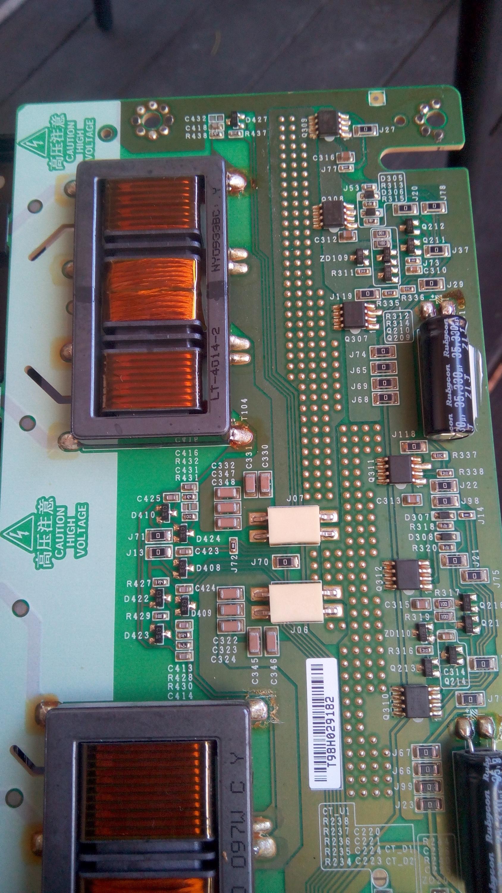

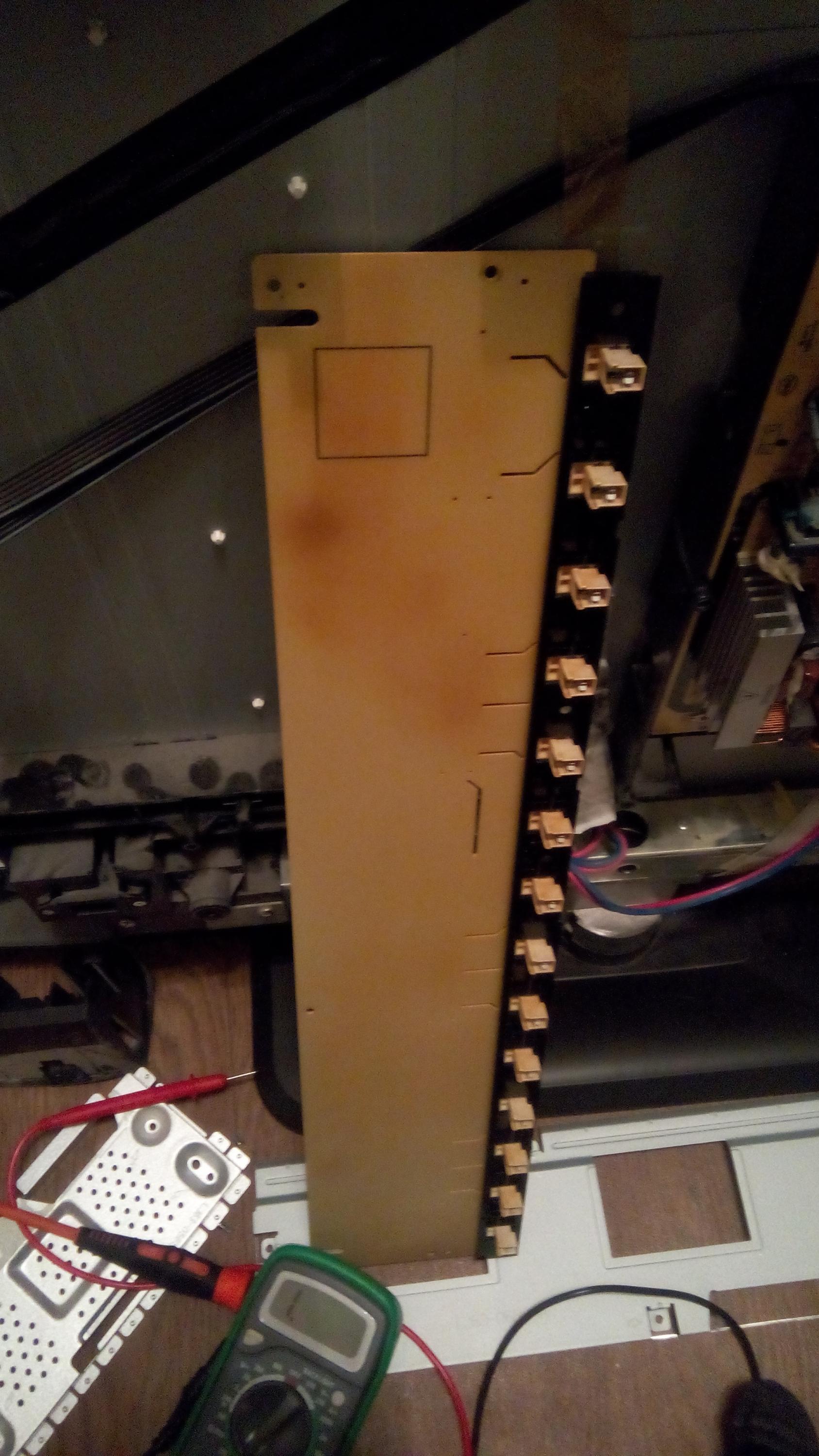

            Here's a picture of the backside of inverter board, the top looks like it was exposed to some heat
            The burn marks lead to the area right where the capacitor on the right is and where that eight legged transitor is (see pictures)

              #86
              Re: 40" RCA L40FHD41 No Picture + No Audio
              The hi-heat discoloration goes down the whole length of the inverter board (backside) but it's not as dark in some places. There are 14 mosfet transitors that run the length of the board too.

                #87
                These are the mosfet that are on the board
                PDF
                I am getting ~0.567k on D1 pin 5
                When I check the other Drain pins 6,7,8 I do not get a reading
                Negative probe on source, charge up the Gate pin, then red lead to Drain

                  #88
                  in your pic with the ccfl's on, the 3rd from the bottom is not on. can you confirm/deny if is working or not.
                  WHY CAN'T PHILIPS USE PHILLIPS HEAD SCREWS?
                  • ajsterr4
                    • Jun 2016
                    • 115
                    #89
                    It's possible it was working at some point or maybe I didn't snap it in all the way. Oddly enough since I've taken that picture, 2 ccfl bulbs broke (one of them being the 3rd from the bottom) it broke trying to snap in/out.
                    2 bulbs are now missing but the other bulbs still light up and shut down the same. Can you operate the TV with missing bulbs?

                      #90
                      that's a problem. even if the inverter board was ok, it would sense that pulling different amount of current from each transformer, so it would shut it down to protect itself.
                      so, you now either need to replace the ccfl's that are broken to continue, or call it a day on this one. if you could get your hands on a broken screen set, that would be awesome.

                                #95
                                It looks like one of the inverter transformer got hot too.
