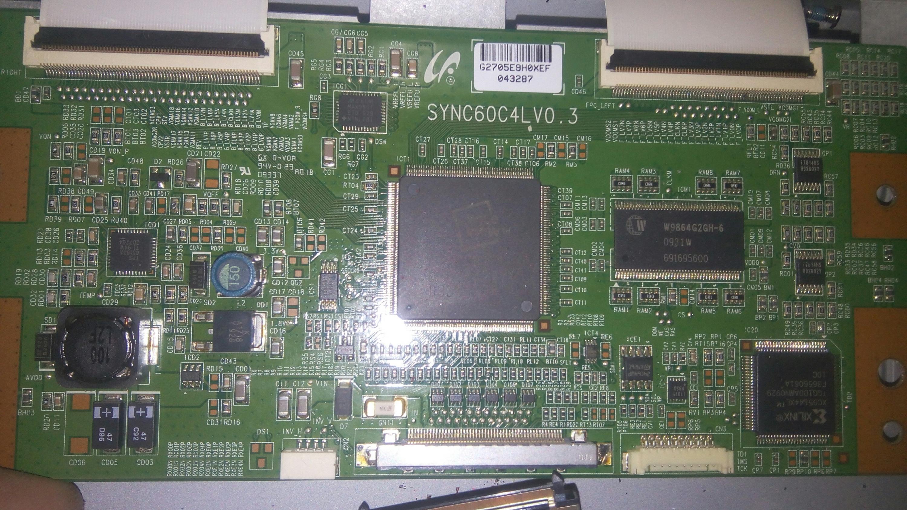

    This TV turns on for a sec before it turns black, so far:
    flashlight to TV screen shows image being shown (good thing for t-con right?)
    I also connected laptop to it via HDMI and TV is by default on 'HDMI 1 setting'
    It makes video on laptop really slugish while hdmi is connected to the TV, and the audio is only pops/noise coming from TV
    What should i be looking for?

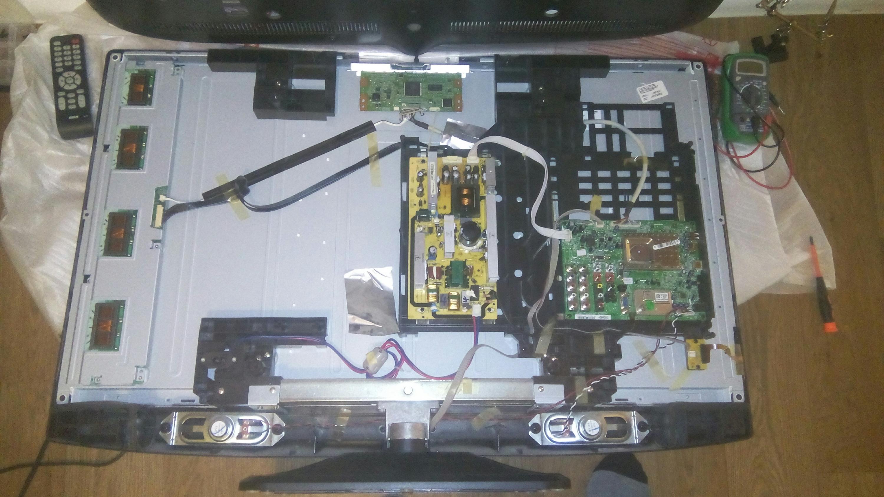

    The TV is disassembled and its kind of a project for me for an extra TV in the house and to practice fixing more things
    Elsewise the TV has little value

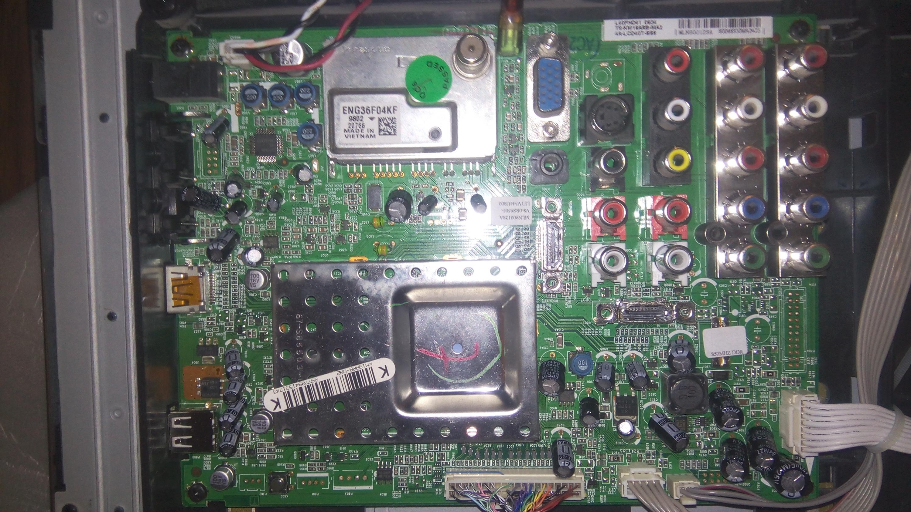

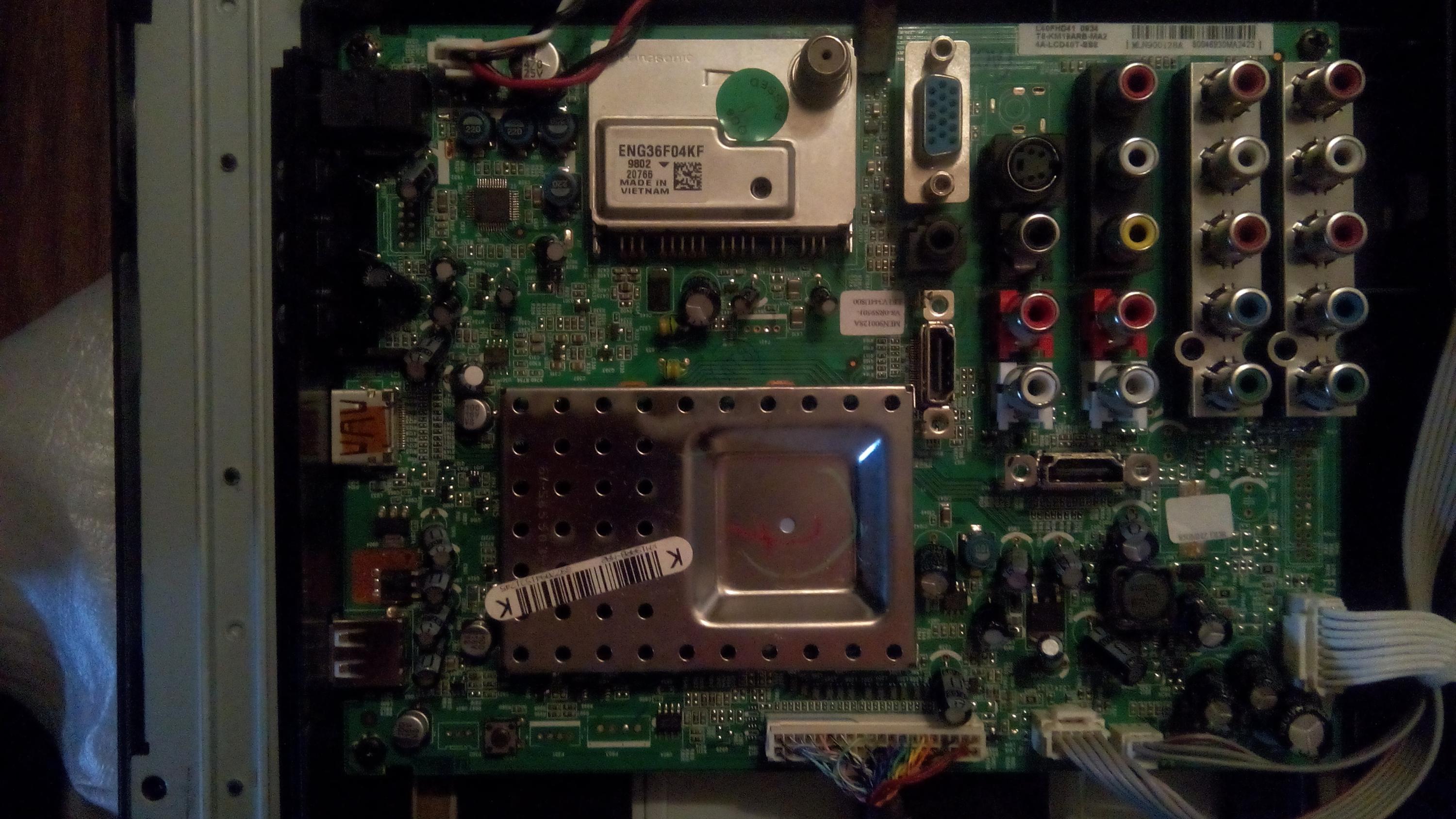

    Re: 40" RCA L40FHD41 No Picture + No Audio
    Need good clear straight on pictures of back of tv with cover off and each board.
    Do you get any flash on screen when you first turn it on?
    • ajsterr4
      • Jun 2016
      • 115
      There was no flash that i recall, I turn on power, TV light turns blue/stays lit blue tv screen itself is black while powering up for the first second (normal) then image for a moment, before it quickly dims black and no picture
      here's the pics I got to help, hope they suffice if not let me know

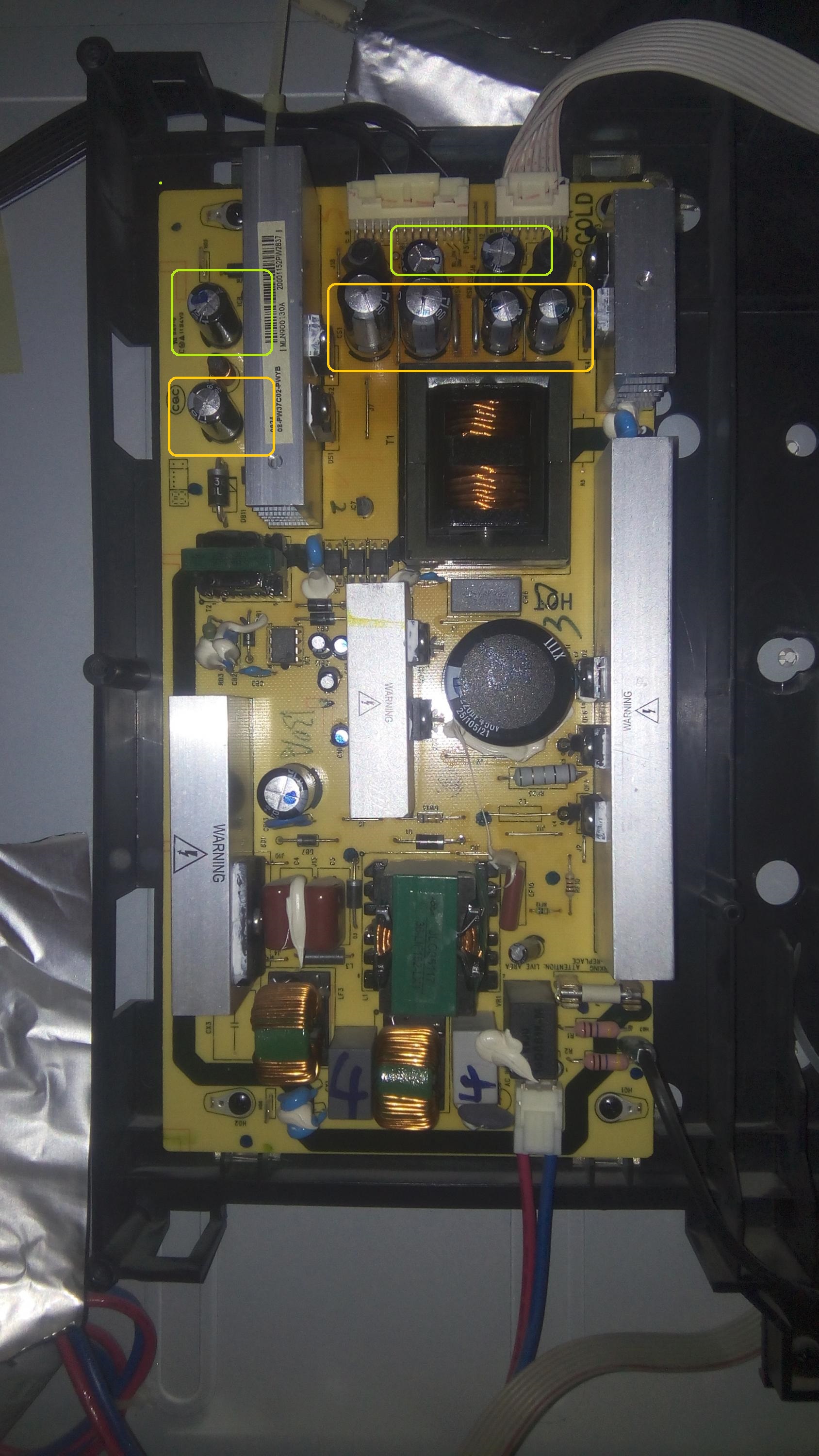

        I am seeing a bunch of bulged caps on power supply.
              I would replace all caps at top of board. I see at least 5 bad ones. Also they don't have to be bulged to be bad. Changing caps is easy and not to expensive.
                    change out the ones i marked in orange and if you don't have access to an esr meter, change out the ones that are marked in green.
                    make sure you get low esr, 105 degree caps.
                        Yes just the cylindrical ones that attainteddragon marked. That are polarized when you go to replace the neg. goes towards wide band on board.

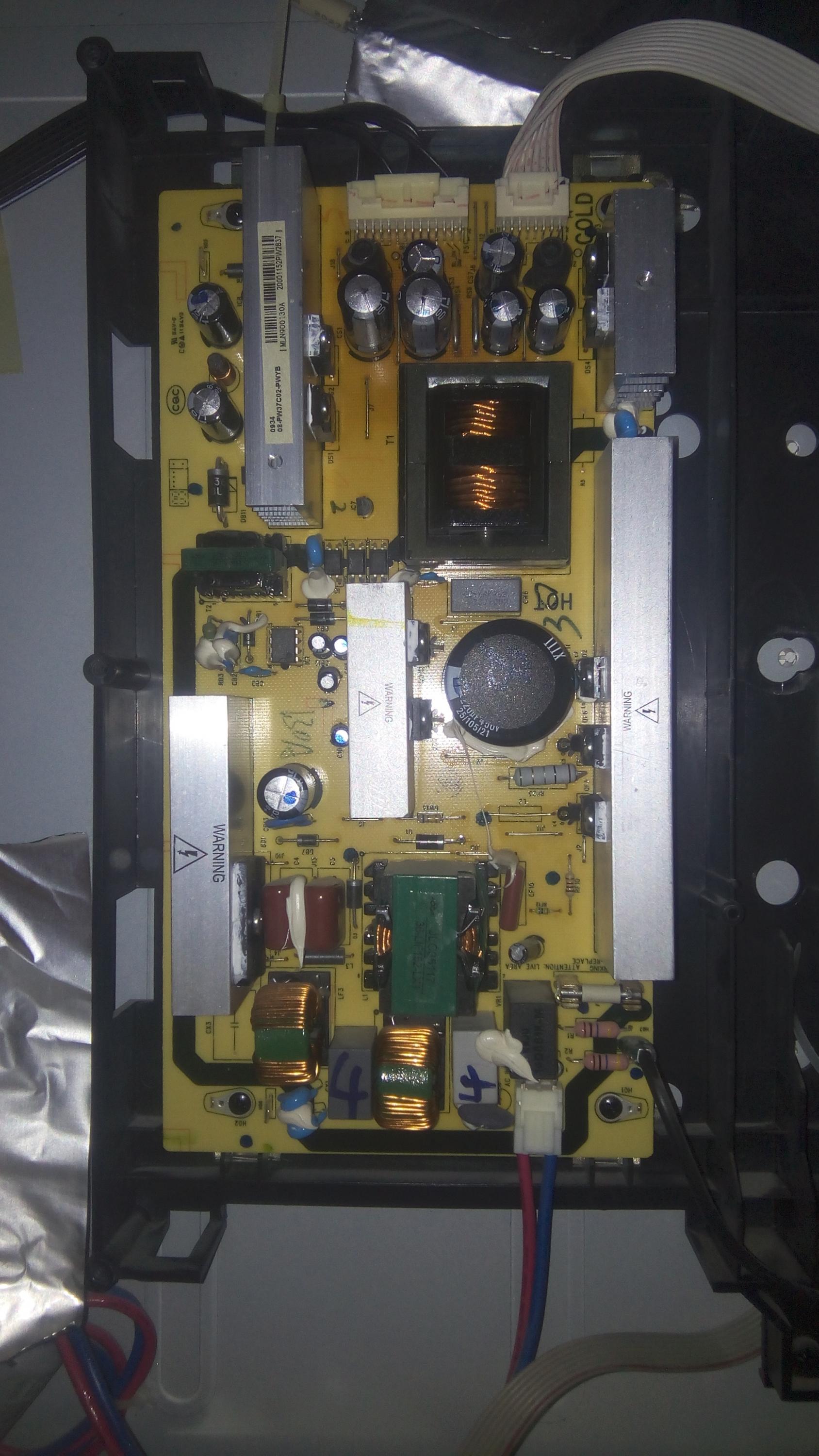

                              So i replaced all 8 capacitors and tv still doesn't work, i don't know how to test everything with a multimeter tool, although, i do have one.
                              TV is turning on, half of screen is blue, the other half is black.
                              Then it just turns off after a sec...
                              • ajsterr4
                                • Jun 2016
                                • 115
                                There is one more big capacitor at the bottom left, its 450 volts...
                                looks a tiny bit bulged, but wasn't replaced.
                                what do you guys think?
                                        Can we get a picture of the power board again?
