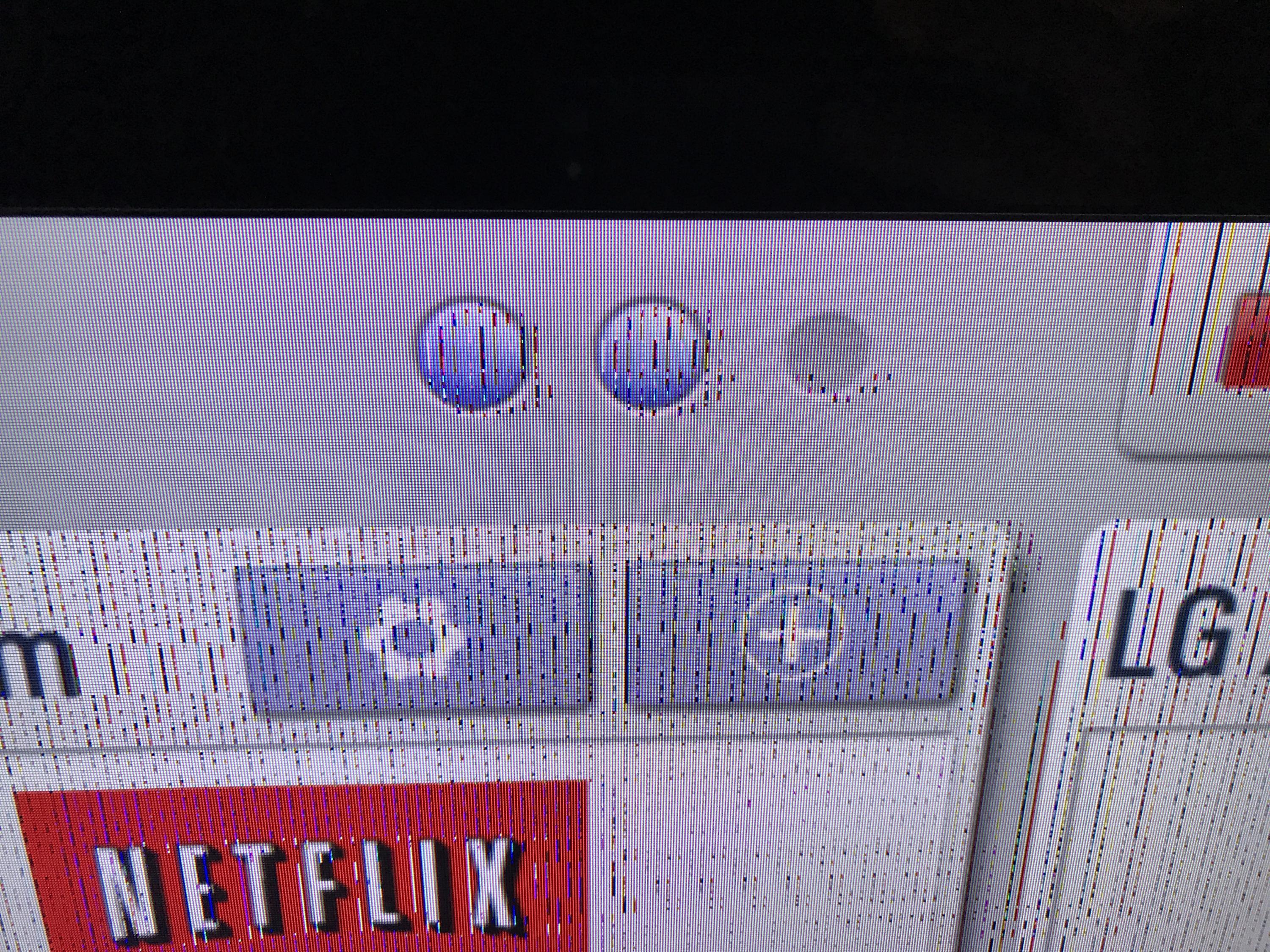

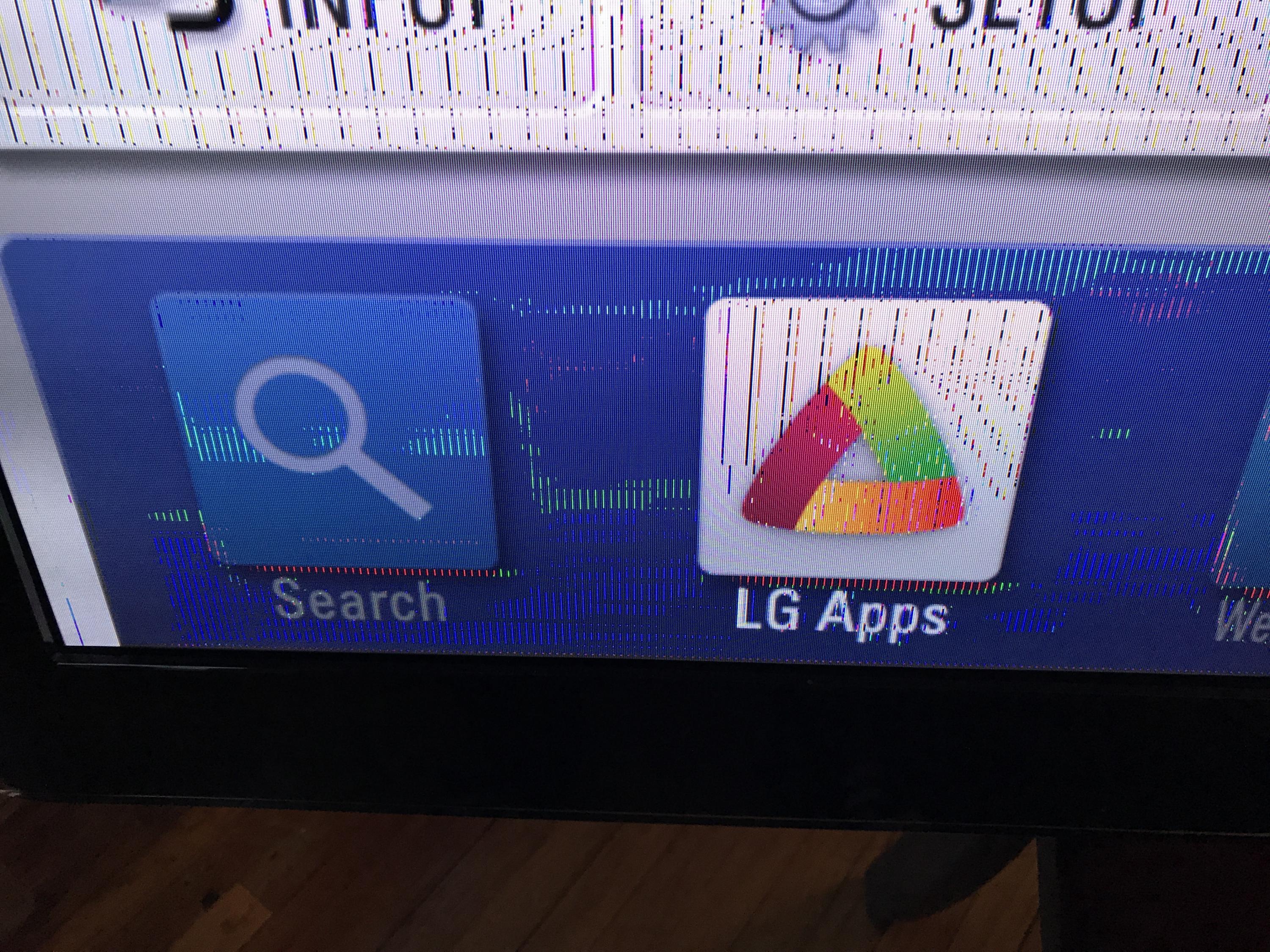

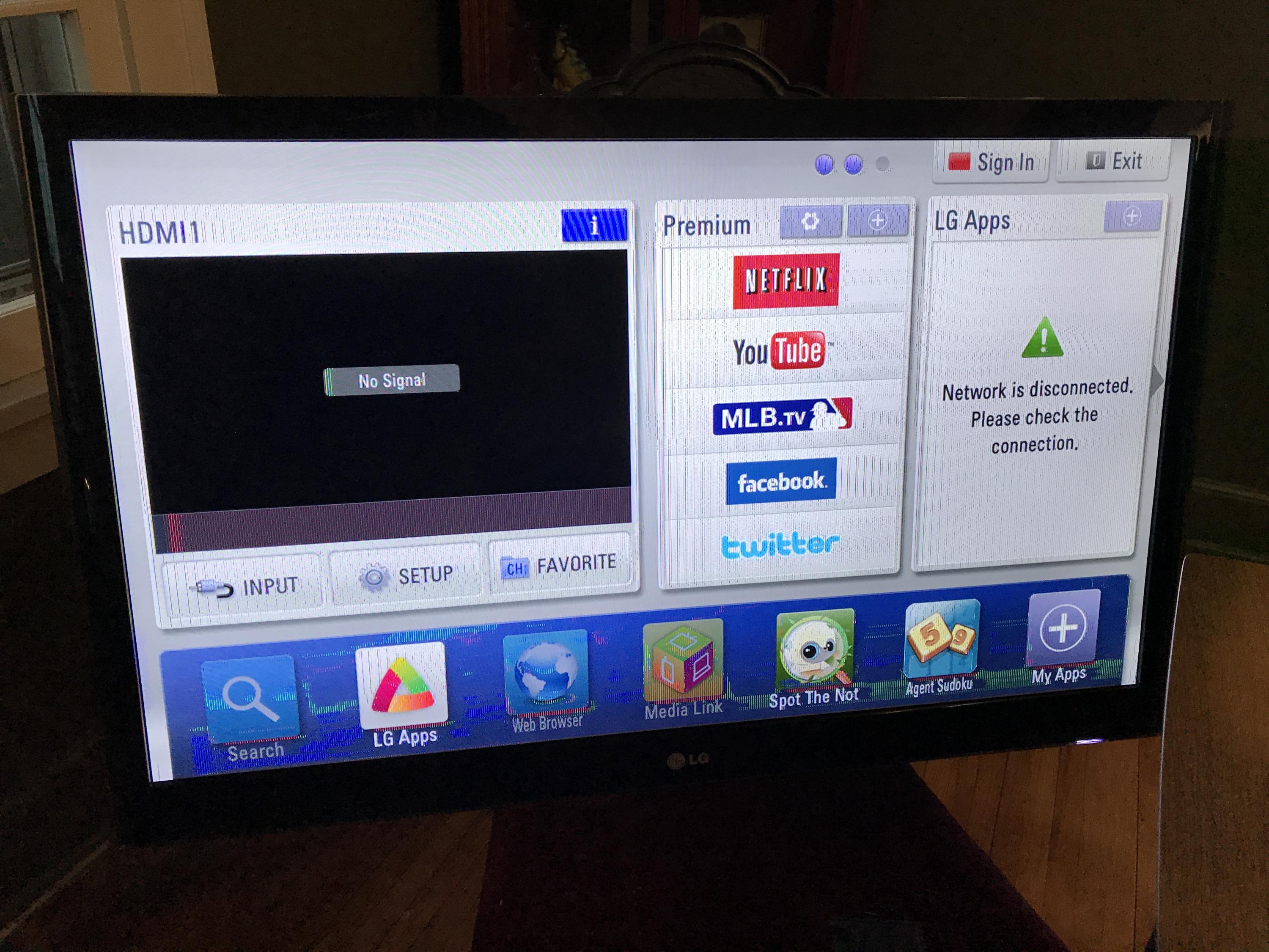

LG 42LV5400 panel failure or internal board?
  • johnboy1313
    • Nov 2012
    • 1959
    My gut tells me panel failure. The menu shows the same condition.
  • johnboy1313
    • Nov 2012
    • 1959
    Re: LG 42LV5400 panel failure or internal board?
    I can only post one pic at a time from my phone.
    • johnboy1313
      • Nov 2012
      • 1959
      Another pic
        Only a guess for me but don't think it is panel. Lines look like they go across full screen. Usually panel is only on part of the screen.
        • diif
          • Feb 2014
          • 6978
          • England
          As it's an LV i'd suspect it's the BGA on the mainboard.
          • attainteddragon
            • Apr 2013
            • 764
            • australia
            i'll put a vote in for main board. looks too even to be panel to me, but it is only my guess.
            you will always be able to isolate it a bit more by disconnecting one side of the t-con and see if the fault changes at all.
              check lvds cable...reinsert it or apply wd40 to both connectors..this will fix this problem.if not then motherboard is suspect
                  I'll try to reflow the processor and see if it makes any difference. Thanks guys.
                  • tw2005
                    • Oct 2011
                    • 6458
                    Just reheated a LV5500 on the BGA, came back to life. I'll vote mainboard, main processor
                    • rccrasher65
                      • Mar 2014
                      • 626
                      +1 did a few of these.
                      • johnboy1313
                        • Nov 2012
                        • 1959
                        Well, seems like that's what it was. A shame this thing doesn't have Wifi. Would any USB wifi dongle work or does it have to be an LG branded one?
