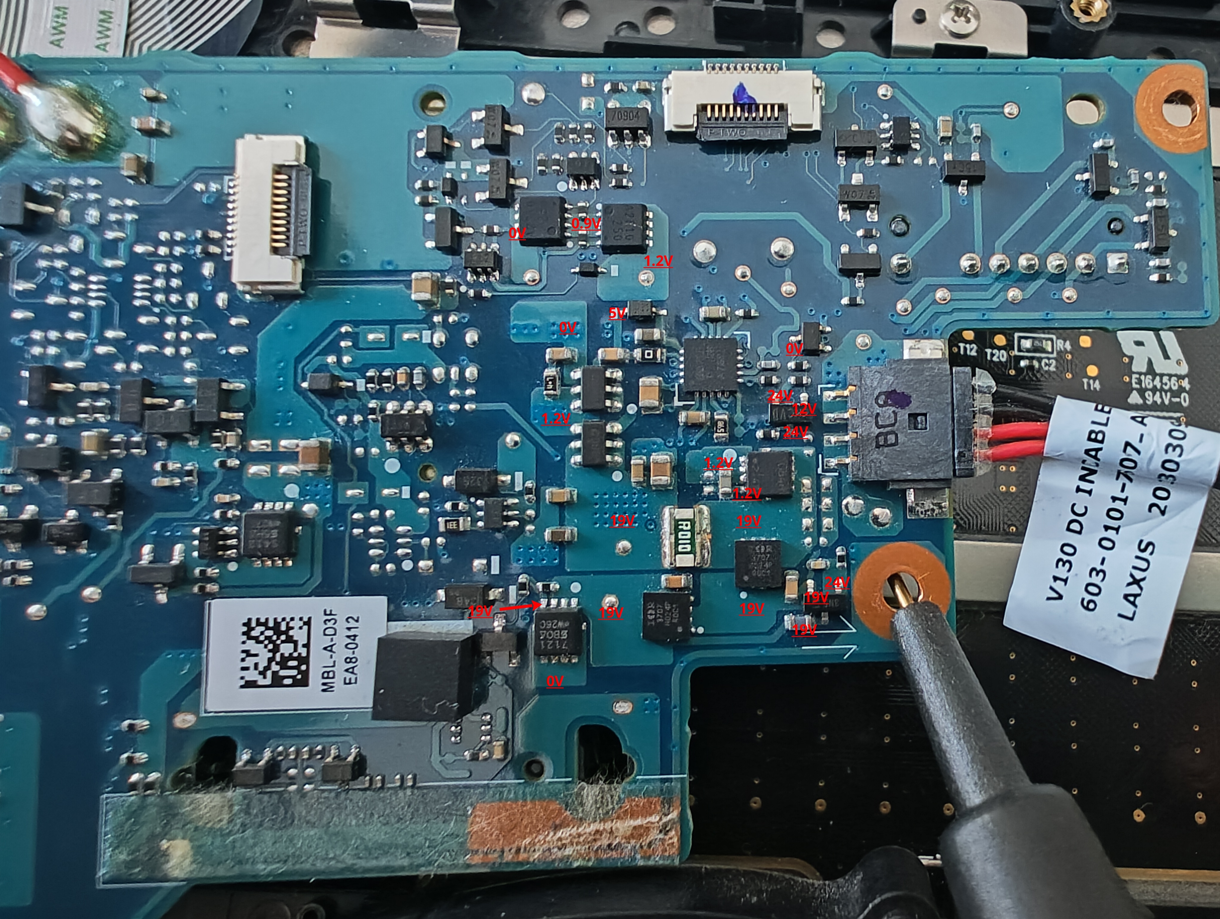

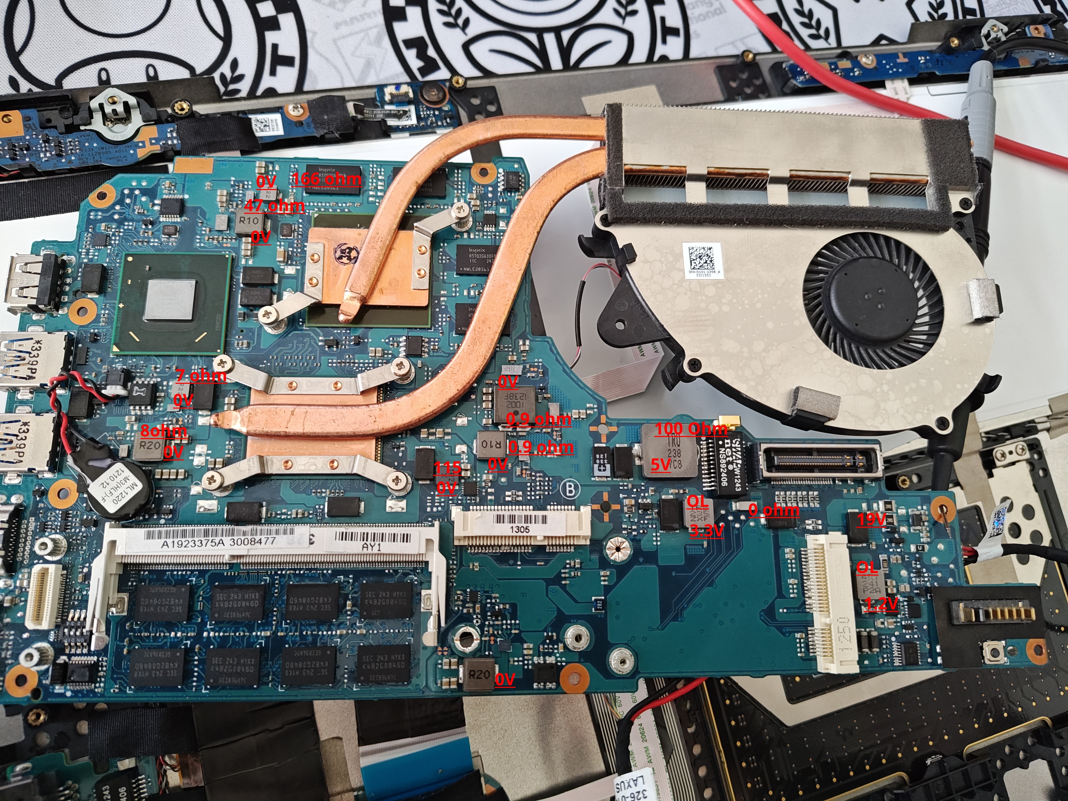

    I started to measure the voltages, i have 19V not shorted, 3.3v is present, 5V is present and 3.3 present at the power button as expected, but still not able to start the board.
    I placed in the picture what i have. It is not obvious for me what happened, i triple check my work when putting the board back, and i did not made any mistake.

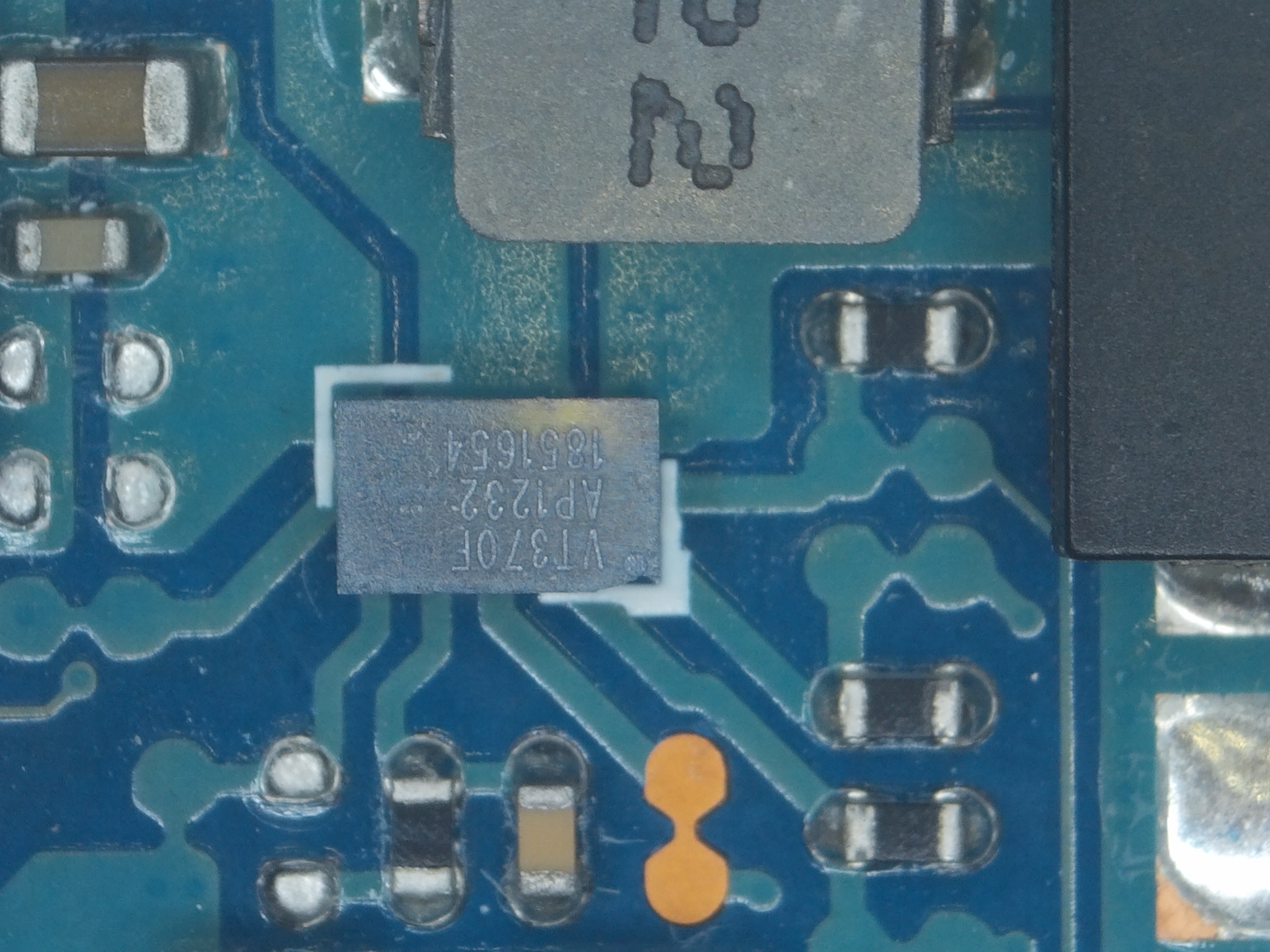

    I only found a strange issue, with what looks to be a power regulator, the corner of it was broken, not sure if it has an influence but i put a picture.
    I also placed in the picture the resistance to ground i have for each coil.
    If someone have an idea where should i continue to look, because i am a bit lost.

      Yes i checked, i get the 3.3V on the power button itself, pressing it cause the voltage to go to 0V and then back to 3.3V. On the other end, i checked all the fuses of the board, all looks good, when no battery is present, the board eats 4mA on the DC-in and no difference if i press the button, when the battery is in, it starts to a steady 230mA and then jump to 500mA, again no difference if i press the power button on the current.

        There is no current draw from the power adapter side of the power path. Which charger IC is onboard? Test the DCin mosfets in the power adapter path to the main power rail for this board.
        The VT370F IC that has been slightly wounded since this is a BGA device.

          The charger IC is the BQ24725. Both mosfets looks good, i see 19V coming through and i don't see an issue with it.
          However, i am wondering if i don't have an issue with the BQ chip, because on the screenshots, where you see 1.2V at the coil next to it, on a working board i have 2.4V. And this voltage directly comes from BQ. I ordered few of them tro try it out, i don't want to mess with my working board. I also ordered few VT370F in case of, but i am really wondering if this little wound can cause an issue on it ?

              I checked the bios chip, no power on leg 8, and i compared with the good board to make sure i wasn't mistaking. I traced where the 3.3 was coming from, and guess what, from this VT370F power regulator. I have 3.3V on top right corner resistance on the good board, not on the bad one.
              Once i receive new one, i will exchange and let you know.
              • delpiero3
                • May 2017
                • 11
                • Belgium
                Mmmh, i think i was speaking too fast. I am under the impression that the top right corner of this VT370F is the VCC, and therefore, i should get 3.3V there compared to the working board and i have nothing. So back to square 1, i don't know where the 3.3V of the bios leg should come from, i have no way to trace the track. How do you proceed in such condition ?
