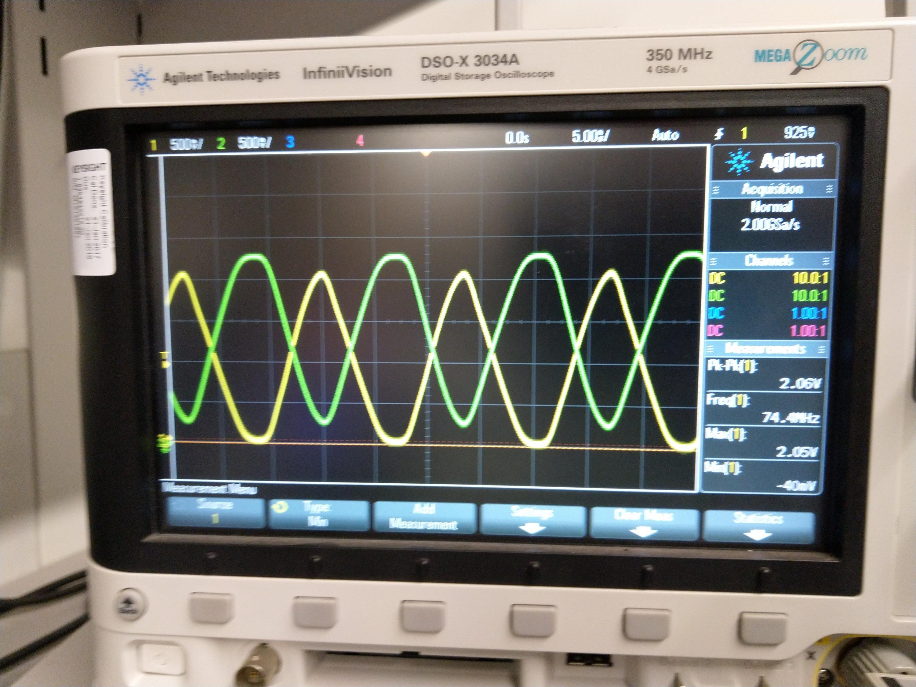

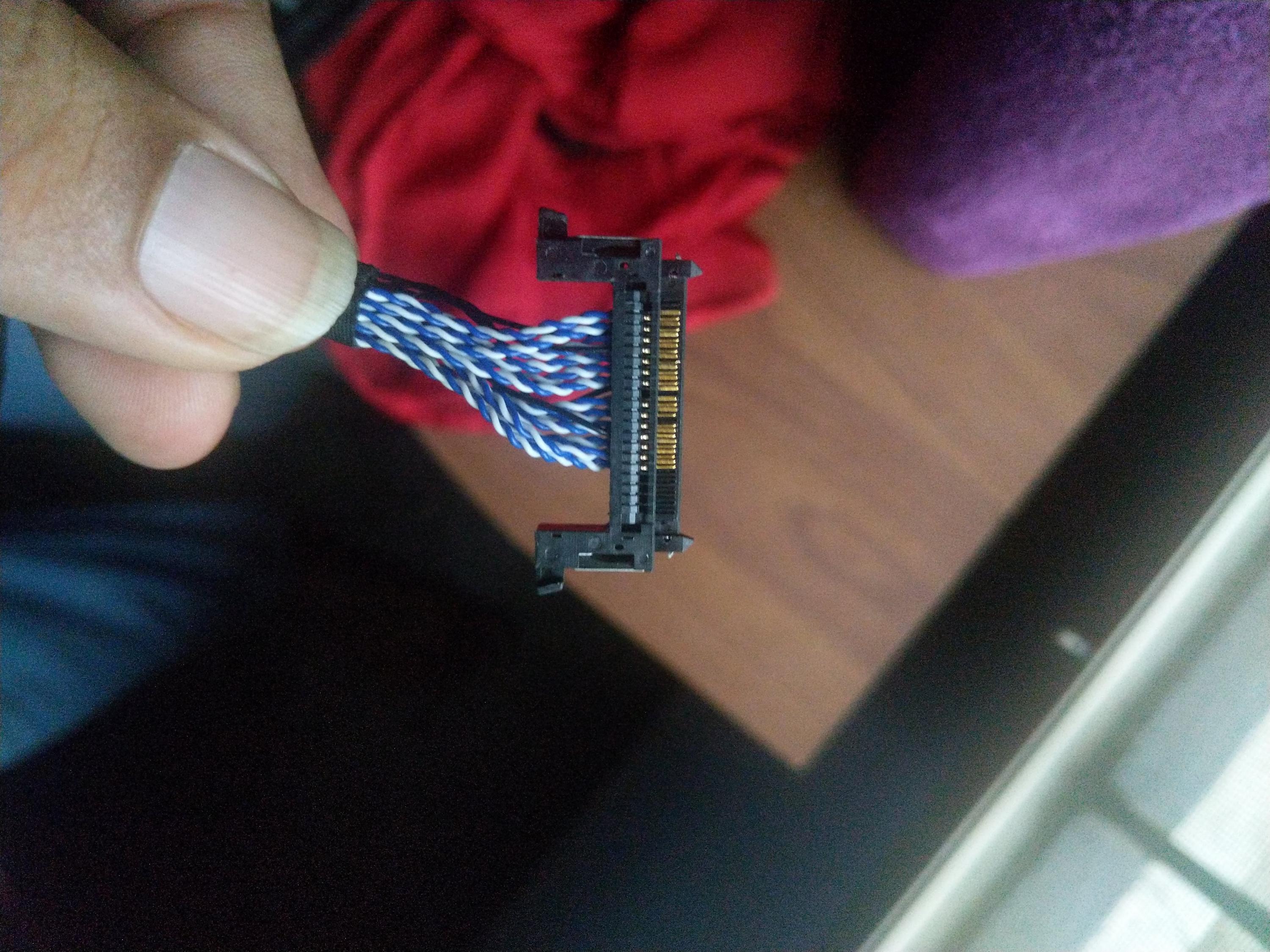

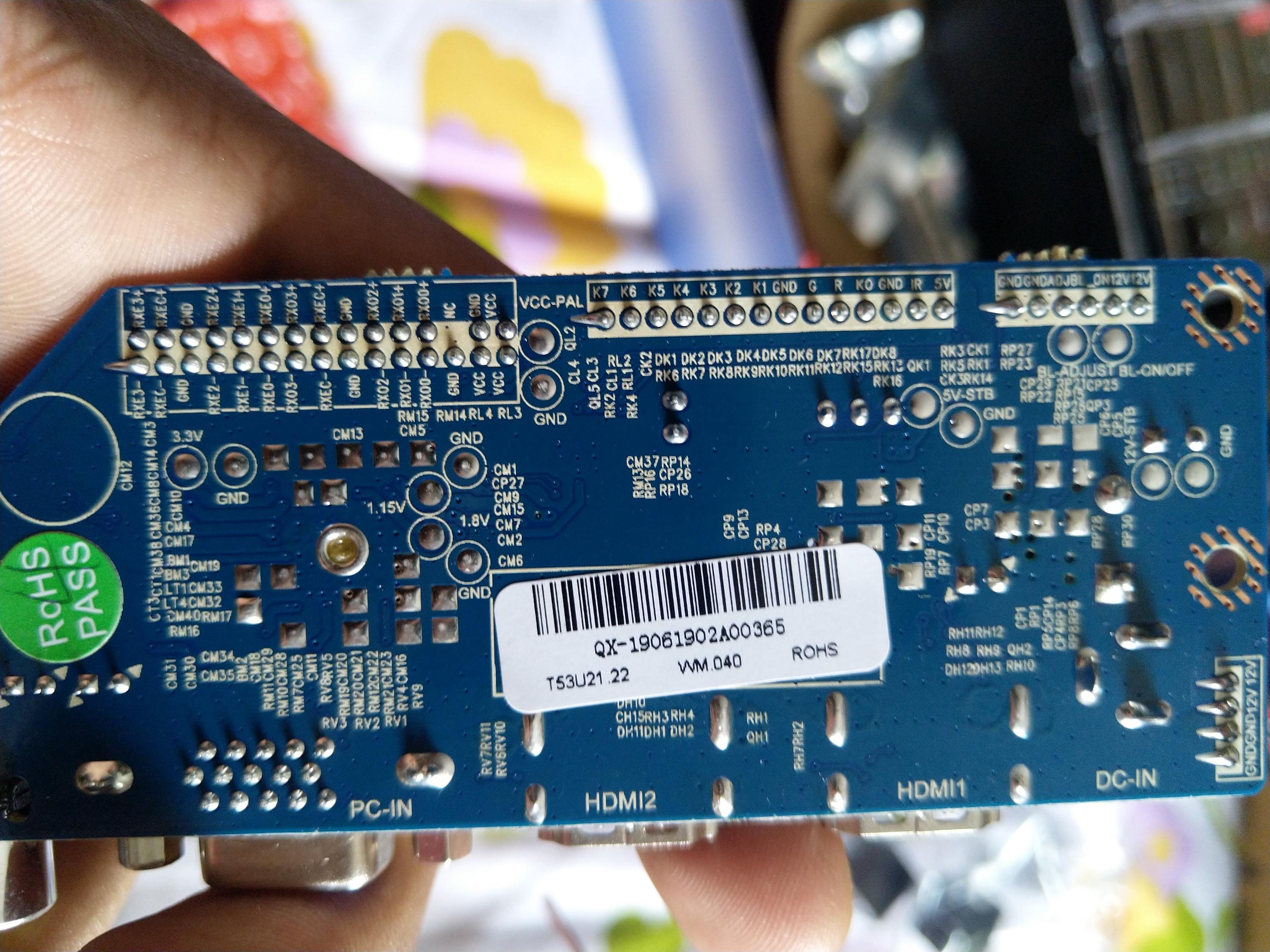

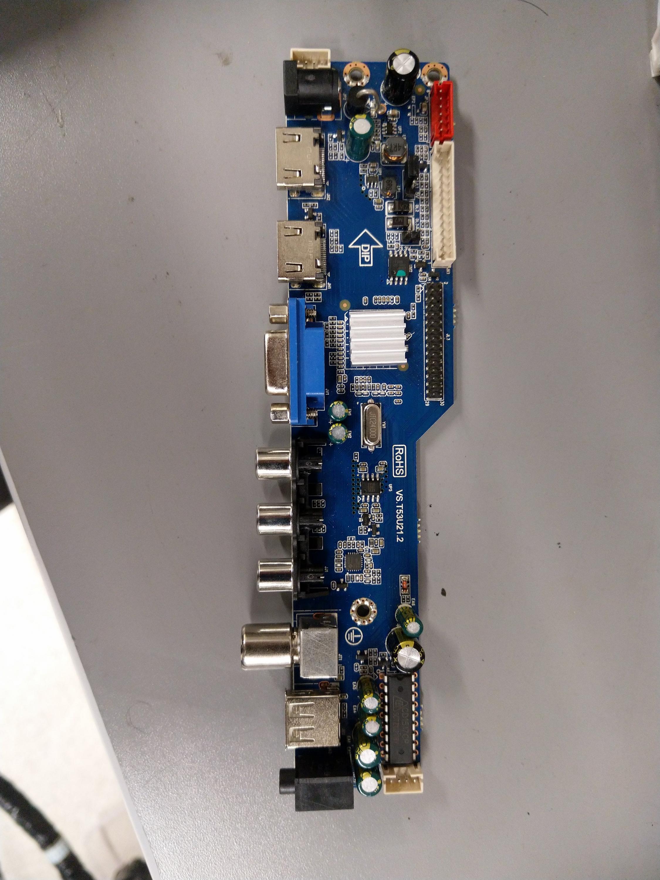

    I have a Sharp LC-46D85UN TV that has had a main board issue. Since this model is from 2009, I am not able to find an exact replacement of the main board. Instead, I decided to see if I can future proof this tv by getting a Universal Main Board (T53U21.2) from China to work with the Sharp TCON (CPWBX4291TPZA) and panel. The universal main board supports a 8 bit dual channel LVDS interface whereas the TCON requires a 10 bit dual channel LVDS input. I have modded the LVDS connector to match 8 bits of LVDS data exactly to the TCON pinout and left the remaining 2 bits floating. I believe this is okay as this should only a cause a minor color issue in my opinion especially with the JEIDA LVDS standard that Sharp TCONs typically use. In this case it is the LSB's that get missed and not the MSBs if the 5th bit from each channel is not connected.
    I have been able to test and program the universal main board by connecting it to an LCD panel that I removed from a laptop. The board works fine in this case. The board itself can be configured to support a 6 bit, 8 bit or 10 bit LVDS interface through the software (although it's pinout does not allow 10 bits)
    I get no picture when I connect the universal main board to the Sharp TCON/Panel. I have been able to work around the backlight issue by driving the inverter board of this TV from a backlight enable signal of this main board. So the backlight is up and running correctly. But no picture whatsover.

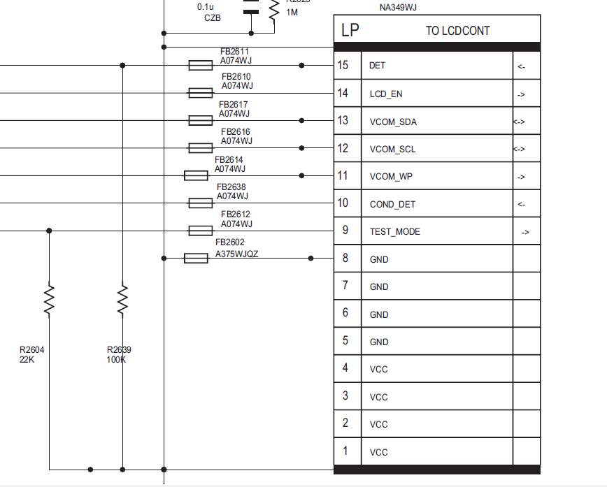

    On the Sharp TCON, there is a 15 pin LP connector that is connected to the main board. This has the following signals.
    Pin # 15 : DET (output from TCON)
    Pin # 14 : LCD_EN (input to TCON)
    Pin # 13: VCOM_SDA (bidi to TCON)
    Pin # 12: VCOM_SCL (bidi to TCON)
    Pin # 11: VCOM_WP (input to TCON)
    Pin # 10: COND_DET (output from TCON)
    Pin # 9: TEST_MODE (input from TCON)
    The rest of the signals are not connected.
    Does anybody know the function of the signals LCD_EN, VCOM_SDA, VCOM_SCL and VCOM_WP? I suspect I am missing some kind of an I2C command to get the TCON working. All analog voltages (3.3 V supply, VCOM etc) all check out okay in the TCON. Like I said earlier, I don't suspect a TCON issue as two TCONs are showing the same no picture symptom.
    How do I kick start the TCON board to start receiving the LVDS signals? Can somebody please who has a Sharp TV respond back if the TV powers up and works normally with a disconnected LP connector? If the LP connector needs to be connected to get a normal picture, I am probably missing some commands from the main board. If I knew what they are, I can possibly try to reproduce the signals using an Arduino based I2C interface.
    I have been under the impression that the LP connector above is needed only for VCOM gamma programming.
    Appreciate any pointers on what the issue is. Also, does anybody know how to get the TCON to produce a test pattern without any inputs from the main board? Do the Sharp TCONs have such a feature?

      I probed the the LP connector with continuity mode, and found that TEST_MODE and COND_DET pins unpopulated and unused.
      According to my research, if the vcom signal is not present, nothing will display on screen. See the following:
