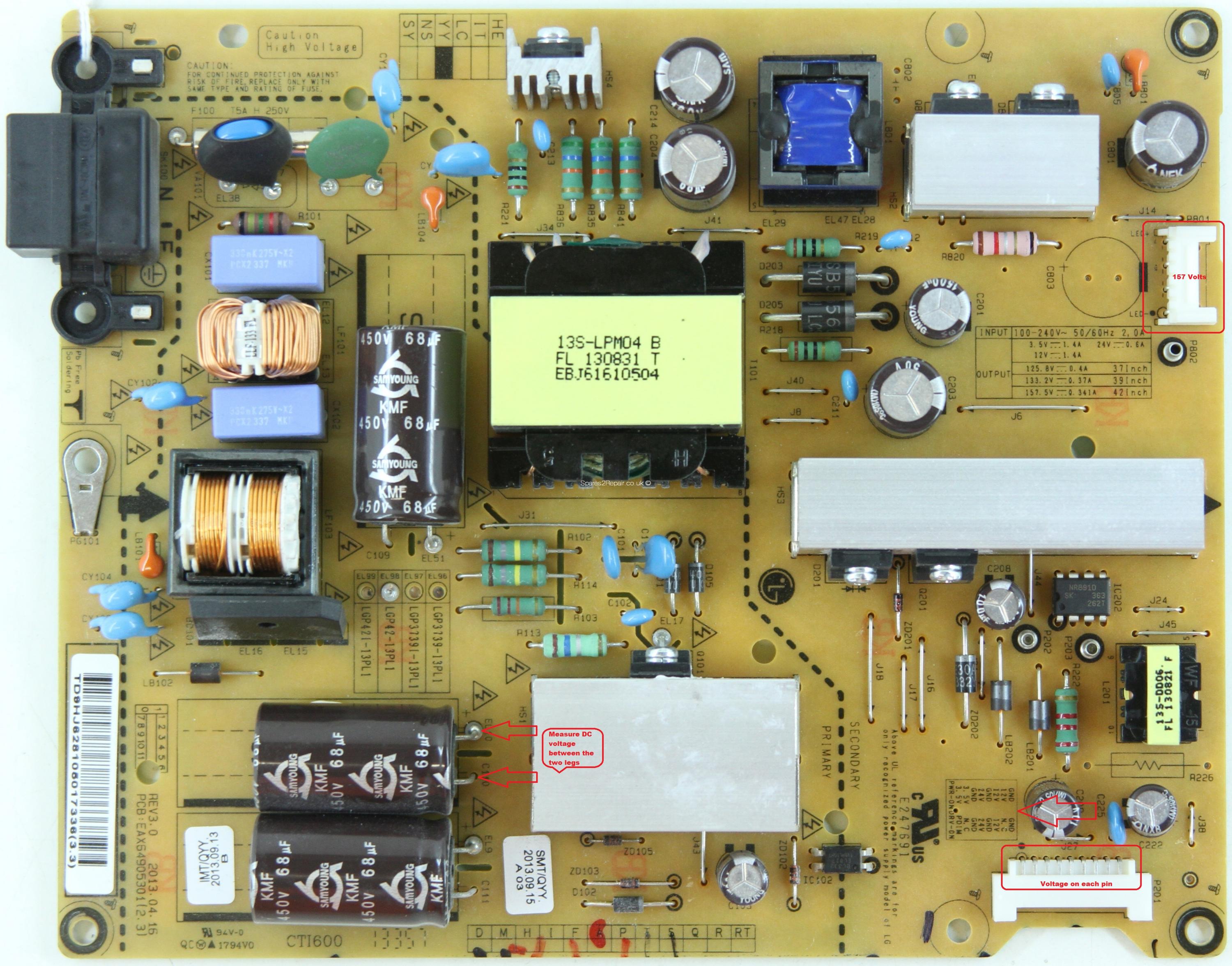

          Re: LG 42LN575V backlight issue.
          Can you also check the following:-
          The DC voltage at the capacitor marked with meter probe on each leg.
          The voltages at the power supply connector to the main board. 18 pins in total.
          The voltage at the led connector.
                    That may be because the leds are powering up and then the voltage is falling because you have a led fault.
                    Have you access to a reasonable multimeter or borrow one preferably with a min/max function.?
                    There a a number of reasons why this could be happening and is why it is important to give voltage readings so the fault can be found.
                    I certainly would not be considering a replacement power board at this time.
                    Can you give the voltage readings on the connector highlighted against what it says it should be on the legend alongside.

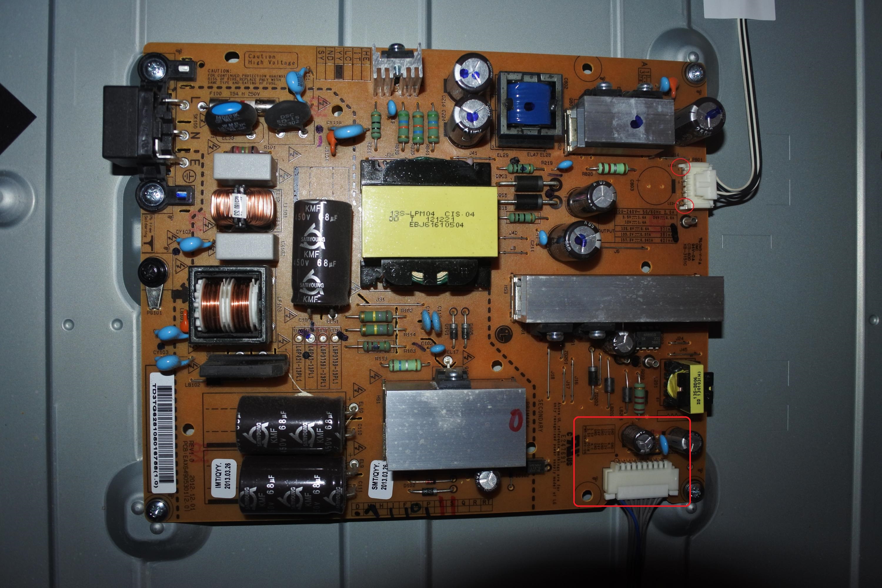

                            The meter in the photo is currently set to 600V DC. You can leave it set there to measure the voltage between the two capacitor legs. As photo in post#5, black meter probe on one leg of capacitor and red meter probe on the other leg of capacitor. This is high voltage so be careful when using the probes to make the measurement.
                            To measure the led voltages at connector P801 you can leave the meter set to where it is and use the red meter lead to measure the voltage at the connector pins and black meter lead connected to the panel chassis. I suspect the voltage will rise to a high voltage when you switch on and fall quickly.
                            To measure the voltages on P201 you can rotate the meter dial anticlockwise to 20V DC. Red meter lead to measure, black lead to chassis.
                            For all measurement black meter lead is connected to COM and red meter lead is connected to V Ω mA

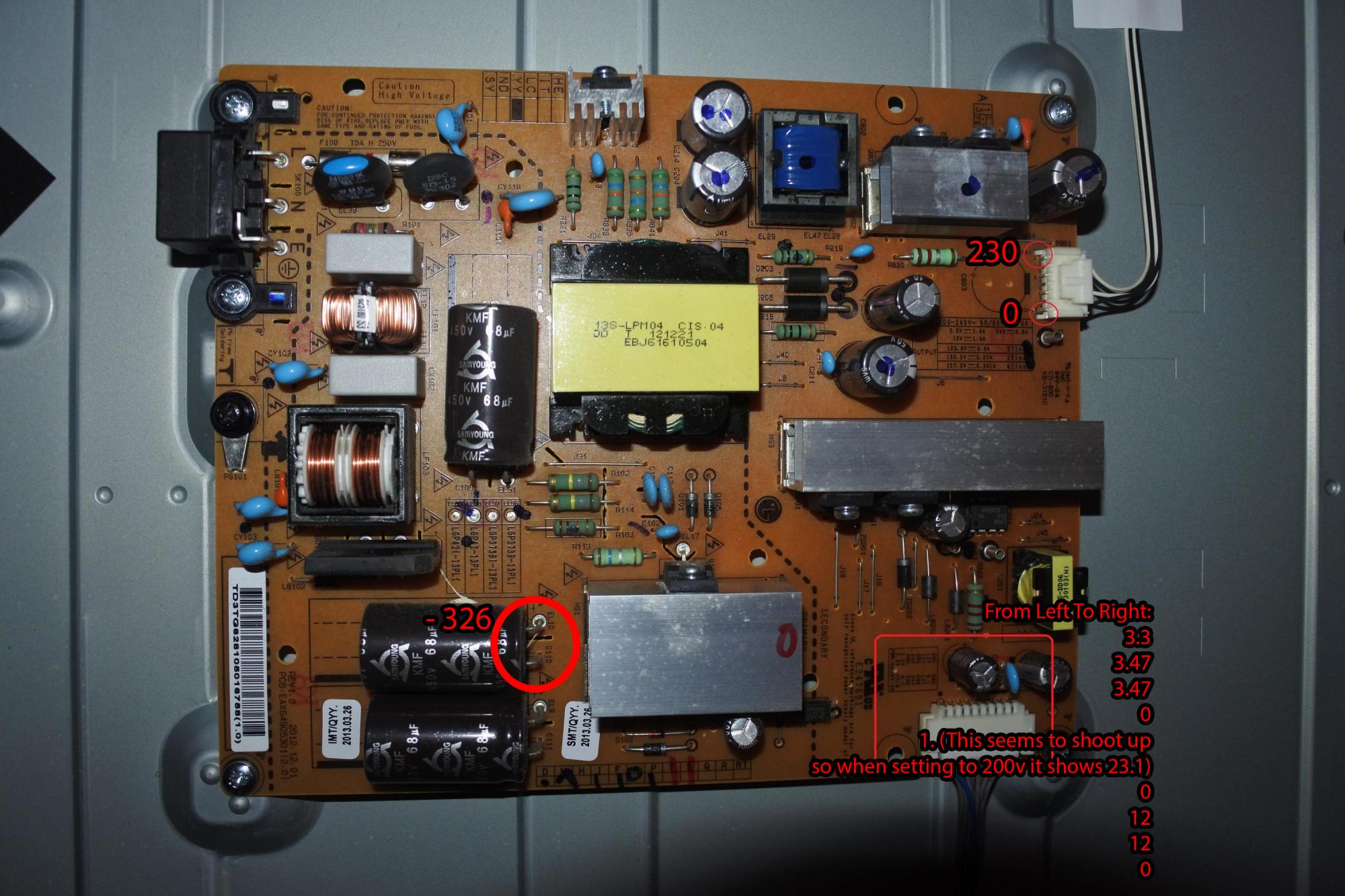

                                    Thanks guys, really appreciate the detailed responses and thank you for putting up with my total lack of knowledge.
                                    I did what you said (as best as I could) and got the attached readings.
                                    All readings are when the TV is on and not on standby.
                                      there should be 18 voltage readings on that connector as has two rows of pins
                                        All the voltages on P201 look fine but you have only read one row of the two rows of pins.
                                        You need to also give DRV_ON & PDIM.
                                        Also the top pin of P801 is given as 230V. Does that remain steady or fall and what DC voltages were on the next two pins.
