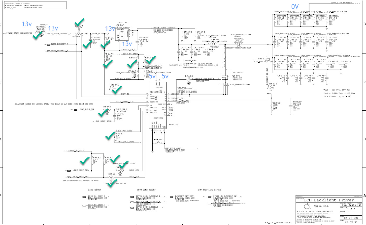

    Please find below few informations which can help for the analysis :
    - I attached all ok component with few measurements
    -There is no short to ground on the output line with & without the screen connected .
    -I know the screen backlight is good because I tested it with another MB .
    -I tried to manually ground the SD line and it gave me 12v on the backlight output PPVOUT_S0_LCDBKLT.So the Q8400 is working fine .
    -I measured EDP BKLT EN : 3.3v (HIGH ?)
    -I measured BKLT SCL & SDA : around 3.3 v ( so communication is working ? )
    - I changed the U8400 but still no change.

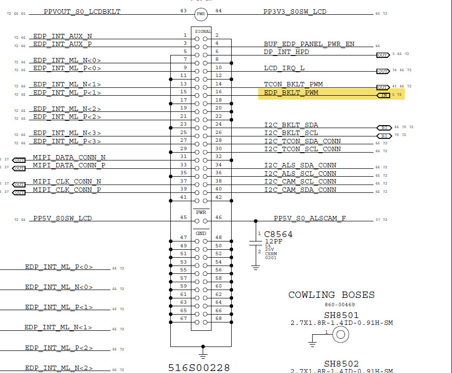

    I read a post that the BKLT_PWM could be the issue but I don't really know how it works . One other backlight IC , I saw PWM input . On LP8548 , it's not the case . I only see that BKLT PWM KEYB but I assume it's for the keyboard . And this one is working .
    On rossman video , he talked about bypassing the PWM control which will result to a maximum brightness all the time but it's ok for me if I can get that .
    He did it by injecting the expedted voltage on the PWM input of the backlight IC . But since there is no PWM input on the A1708 I don't know how can I do it .
    I saw that the PWM is generated by the U0500 whic is the CPU ?
    And then go to the J8500 on the TCON board . Can I send 3.3v on the pin 16 of the J8500 with a jump wire ?

          If the EDP_BKLT_PWM is the issue , do you think forcing this signal to be at 3.3v or 5v will enable the backlight circuit ?
          As on this video :
          https://youtu.be/gC_mixwqLHI
          • mon2
            • Dec 2019
            • 14664
            Re: MacBook A1708 820-00840-A backlight issue
            In theory, yes but concern is that the model of your logic board does not appear to have a current limit resistor between the source and target (display).
            That is, your original source for the PWM signal is driving a logic low = 0 volts.
            But for the fix, you plan to assert a hard wired 3v3 from a local power rail.
            That is 2 outputs fighting out the signal levels.
            The hack from the YT / Louis' fix, had a 33 ohm resistor in series which limits the current by the original driver.
            If you really wish to attempt this fix, trace the PCB trace that is linked to the PWM line. Then with a sharp cutter, cut the trace. Plan to do it in a location where the same PCB trace can be repaired if required.
            After the trace is cut, then apply the 3v3 onto the LCD side of the (PWM) cut trace for testing.

              So I finally measured the voltage that you asked .
              1) check the voltage to ground of LID_OPEN. This signal may be ok since you have EDP_BKLT_EN = '1' (high)
              LID OPEN = 3.4 v
              And EDP_BKLT_EN = 3.3v
              2) check the voltage to ground of BKLT_EN_R to be sure this same enable status is reaching the IC. Do check the backlight IC for any possible corrosion.
              BKLT_EN_R = 3.3v
              No corrosion seen .
              3) What is the voltage to ground @ pin #16 of J8500 ?
              I wasn't able to measure it with the macbook turned on because it's on the other side but MB out with screen connected , and charger connected I read
              EDP_BKLT_PWM = 2V
              TCON_BKLT_PWM = 2V
              This macbook is strange ... I all input seems to be good ..
              I hope we'll find the issue .

                        But right now what I cannot undestand is that why I have 12v on source and gate of the Q8400. The votage divider isn't working because the IC doesn't short it(SD) to ground. Why ? I don't know ...
                        What is sure is that Q8409 is good because when I manually shorted the SD line, It allow the 12v to go from source to drain and on the gate I measured 5.7v
                        Last edited by Riananyaina; 04-24-2023, 04:27 PM. Reason: Error and additional information.

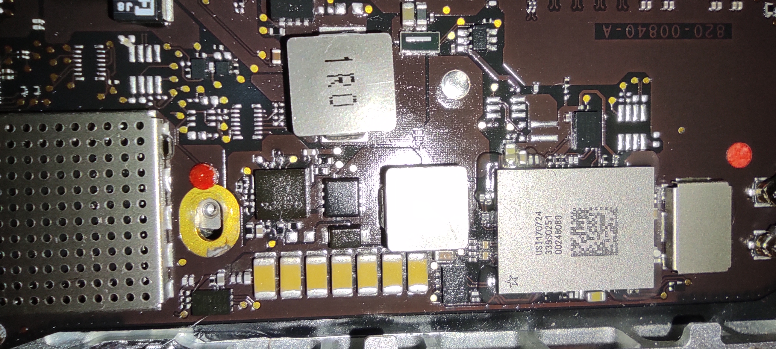

                          I think you have replaced this backlight IC ?
                          Consider to flux and reflow this part but protect the tiny parts in the region with kapton tape. Use low air pressure.
                          Keep heat away from the LCD!!!!
                          Any possibility of missing parts in this area?
                          Post pics if you can. Be sure the enable pin is reaching the backlight IC as well as the I2C lines.

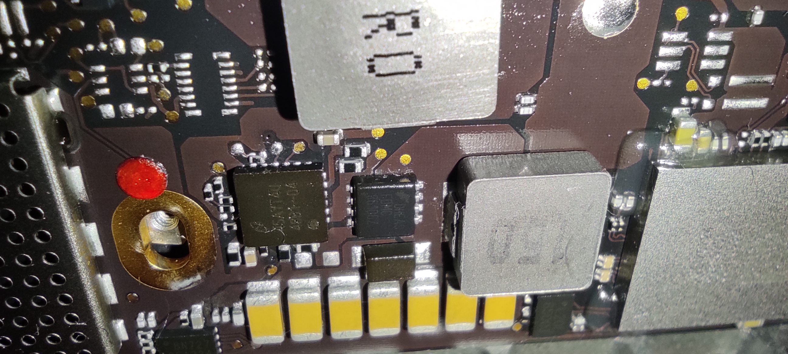

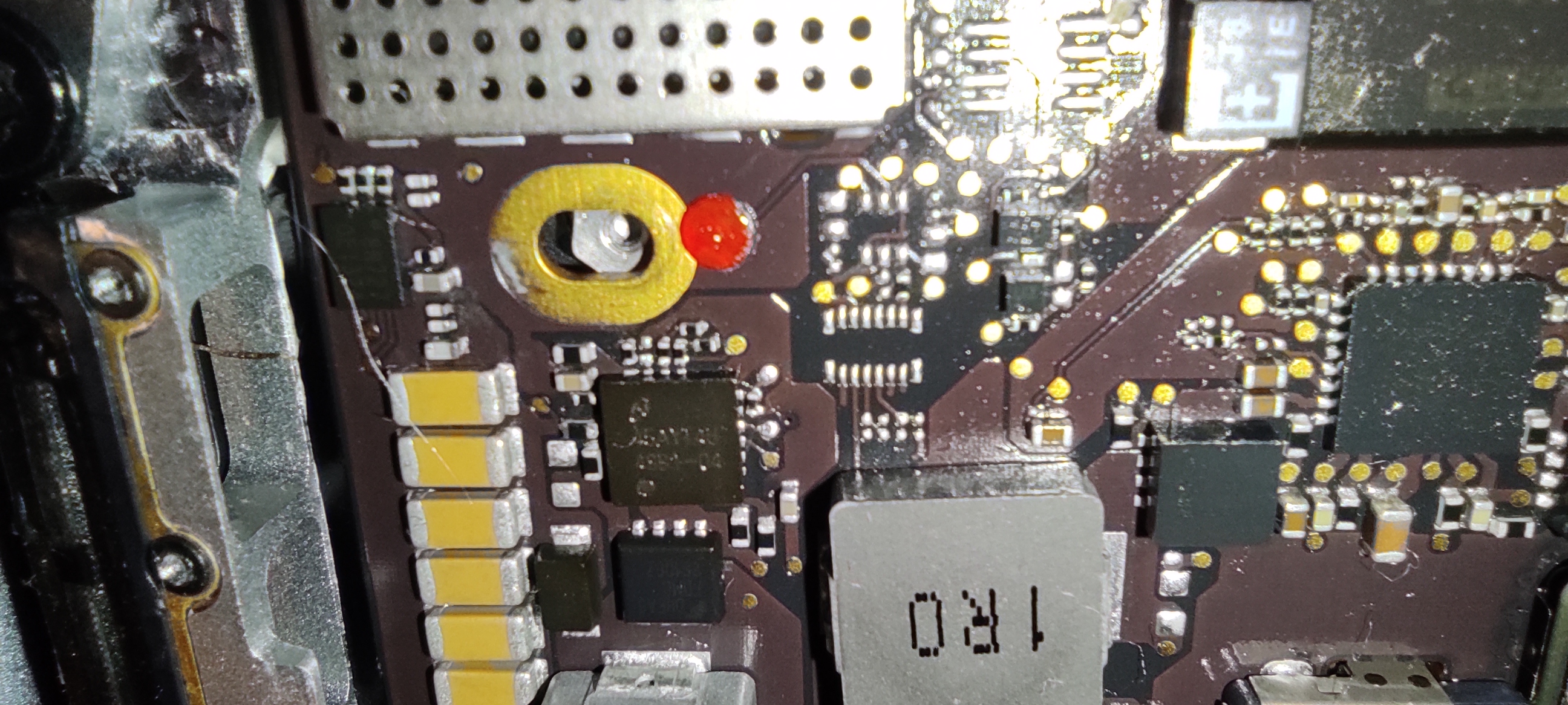

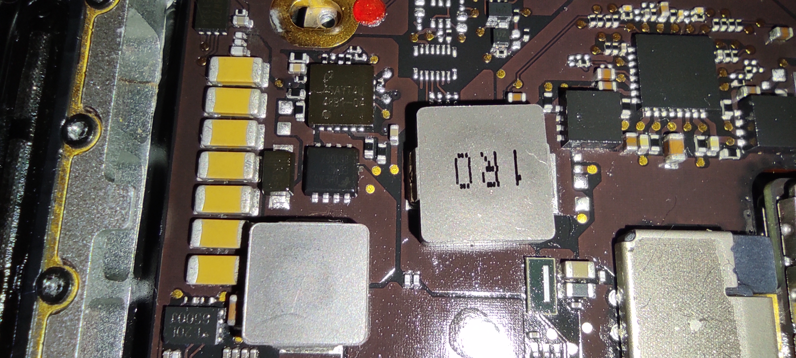

                          • Riananyaina
                            • Mar 2023
                            • 12
                            • France
                            Yes indeed I replaced the backlight IC.
                            Do you think , I'll need to replace it again?I'll need to find a new one.
                            I checked everything around but I didn't found any missing parts.
                            Please find attached some pictures. I hope you can see well.
                            • mon2
                              • Dec 2019
                              • 14664
                              The 3rd pic shows the component to be at an angle.
                              Recommend to apply flux and low heat on the top surface in circles.
                              Keep up the heat around the perimeter of the device till the solder melts. When it does the ic will self align onto the pcb pads. If required, increase the air pressure but be sure the other parts do not go flying. Topside air will melt the solder pads and underside metal belly to align the mount.
                              Then test again.

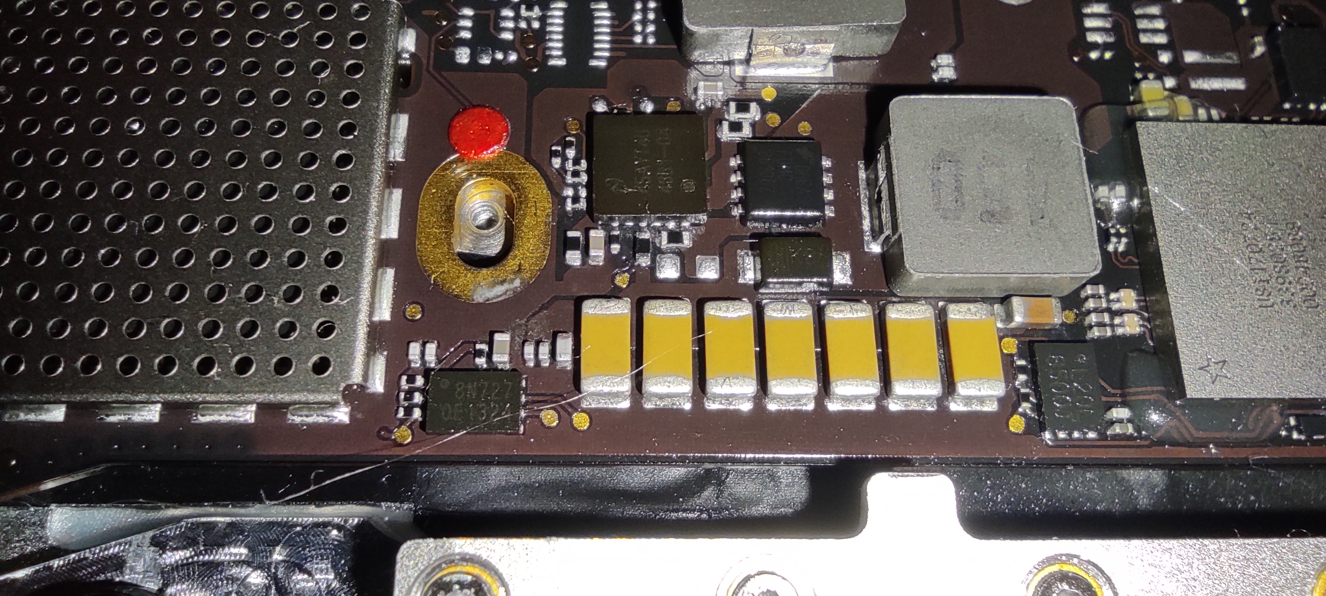

                                Hello , so I did solder it back and as you said it aligned itself onto the pad now .
                                Unfortunately still no backlight .
                                I'm thinking maybe the IC that i bought might be bad ?
                                I'll find another one .
                                After measuring almost all the board , I couldn't find any bad area . All input seems to be good . So the remaining component which could be bad is the IC .... .

                                      Hello mon2 ,
                                      Thank you for the explanation above .
                                      I was a bit despoerate for me macbook case but yesterday I discover that on Logowiki there was diode measurement value of good board . And after doing this I found 2 strange points . I hope you can highlight me .
                                      I strarted from there :
                                      https://logi.wiki/index.php/MacBook_...500_Edited.jpg
                                      On the pin 24 I found 1100 instead of 512 which is almost the double . Is this value telling us something ?
                                      On the pin 43 which is the backlight circuit output normally , I found OL . If we have open line do youthink that the backlight circuit can detect it and decide to not send voltage ?
                                      Many thanks in advance for your help .
