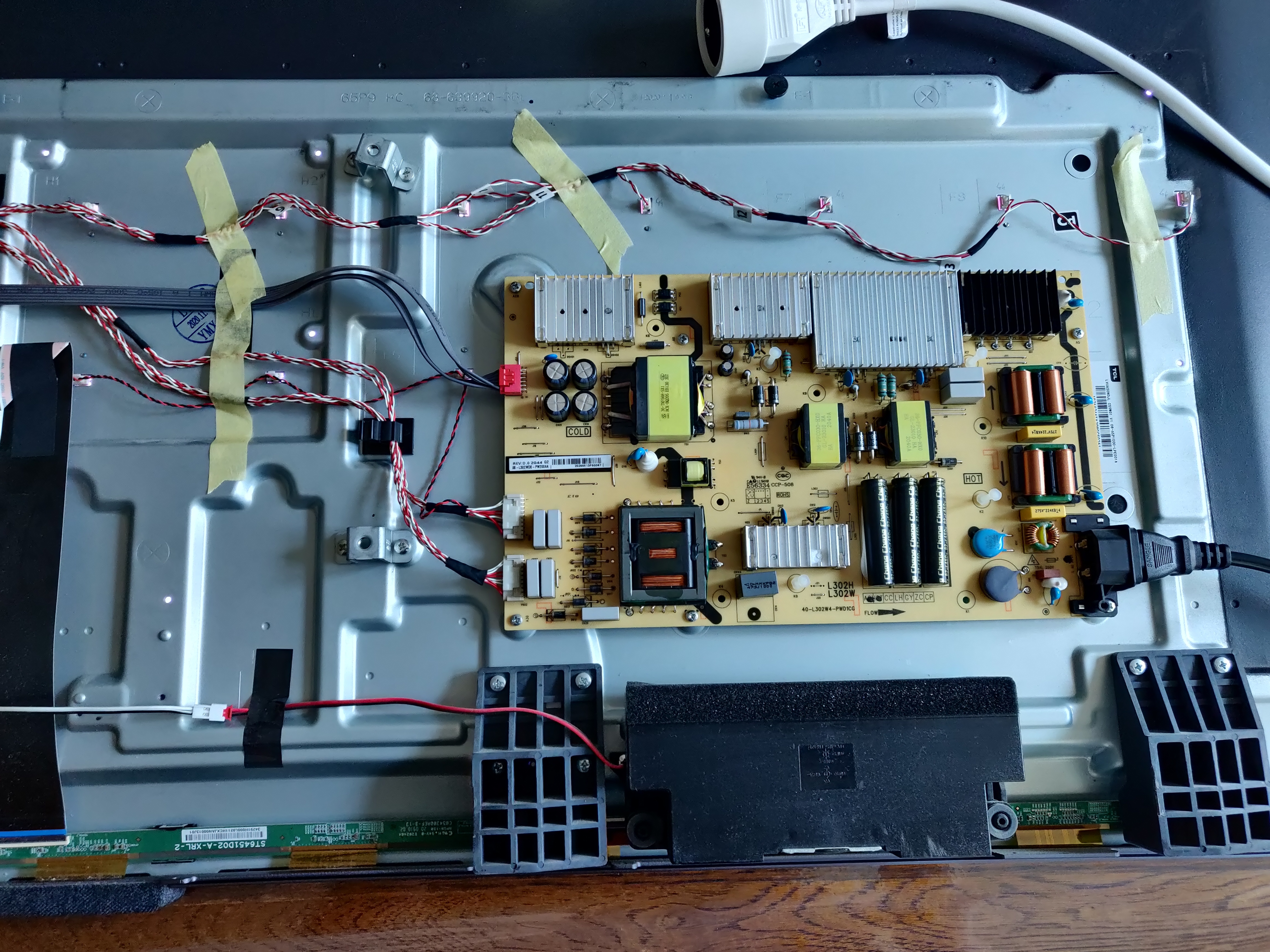

    Hello team,
    I'm back with another topic.
    It's a 65C715 TCL tv with backlight issue.
    But the problem is a bit strange.
    When I took this tv from the marketplace backlight didn't work but picture was ok.
    Back at home I checked with led tester if led are alive and I can find something different in term of voltage supply => nothing
    Putting all back together the tv worked fine for weeks. => Contact issue??
    Few moment later the tv has started to have backlight issue back, turning off and on worked sometimes and tv was working.
    Then one day nothing.
    Reading other threads I've seen that the C614 may be faulty even if not really visible.
    I replaced it and tv was back to life for couple of days, then same issue.
    Same maybe not really, the backlight flashs at strating up the tv, I've didn't noticed that before.
    Ok putting apart another time the tv, I checked the PSU voltages, seems that PSU does into protection mode because a small time I can read a voltage before it drops to 0.
    checked all led strips by the back connector, nothing special, all voltages are the same, 43V on outer strips and 33V on inner strips, the ones with two connectors.
    So, as nothing was noticed, I've checked functionality and tv works well since.
    As the tv is glued I'd like to avoid useless LCD panel removal to check led 1 by 1.
    Do you have any idea of what can be the problem?
    Do you know what is the part number for led strips, I can't find it online. I'd like to get new ones if needed before removing the glued LCD panel.
    Thank you in advance

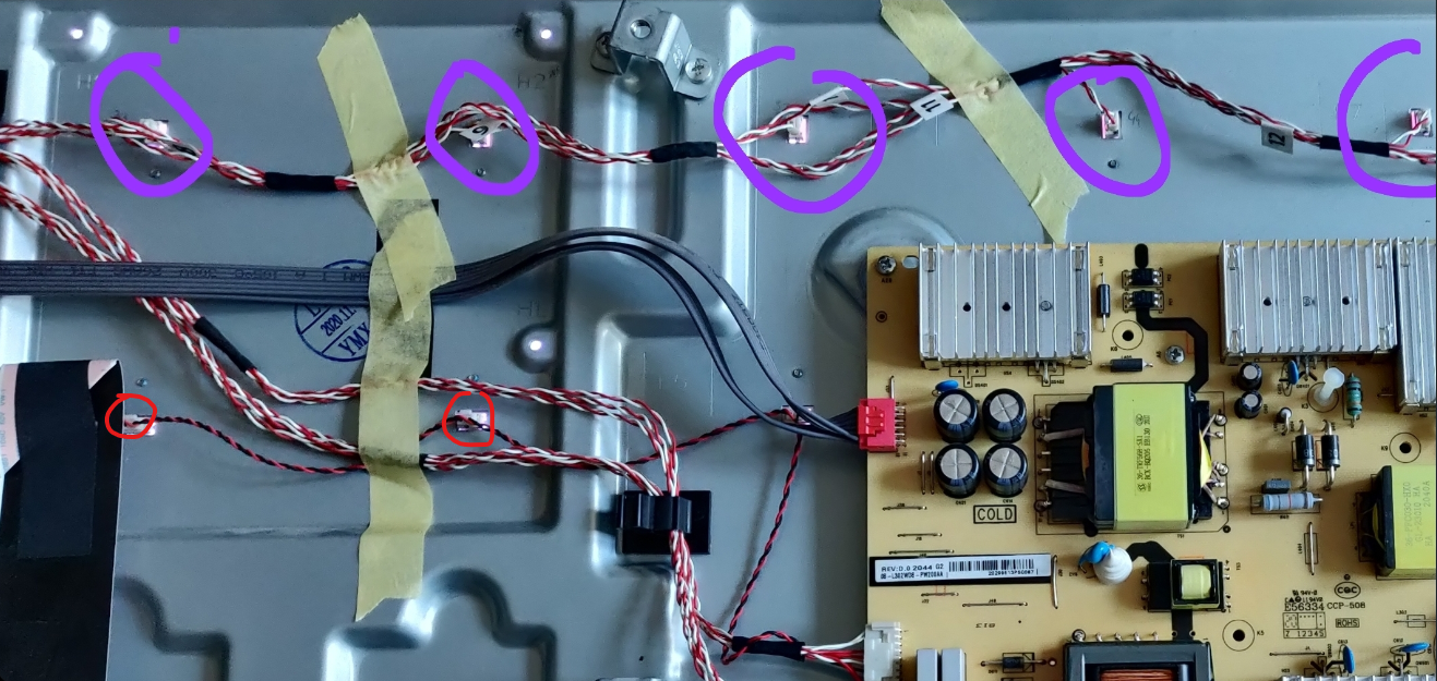

                  • Cornito
                    • Jan 2024
                    • 93
                    • France
                    Hi EazyBone,

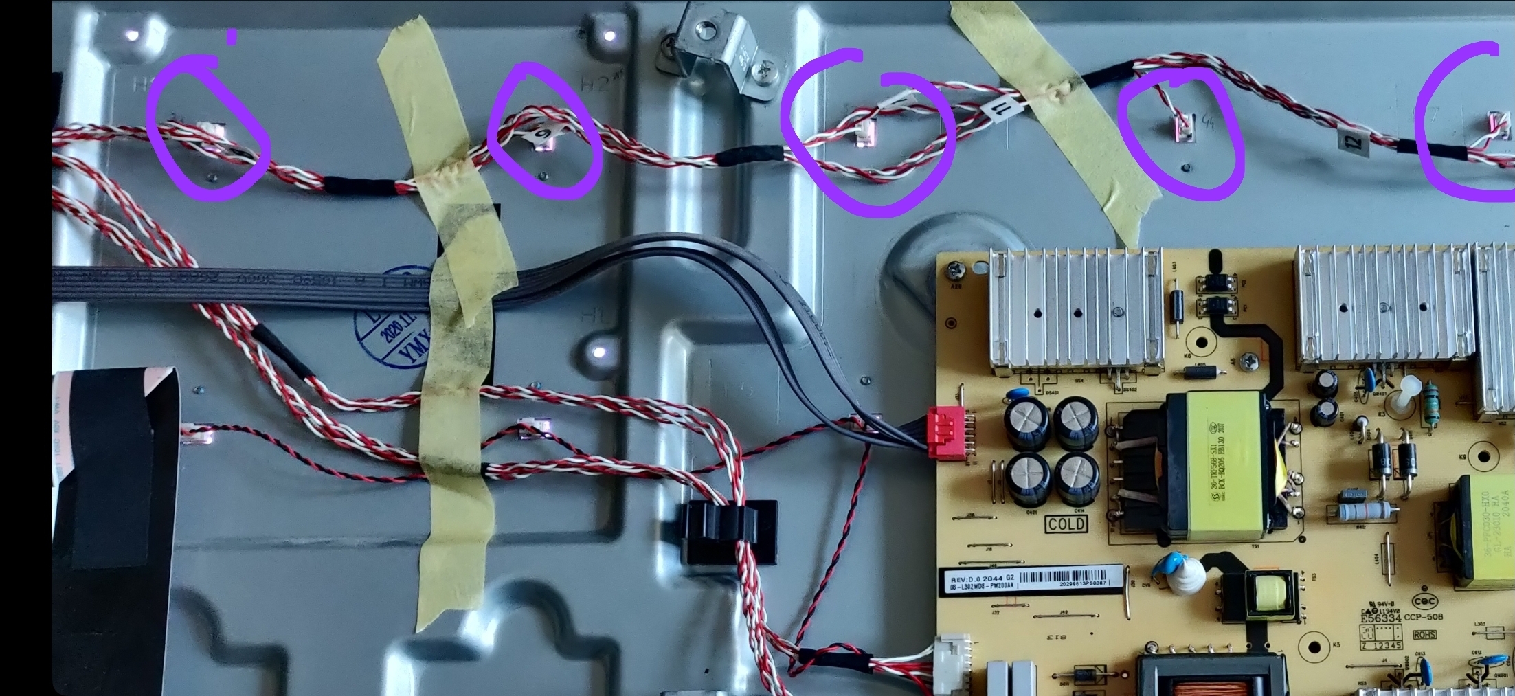

                    To clarify a bit what I said, the "bottom" connector are the one in the red circles.
                    These connectors exist only on the 6 middle strips.
                    There are 14 strips in the whole TV, 8 without the middle or bottom connector, 6 with.
                    Or maybe there are 20 lines at the end 8 with 43V 6 with 33V, 6 with ?? (i didn't measure the voltage on the middle connector)

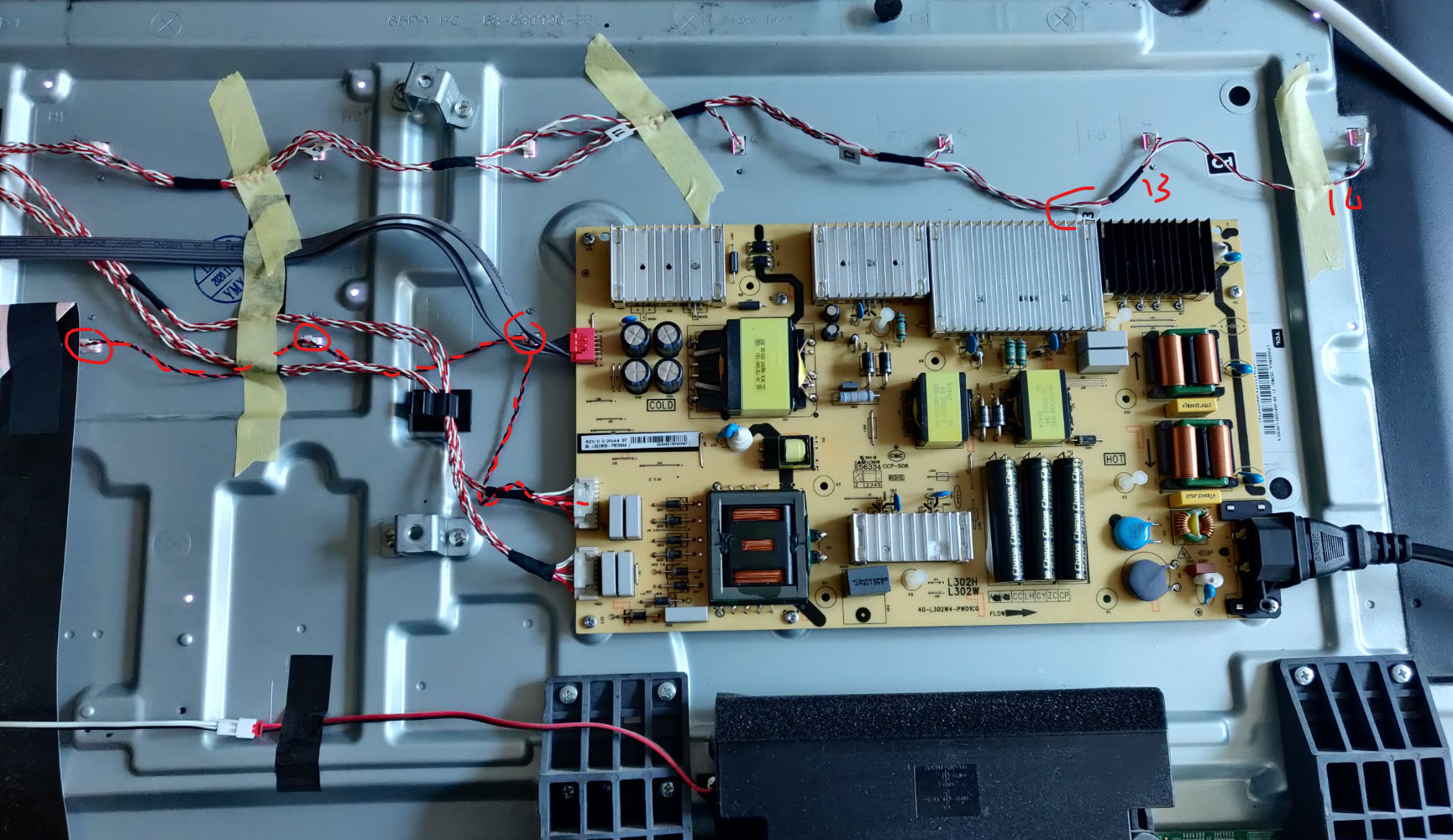

                      Hello back,
                      So tv was working fine until another backlight issue.
                      It seems that PSU goes in protection mode, but why ?
                      It's a pitty that led strips seems not fixable, because of non availability and glued screen.
                      Any idea ?

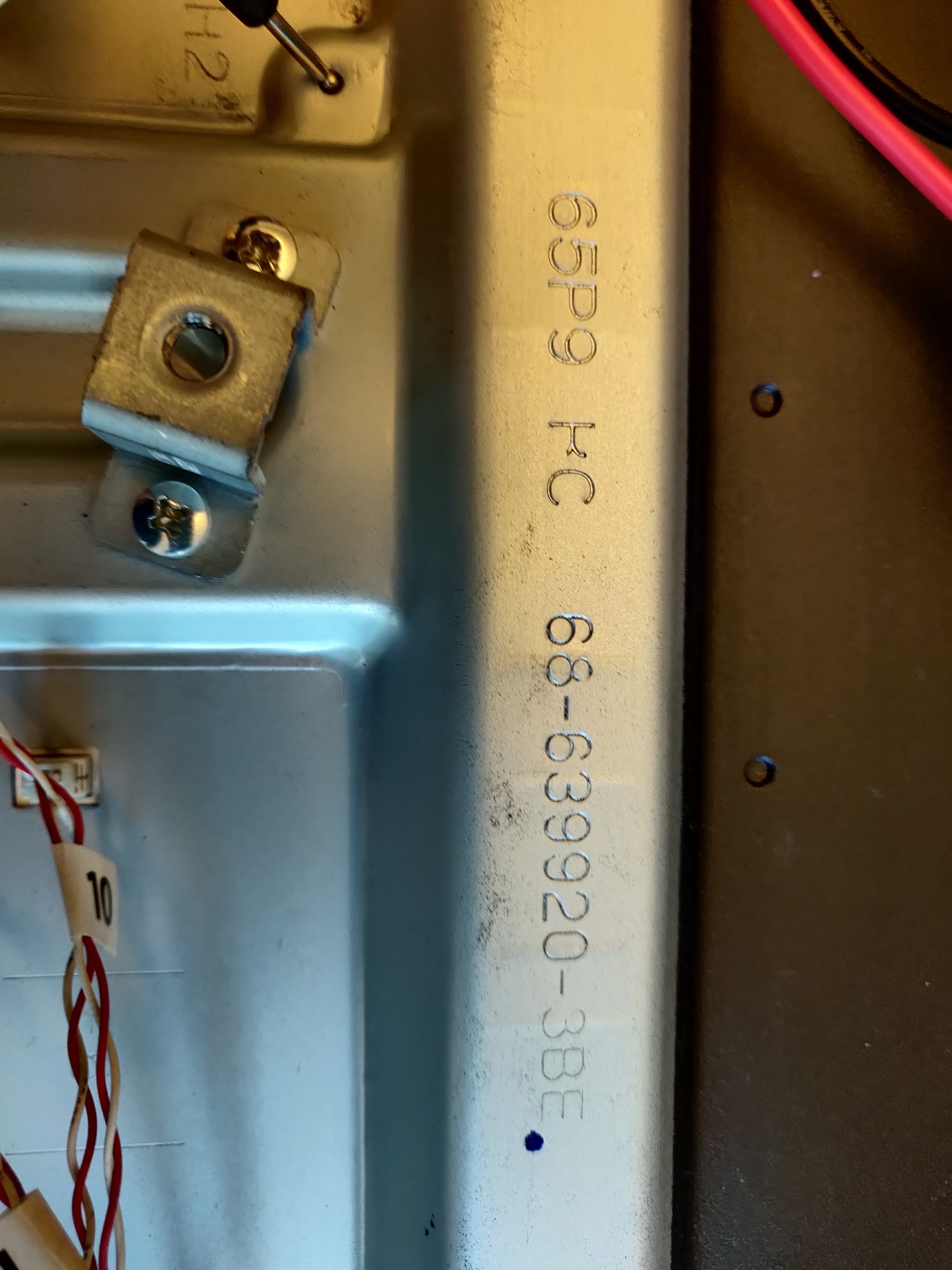

                                Finally it seems i found the LED part number: GIC65LB100_3030F2.1D_V0.7_20200108
                                Found these on AliExpress :
                                https://fr.aliexpress.com/item/10050...|query_from%3A
                                On pictures i can now understand why i've got so many connector and same not at the same height on the same led strip.
                                I hope this can help somebody,​

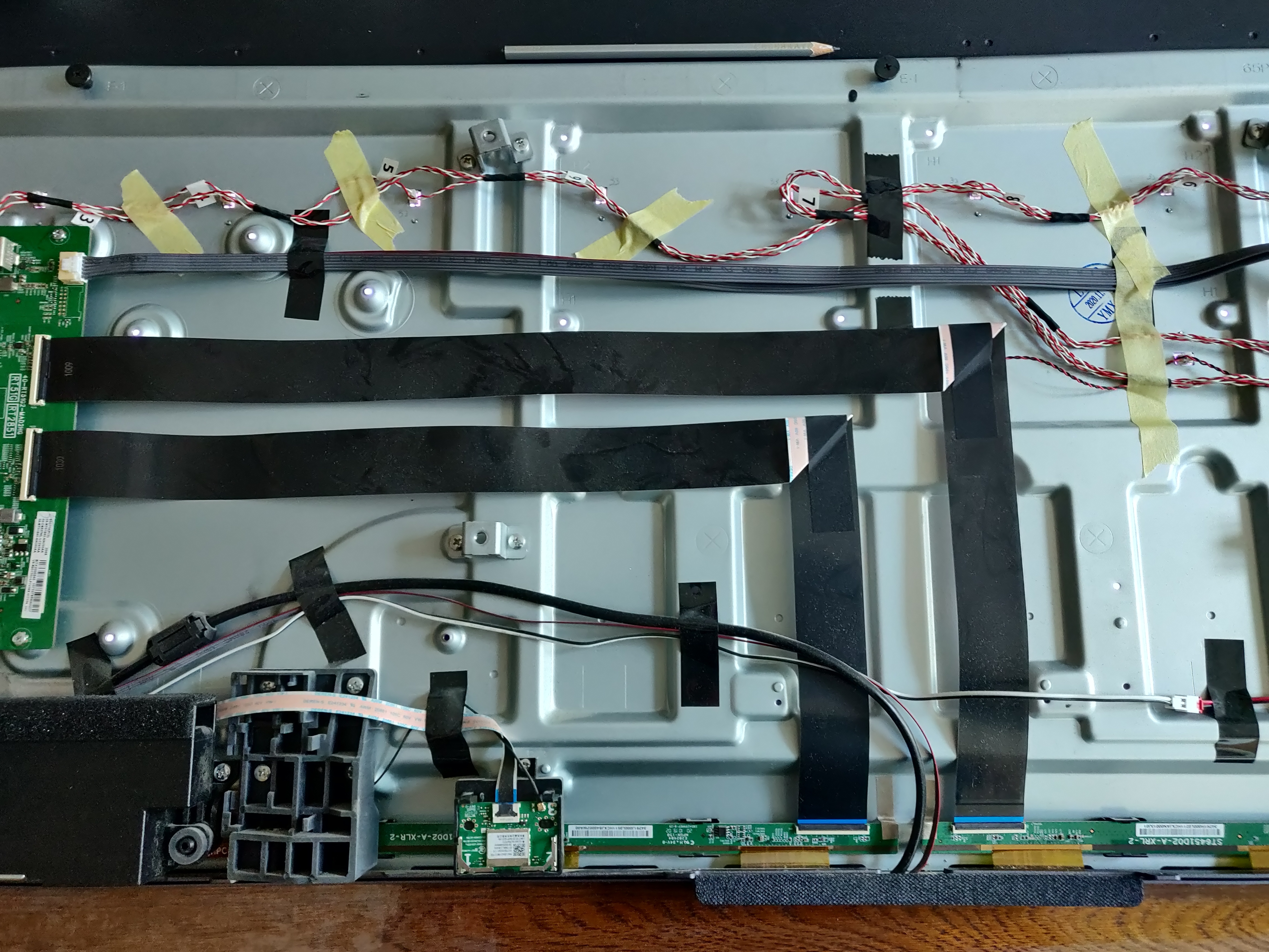

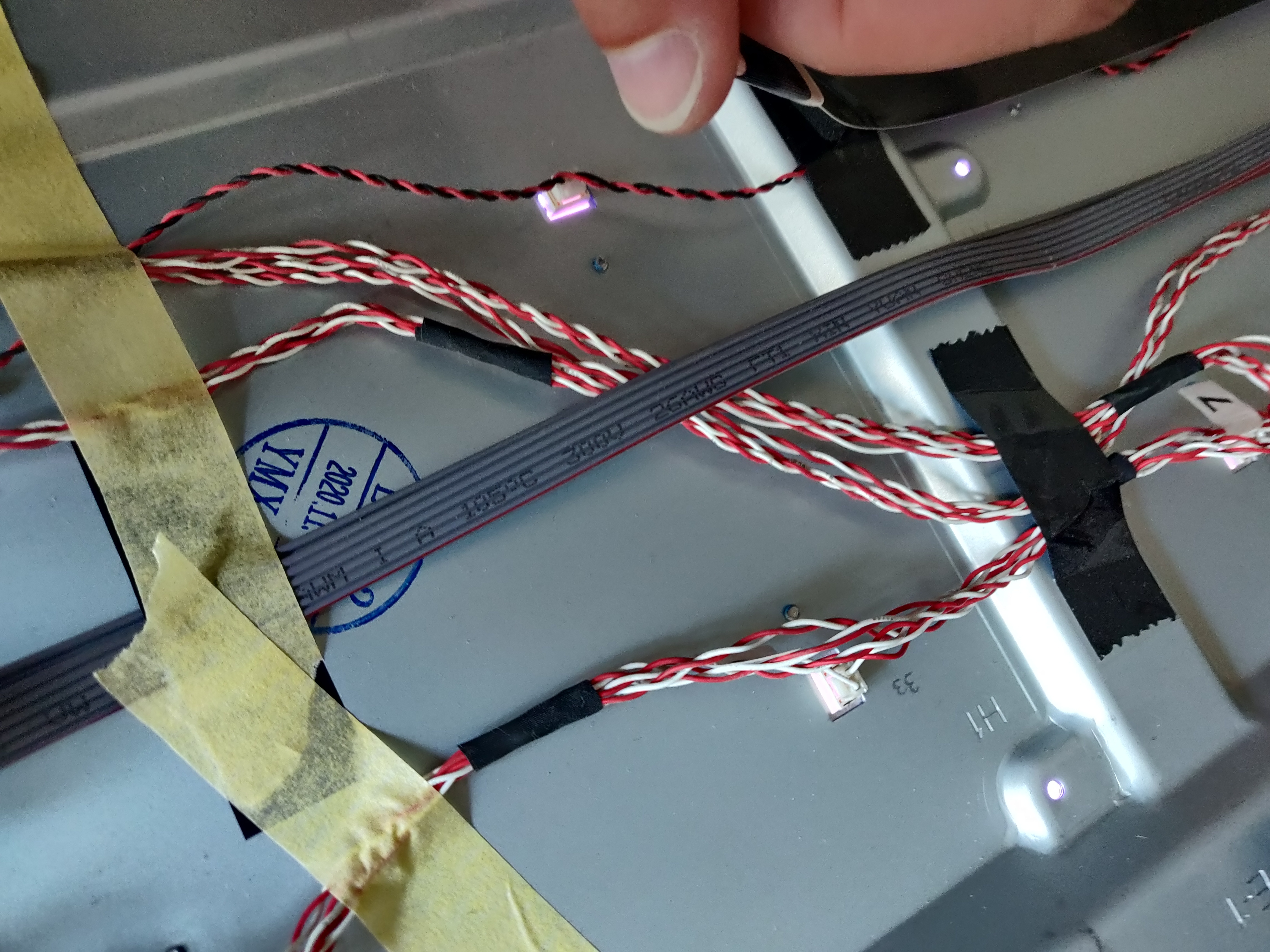

                                  Hello guys,
                                  Back from the battlefield, in order to try to find out which LED strip is defective, I've used my LED tester.
                                  Nothing seems really strange; all lines work perfectly with the same voltage requirement.
                                  As with each time I test the LED strips, when I plug the TV back in, everything works well.
                                  It seems like LED strips need to be unlocked before being able to let the PSU start correctly.
                                  Furthermore, I can see the LED flash when the backlight is defective.
                                  So it seems that it's an LED strip defect, even if I'm not able to find which one is causing the problem.
                                  Any thoughts?
