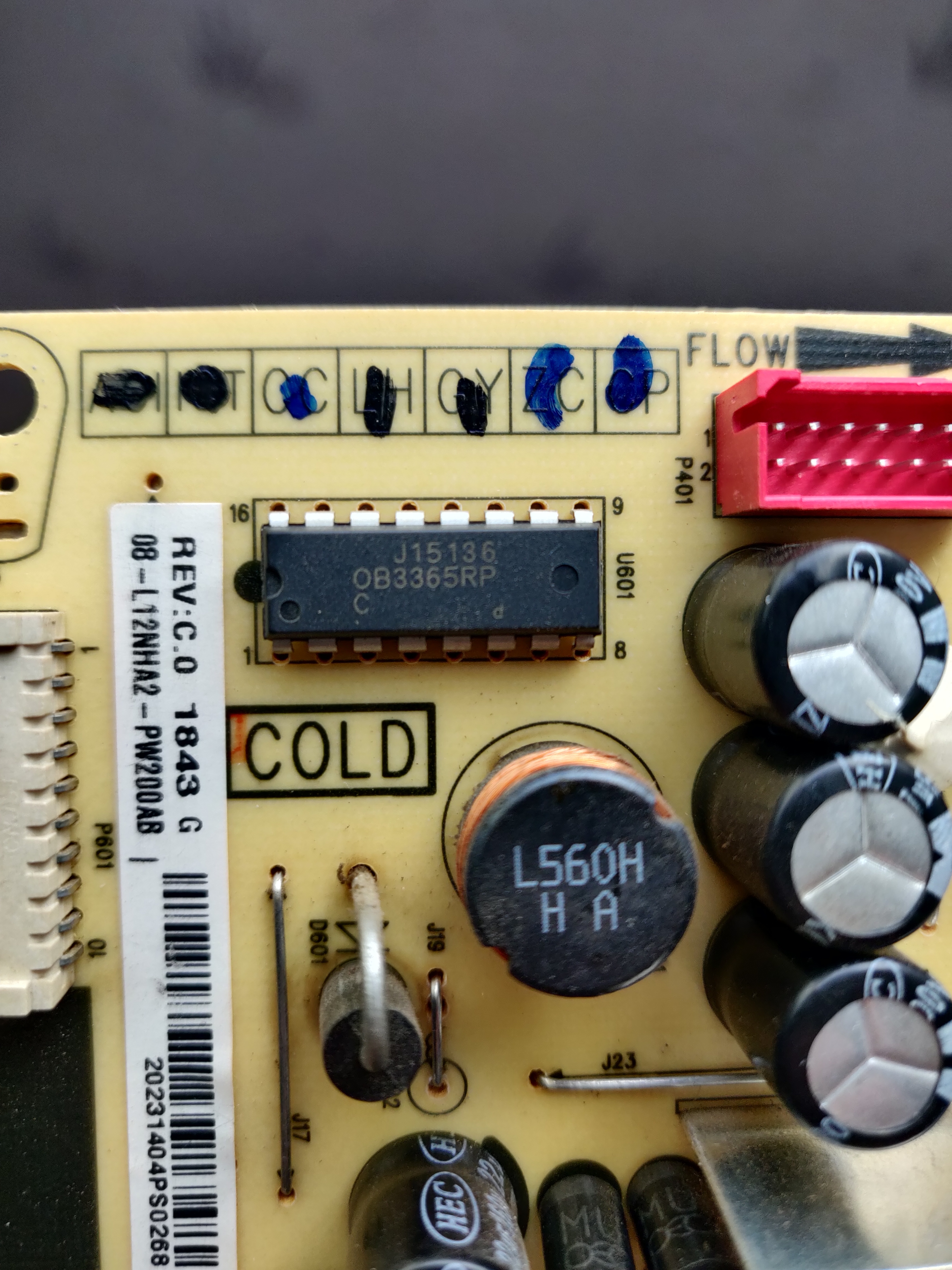

    Next, I replaced the electrolytic capacitors attached to the LED power supply, but the results were the same. I then replaced the driver, a OB3365RP, and did it twice due to the same result.

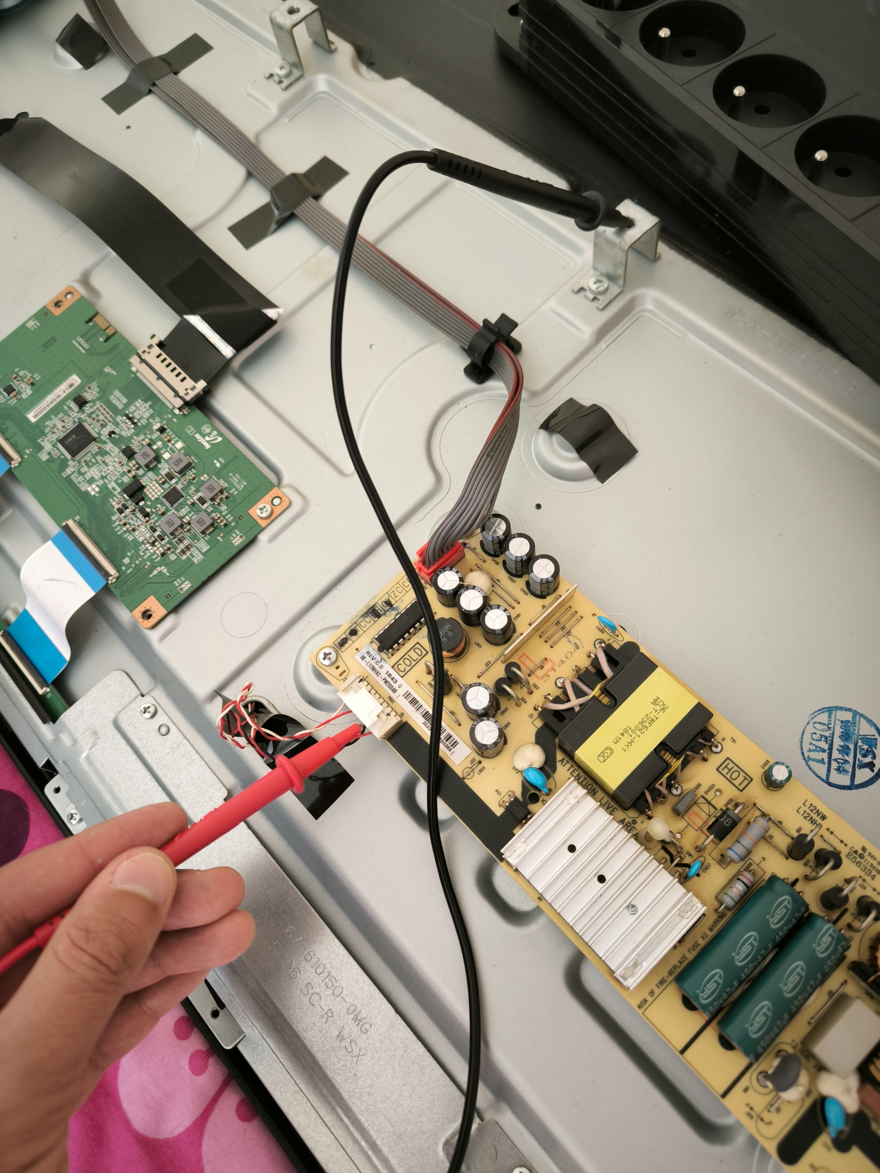

    Using an LED tester, everything seems good, with 73.5V per line (2 lines on this TV). The power supply delivers around 83V per line, but there is no backlight, or just a brief backlight at startup for about 1 second.
    The only way to have a kind of working backlight is to use my multimeter in resistor mode and test between the return of the LED and the chassis.

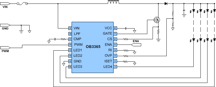

    The LEDs are current controlled, not voltage controlled. The OBwhatever number IC is detecting a fault somehow and turning the backlights off. Download the data sheet and it will tell you how it works and what voltage range you need to see on what pin. I would start with the enable, ovp / uvp and the current sense pins.

      Hello Capleaker, thank you for the advice.
      Do you know where i can find the data sheet with correct level of detail ?
      I'll need to change the pull up resistor to correct this protection ?

        Look at alldatasheet.com OB3362RP from On Bright.
        i think it is a OB3362F datasheet, but that doesn’t matter much, just different casing still 16pin

          ???... there's no minimal reason that it can reach 400v on hot side with no PFC present.. sounds like a joke...maybe a joke of your MM

            this tell you have one SMT R open / or changed Value at the BL circuit, the SMT R are located at the downside of the Power Boards

              Combining the advice received, the potential root cause may be a faulty resistor in the protection circuit. This is linked to pin 3 according to the TDS.

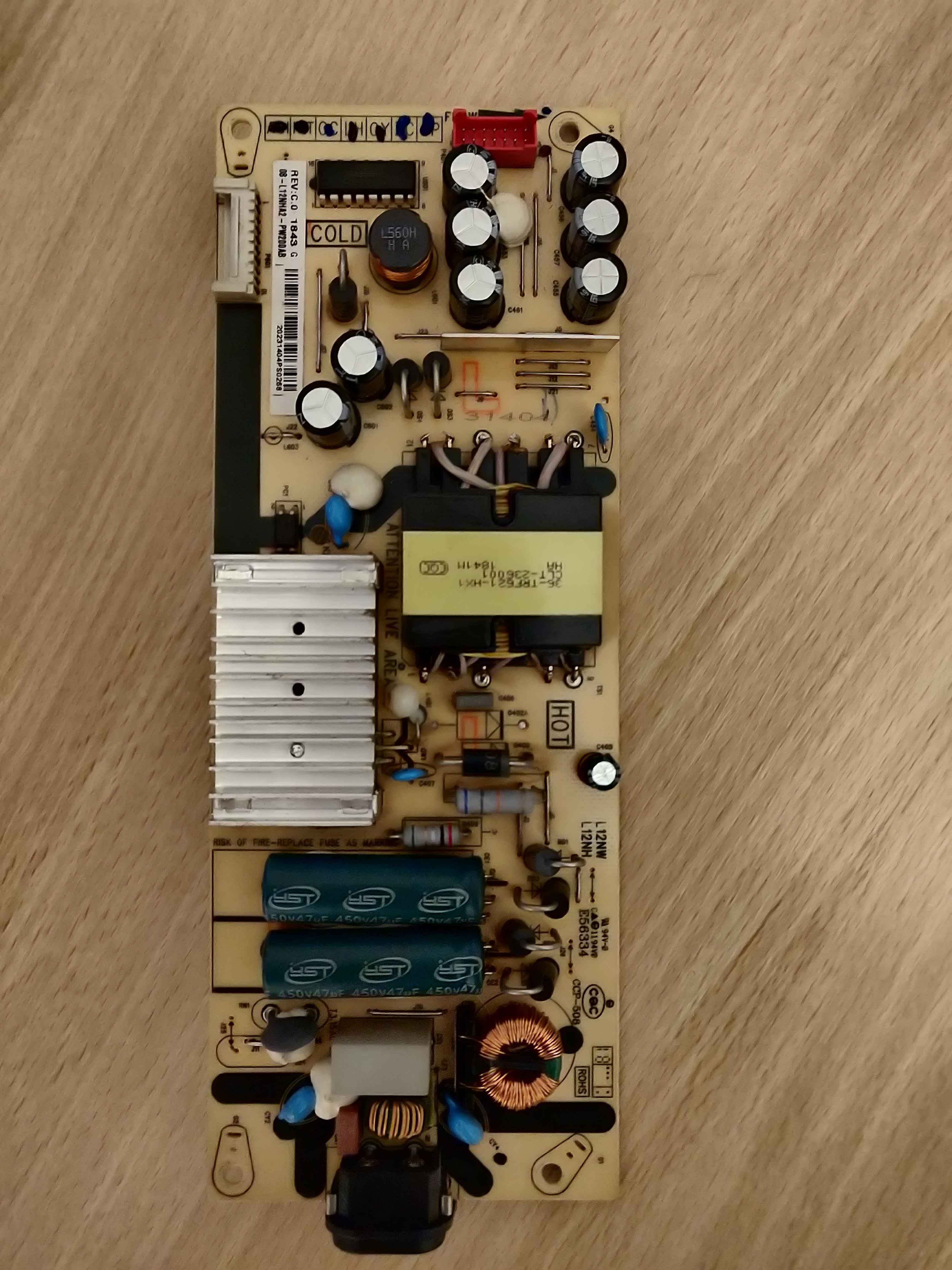

                    Back on this story, I found for 12$ a PSU on Aliexpress, I bought it and it works.
                    Unfortunately it's not exactly the same as mine, a compatible model anyway, so i'm not able to measure and compare values to find the issue on mine.
                    I'll try with a colleague to check the 2 remaining possible component that may have failed => MOSFET and resistor on control pin.
