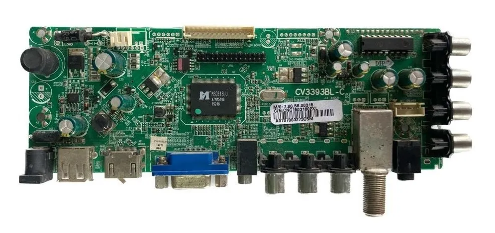

                          #1492
                          Re: Eeprom dump thread!
                          the problem is only red light standby, don´t turn on. Panel HD 18.5" RCA, model DETG185R motherboard CV3393BL-C
                          Do you have Dumps of this motherboard? not necesary that brand

                            #1493
                            Is it posible to modify this dump in order to flip the screen ?

                              #1494
                              Try
                              • nitsuga
                                • Dec 2013
                                • 12
                                • mexico
                                #1495
                                Thank you so much! You are a genius.
                                I wonder if you can change the panel in this firmware, Mainboard CV3393BL-C original panel is HV236WHB-M00 but I need the V236BJ1 panel,
                                the reason is that I need to flip the image, or how can I flip image? Service mode don´t work
                                • nitsuga
                                  • Dec 2013
                                  • 12
                                  • mexico
                                  #1496
                                  Originally posted by lotas
                                  Try
                                  Thank you so much! It works
                                  the reason is that I need to flip the image, or how can I flip image? Service mode doesn´t works

                                    #1497
                                    Why does the service mode not work, or do you not know the code how to enter it?
                                    • nitsuga
                                      • Dec 2013
                                      • 12
                                      • mexico
                                      #1498
                                      I can enter and modify but the changes disappear when I turn off the TV

                                        #1499
                                        there must be function to save changes. try with ok or (>) arrow button or vol/channel + button.
