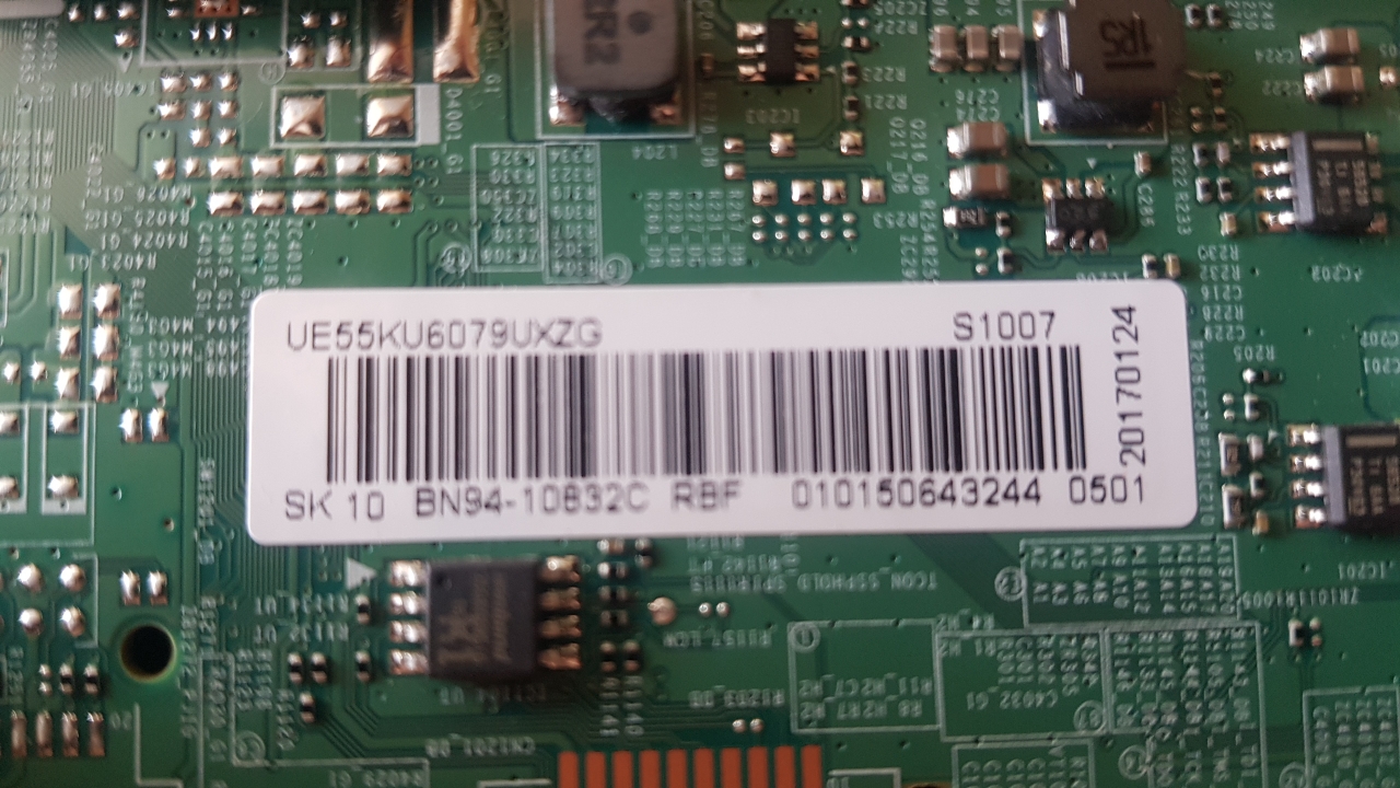

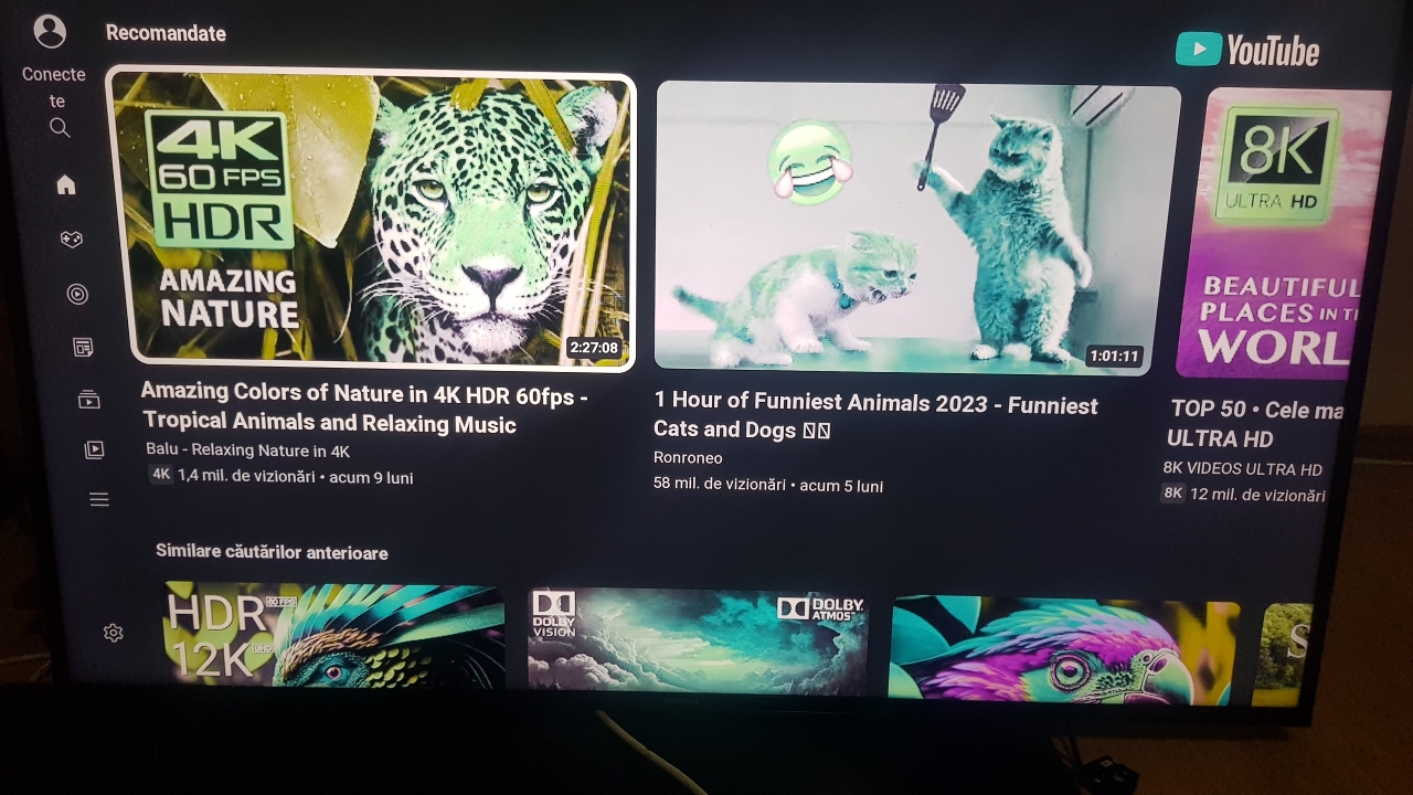

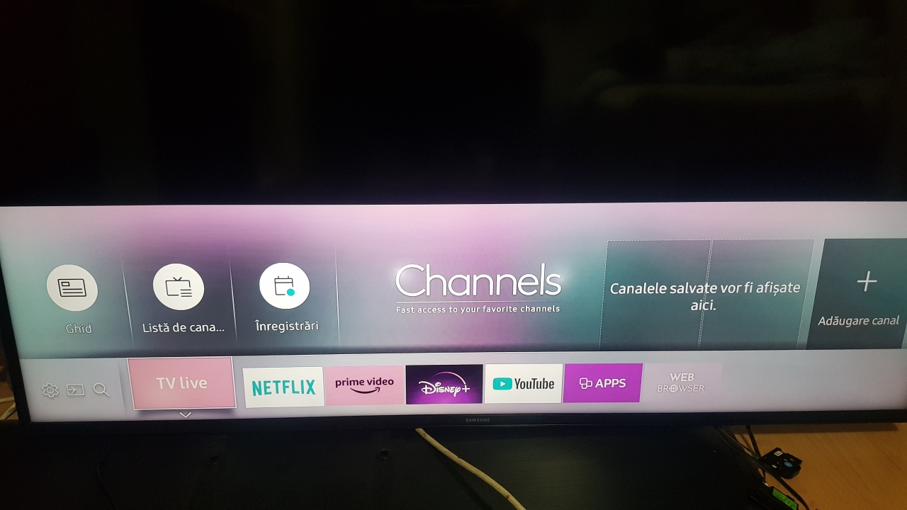

                    hi, i am looking for the firmware for a samsung UE55KU6079U, BN41-02528A, BN94-10832C, panel CY-GK050HGNV5H.
                    the tv works but has no colors.
                    I wrote the memories with the bins from the ue50ku6092u, but it doesn't display anything. how could i solve it?

                      #1570
                      Re: Eeprom dump thread!
                      How can there be a TV with a “55” diagonal, and the panel costs from “50”, correct it.

                        #1571
                        the board is on the diagonal of 55. but in the information about it it appears that it is ue50ku6092u. I wrote the bins for this model but it doesn't display anything anymore

                          #1572
                          that's how I bought the TV. without the original motherboard

                            #1573
                            Return all the original dumps (if you saved them), here you just had to replace the dump (t-con) 25Q80.
                            Or change it to your panel in service mode.

                              #1574
                              from the service menu you have nothing to do with them
                              here are the files it works with

                                  #1576
                                  These are his original dumps, if so, then return dumps 24c512 and 25Q40, and write down mine 25Q80.
                                  In service mode you can change the panel type!
                                  I tried, but black screen
