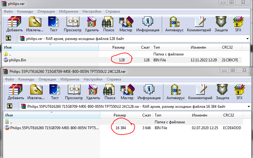

                                    here is the corrupted philips bin file
                                    65pus6162/05
                                    sorry i cant seem to upload .bin file
                                    can somebody advise please

                                      #1338
                                      Re: Eeprom dump thread!
                                      hope this is correct
                                        65pus6162/05
                                        And why is this size small, what chip did you read the dump from?
                                        • jimbofz
                                          • Apr 2013
                                          • 539
                                          • uk
                                          #1340
                                          cct ref U409
                                          M24128 BRMN6TP
                                          this is from the cct diagram
                                          the number on the chip is difficult to read
                                          :128br 713t with green paint on pin 1
