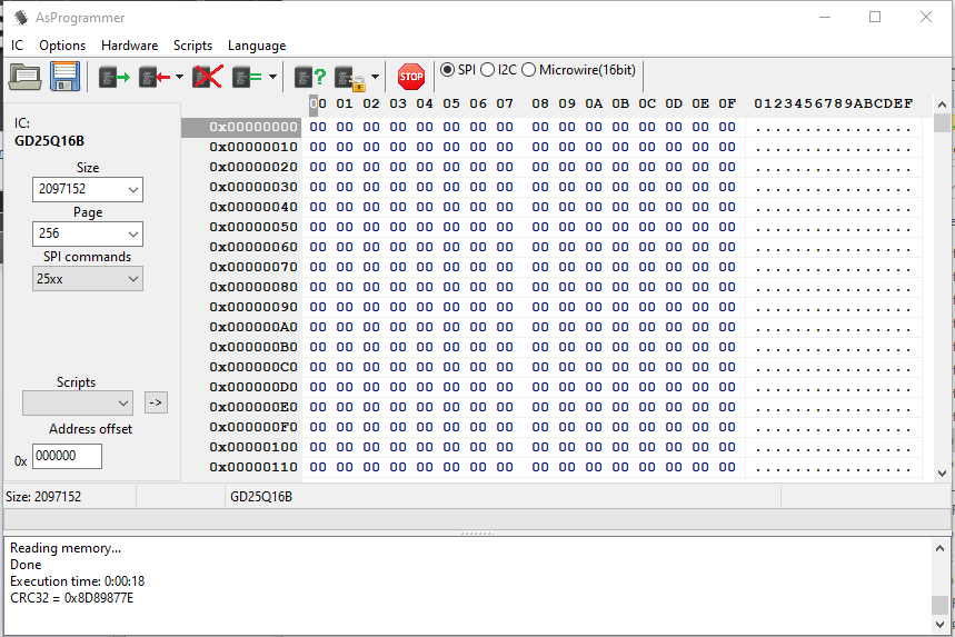

                                    • jeff260z
                                      • Jun 2014
                                      • 3
                                      #1138
                                      Re: Eeprom dump thread!
                                      Originally posted by lotas
                                      Post your non-working dump here, I'll fix it for you.
                                      Thanks. I've been trying to read the eeprom but I keep getting all zeros from asprogrammer.
                                      I'm using a CH341A and trying to read the chip while still on the board. I've tried to read the eeprom from two different tv's and am getting zeros every time. I'll keep trying to figure things out.
                                      • Rajnhl
                                        • Oct 2018
                                        • 94
                                        • India
                                        #1139
                                        try with shorting crystal attached to main ic
                                        or programmer is not supplieng enough power to eeprom
                                        • lotas
                                          • Jan 2016
                                          • 4503
                                          • Russia
                                          #1140
                                          It should be like this at the beginning of the dump, unsolder the flash and try to read data from it.
