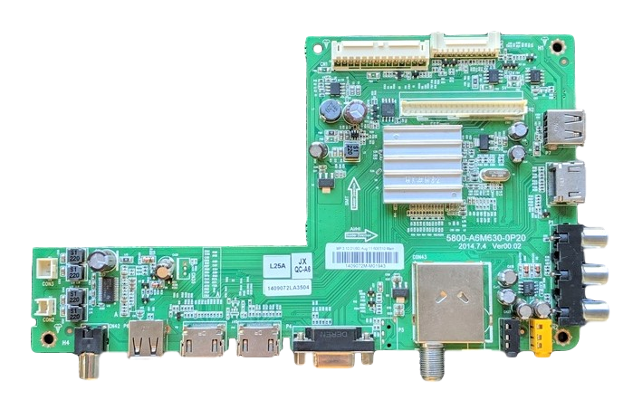

          Does anyone have EEPROM or SPI FLASH firmware for 60" LG model 60LB5200?
          Mainboard is 5800-A6M630-0P20
          part number COV32945801
          See attached image of mainboard.
          Thanks in advance.

            Post your non-working spi flash dump here, I'll try to fix it.

              Hi lotas:
              Thank you for replying.
              I attach two files:
              [1] NON-WORKING SPI flash dump from 60" LG model 60LB5200-UA.
              [2] WORKING SPI flash dump from 65" LG model 65LB5200-UA.
              Normal TV behavior upon plug-in is for power LED to flash green for a second or two, then turn red and stay red until power button is pressed on TV or remote.
              Problem symptom is green power LED upon plug-in, and stays green at all times. No response to any buttons on TV, or remote. No backlights, no audio, no video. Completely unresponsive.
              I tried the BIN file for the 65", and my TV turns on, but image is very bad with psychedelic rainbow colors since it uses a completely different panel. I only upload for you in case it helps you determine fault by comparison.
              I hope to hear from you.

                Ok, do you know the model (processor number) of MStar?

                  Hi lotas:
                  Processor under heat sink is MSD3393LU.

                    Done, try it.

                      Hi lotas:
                      Thank you - I downloaded the file but no time to try it today. I will try tomorrow and report back.
                      I have a question though - The original BIN file I uploaded is 4,194,304 bytes. The file you uploaded is 3,173,140 bytes. There is larger than 1MB difference in file size.
                      I expected the files to be the same size. Is the file you uploaded the correct size? How can I program this smaller file? Do I need to fill or pad with 1's or 0's? I don't know much about that.
                      Let me know your thoughts.

                        Hello, it's not so bad that the size is smaller, the programmer will fill the free space by itself FF FF...

                          Hi lotas:
                          The .BIN file you modified for 60" LG model 60LB5200 is working for my TV.
                          Thank you very much!
                          What was the problem? How did you find the problem? What did you do to fix the problem?
