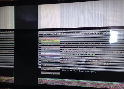

          Originally posted by dani502017
          After if its ok go to Copy Pattern profile for MB95M
          Here the procedure is a bit more complex, so will be created two folders
          1.downloadprofile.mb95 - responsible tuner, audio, subtitle
          2.downloadpq.mb95 - panel responsible (display)
          The operation is the same as the FAT32 stick, make the two folders with the above names, insert the stick into the TV, go into service with the MENU 4725 and the "USB OPERATION" option is ok from the remote control.
          After upload here the file,will then help repair
          Hello again,
          I finally got the TV to switch on but screen is scrambled & upside down,
          I have downloaded the files you requested as follows,
          Thank you
