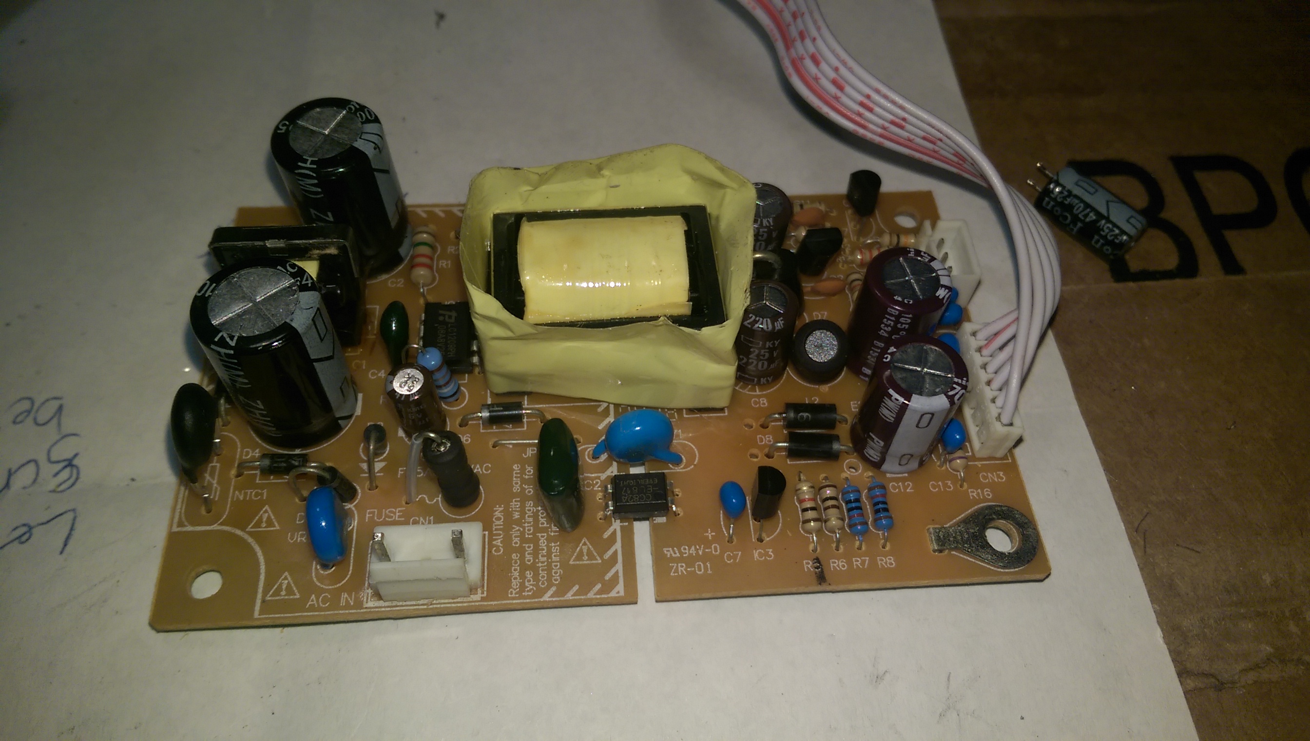

    Hey, I have a TV in my room that I use for all my video viewing. It is an Apex GT2415. 24" 4:3 CRT. It has Coax, S-Video, and 3 Composite/LR audio ports. I have an RF modulator with all the same ports and an Apex DT502 Digital TV converter box. I have tried many combos to get it to work but can't seem to pick anything up over my antenna. The antenna is a GE 12940.
    What should I be doing to get it to work? Thank you

                • Pentium4
                  CapXon Be Gone
                  • Sep 2011
                  • 3741
                  Re: How to get cable over antenna to analog TV?
                  Yep, I was doing that. So I had it set up correctly, but I didn't have a remote! There are no buttons on the unit itself so I had to buy a remote for it on eBay. Once it came in, all I had to do was tell it to scan for channels in the menu. Cable started working! I thought there was something wrong with my TV because the image was spotty and had spotty white static on it. I opened the Apex unit and found a JWCO cap bulging on the bottom. I replaced all of the filtering caps and the startup cap on the PSU. Once I fired it up again, it had a perfect picture!
