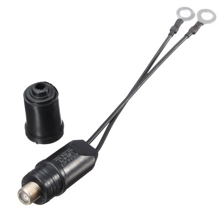

      Re: Log periodic antenna to Coaxial cable... balun right?
      One of these should work
          The most typical is 300 Ohm for those TV antennas, unless there is a tuning stub or something. If there isn’t any matching mechanism, it plain 300 Ohm. Now if you use twin lead 300 ohm cable, it has less losses an works over a wider frequency range vs coax. As soon as you put that balun in there and go coax, you have more losses.
          Coax advantage: 75 Ohm, unbalanced, shielded, can be laid anywhere. Disadvantage: higher losses.
          Twin lead advantage: 300 ohm, balanced, works over a very wide frequency range, less losses. Disadvantage: unshielded, cannot be laid in metal pipe, or touch metal etc. It needs holders of some sort.
          Years ago, I put an antenna like that in my barn roof. Look around, people are giving away old TV towers.
