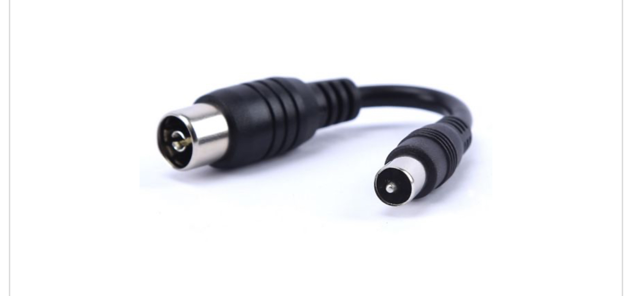

    can anybody tells me if there is an adapter like the title
    in every link tells is discontinue
    or is there some other way to replace it ?
    i cannot find the special male coaxial plug 7,5 mm that is connected on pcb board
    thanks on advance

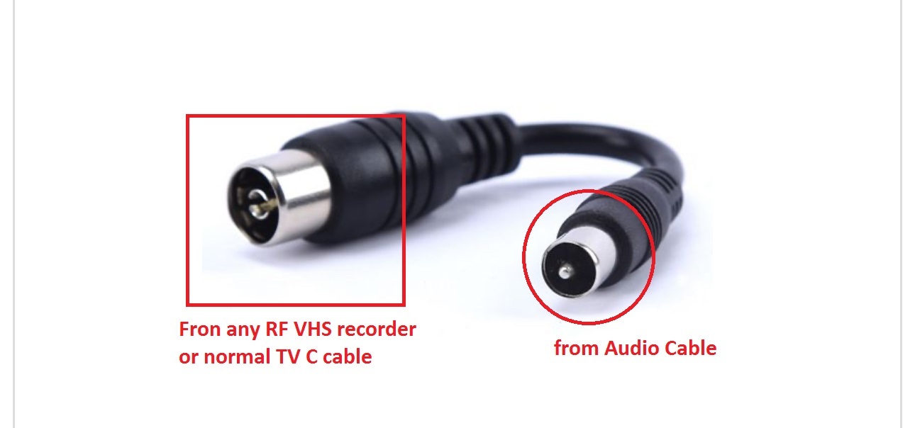

    doesn't worth to buy the Gender Cable ,,,,. do it yours self.. with 2 adapters one for audio input and other for antenna depend on what you need if for T & C or for S

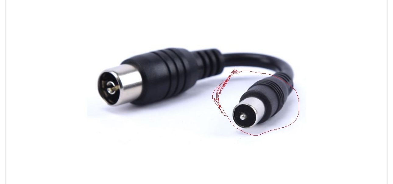

      i cannot find the male plug 7.5 mm that is my problem
      • wolf1976
        • Oct 2023
        • 113
        • Ελλάδα
        can you tell me sir where can i find the underlined with red male plug ?

              sir just to be sure rca male plug like photo is ok ?
              i ask so i dont damage the connector of tv if i use wrong connector

                the only way is to disassemble the tuner box and solder a coax wire about 5-10cm and terminate it with a standard iec flying connector

                  mr diah i tried to fit a male audio connector as you advice me with no success i cannot fit with the female of my tv
                  the connector must be 7.5mm

                    why didn't fit... did the out ring smaller or bigger or the inner pin thicker as the hole? explain i did it many time with out problem

                        i believe you sir
                        maby i didnt use the right connector rca
                        my tv is ue46c8000
                        can you give me a link please from the audio connector thst u use for my model and it was fitting without prblem ?
                        thanks on advance

                          go a head to buy ready one gender cable on amazon... sorry to tell ,, you are lack with creative idea.
                          i used the same one you showed later for stereo audio plug cable,,, take only one,,, the plastic covered the round plug must be removed so you can adjust the rand round plug mass on the tv one to sitting exact... if the round one round complete we cut 2 line against each other so we can make it bigger or smaller as the size of the female.
