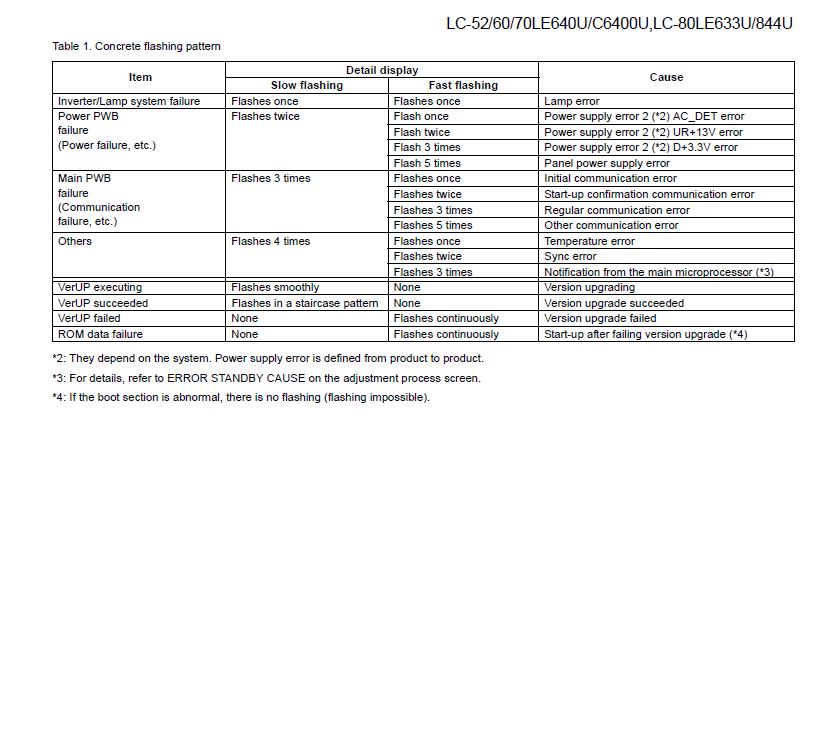

    Hoping someone can tell me what the errors im getting mean

    I was able to force the set on using sharps force on procedure for this model which is to unplug the set from ac simutanously press and hold ch down & vol up down and while holding buttons down, plug set into ac,

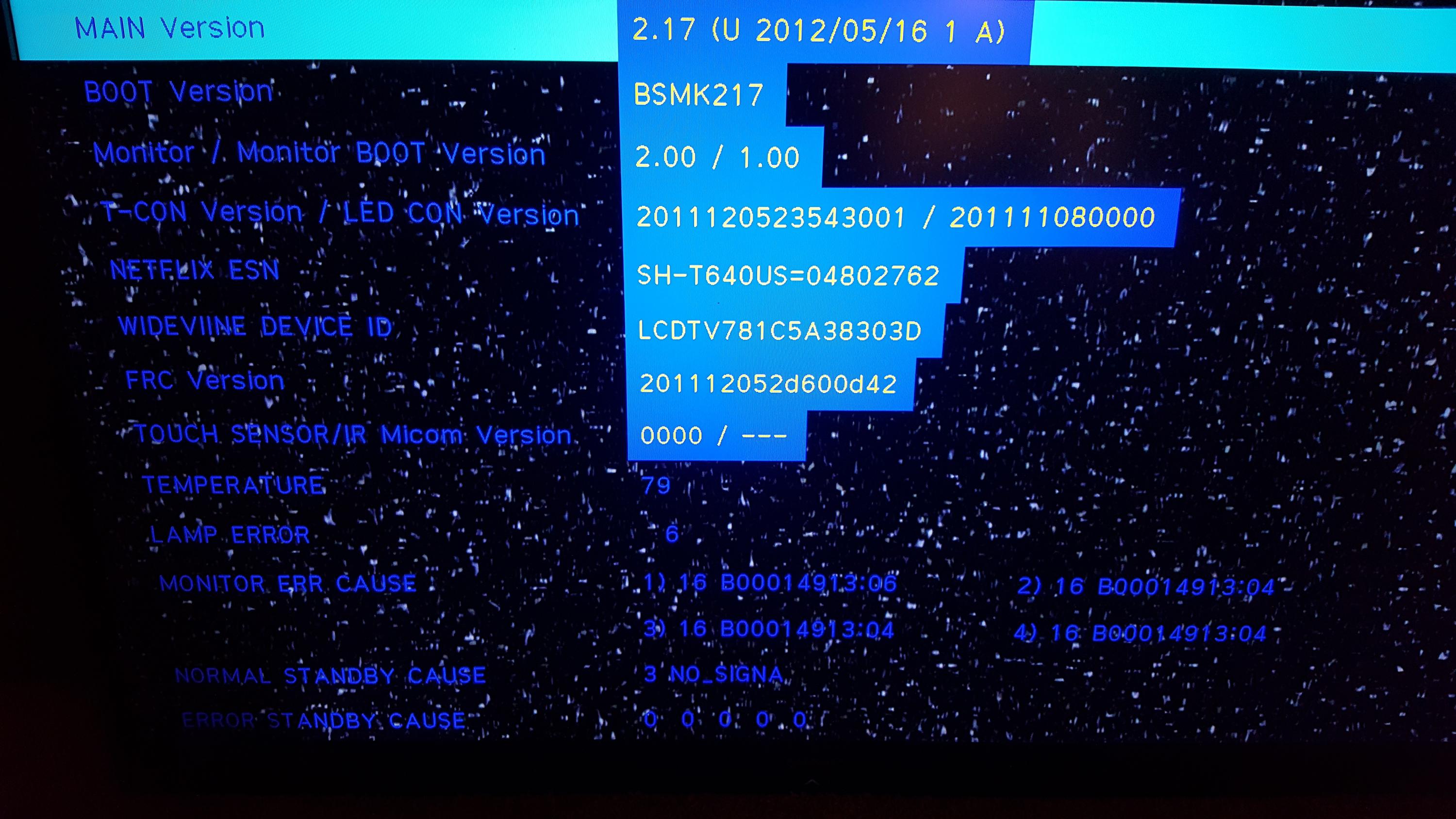

      I did get it to turn on but only showed the screen I attached a pic of above.
      I will try that when I get home and update, Thank you!

        Looks like burned out led on the lower left.
        Same issue I had with a 60 sharp but on the lower right.

          By looking at your screen, it has logged 6 lamp errors so I would suspect, (like Malachi said) defective led

            Thanks guys, that's what I figured through my research the past few days. Only thing now is to weigh my options between fixing myself and taking it into a repair shop. Now, Im not an expert on electronics but I can complete projects when necessary. what do you guys think?
