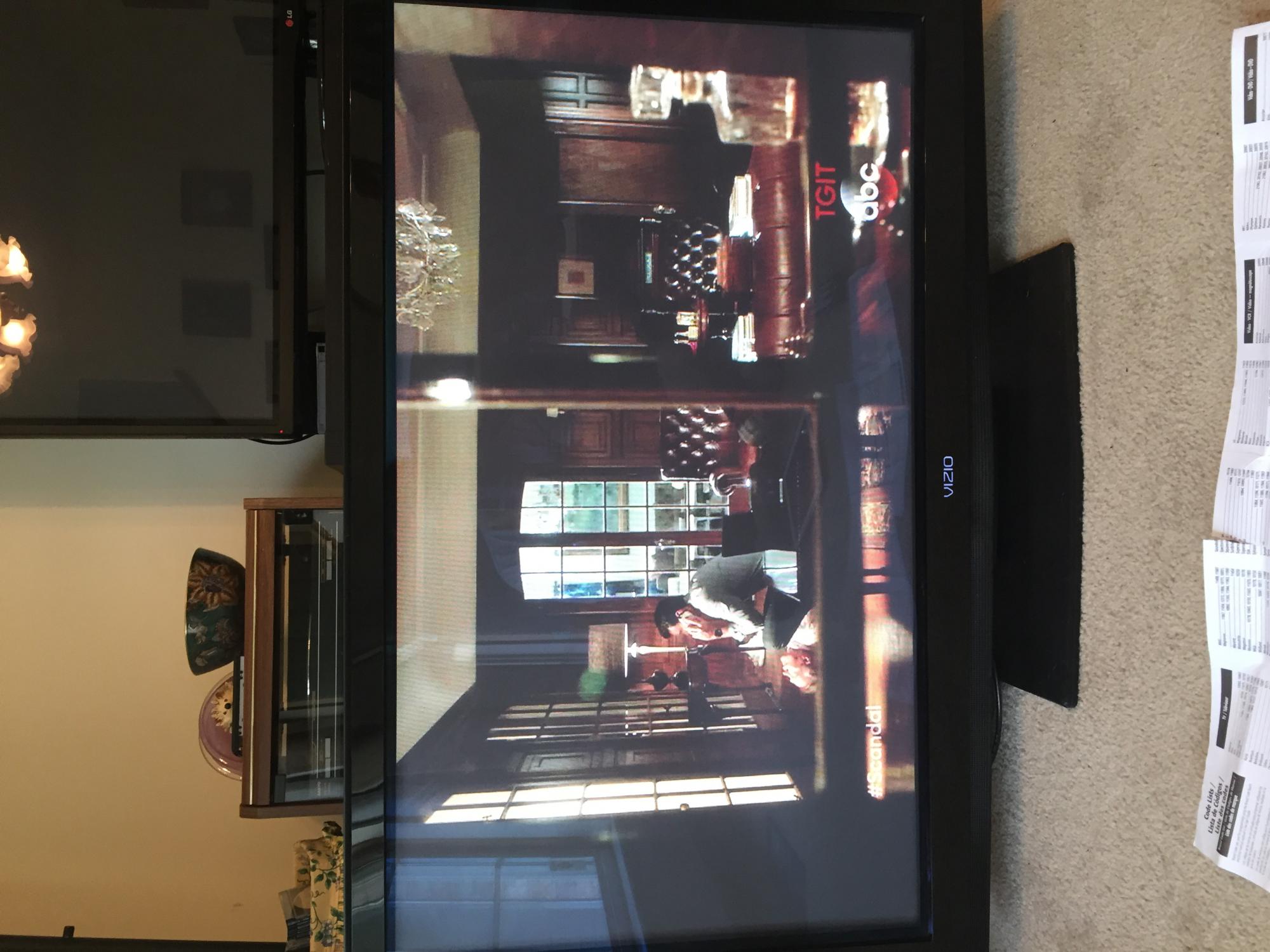

                    #129
                    Re: Vizio VP422 won't turn on.
                    Fixed. A new power supply took care of it. Cost of $38.
                    Without your help, I wouldn't have know which board was faulty.
                    Now I also know what's wrong with the faulty one.
                    I can take my time fixing it if I want.
