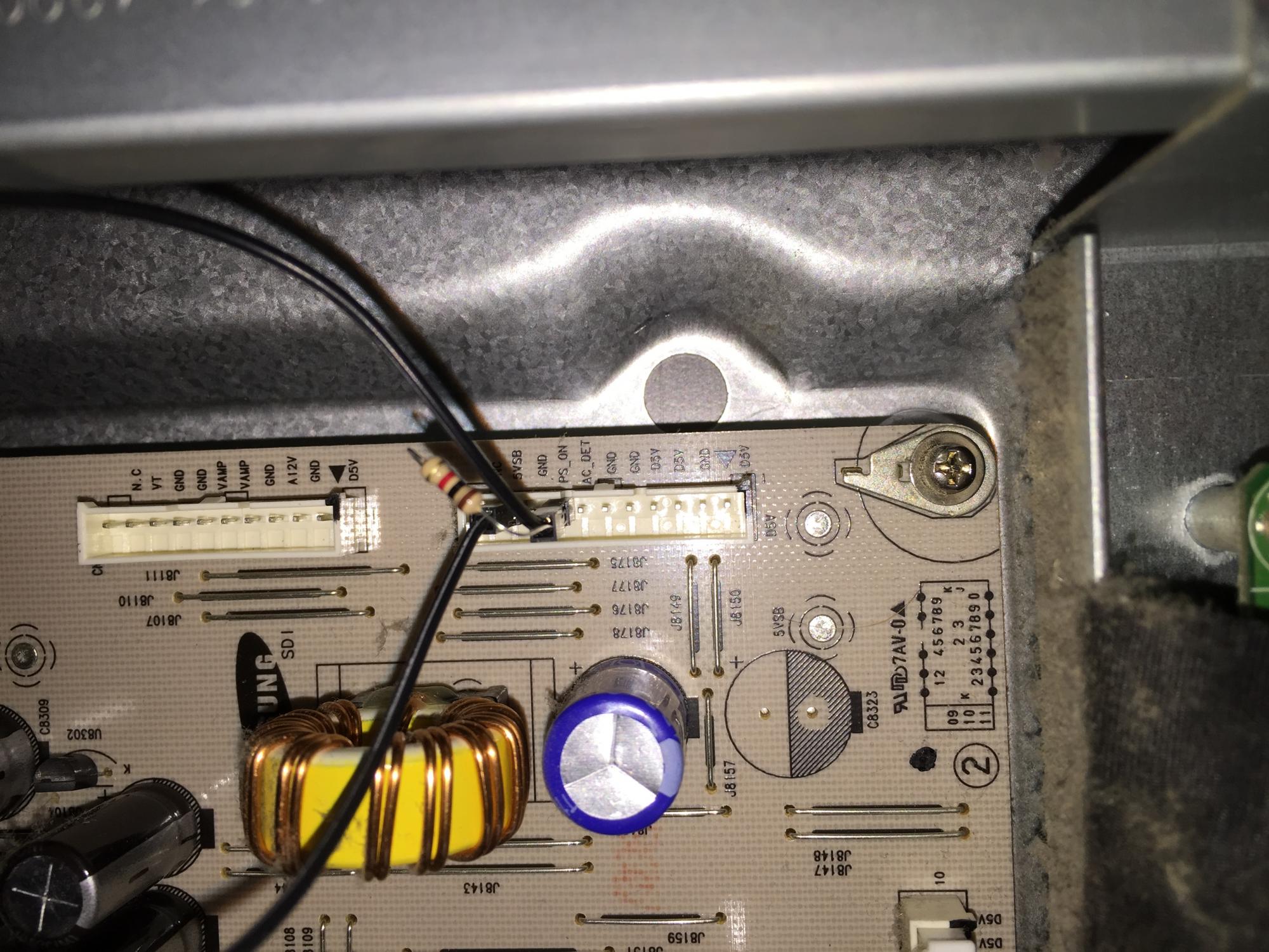

    I just got this TV. When I plug it in a relay clicks, logo turns Amber and that's it.
    I checked the voltages on the psu, and this is the only readings I'm getting.
    5vsb=5.37
    Ps_on=0.48
    Ac_dect=5.18
    That's it.

                        Re: Vizio VP422 won't turn on.
                        Hello Malachi,
                        If you isolate the PSU and connect 5Vsb to PS_ON does D5V, Vamp, A12V come up?
                                  I had a 1k resistor and did what you said, no change.
