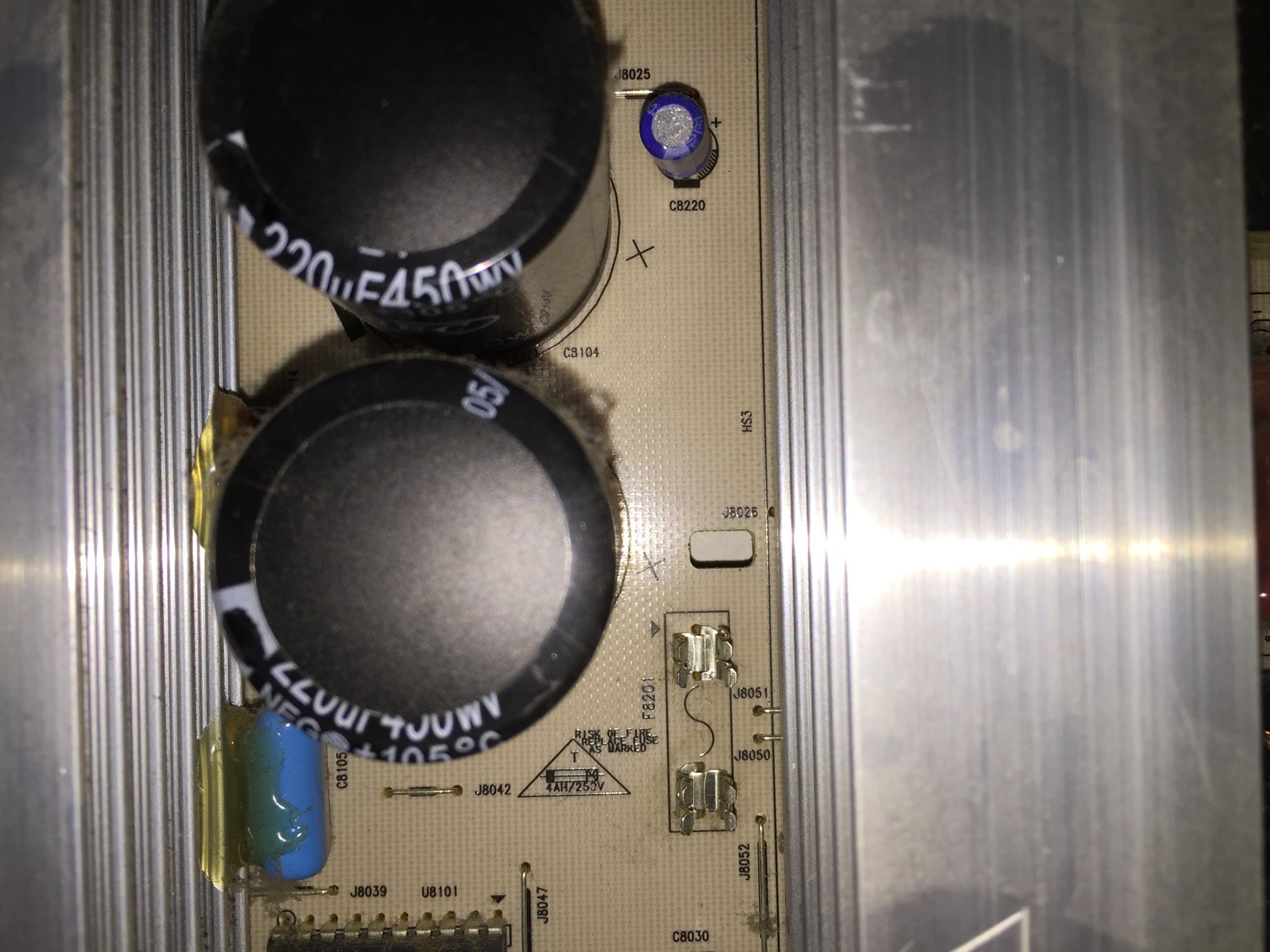

      Both fuses were good when I first started, that's the first thing I always check. It was the only thing I knew how to do when I started doing this.
      Now F8201 is blown.
      I just replaced it.

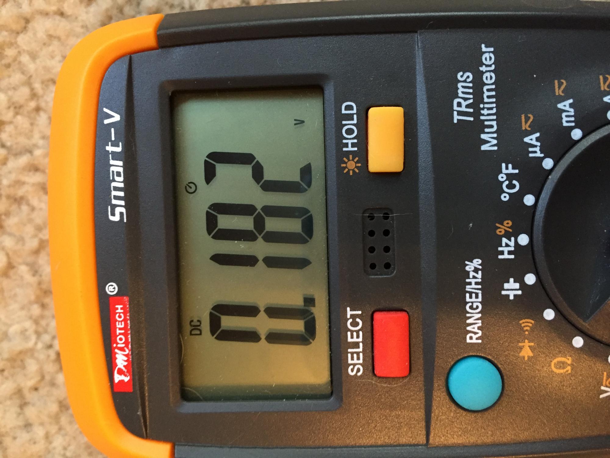

                        So there's definately no change when you connect 5VSB to PS_ON.
                        What is the voltage across the large capacitors C8103 & C8104. Its on the hot side of the mains supply so be very careful. Use your meter set to 600V and measure across the two pins of each of the capacitors.
                        I took the psu out of the tv. Laying upside down on a piece of cardboard. Plugged it in and measured each capacitor, voltage steadily climbing. After a few minutes I had less than 0.2V. Unless I'm reading my meter wrong.

                          The capacitance is about 446uf on each, in circuit.
                          Fuse F8201 blew again.

                            That explains why you had no voltage on the caps. Why is the fuse is blowing? Can you see anything amiss on the board because that was not your original problem.
                            • Malachi
                              • Dec 2015
                              • 1077
                              • Usa
                              #34
                              Re: Vizio VP422 won't turn on.
                              I couldn't tell anything visually unusual.

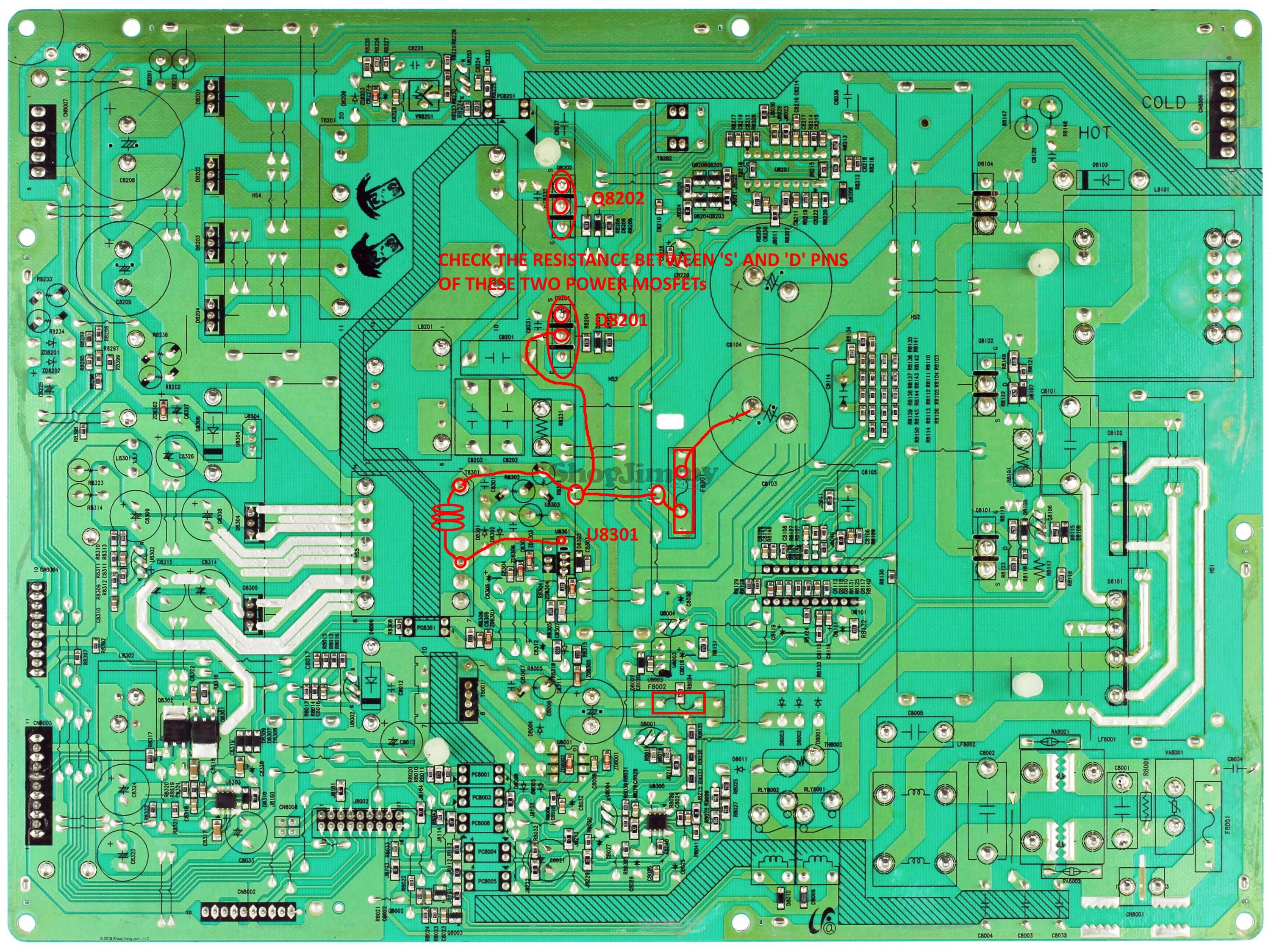

                                  I checked some of the 3 legged components that are screwed to the heat sinks. With my meter in diode mode.
                                  With the diodes, when I touch the two outer legs the meter beeps. When touching the middle one and an outside one, it doesn't beep.
                                  I also tested other 3 legged ones I'm not sure what they are called.
                                  They are labeled Q8101, Q8102, Q8103, Q8201 and Q8202 none of them beep. This is all in circuit.

                                        #39
                                        'But I can't keep replacing them with out figuring out why the blow.'
                                        But you already find the shorted out components? Which one?
                                        'They are labeled Q8191, Q8102, Q8103, Q8201 and Q8202 none of them beep"
                                        BTW, the meter will beep even if the resistance is as high as 100 Ohms on some meter. That is why I use Ohm mode to look for shorts or very low Ohm reading.
