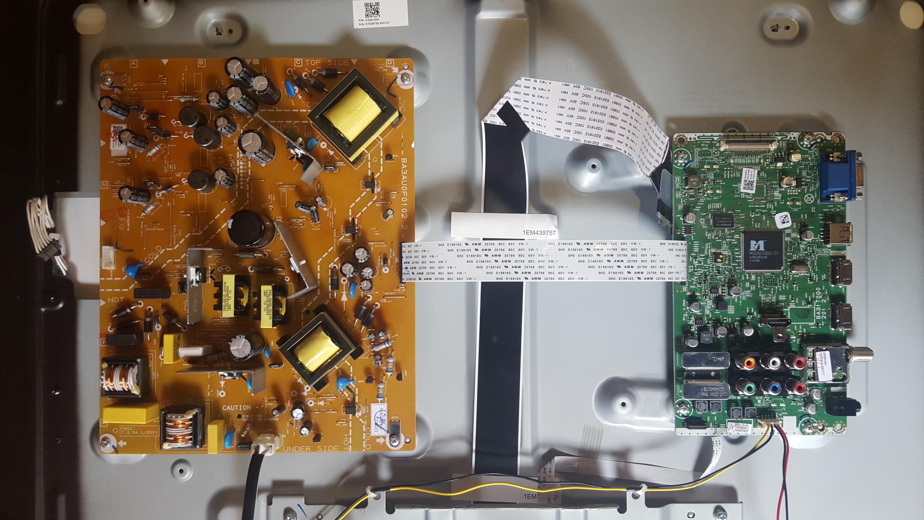

                            One ribbon going to the tcon.
                            • erickeri1234
                              • May 2013
                              • 98
                              • usa
                              #34
                              Re: Emerson LF501EM4F turn on then off.
                              Pic
                              • CapLeaker
                                Leaking Member
                                • Dec 2014
                                • 7964
                                #35
                                Where does that ribbon on the bottom left corner on the main board go? It looks like it goes to the Tcon for me?
                                • erickeri1234
                                  • May 2013
                                  • 98
                                  • usa
                                  #36
                                  Small ribbon goes to the ir board.

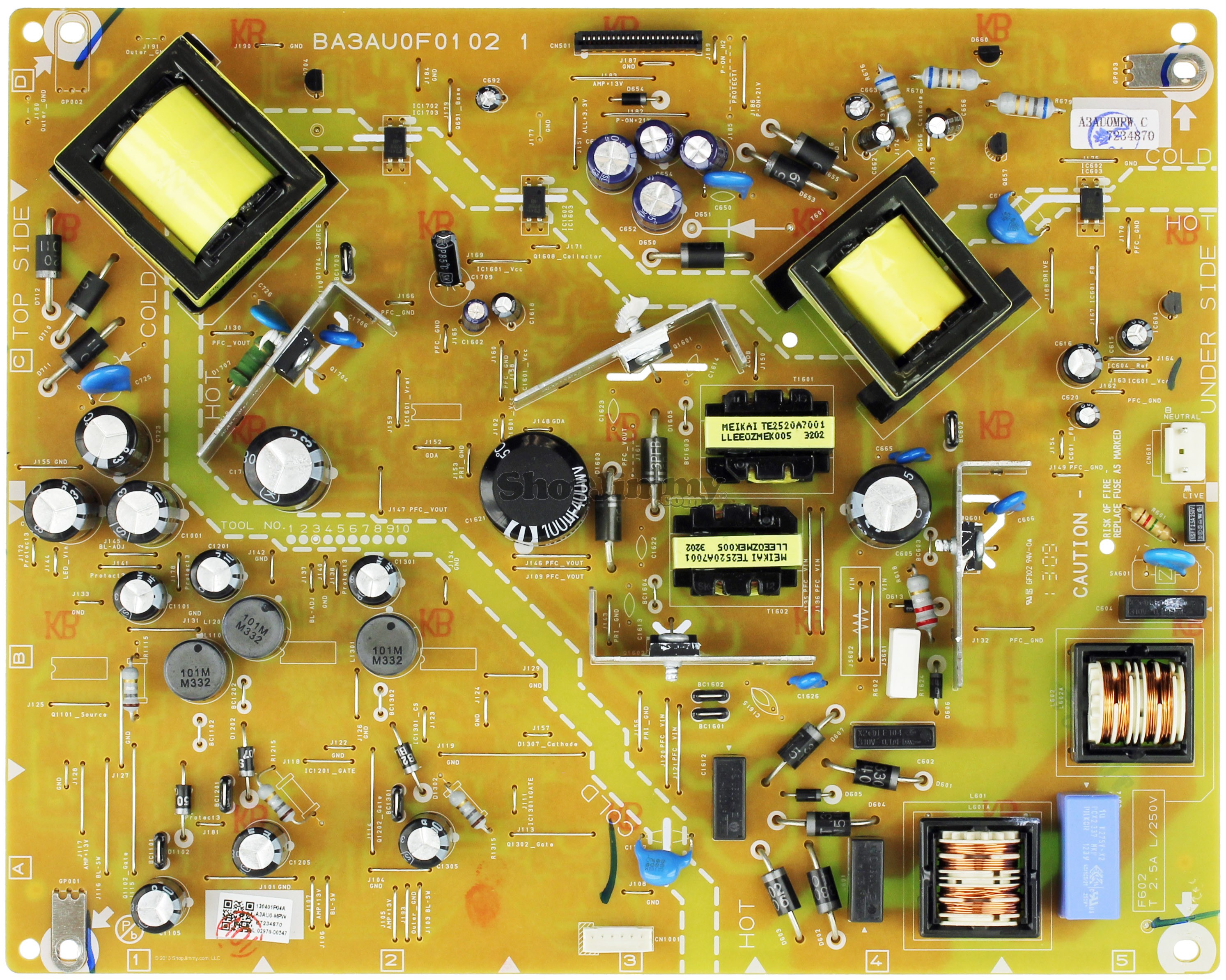

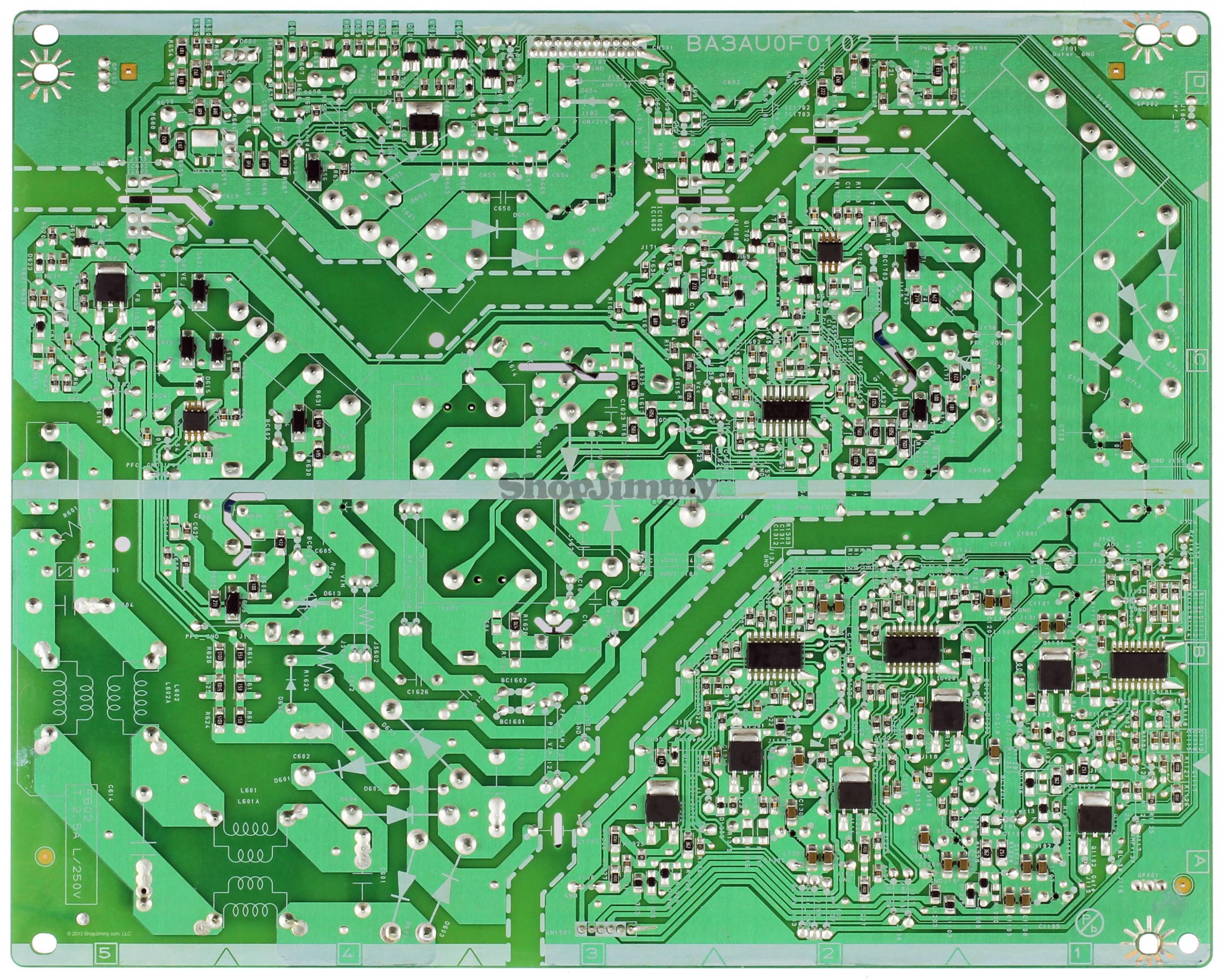

                                          #40
                                          No cable between the power supply board and the main board, LED connector in place, do the resistor jumper for the PS-ON (P-ON-H2) as before, then another resistor between the jumper J106/ BL-SW and the 3.3V to force the backlight on, see if the backlights will stay on.
                                          Pictures provided by shopjimmy.
                                          http://www.shopjimmy.com/emerson-a3a...pply-unit.htm#
                                          Emerson A3AU0MPW-001 Power Supply for LF501EM4 / LF501EM4F
