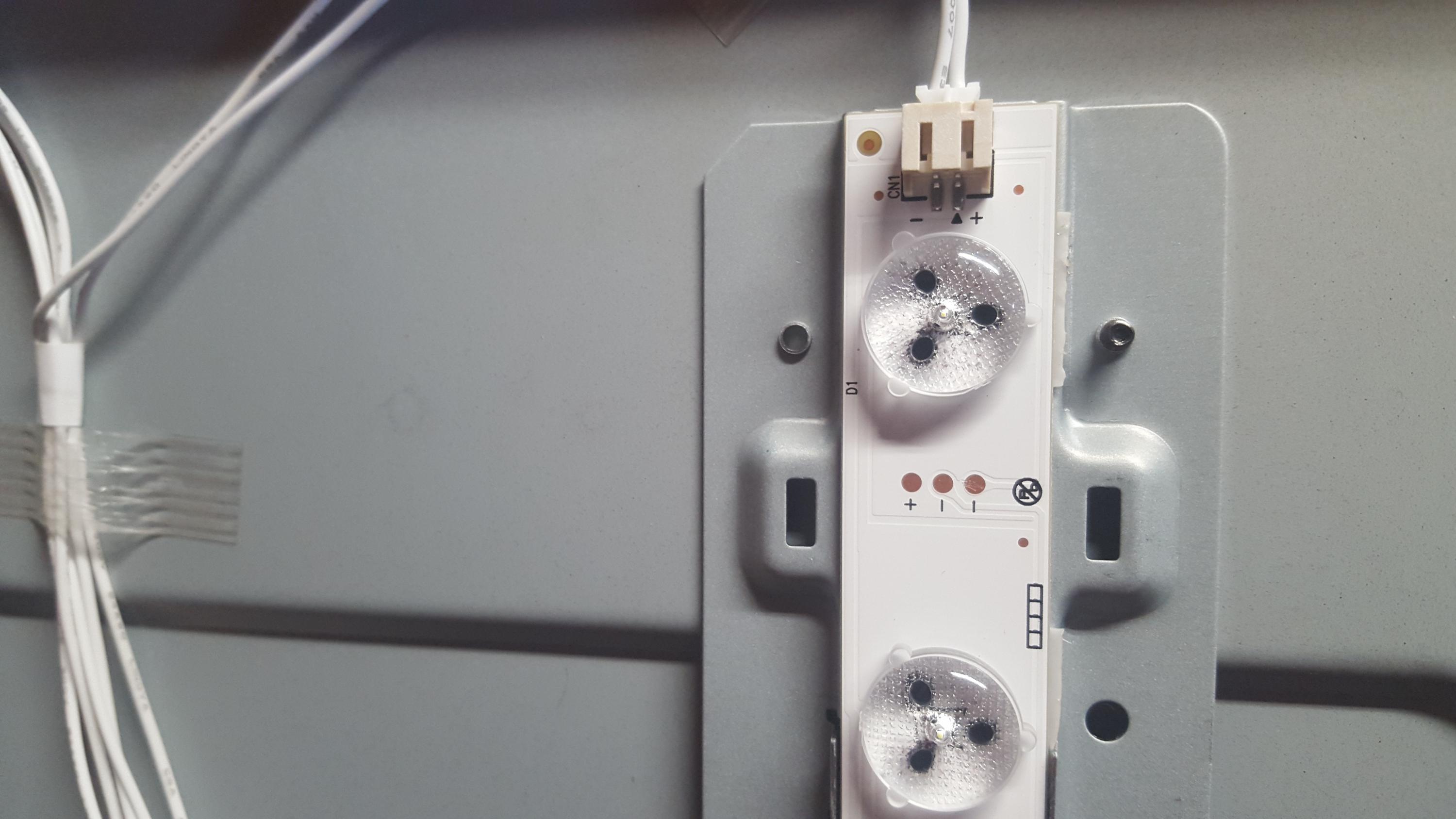

                                  Well I pulled it apart and guess what I found. Yep one strip of L.E.D's are not working. So I tested it with one of the other plugs. It acts up sometimes it comes on sometimes it doesn't and I see one led out on the strip but after like 10 secs it starts to flicker and it comes on.
                                  I looked on ebay there is a set but they say Samsung these in mine are LG. but they look identical.
                                    #57
                                    Re: Emerson LF501EM4F turn on then off.
                                    Samsung LEDs usually have the cathode on the larger pad. LG LEDs usually have the anode on the larger pad. DO NOT modify the pads to fit one where the other should go. The pads are the primary heatsink for the LEDs, which are usually driven to the max, thus requiring all the heatsinking that they can get.

                                      #58
                                      At the head of the strip, you should see a (+) and a (-) and two small test points. Use your ohmmeter to determine which pad is which.
                                      Pic
                                        #59
                                        Have you identified the bad LEDs yet?
                                          #60
                                          No not sure on how to test it. I seen what strip is having the problem but there are 2 boards on the strip.
