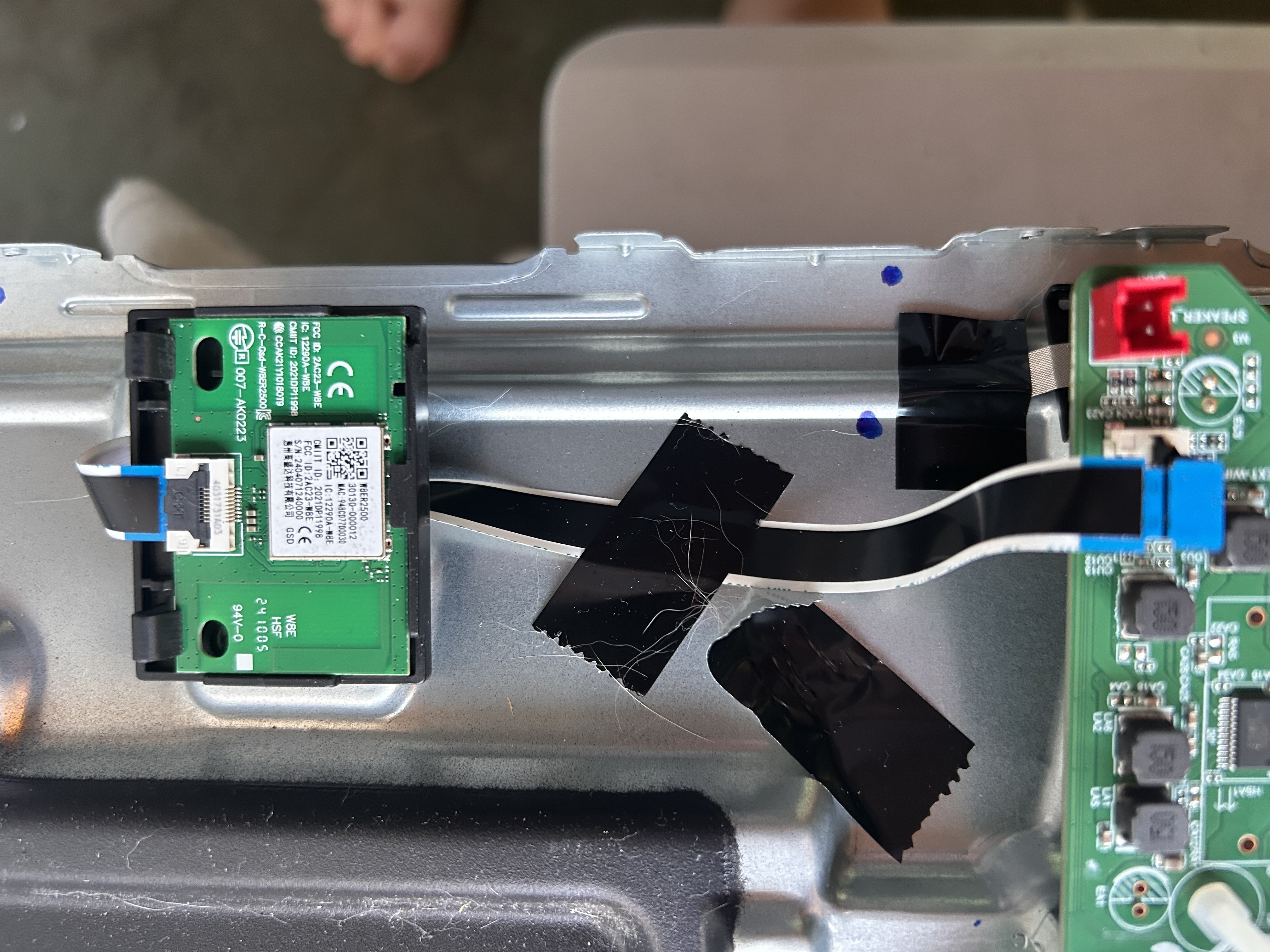

    At the moment; when it faults; which can take several hours or even ten minutes. the TV turn off. then I try to turn on with remote. backlight comes on but no sound.
    • JohnML1975
      • Jul 2025
      • 53

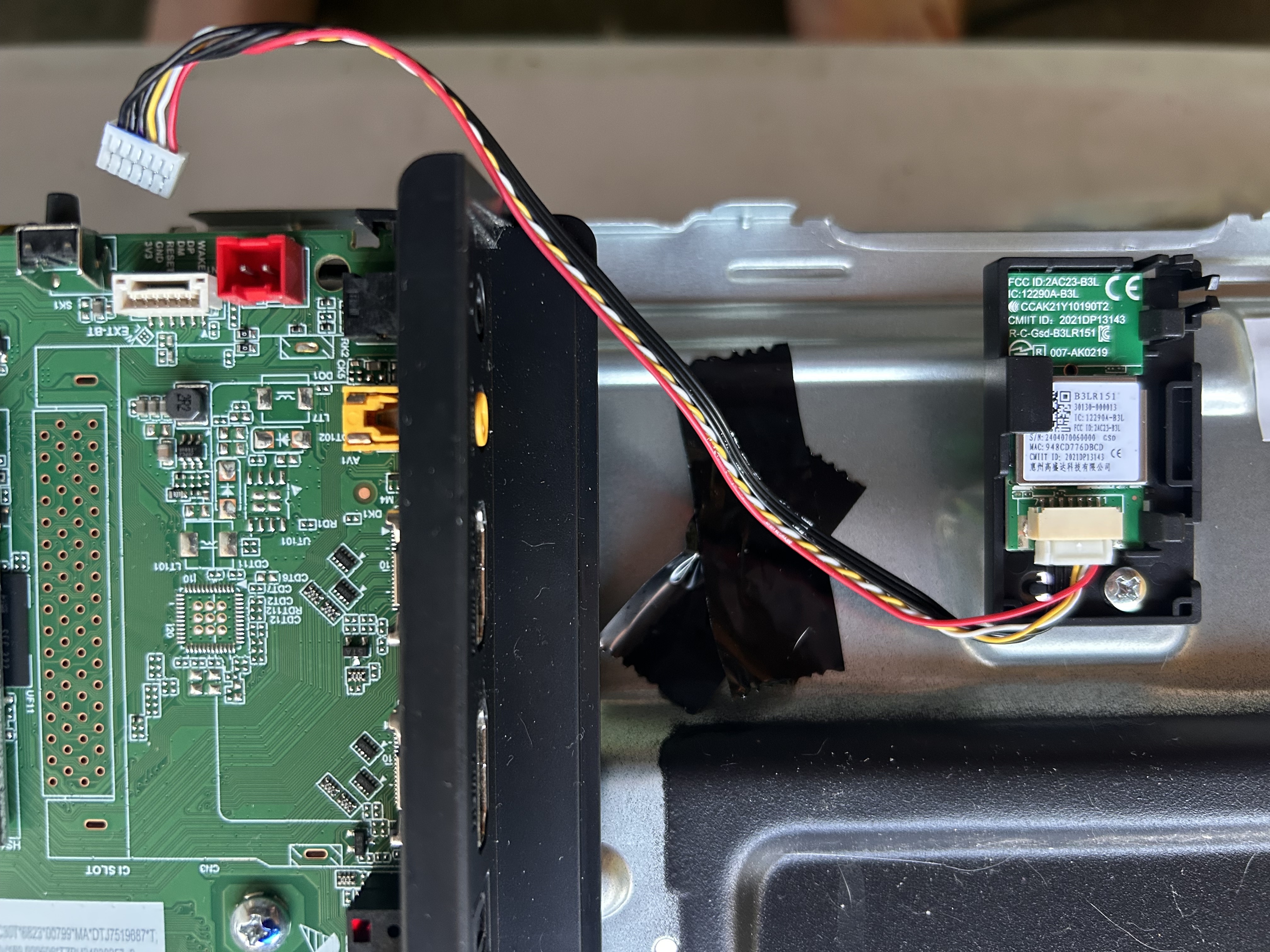

      Using my thermal camera I note the two capacitors, to the right of the heat sink CPU CG29 and CG30 are reaching around 90 degrees celcius. other components on the board are only reaching around 50 degrees celcius. that is one obseration I have made so far
      i have removed the combination power supply and motherboard and inspected visually
      i cannot see any cracked solder joints and i cannot see signs of heat anywhere
      • JohnML1975
        • Jul 2025
        • 53
        I have had these two components disconnected and for a few hours so far the TV has been operating just fine.
        • JohnML1975
          • Jul 2025
          • 53
          These two components are the WiFi and the Bluetooth module. I had to research one of them to find out what it was.
          • JohnML1975
            • Jul 2025
            • 53
            This youtube video suggests a factory reset and just thought I would share the link
            I am yet to try this
            instead i am going to keep the bluetooth and wifi disconnected for a few days over a couple of weeks and see what happens

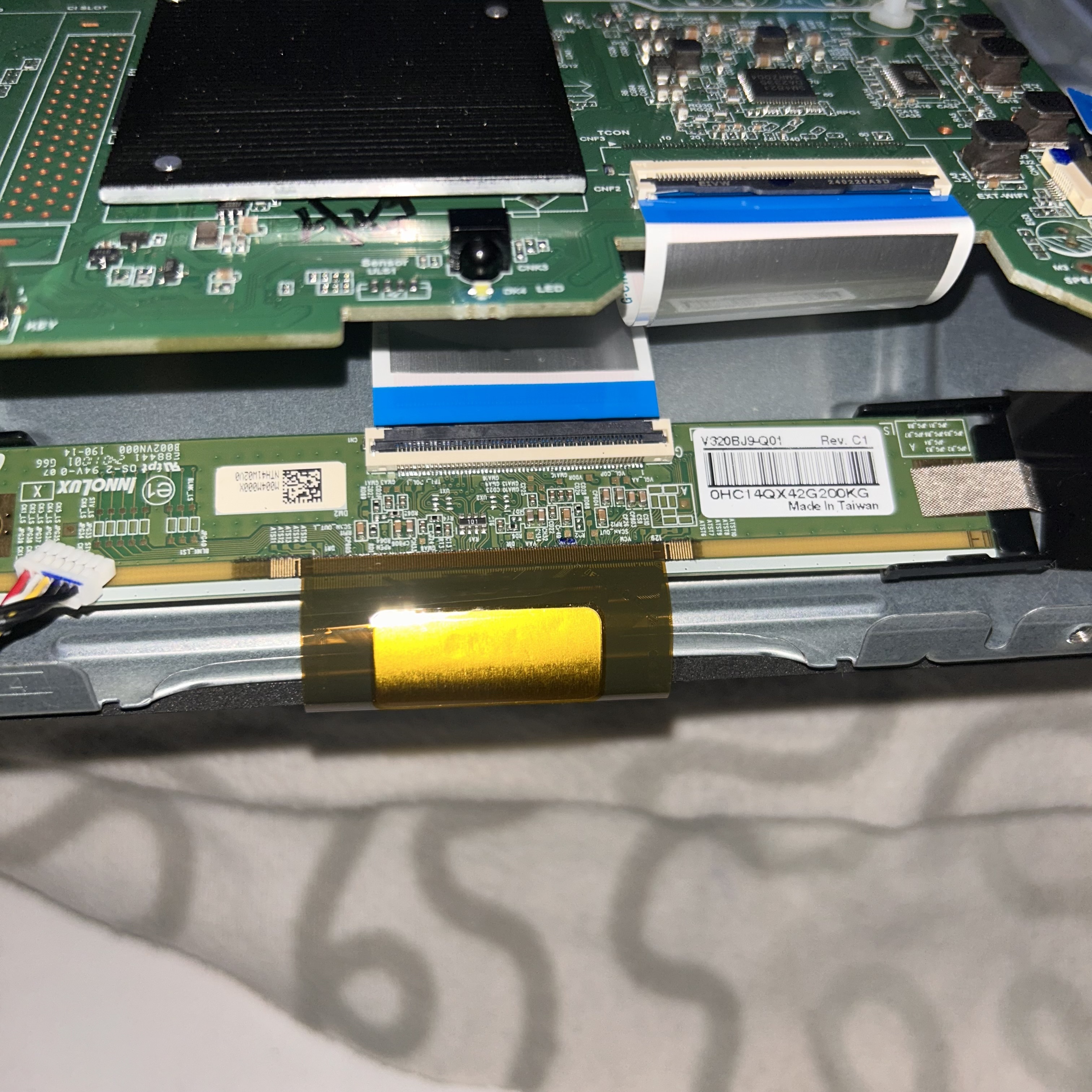

              I took these voltage readings with the TV on and when it was working. You can see the handwritten notes and the photo of the t-con / buffer board. I had the DMM set on DC volts and the earth probe was on the chassis
              It looks like all the voltages are correct.
              I share these incase of use to someone else or even myself as I work through this problem
