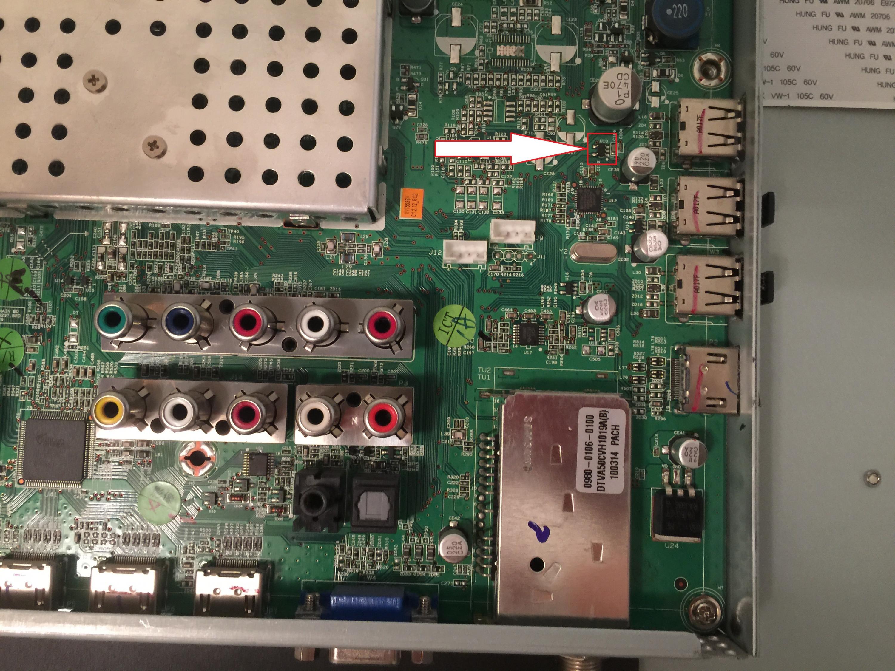

    I will reorganize. I now see there is a small dot on the PCB next to the IC.
    U32 - M11 G5684
    1: 2.256V
    2: 1.1mV
    3: 4.96V
    4: 5.10V
    5: 1.287V
    6: 1.287V
    7: 0.791V
    8: 0.794V
    U2 - M041 G5693
    1: 5.10V
    2: 0.797V
    3: 1.8mV
    4: 0.805V
    5: 4.87V
    6: 1.6mV
    7: 1.816V
    8: 5.10V
    U1 - L451 G5692
    1: 5.10V
    2: 0.799V
    3: 1.4mV
    4: 0.805V
    5: 4.88V
    6: -0.2mV
    7: 2.525V
    8: 5.11V
    U33 - L451 G5692
    1: 5.11V
    2: 0.797V
    3: 1.9mV
    4: 0.802V
    5: 4.88v
    6: 1.9mV
    7: 3.359V
    8: 5.11V
    U10 - 501H1 ? Not sure this one is very small 2 pins on top 3 on bottom and the voltage was changing on the top 2 pins (pin 4&5). It would drop to ~0 and then go to ~3v. I noticed after the tv is on for a while and the logo now stays orange the voltage on these top pins was ~0.
    1: 5.11V
    2: 2.1mV
    3: 5.12V
    4: 3.315V when it had power
    5: 3.17 when it had power
    That should be organized properly now. Thanks for the help. Learning a lot here.

      Attaching picture with U10 shown, since I can't figure out what it is.

        U10
        No idea without the full number written on it but possibly a reset IC for the main processor
        All the above regulators appear to give sensible outputs and step down the incoming 5V supply.
          Re: XVT553SV Vizio light flashes orange/white no display
          I just posted an image of U10. It looks like the top says 50H1M. It's really small. Any ideas what else to test?
              Looks like I might be able to determine the correct output voltage by trying to determine which resistors are connected to the FB pin. The datasheet for the G5692 says VOUT = 0.8V x (1+ R1/R2). Now to try and figure out what those resistors are on the PCB.
                        I wanted to follow up on this for the people who are in the same boat. I ended up sending the main board off to Ernesto's Electronics and he was able to repair the board for $75. I put it back in the TV a couple days ago and it has been working great. I am still waiting to see if he replies with what the issue was. It looked like he might have replaced multiple voltage regulators, but it's hard to tell with the tiny solder pads.
