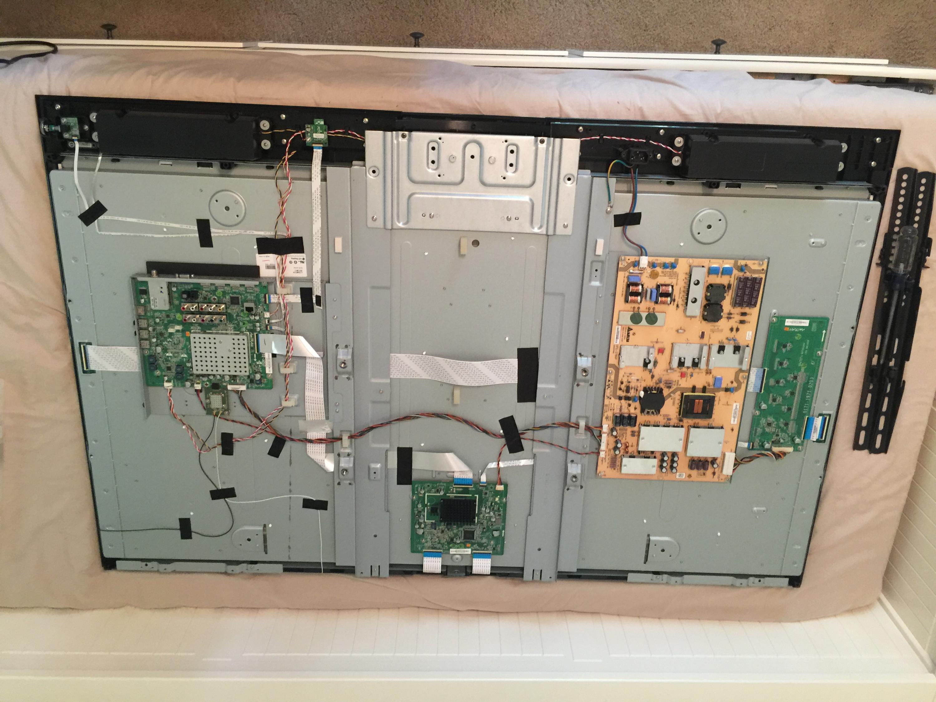

    Hopefully the experts on here can give me a hand troubleshooting my Vizio XVT553SV. Woke up the other morning and the light was flashing this pattern and just repeats forever. I tried unplugging it for a while and same thing.

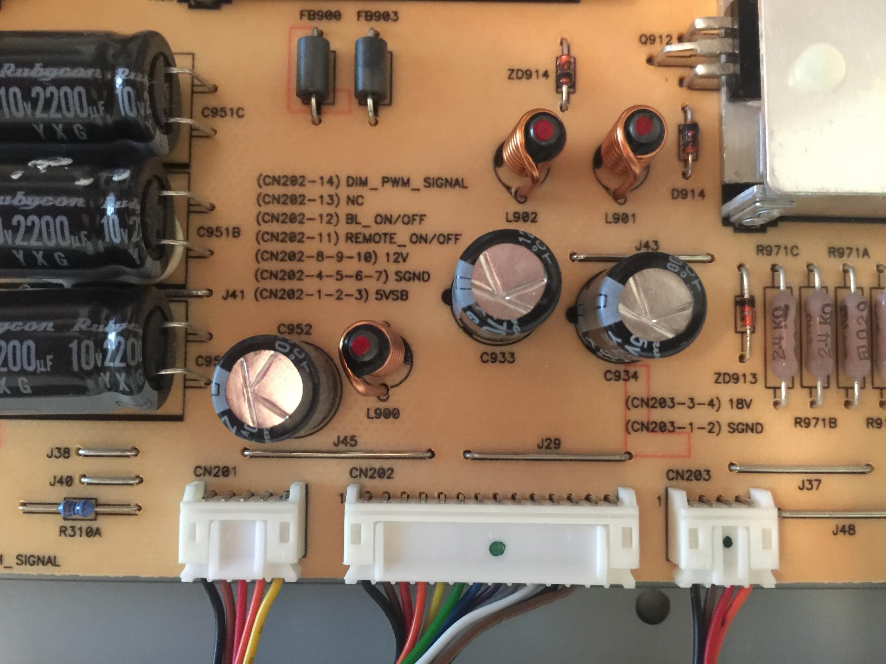

    I took the back off and tested the voltage at CN202 1-3 all have 5.15v. Any input or help further troubleshooting is much appreciated. Should I start trying to test the voltage regulators on the main board or are there other things I should check first? Check voltage at fuses, capacitors? I have a digital multimeter and know a little, but not huge into hardware fixing.

    Disconnect the power supply from the mainboard and connect the 5V supply to remote on/off using a 1 to 10K ohm resistor and check if all the other voltages come up.

        Yeah I think these are all on their last leg. Just to be clear I should disconnect CN201, CN202, and CN203 then jump power from CN202-1 5v to CN202-11 REMOTE_ON/OFF via a 1-10k resistor. Then test the connectors for voltage again.

          Disconnect everything from the power supply except the mains input and connect the resistor between pin 11 and pin 1. This should bring up the 12V and any other DC output supply on the power supply.
          Edit
          I see 18V on CN203. Whats on CN201?

            Got it. Thanks for the input. I am not near the TV now, but will post back later today when I can test this. I would love for the power supply to be bad since that seems an easier fix than the main board.

                  I tested the power supply board as directed. When I power CN202-11 I get 12v to CN202-8,9,10 and 18v to CN203-3,4. I assume this means the power supply is working. What should I check next?

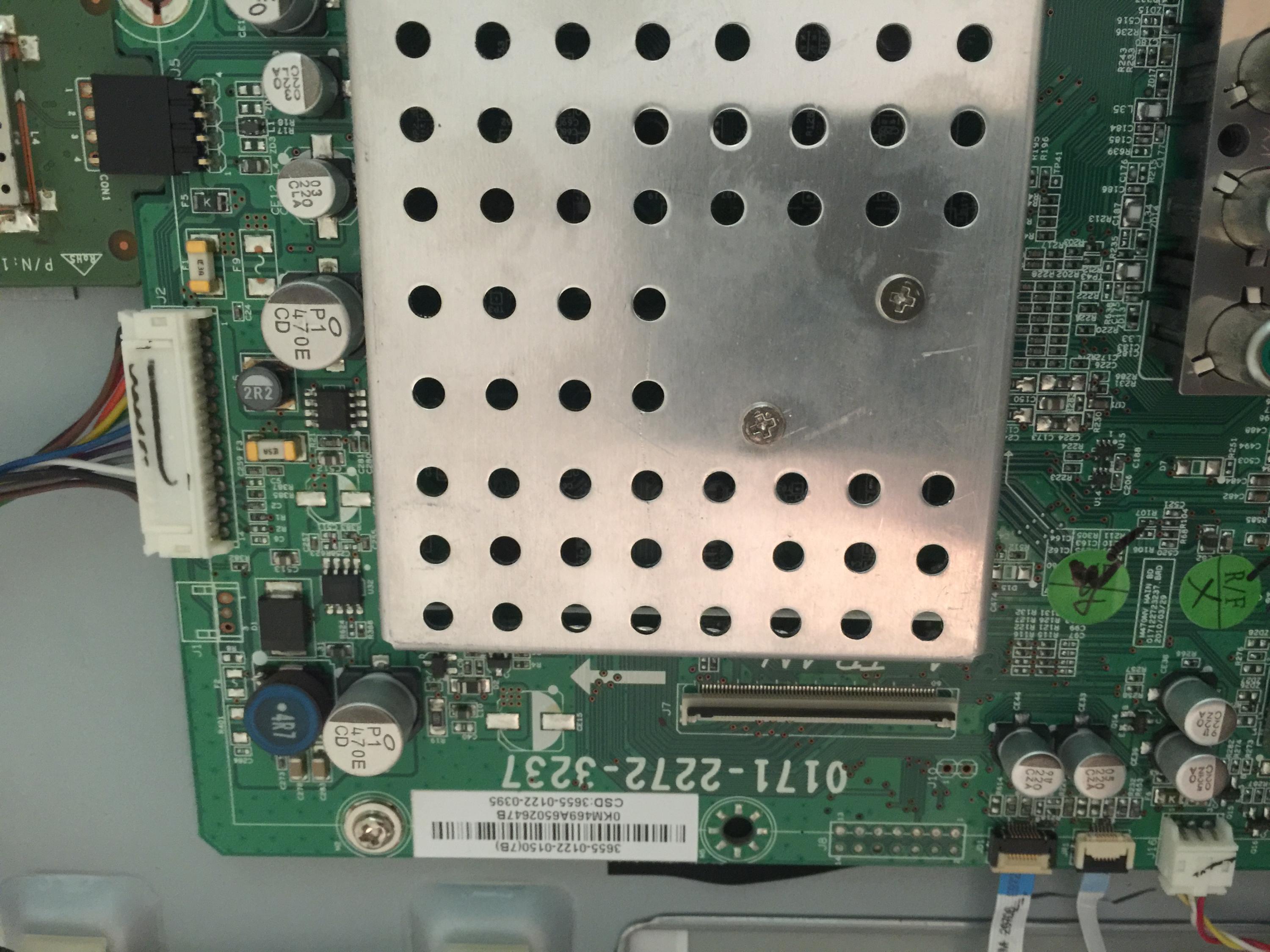

                      It's this board here: http://assets.shopjimmy.com/media/ca...0150-top_2.jpg
                      On the main board I see F1,F3, F8. Continuity tests good across them.

                              Seems like a main board problem. Any idea what to trouble shoot on there. Should I start checking the voltage regulators?

                                I did try unplugging the wifi, Bluetooth, and t-con. It does the same thing.

                                    Looks like most of these are 6 pin regulators. I only see U24 3-pin. I'm not sure what the easiest way to list this is. Is there a standard for numbering the order of the pins?
                                    Location - Labeling
                                    Top row pins
                                    Bottom row pins
                                    Datasheets are guesses. I have little electronics knowledge at this level.
                                    U32 - M11 G5684
                                    0.794V, 0.791V, 1.287V, 1.287V
                                    2.256V, 1.1mV, 4.96V, 5.10V
                                    https://cdn.badcaps-static.com/pdfs/...701cf9b10c.pdf
                                    U2 - M041 G5693
                                    5.10V, 1.816V, 1.6mV, 4.87V
                                    5.10V, 0.797V, 1.8mV, 0.805V
                                    Didn't find anything.
                                    U1 - L451 G5692
                                    5.11V, 2.525V, -0.2mV, 4.88V
                                    5.10V, 0.799V, 1.4mV, 0.805V
                                    https://cdn.badcaps-static.com/pdfs/...2949d76ef2.pdf
                                    U33 - L451 G5692
                                    5.11V, 3.359V, 1.9mV, 4.88V
                                    5.11V, 0.797V, 1.9mV, 0.802V
                                    U10 - 501H1 ? Not sure this one is very small 2 pins on top 3 on bottom and the voltage was changing on the top 2 pins. It would drop to ~0 and then go to ~3v. I noticed after the tv is on for a while and the logo now stays orange the voltage on these top pins was ~0.
                                    3.17V, 3.315V when they had power.
                                    5.11V, 2.1mV, 5.12V
                                    U24 - 7805CD2T RAJ936 G
                                    VI: -4.8mV
                                    GND: 2.1mV
                                    VO: 2.1mV
                                    U20 - HC4052 0A4L305 Un610 12D
                                    Analog Multiplexer? Didn't touch it.
                                    Let me know if this means anything. I am having a hard time understanding the datasheets. Thank you for the help.

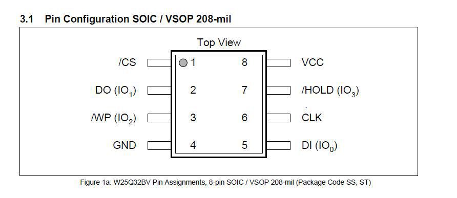

                                      Attaching G5693 datasheet.
                                      • dick_barton
                                        • Aug 2015
                                        • 6643
                                        • Wales
                                        Re: XVT553SV Vizio light flashes orange/white no display
                                        Hello Stealth71,
                                        Pin 1 of the IC often has a circle next to it like in the picture attached. Then the pin numbers follow the same layout.
                                        Can you link your voltages to each pin number which would hopefully be more meaningful.
