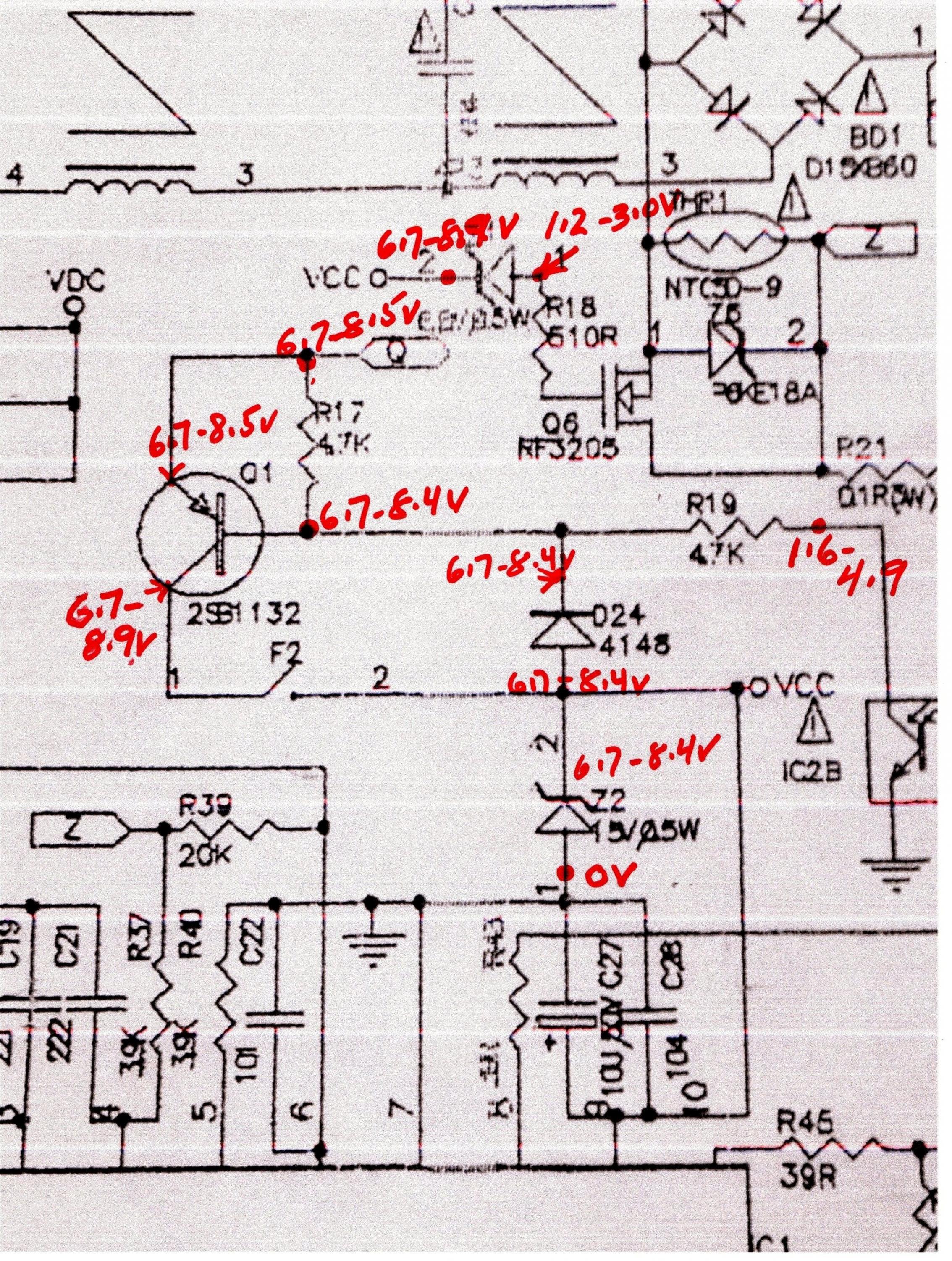

    'Pin 9 6.6-8.3v Vcc supply voltage' I think the clue is that the VCC should not be fluctuating like that.
    The VCC is generated by STBY power transformer T2 winding pin 5 and 6, the AC is rectified by D30 and filter by cap C36 (should be checked for Capacitance and ESR, or just replace it), the dc is then fed to R73, output at 'Q' VCC1 is then fed to switched transistor Q1 (2SB1132, PNP) EMITTER (check the DCV to see what you get at this point), Q1 is turned on by OPTO IC2A/B, the OPTO is turned on when the ON/OFF (PS-ON) is present. The Output (VCC is clamped by 15V ZENER Z2)) is at the Collector pin which is fed to F2 (you need to find out what the F2 device is) and filter by cap C27 (check or replace this cap) and fed to IC1 VCC PIN 9.
    That VCC is also used for turning on the SOFTSTART POWER MOSFET Q6.

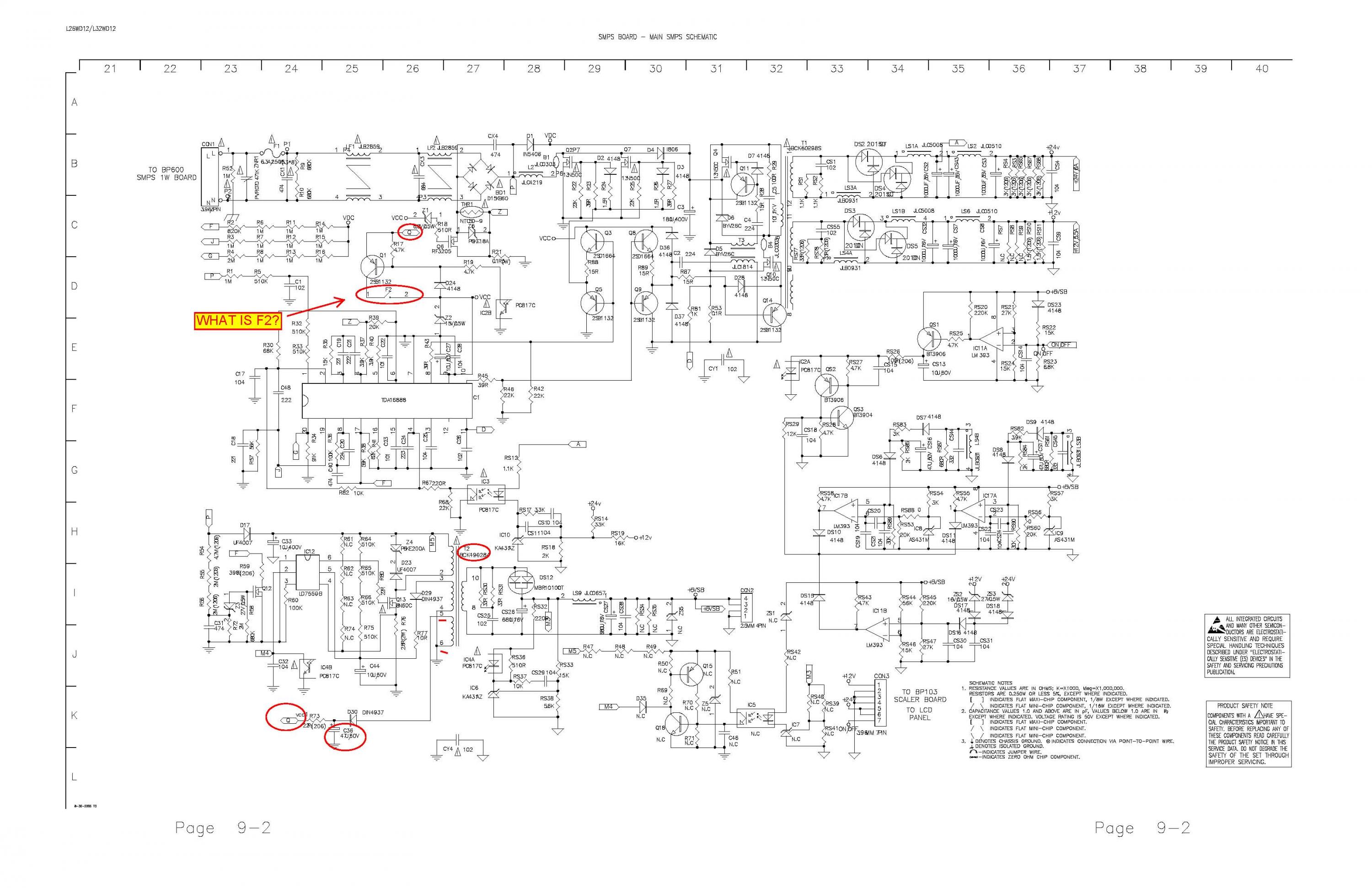

        That TDA chip does the job of running PFC and SMPS circuits.

            I just download and read the spec sheet of the TDA16888, that VCC on pin 9 of the TDA :Pin 9 6.6-8.3v Vcc supply voltage per your reading is way below the under voltage shutdown point. What did you use for the GND point for the meter.
            Page 20:
            Undervoltage Lockout
            Vs,up is 14V Typ.
            Vs,dwn is 11V Typ.

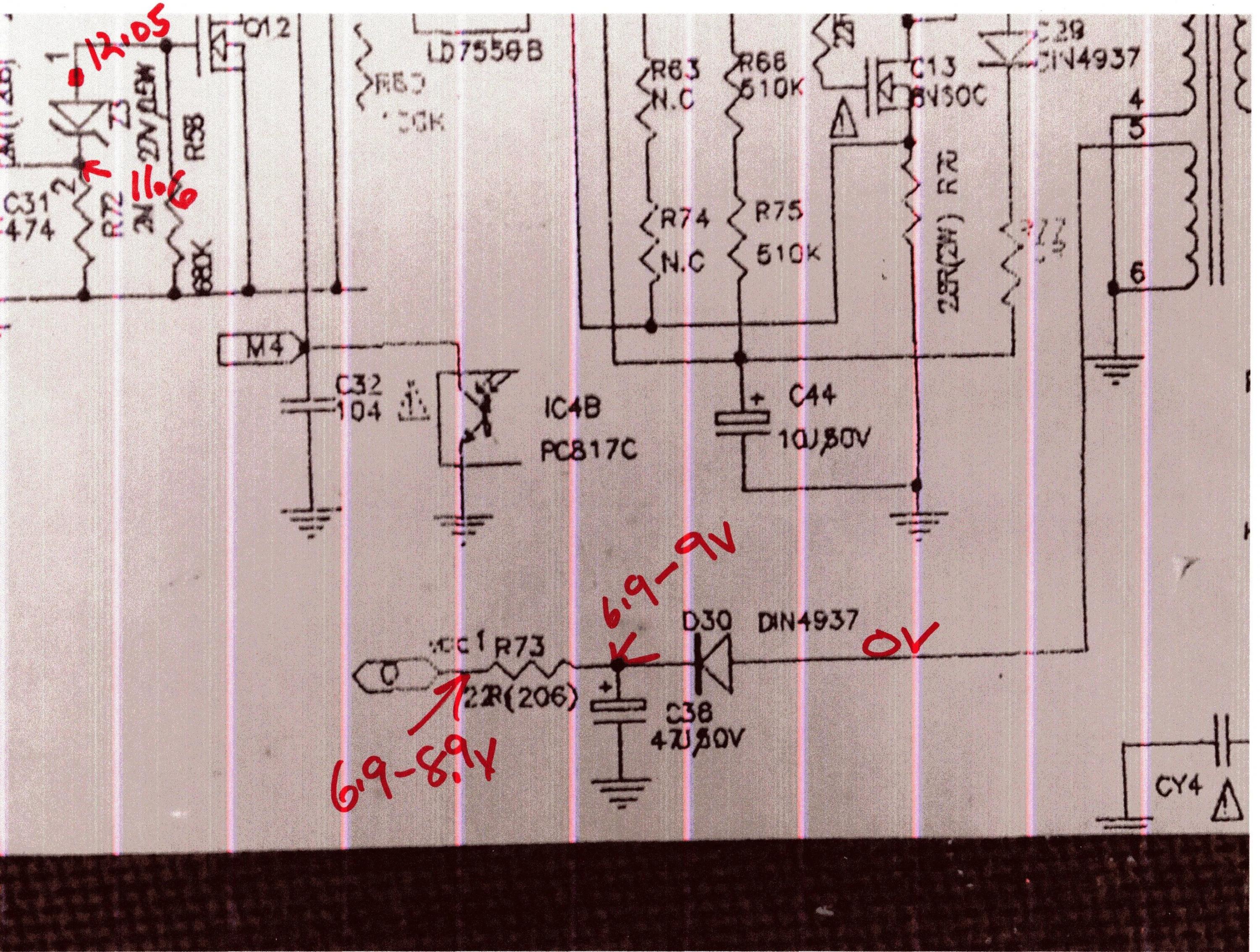

                    #169
                    Re: troubleshooting TV SMPS sequence
                    BudM and CapLeaker.
                    you guys are something else!
                    ok made some resistance measurements and voltage measurements.
                    first, I found a direct replacement for Cap C36 47uf 50V. replaced it.
                    R73 marked 220 22ohm resistor, measured 21.6 ohms
                    R17 and R19 were marked 472, 4700 resistor, measured 4600 ohms.
                    The voltages measurements were made with the main cap NEG lead as my GND lead to the DVM.
                    attached are two photos of schematic with voltage readings. I can do this all over again if needed, if there is something that may not be clear. just tell what you need.
                    getting closer??
                    thanks guys!!!
                    ilikesteel

                      #170
                      ilikesteel:
                      just to understand correctly, you changed out the C36 first before you made that measurement there. If it is, that trashes the bad capacitors idea on the line flagged Q, which feeds Vcc to the PFC combi IC. That means the problem has to be before that again.
                      IC2 is a LD7550B PWM. There is C44 on the pin5 (Vcc) of IC2. Check that. The turn on voltage is 16V. The Feed Back (COMP) is pin 2. I wonder if that is pulsing too?

                          #172
                          CapLeaker-BudM,
                          Hell, I couldn't wait for tomorrow to check it!!!!
                          I found a replacement for C44 10uf 50V. changed it. I believe the ld7550b is actually IC#12. I followed trace and made sure we're talking the right component.
                          are you ready for this???
                          Main Cap now has 384V STEADY
                          checked voltage on + side of C44 which goes to Pin 5 Vcc on ld7550b.
                          measured 12.54V STEADY!!
                          measured Pin 2, feedback comp, 2.09V STEADY.
                          Changed GND connections and Measured the +12 and +24V. they measured 11.85V and 24.0V STEADY.
                          I think we (all of YOU) did it!! I was just the shlep being guided by great minds. tomorrow I will reconnect all cables and stuff and then fire it up. I don't have any input for it, but I should get the black and white confetti screen, also menu boxes should display, right?
