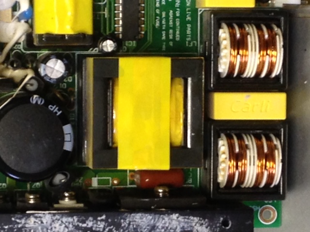

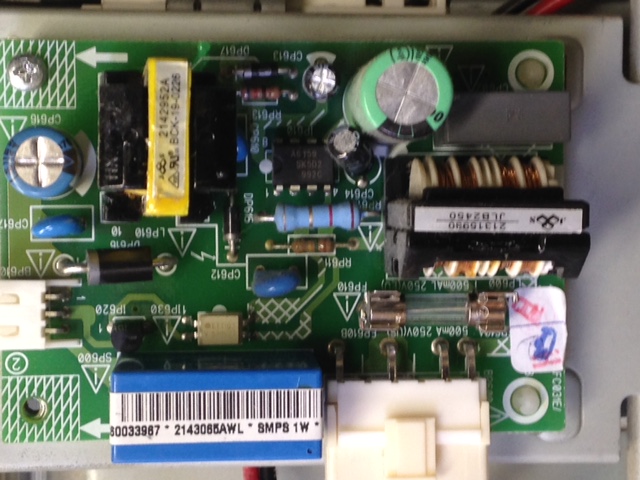

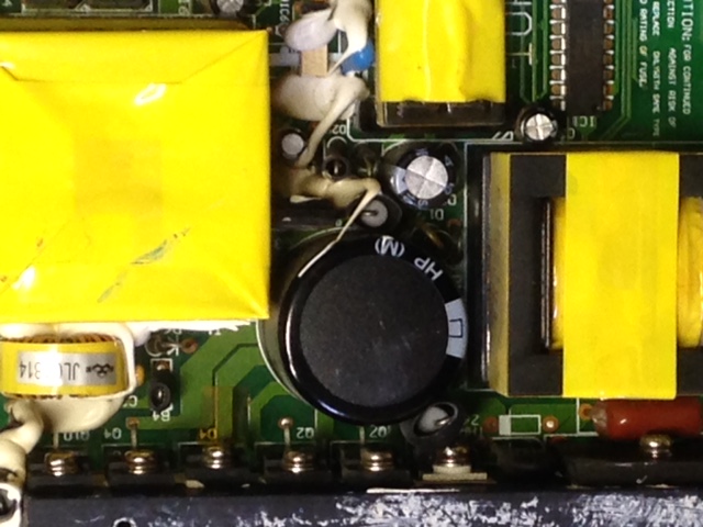

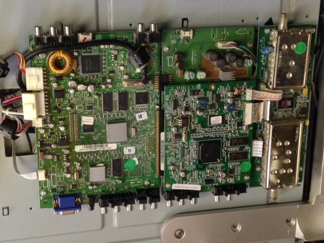

                                    #97
                                    Re: troubleshooting TV SMPS sequence
                                    CapLeaker, Budm,

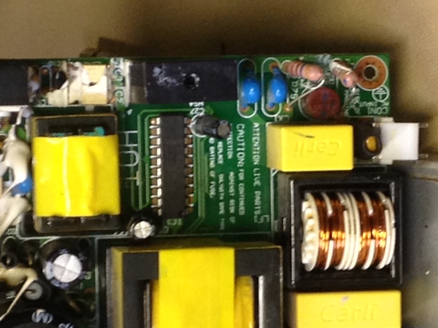

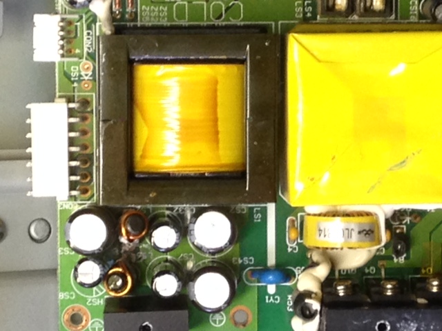

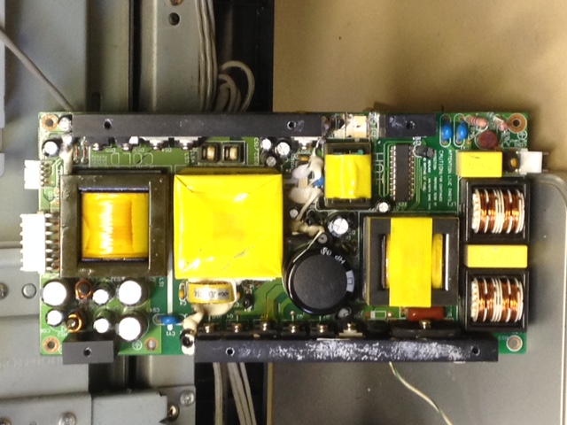

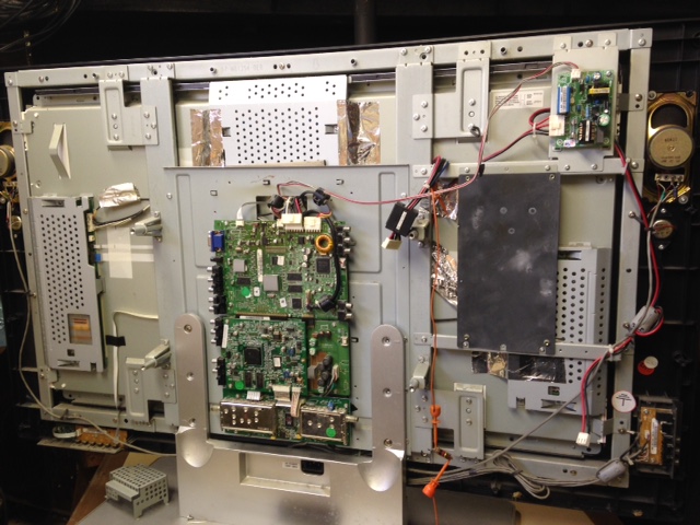

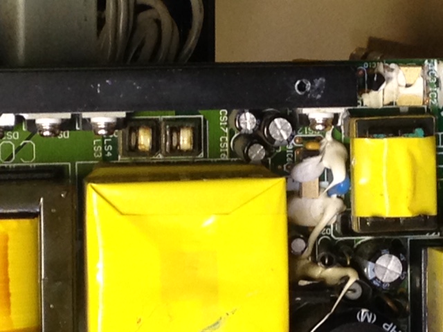

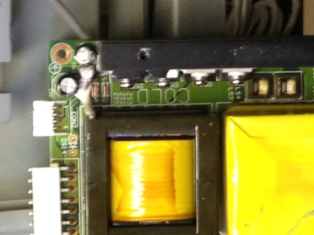

                                    attached are pics of the tv boards. I did sectional pics of PS.
                                    TV is RCA L37WD12. the very small board at the top right is the 1W 5V STNDBY voltage board.
                                    I reattached the PS to the TV, connected all cables. I did not mount PS to chassis.
                                    The main cap still shows 359V-360V with set fully powered on.
                                    I checked the voltage at the common cathodes of DS3 and DS5 for +12 rail, and also at DS2 and DS4 for the +24V rail.
                                    The readings were the same as when I first checked the TV.
                                    +24V rail showed +19.0 - 21.9V
                                    +12V rail showed +1.5 - 2.1V.
                                    any help with readings right at the diode junctions?
                                    Thank you all again.
                                    ilikesteel
                                      #98
                                      The whole thing does not make sense to me yet, since the 24V and the 12V are generated by the same transformer, the outputs are regulated by monitoring the output Voltage of both 12V and the 24V as you can see in the diagram, the resistor RS14 for the 24V and RS19 for the 12V.
                                      Can you remove inductor LS6 from the board and see if you will get 12Vdc between the two legs of CS32 (1000uF 16V)? if still no Voltage, then remove CS55. We have already verified that the inductor LS4A, LS1B, DS3, DS5 are OK. I am beginning to think there is something bad in the winding between pin 10, and pin 11 of T1.
