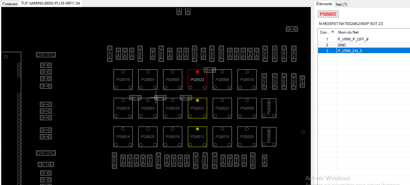

    Hello, I have an issue with the motherboard. Specifically, it doesn't power on, more precisely, the POST initialization doesn't occur.
    Let me start from the beginning, the motherboard suddenly stopped working one day. There are no beep signals from the speaker, and the debug LEDs are not lighting up. After inspecting it under a microscope and using thermal imaging, I didn't find anything that could be damaged.
    After that, I began voltage measurements, in which I noticed the absence of VDDQ, VDDP, VTT, and VPP lines. Later, I checked if there is an EN state on these lines, and there wasn't for VDDQ and VPP.
    I tested the motherboard with two different processors. Based on my measurements, I suspected that the NCT6798D-R might be damaged, but even after replacing it, the same problem and results persisted. When I checked with an oscilloscope, there was nothing in the SMB.

    PQ5018:
    1 0.755V P_VRM_12V_EN_10
    2 0.138V P_+VCORE_EN_5V_10
    3 0.2V P_VRM_Q_EN#_10
    PQ5019:
    1 0.686V P_VRM_5V_EN_10
    2 0.0626V P_+VCORE_EN_3V_10
    3 0.138V P_+VCORE_EN_5V_10
    PQ5020:
    1 0.635V P_VRM_3V3_EN_10
    2 0V GND
    3 0.0625V P_+VCORE_EN_3V_10
    PQ5021:
    1 0V GND
    2 0.189V P_VRM_Q_EN#_10
    3 0.0047V P_VRM_EN_5
    4 0V GND
    5 0.0047V P_1V2_M#
    6 0.0020V P_VRM_EN_5

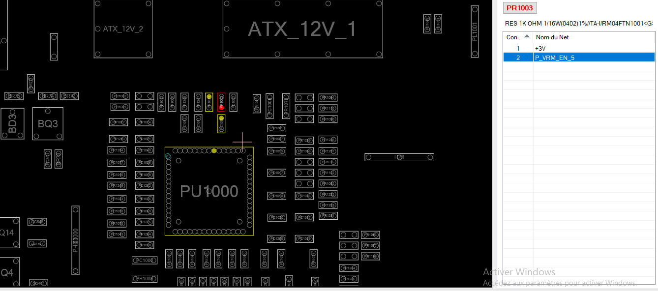

    Trace where the VRM_EN signal is coming from and what voltage it should be when it's working normally. If there's a component that generates this signal but doesn't work, remove it or disable it, and then inject voltage into VRM_EN to see if the rest of power up sequence will continue and mobo will start.

        hi
        i was able to fix it
        the problem was in the 12v sense resistor for pwm and the enable signal for the pwm coming from a mosfet (changing the mosfet didn't fix it i had to jump it)
