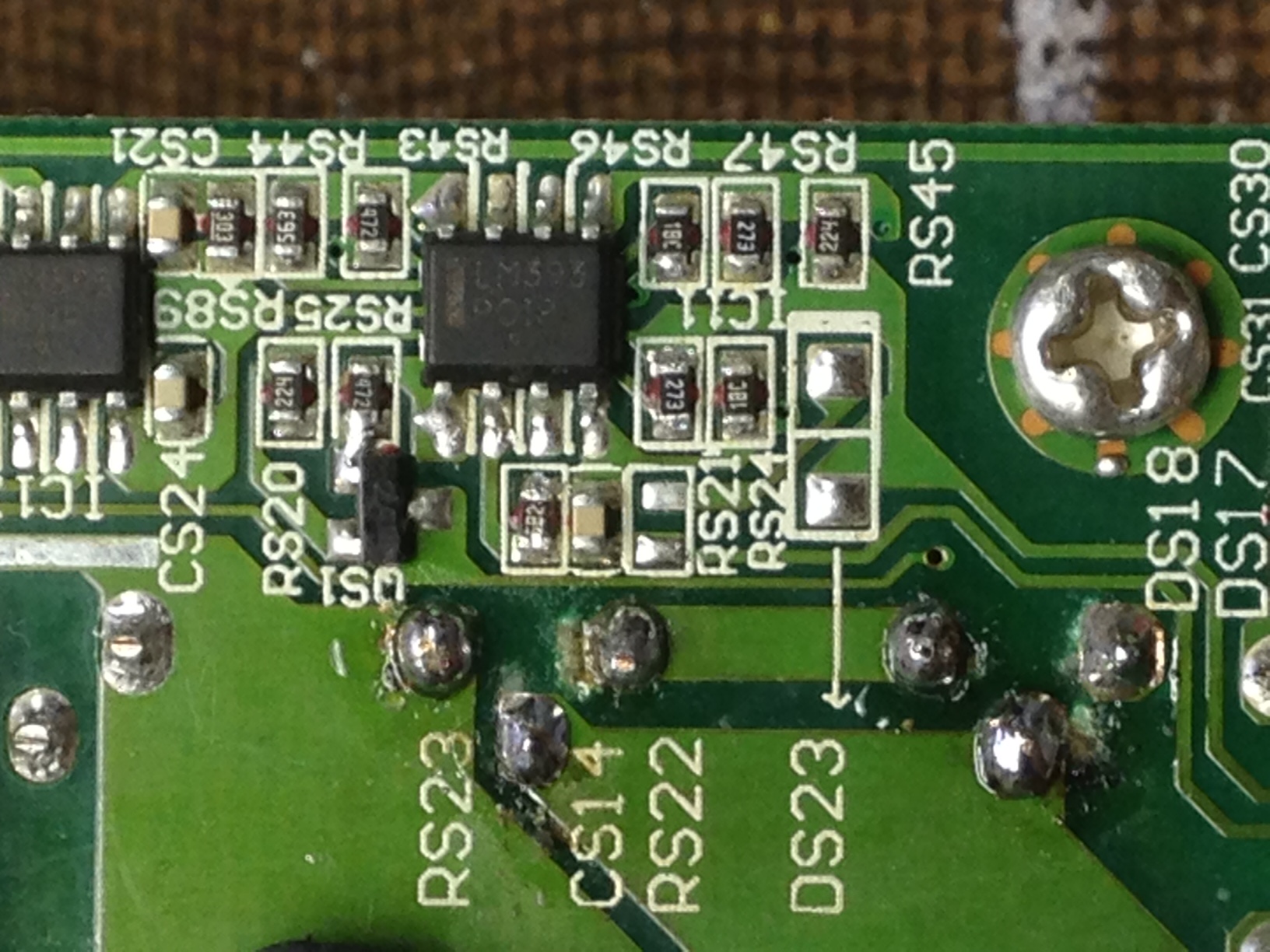

      ran into a dilemma trying to put a 1K resistor from junction of RS22 and RS23 to GND.
      first I re-soldered the DS3 and DS5 diodes back on the board. I re-soldered the transformer, caps, and coil connections on both supplies.
      when I went to identify the resistors RS22 and RS23 on the underside of the board, RS22 appears not to be on the board. it looks like a blank space where it should be.
      RS23 is a 6800 ohm resistor. the marking on it indicates that (682). it truly measures 6.8K across the resistor.
      RS22 should be a 15,000 ohm resistor (153). there are no resistors in that area marked 153. Also, on the schematic, RS24 should be a 15K ohm resistor, but it's not. It's marked 18 followed by a 0 or a C.
      there's a blank for RS22 and also for DS23 which the cathode should be connected to RS22 as shown in the schematic.
      I haven't tried applying power to the supply. I thought I should check first with you guys to see what the next step should be.
      Thanks,
      ilikesteel

        My apologies. here's a close up of the underside of the PS for the parts we're talking about. sorry!
        ilikesteel

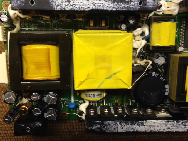

          It can't be any simpler. T1 has 2 secondaries, 12-14 is for the +24volts. 10-11 is for the +12 volts, These supply a/c (20-30 khz) to ds3 and ds5 which rectifies the a/c to dc and goes through ls1b and is filtered by cs32 and cs7. the dc also flows through ls6 and is further filtered by cs8 which gives you +12 volts.
          Try and measure the ac coming from the transformer, 12-14 should be close to +20vac
          10-11 should be around 10vac depending on the meter etc.

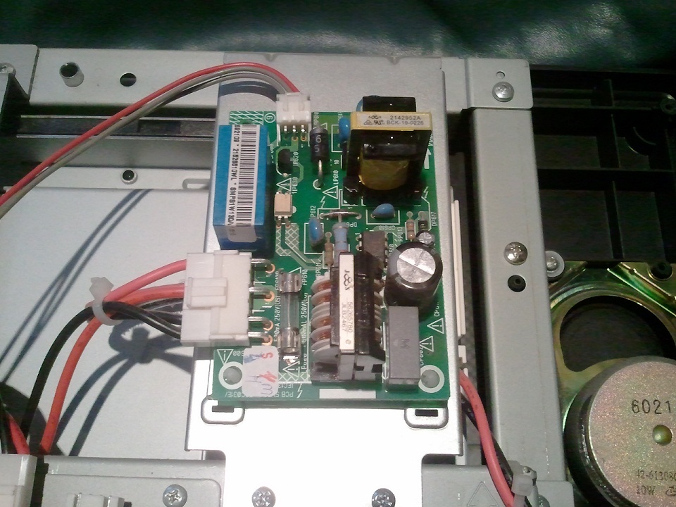

            separate 5V stndby on a small board. that's working. remote turns on the relay on the stndby 5V supply and that allows the 120vac to be applied to the main SMPS.
            main SMPS shows 20V on the +24 rail and 2V on the +12 rail. I removed the PS connection, Conn3 which has all the outputs going back to the scaler board. so there is no load on the main SMPS. I still get the same results.
