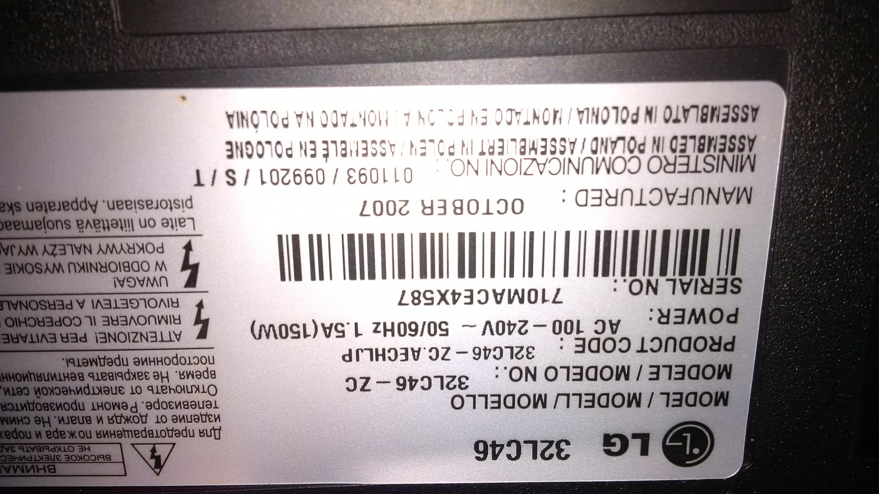

    LG 32LC46 Model 32LC46-ZC not turning on or showing any sign of life.
    This 7 year old TV is like new, but sadly doesn't work at all. Just to be clear, there is absolutely no sign of power.
    It just would not switch on one day. I moved it about and it came on but then went off.
    I replaced the power cable and even removed the back to ensure there was life going to the power supply (which there is) but am frightened to go any further.
    Any advice on next step would be greatly appreciated.

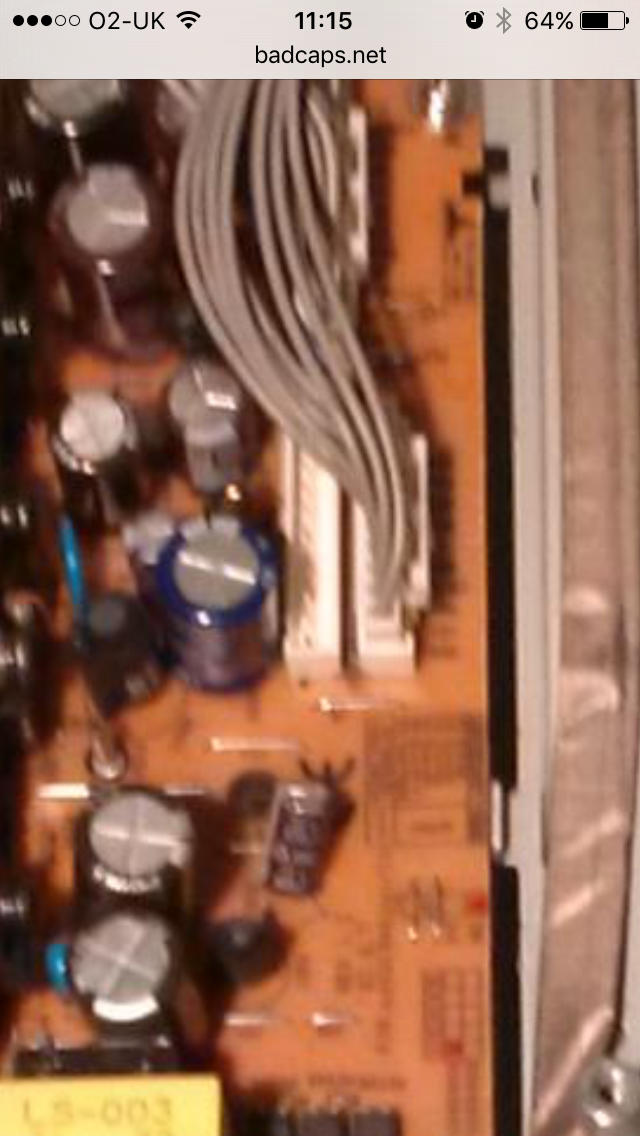

            Re: LG 32LC46 Model 32LC46-ZC not turning on or showing any sign of life.
            images attached - even when there is no sign of power and the LED light won't come on there is still 240V on either side of the fuse as shown.

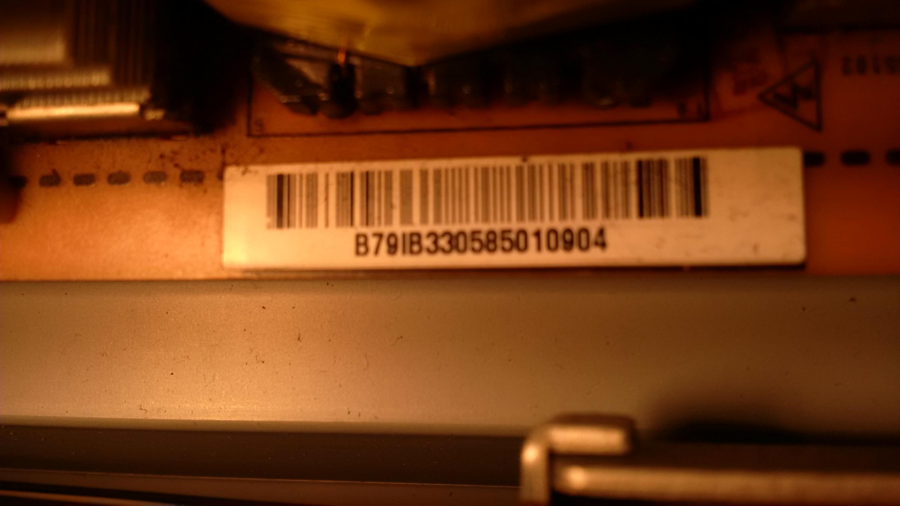

              2) What is the power supply board P/N as shown on the barcode sticker?
                The part number looks like B791B330585010904 and I've tried to attach an image of it.

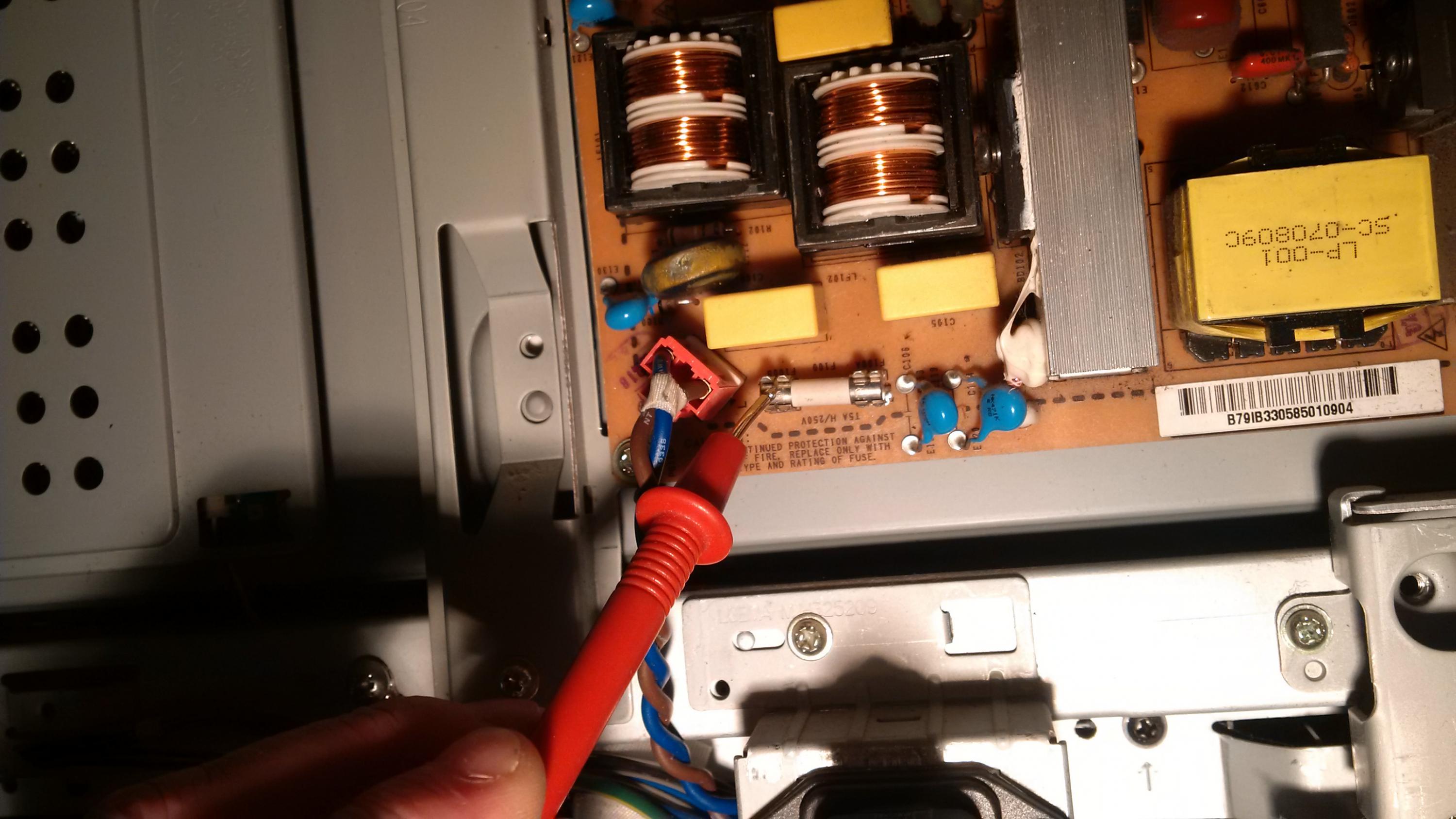

                  Not sure if this is what you have asked for but the blue negative cable has a label with E13933B (or maybe the B is an 8). There is NO AC voltage between it and earth chassis.
                  The red live cable has a label with 600V FT1 22AWG and it has 232V AC between the terminal and earth chassis.

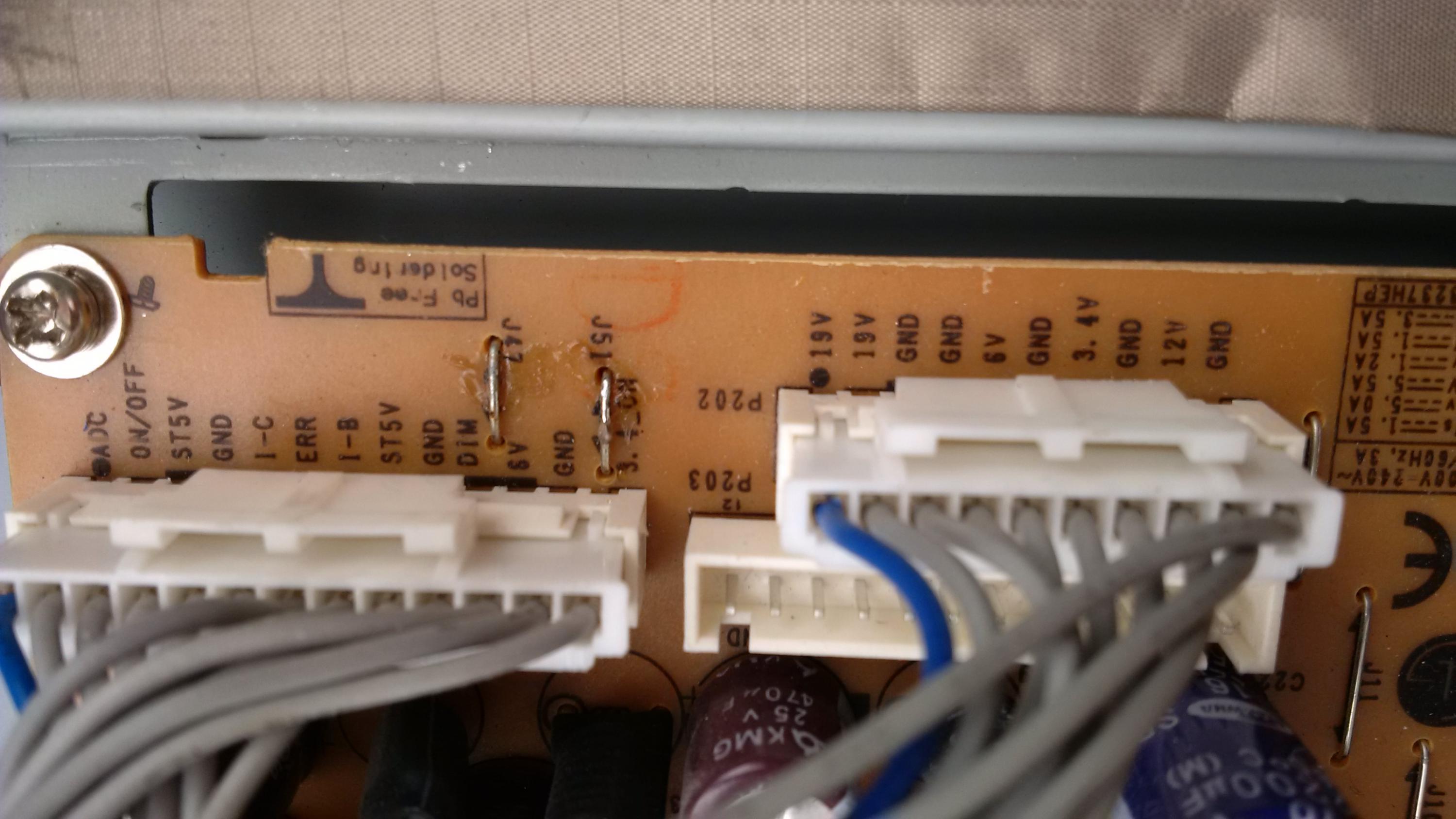

                        Apologies for confusion. I have now attached an image of the pins for the 2 connector blocks. Their details are below -
                        1 AOC - 5.09
                        2 ON/OFF - 0
                        3 ST 5V - 5.09
                        4 GND - 0
                        5 I-C - 0
                        6 ERR - 0
                        7 I-B - 0
                        8 ST 5V - 5.09
                        9 GND - 0
                        10 DIM - 0
                        11 6V - 6.08
                        12 GND - 0
                        13 ???? - 0
                        1 19V - 18.47
                        2 19V - 18.44
                        3 GND - 0
                        4 GND - 0
                        5 6V - 5.95
                        6 GND - 0
                        7 3.4 - 0
                        8 GND - 0
                        9 12V - 11.82
                        10 GND - 0
                        To take these DC voltage readings, I removed the connector blocks from the board and connected the probes between the earth chassis and each pin in turn.
                        Pin 7 on the second block should I assume have a 3.4V but has 0
                                  https://www.badcaps.net/forum/attach...8&d=1444936903

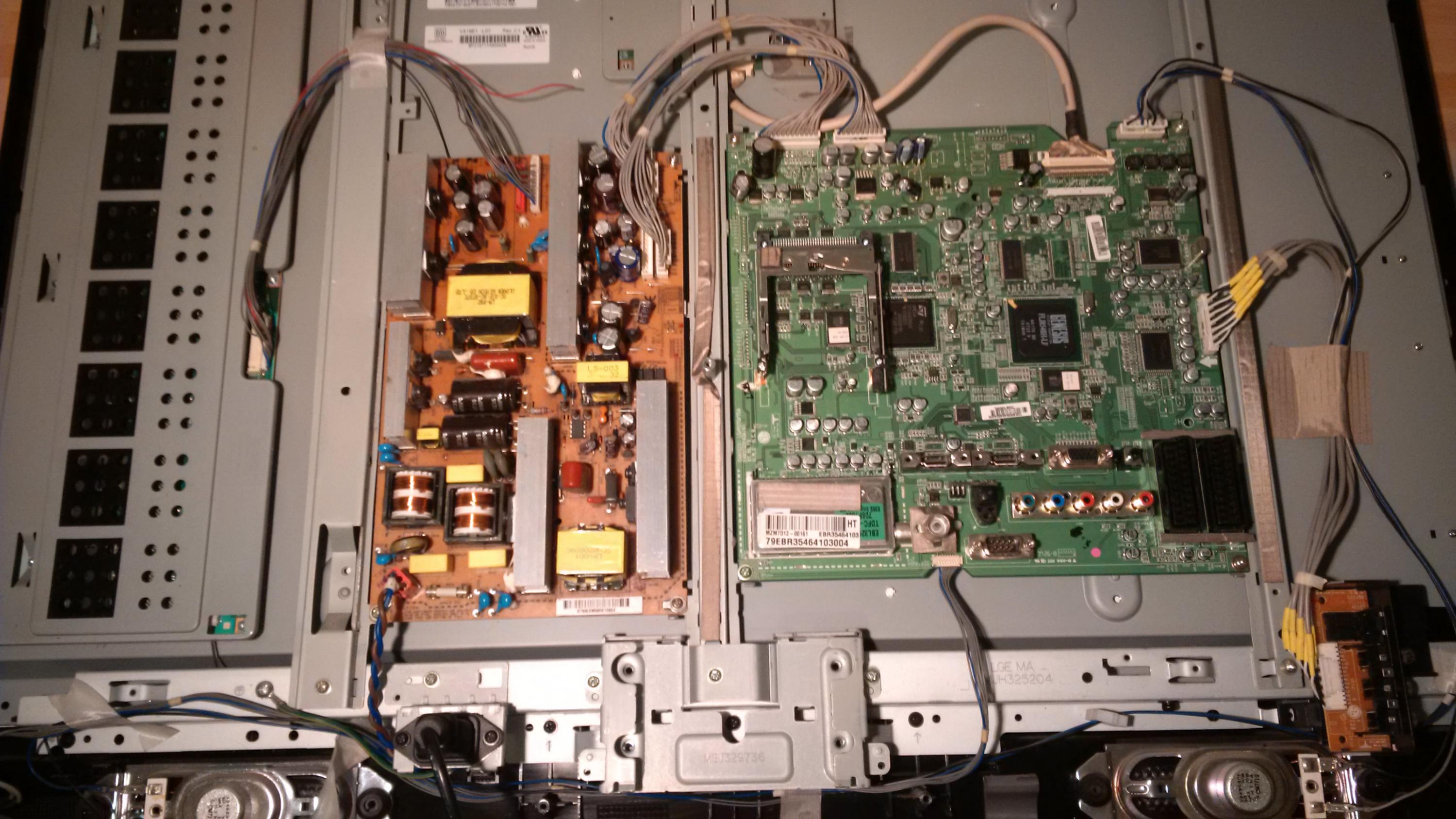

                                  What is that hanging red wire from the inverter board?
                                  So you do have pilot lights, one signal that does not look right to me is the:
                                  10 DIM - 0.44 which looks to be too low for the backlights Dimming signal.
                                  BTW: 1 AOC - 5.04 is actually ADC (AC DETECT signal).
                                  Your Voltage readings looks normal except the DIm pin 10.
                                    There is both a red and a black wire suspended neither of which look as if they have ever been connected.
                                    The part number looks like B791B330585010904 and I tried to attach an image of it in an earlier post.
                                      Sorry, I found the board on SHOPJIMMY.
                                      Those wires should not be floating around like that, need to find which pins on the inverter connector they are connected to. Did any one else work on this TV before you?
