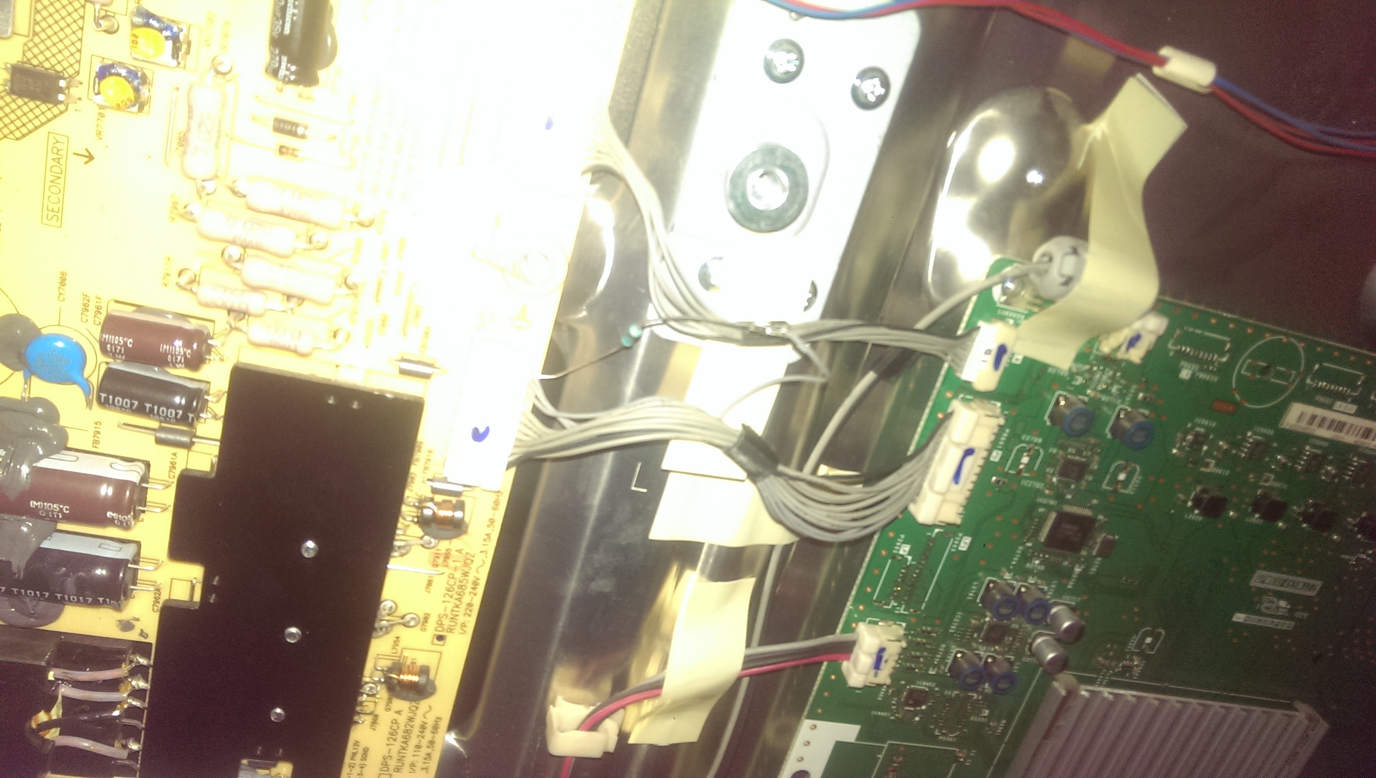

    I added quick photos I will post more, when You allow me to solder that.

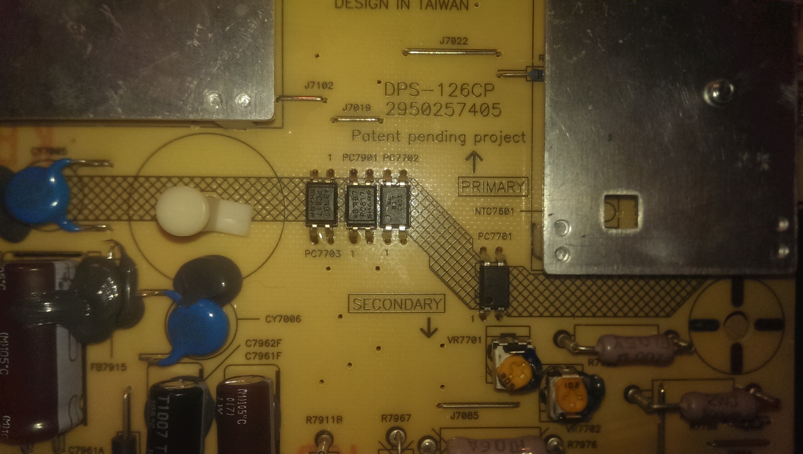

              The first thing to check is that the optos are fitted the correct way. They dont all face the same way. Take a clear photo of the top before you do anything else.

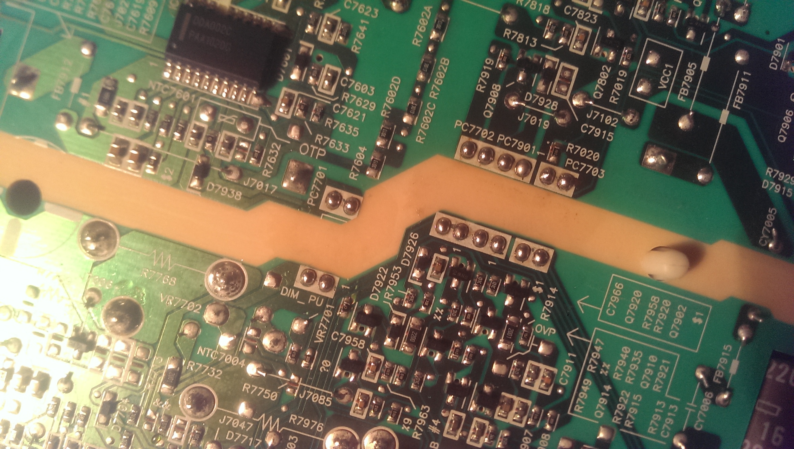

                  Here are photos, after I changed all optos. I noticed they are not same brand. 2 of them were sharp and 2 of them different. Also I checked if I am fitting them in correct way. There is sign 1 on motherboard for dot in left top corner. Also there are marks on side and motherboard like half circle. So I am sure I fitted them correctly.

                    Re: Sharp aquos LC-40LE810E
                    Here are photos after I put all original optos back. You can check, they are in same position. I added photo from shopjimmy so you can check they are really in proper way. Also photo of that red led. Red led is not still on. It is flashing like: maybe 20 seconds on, off for few seconds afaing 20 seconds..... after few flashes, led will turn off and nothing else happens.
                    I was not using TV with this fix. I tried that once, when I first tried for maybe 30 seconds until I took photo.
                    After opto change, it started to act like that. So how bad is it? All pins have same voltage. If you need more info just let me know.

                          Yes, try that. We need to see AC_DET go high, Also measure the voltage on both pins on the middle opto on the secondary side, the side that is closer to the power supply output. Normally they should be 5v and something a bit lower than 5v.

                            The opto for the AC-DET is PC7703
                              #54
                              I made a mistake before. PC7703 is the lower one.
