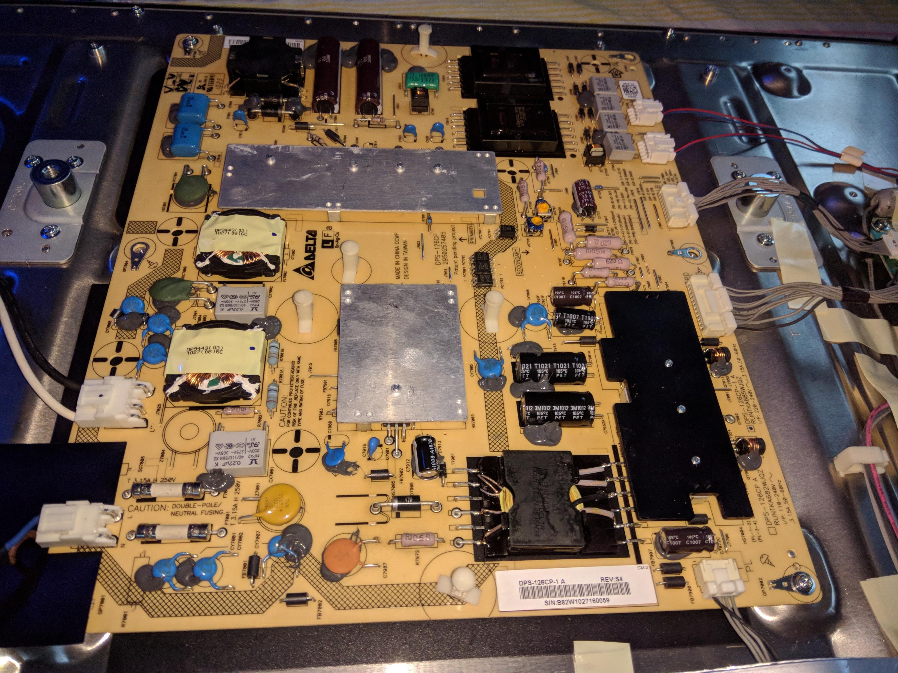

                Measure some pin voltages on the PD connector as the TV is being turned on.
                Look at post 21 as an example.
                I mainly want to know what happens at pins 1 and 9.

                      I also measured the pf Voltage of PC7703 with these reults which immediately drops to zero like after 7 secs or so
                      PIN 3= 4.74v
                      PIN 4= 4.90V
                      • rievax_60
                        • May 2012
                        • 897
                        • australia
                        #111
                        Re: Sharp aquos LC-40LE810E
                        Those voltage readings show that the AC-DET is working properly.
                        There must be something else wrong, Does the voltage on pin 1 disappear after 7 seconds also?

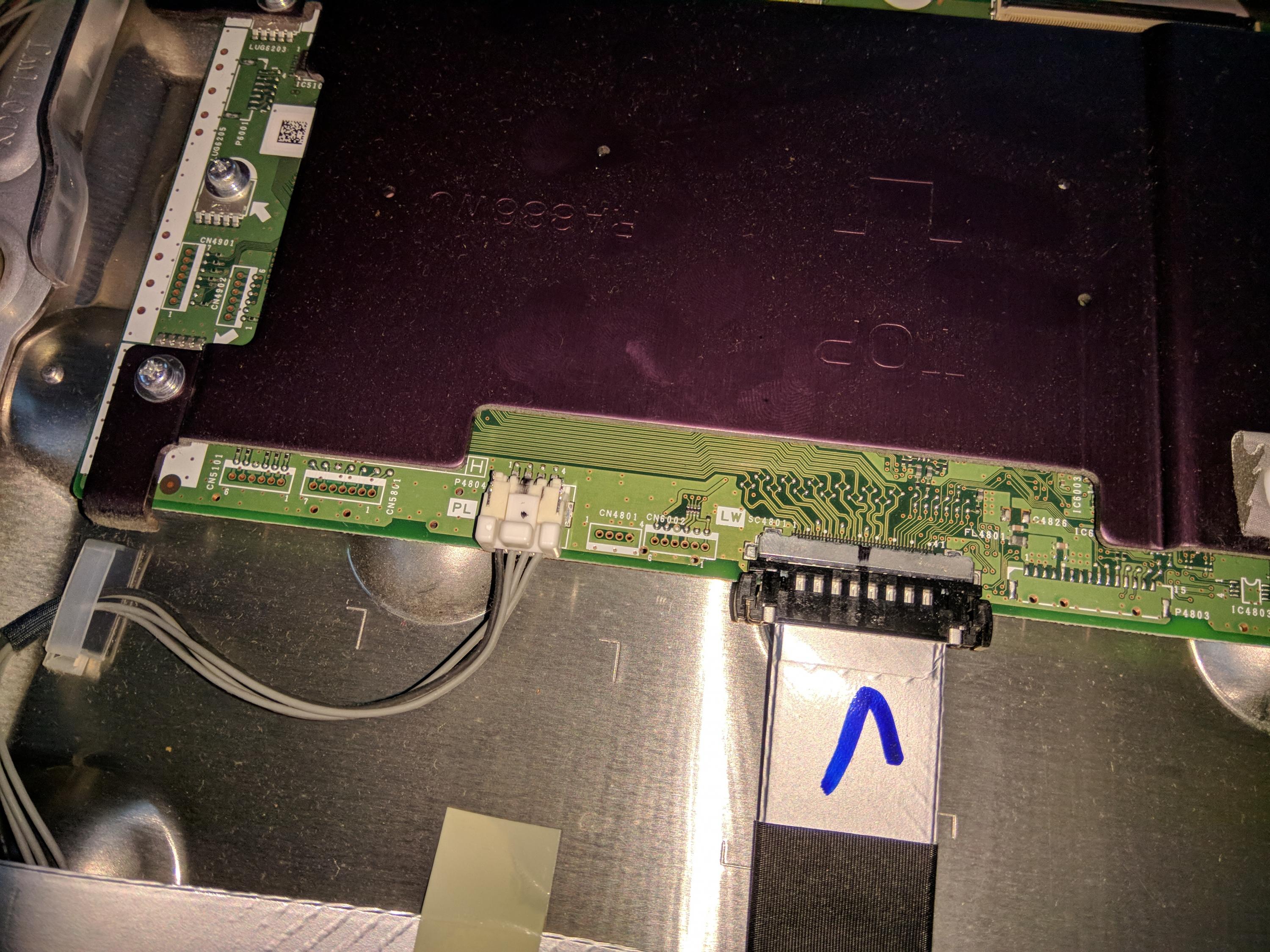

                          Since you do have 3.25V PNL-POW control signal, so do you get 12V at the PNL-12V connector pin?

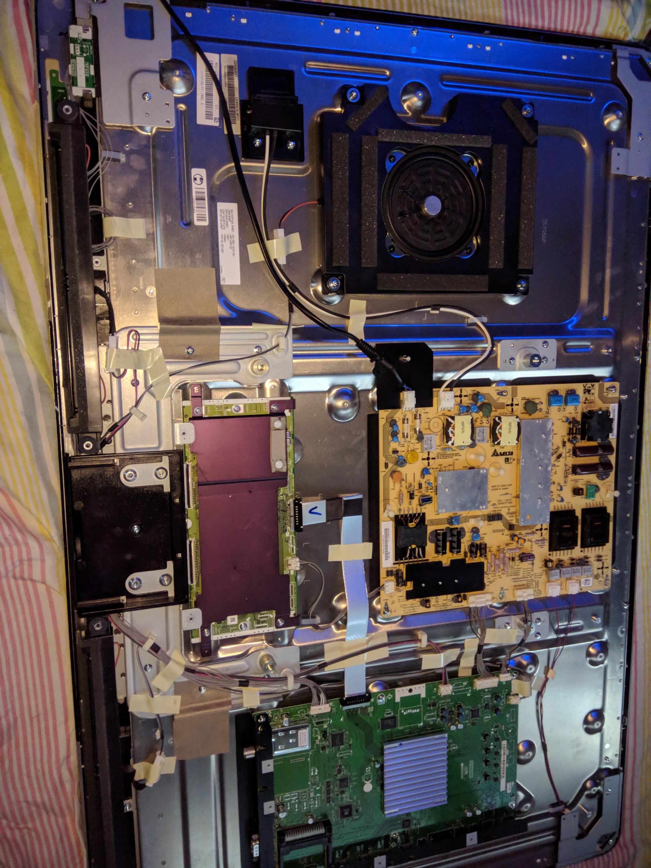

                              #114
                              Sorry I am novice so a little confused where can I please locate PNL connector pin??
                                #115
                                Please upload good clear pictures of YOUR board.

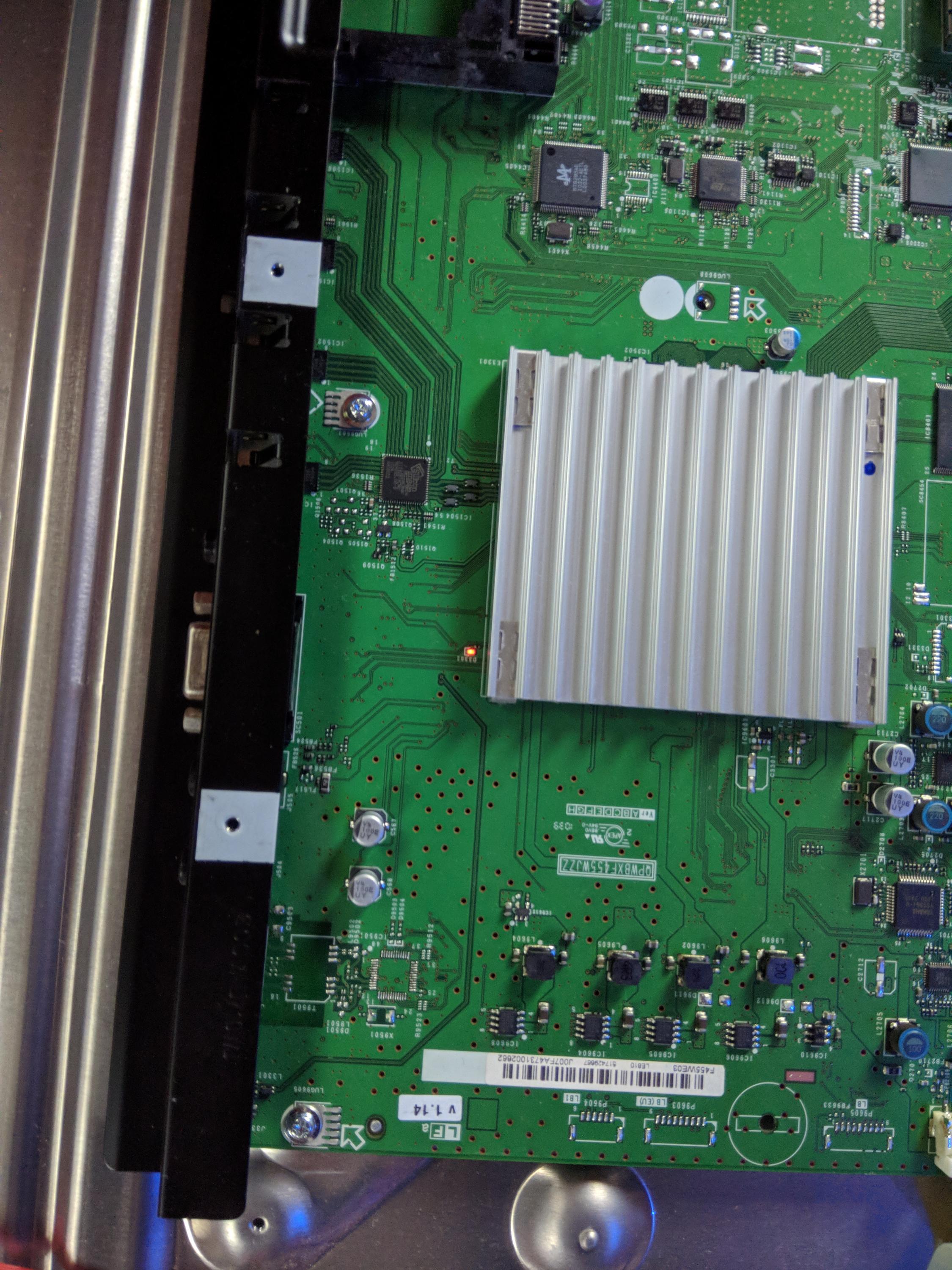

                                • Jstone86
                                  • Jul 2018
                                  • 20
                                  • Ghana
                                  #116
                                  Sorry for the late response. I have been having troubles in uploading the pictures here

                                        So which way forward? At the moment am not sure about the next step to take maybe Budm can throw more light in regards to 12V PNL connector pin which I can't located on the motherboard except PL on the inverter board. Can guy help me located PNL-12V connector pin since guy have same TV model
                                        • rievax_60
                                          • May 2012
                                          • 897
                                          • australia
                                          #120
                                          PNL-12V should be pin 1 of PL connector.
