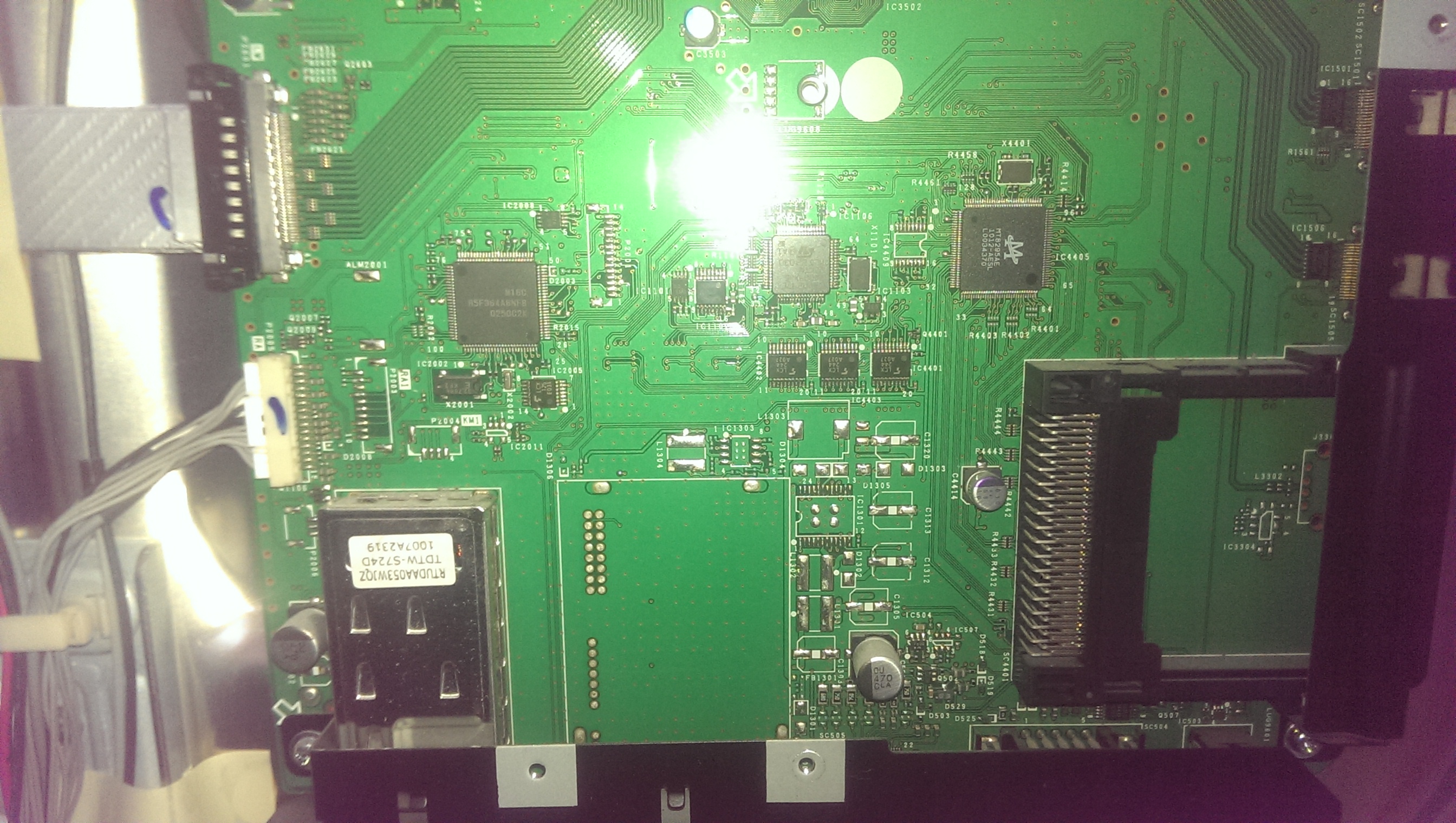

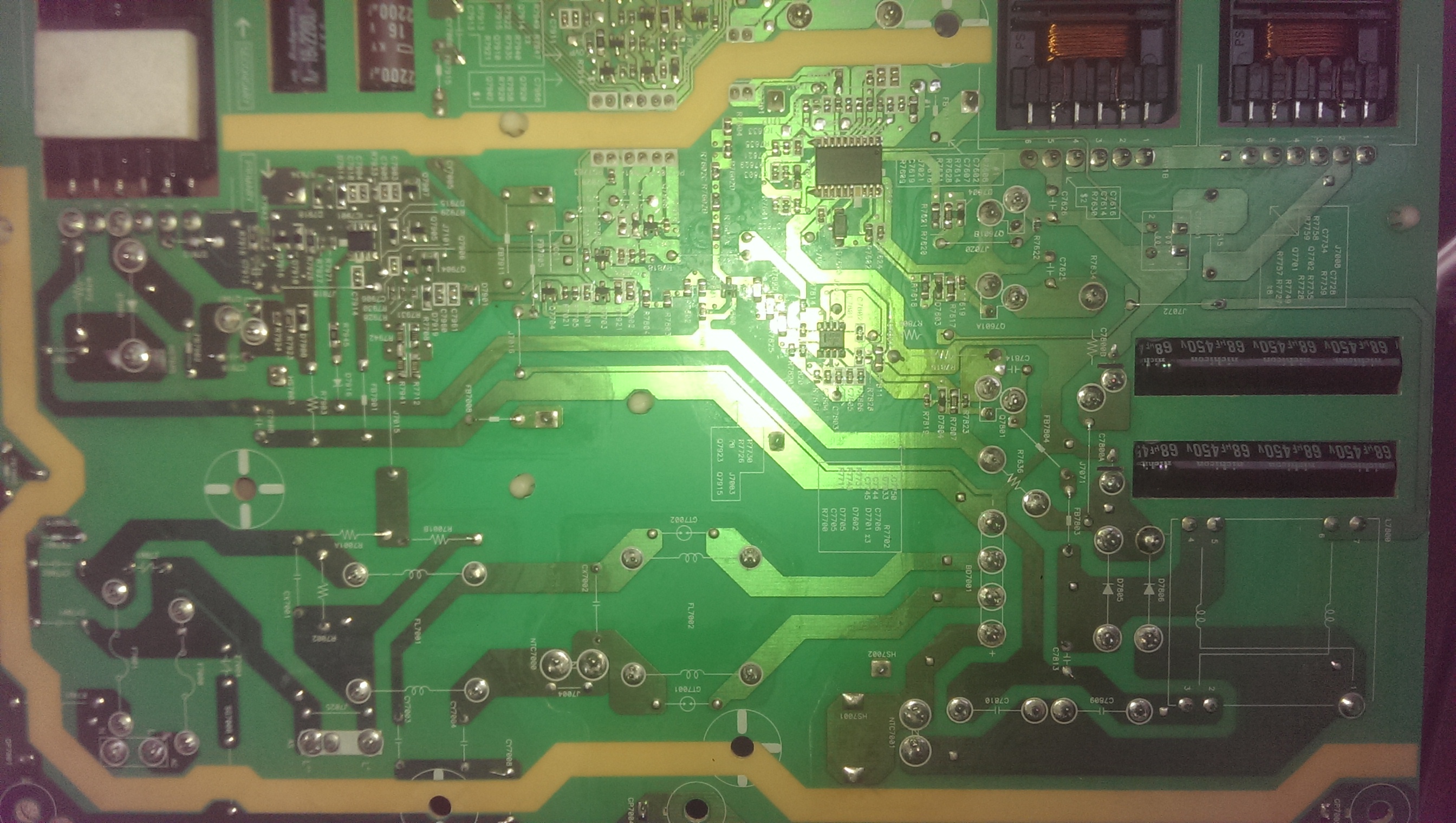

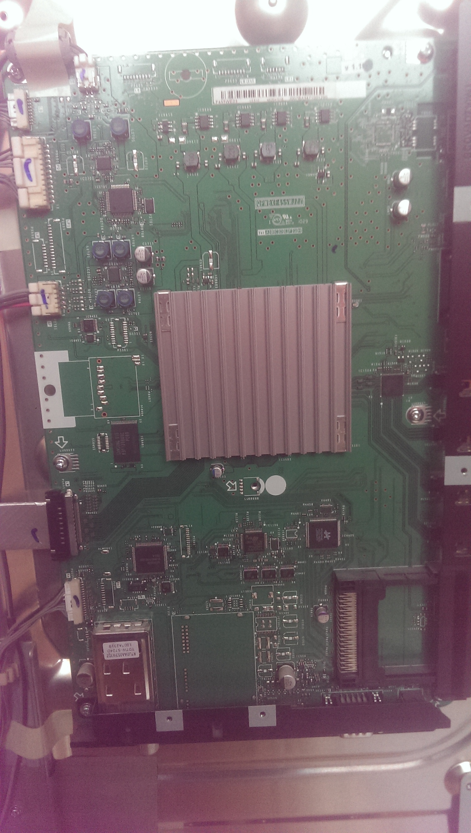

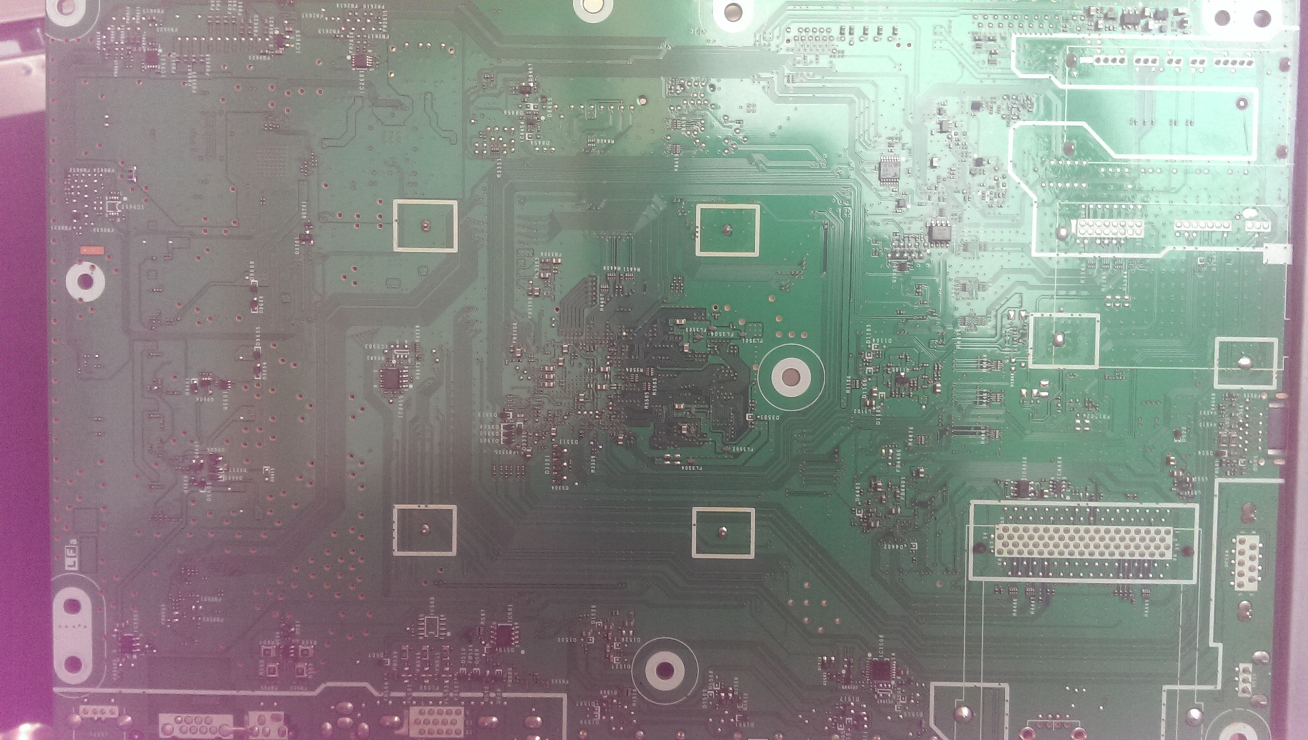

              Re: Sharp aquos LC-40LE810E
              Hello

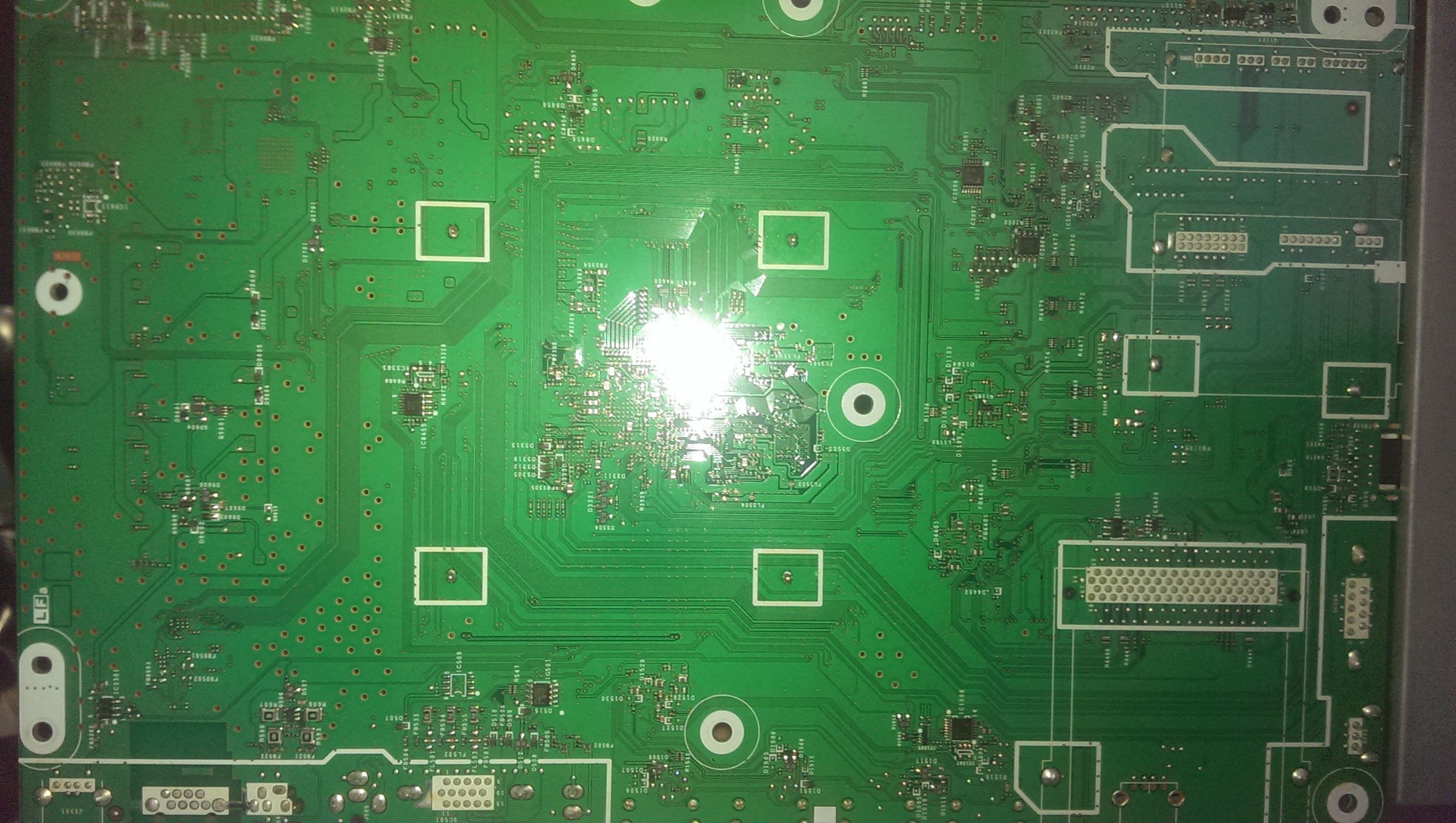

              Sorry it took me so long. I fall asleep after night shift. Here I uploaded some photos of power supply and mainboard. I hope you can see everything you need. If not, just let me know. I will try to take better photo.

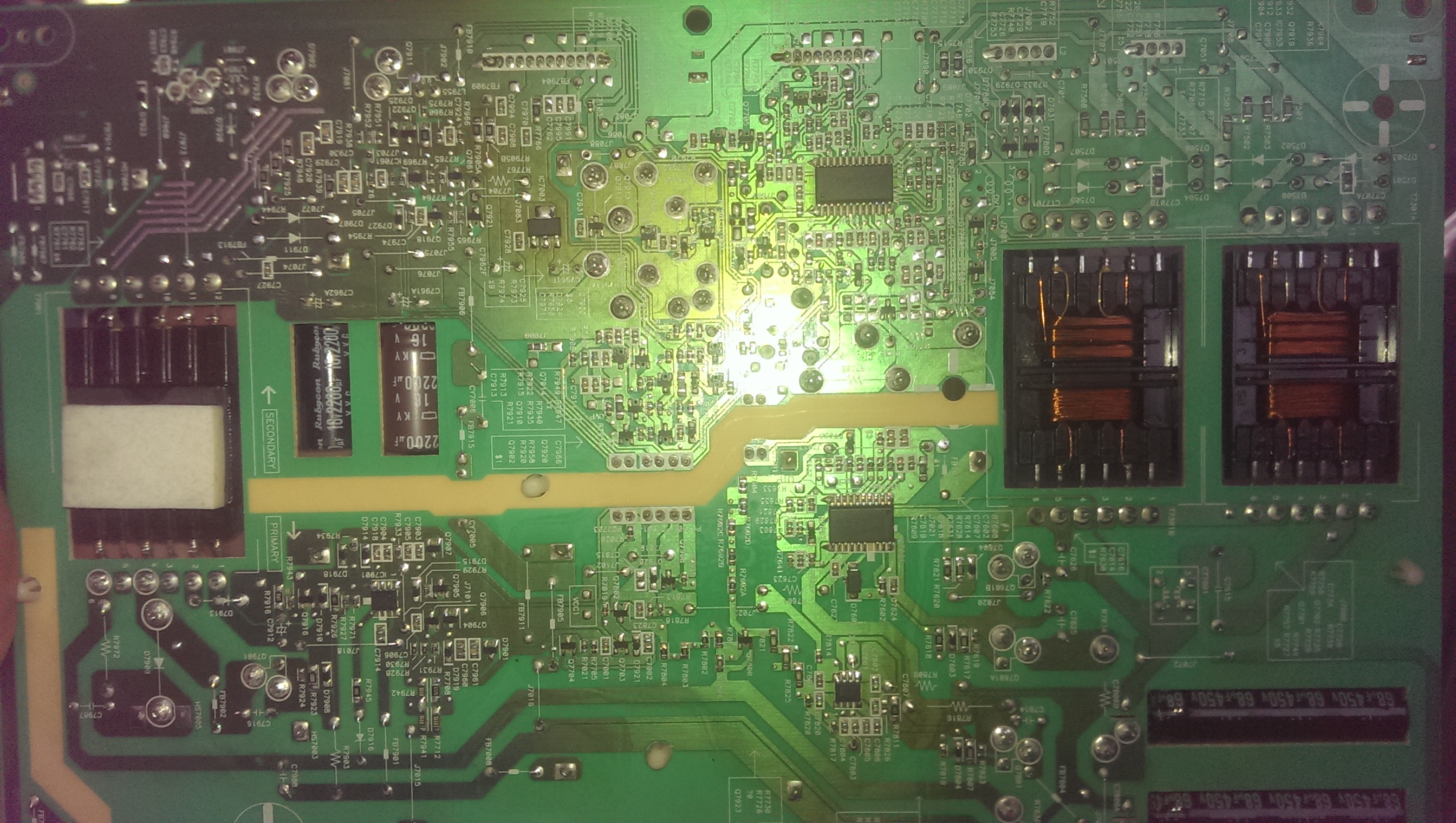

                          Your pictures of your power supply board (DELTA DPS-126CP-1A) are cloudy and not in focused for me to be able to trace out the connections of the board or able to read the pin names of each pin of the connectors. I also need good clear pictures of the bottom side of the board. Shopjimmy does not have good clear picture either.
                          You need to check the UR 13V pin on the power supply board.

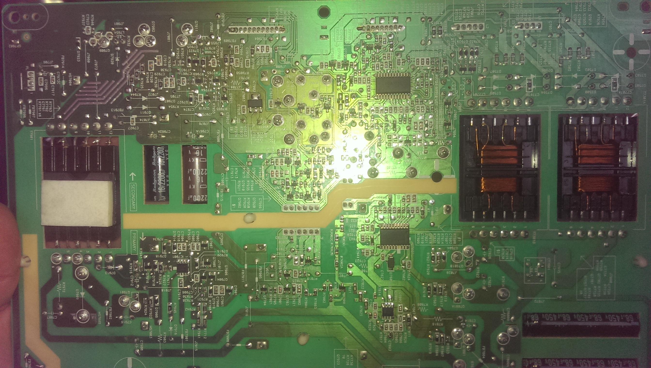

                            Here I found one picture of this board. Sadly its only part of bottom board.
                            I can try to make better pictures. If I won't be able to take good photos, I will borrow camera from my sister and provide better photos
                              Check the Connector PD pin 1& 2.
                              Where did you find that picture? Is there the picture of the whole board?

                                No I couldn't find whole board. Its Just from some polish site i found on google images. Here I uploaded some photos of board. I think they are better. But I couldn't find any tool to connect them together. Do you think it will help and dou you will be able to read that? If not I can try to do that in paint maybe
