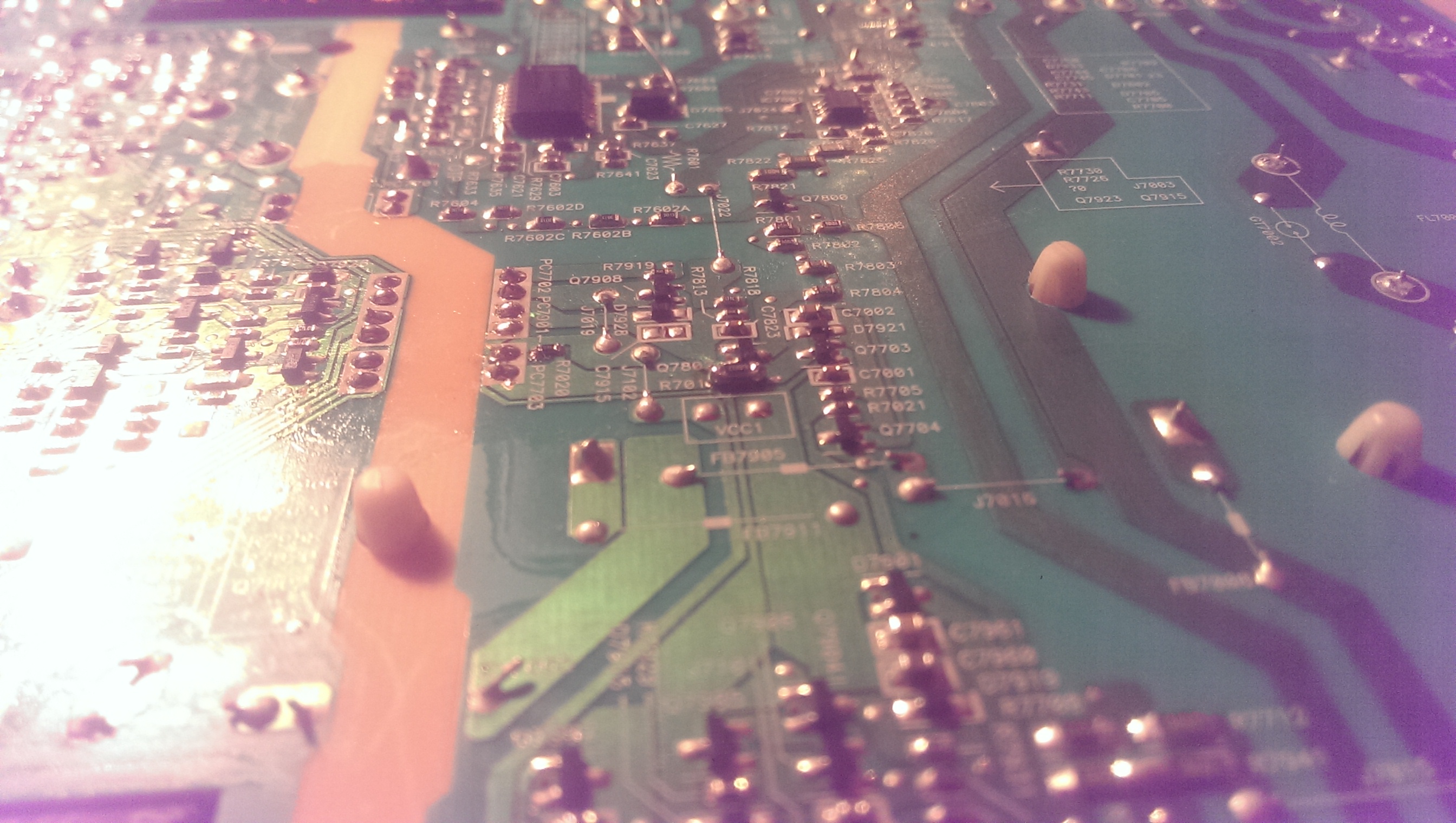

    "Tried that magic trick with resistor again, but this time tv didn't turned on. Not even led. Just red led on mainboard. " I am a little bit confused here, the first time you did not use any resistor between the AC-DET wire ("I took out pin 9 - AC-DET an just plugged it next to pin 11 - 5v. Without any soldering") and the STBY5V, you had it connected directly without the resistor, and now you are using the 330~1K resistor between the 5V and the AC-DET but the TV will not work this time, is that correct?
    BTW, what is the P/N of that opto for the AC-DET?
    What DCV do you get between pin 1 and pin 2 (the LED side), and between pin 3 and pin 4 (the photo-transistor side)? Notes: The measurement is for between the legs, not with ref to the circuit GND.

      Sorry I confused you. First time that trick was working I used 570ohm resistor. I just plugged resistor next to pin 11 and other end of resistor to pin 9. I never tried that without resistor. Just after opto change that resistor trick didn't worked again. Same as I put original optos back.
      That voltages from pin 3 and 4 I got to GND. Voltage of PC7703 between pin 1 and 2 is 0,99V and between 3 and 4 is 2,56V (this voltage goes to 0,08v after tv starts to show error code)

        These are original. I measured pins between 1 - 2 and 3 - 4 like in this photo. Is it correct? I found pin numbers like that on google.

          Is that after you added the 68K?. You didnt say. At 2.5v on pin 3 of PC7703, you might see some voltage on the AC-DET but the TV will not start unless AC-DET is solid high level, no pulses.

            If pin 3 doesnt go over 3 volts after the 68k is added, then replace PC7703. BTW opto couplers dont like being heated for too long.

              I just added 68k resistor. I forgot to take a photo. Now between 3 and 4 opto leg I am getting 3,06V
              Tv didn't started. On AC-DET pin 9 I am still not getting any voltage.

                  So you now have 2v on pin 3 to ground? same as before? It should have made a large difference.
                  Where did you put the 68k? Look at post 279, https://www.badcaps.net/forum/showth...AC-DET&page=14
                    #69
                    Re: Sharp aquos LC-40LE810E
                    I put it on R7019
                    In that post he is saying R2019 but its typo. If you check photo he really soldered it to R7019
                    Please check that photo I added in post 63, if I am measuring in correct way.
                    Leg 3 of PC7703 with 68k resistor soldered on top of existing resistor according my photo to gnd I got 1.68v

                              Omg.... I am tired and retarded..... I really soldered that resistor on top of.wrong resistor. f-ck, sorry for your time.... Going to fix that....

                                  Any, even we are not getting the correct AC-DET signal regardless, you still should be able to fool the main board using the resistor to pull AC-DET high, you did pull the AC-DET wire off the PD female connector when you use the resistor the second time but the TV will still not start, right?

                                      This time I soldered 68k resistor on right place.... Put everything back. Tv is working. Now it's time for measuring. Tell me what do you want to measure. Is this resistor final fix? Or should I buy something?

                                        Photos of 68k resistor fix
                                        Also found out, that that red led (D3301) on mainboard is still flashing while tv is on.

                                          So what DCV measured between pin 3 and pin 4 now (do not use GN for ref point)? You still should have about 1VDC between pin 1 and pin 2.
