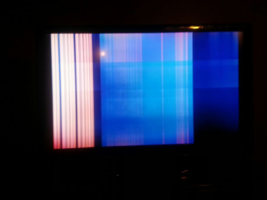

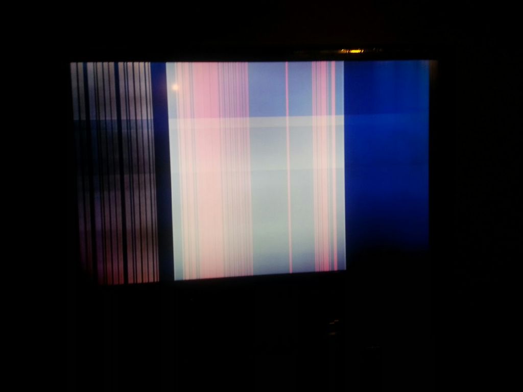

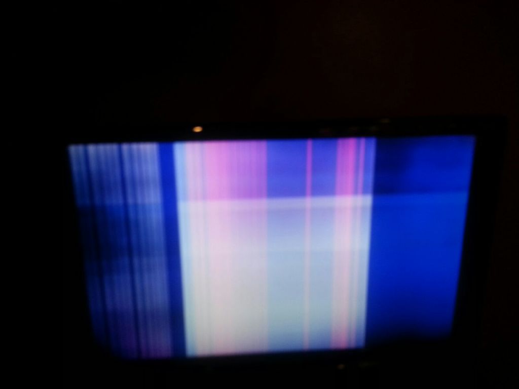

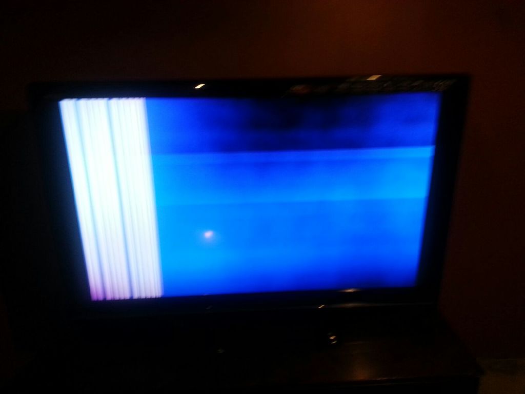

My friends TV was damaged during a recent move. The movers must have dropped it or something. This is what his picture looks like on his LCD TV. Is this a damaged panel or something else. The moving company will replace his tv if it is the LCD panel.
Bad panel or t-con
Re: Bad panel or t-con
Did you try flexing the screen yet?Never stop learning
http://www.badcaps.net/forum/showthread.php?t=24809 -
Looks like a panel tab bond issue to me.Please Do Not PM My Page Asking For Help Badcaps Is The Place For Advise, Page Linked For Business Reasons Only. Anyone Doing So Will Be Banned Instantly !
