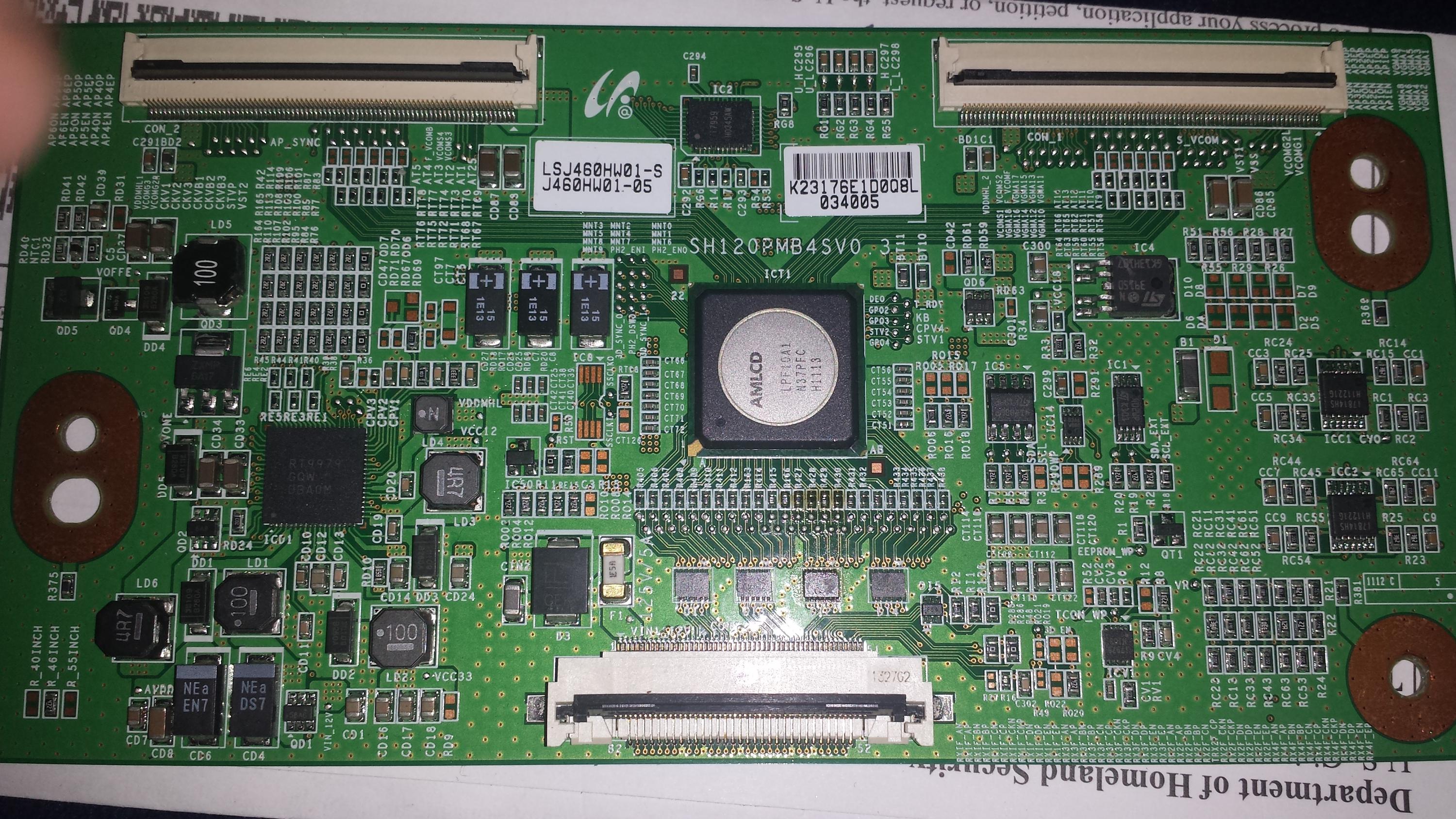

    SAMSUNG UN46D6420UFXZA bad t-con
    i have narrowed down the problem to a bad tcon though i dont see any physical damage on the board it self(not sure if its really fried or not). what id like to know is where can i buy a replacement board? it has to be in the lower 48 states and it cant exceed $65 with shipping.

                Re: SAMSUNG UN46D6420UFXZA bad t-con
                The SMD fuse is on the T-CON board, it will be closed to the LVDS cable, please up load the pictures of the T-CON we can show you where the fuse is.
                  here is the pic of the tcon, il try the 1 ribbon at a time when i get home
                    The fuse is the white rectangle with the gold ends above the bottom conector. You should read the same voltage to chassis ground at both ends, If there isn't any voltage it's either a bad mainbord or the cable.

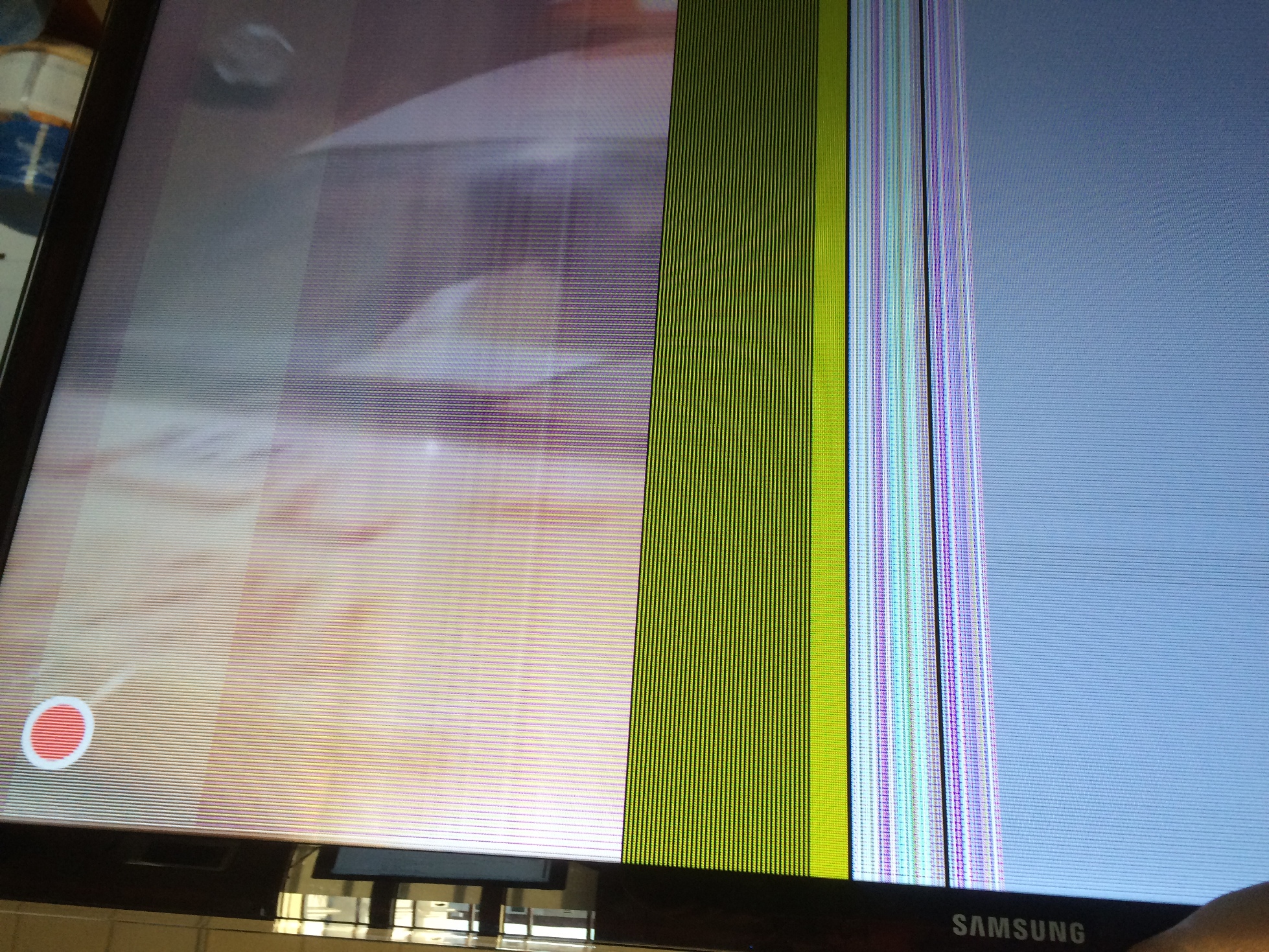

                                Hello guys.
                                I'm having the same problem. I try to remove one of the two ribbon cable between the tcnon and the panel. With a right cable removed the tv doesn't power on, but with the left cable remove I Can see a part of picture as in the pic. I still don't know if the problem is the tcon or the panel...
                                  For the heck of it check for shorted capacitors across the top panel boards

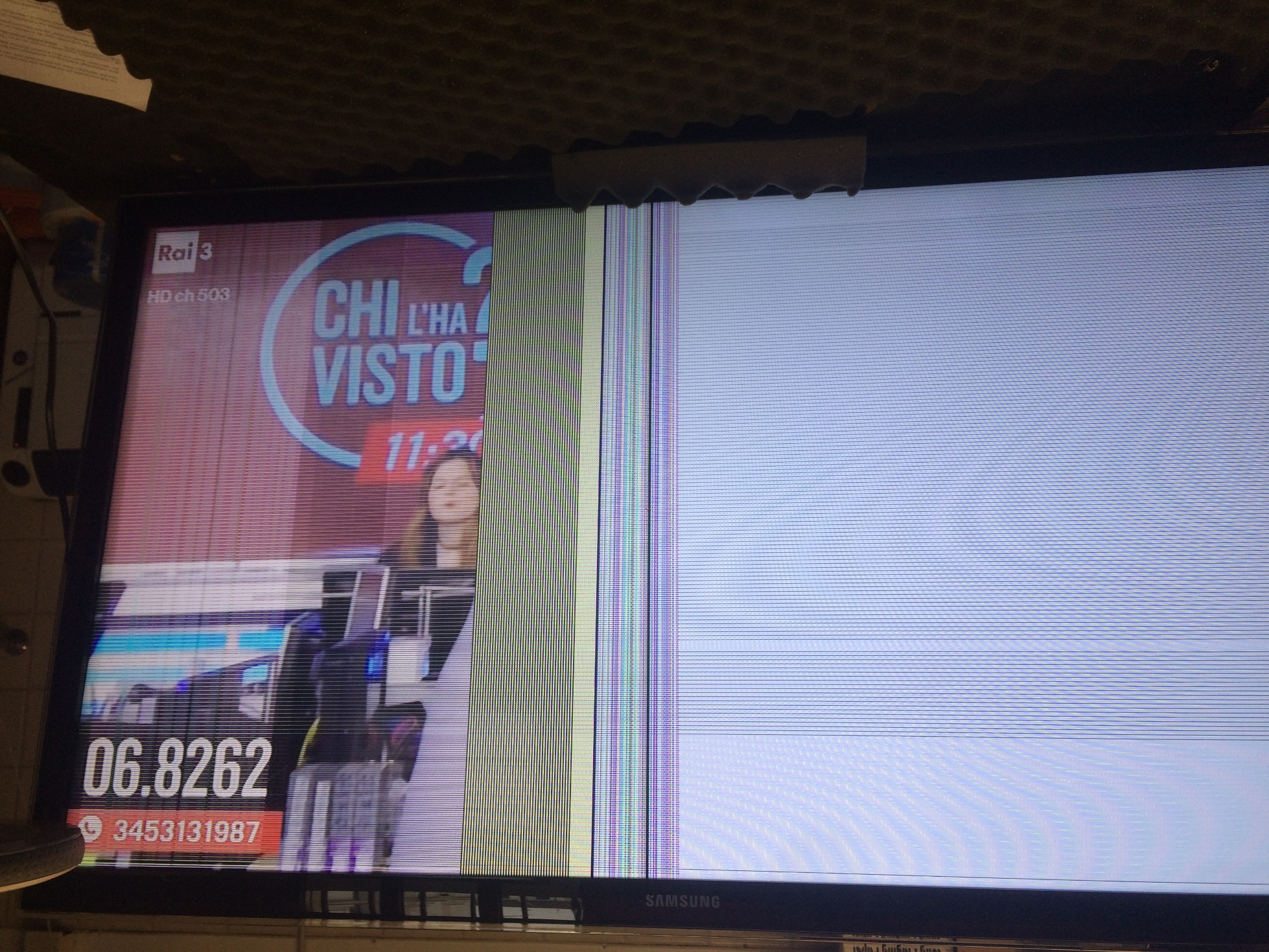

                                    Can't you show all the screen??
                                      How you can see, the are some lines on the picture.
