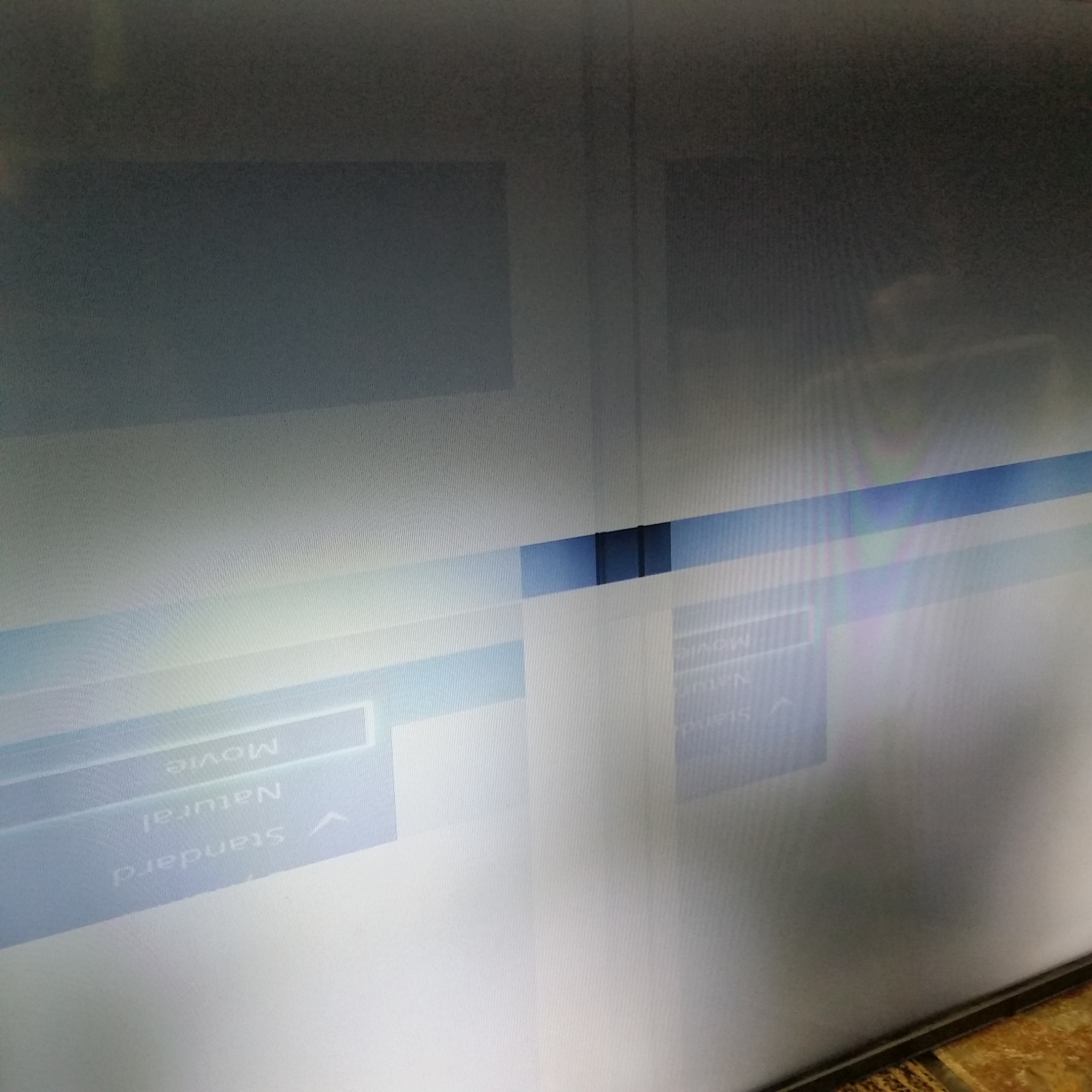

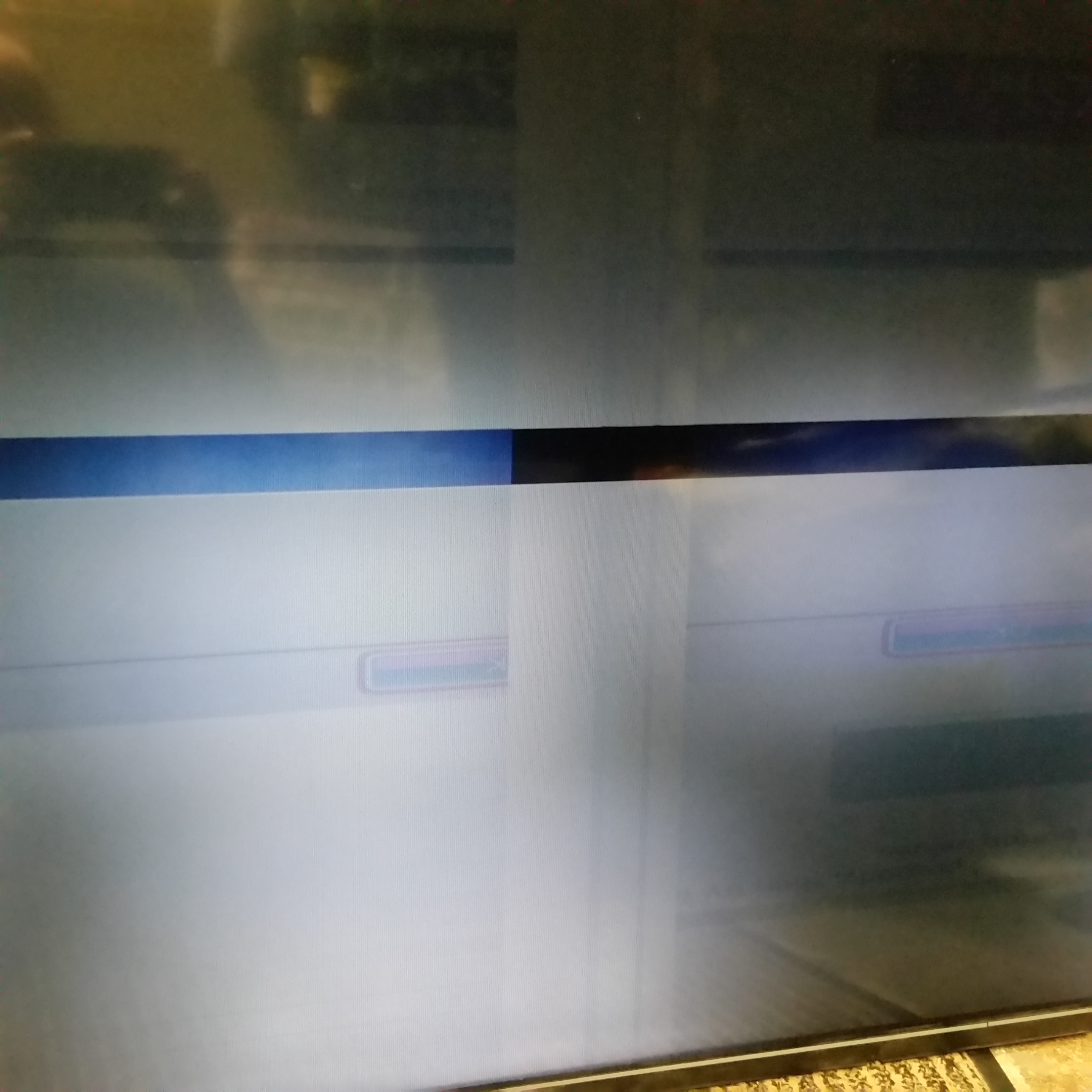

    Can't you show all the screen??
    No, I can see only less than half picture, but that check has been done with one of two tcon ribbon cable unplugged. If I put both the tcon ribbon cable the tv doesen't light on. The photo uploaded has been taken with the right tcon ribbon cable unplugged.

      its has good probability that someone washed the screen and let liquid get down into the front panel. Check the edge boards on the bottom of the panel for water marks / contamination.

        Hi all.....I know this is old thread, but I have replaced T-Con board, and disconnected one ribbon to panel, and get one half picture. From what I read its a bad panel. Does panel mean the circuit board that the ribbon from T-Con board attaches? I guess that board attaches to panel by lamination? So the entire panel has to be replaced. Is there anything else I can do before giving up on set? Thanks AL

                  I should mention... with both ribbons connected there is a horizontal line about 2 inches wide across bottom of screen. I could barely see menu when pressed, but it is there very blurry. If this makes difference? AL

                    Can we see the screen shot of what you are seeing on the screen?
                    Is/are the long board at the bottom edge of the LCD panel or on the top edge of the LCD panel?

                      The long boards are on bottom of set...I will send pic

                        I guess its a bad panel...and time to e-bay boards. AL

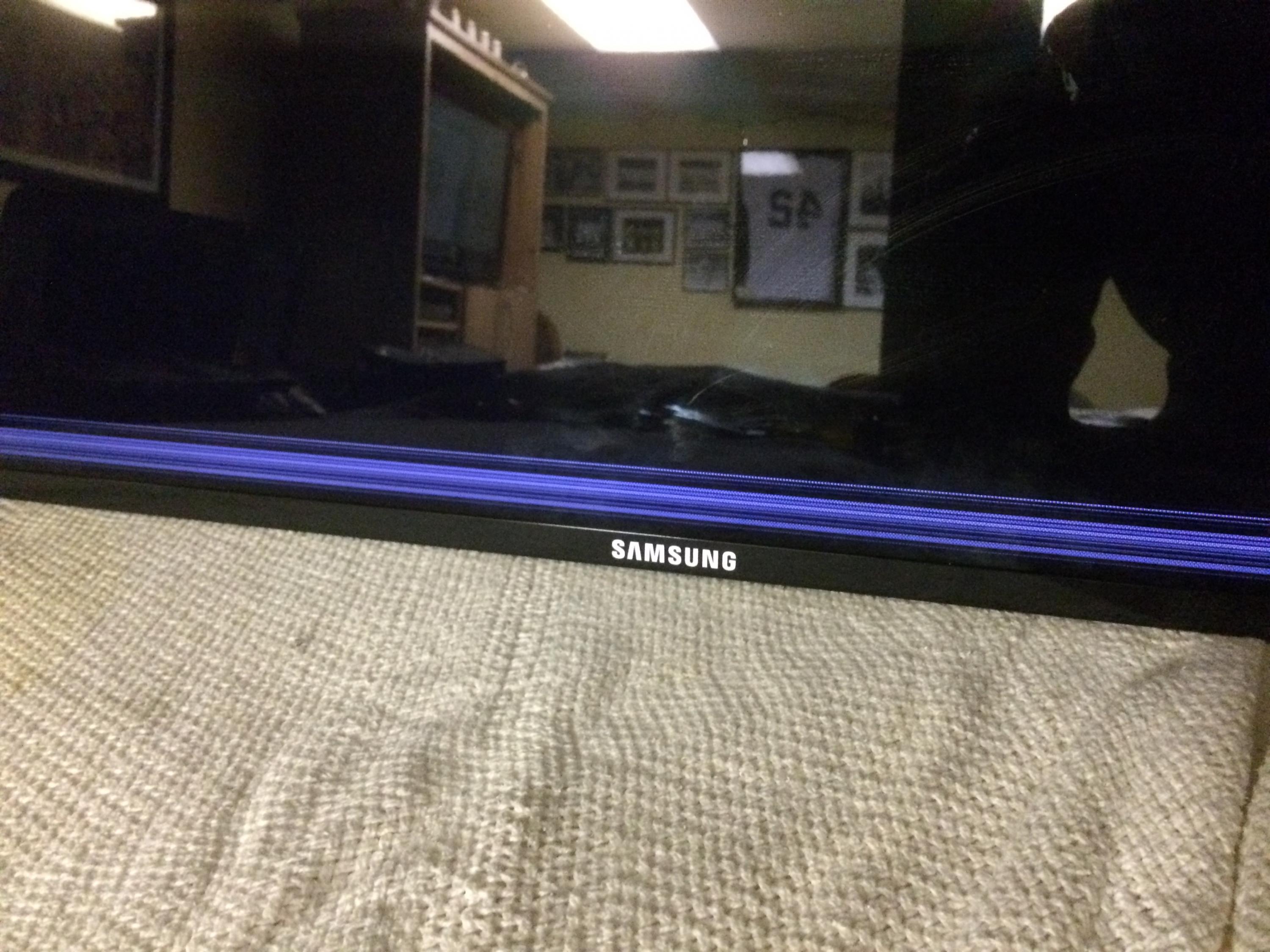

                          Hi I have a similar problem with a un65h6203b it has a white spot 3-4in wide top to bottom. Does that mean the screen is bad? The ribbon that feeds that area of the screen is very hot.

                            More pictures

                              Not good to show only part of the screen, neither a wizard can judge..
