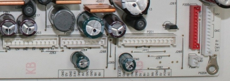

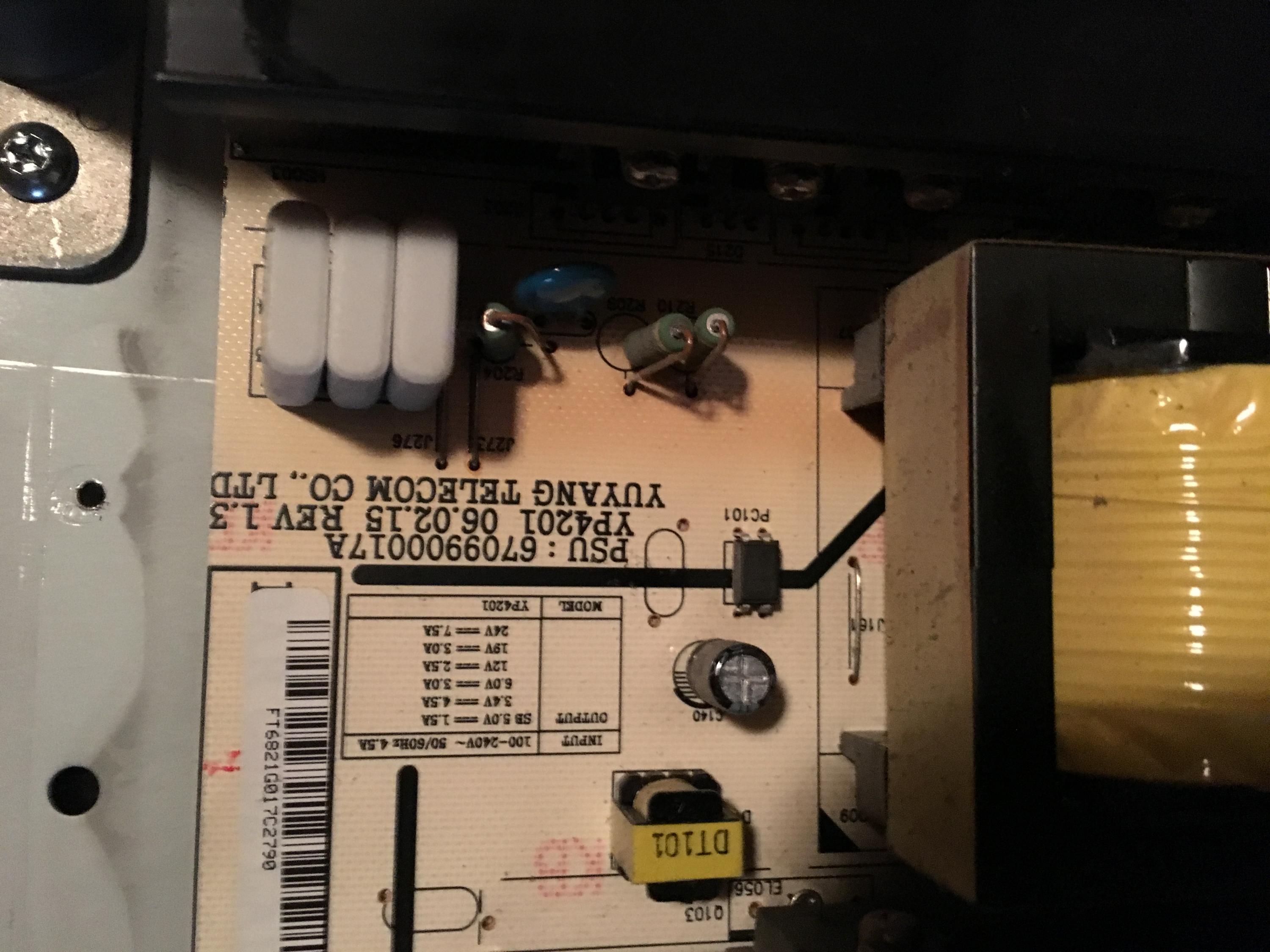

    Does anyone have the schematic for PSU: 6709900017A (YP4201 06.02.15 Rev. 1.3)?
    I replaced 4 10V 2200MF capacitors, and now when plugged in, it clicks once while illuminating the green LED on the front of the TV, then immediately clicking again, turning the LED off. I then have to leave the TV unplugged for at least 5-10 mins before I plug it in, in order for it to do it again. If I plug it back in right away, nothing happens...no green LED, no click.
    While plugged in, I get the following readings...
    At P201
    • AC pin = 2.25v
    • POW pin = .01v
    • 5V pin = 5v
    • ERR pin = 4.98v
    • 5V pin = 5v
    • DIM pin = 4.98v
    • 6V pin = .01v
    • 3.4 O/F pin = 0.14v
    At P202
    • 19V pin = 19.28v (and drops at rate of 0.01v/sec)
    • 19V pin = 19.24v (and drops at rate of 0.01v/sec)
    • 6V pin = 0v
    • 3.4V pin = 0v
    • 12V pin = .37v (and drops at a rate of 0.02v/sec)
    I'm assuming that I'm not a candidate for the AC Detect optocoupler fix since I see the 5v?

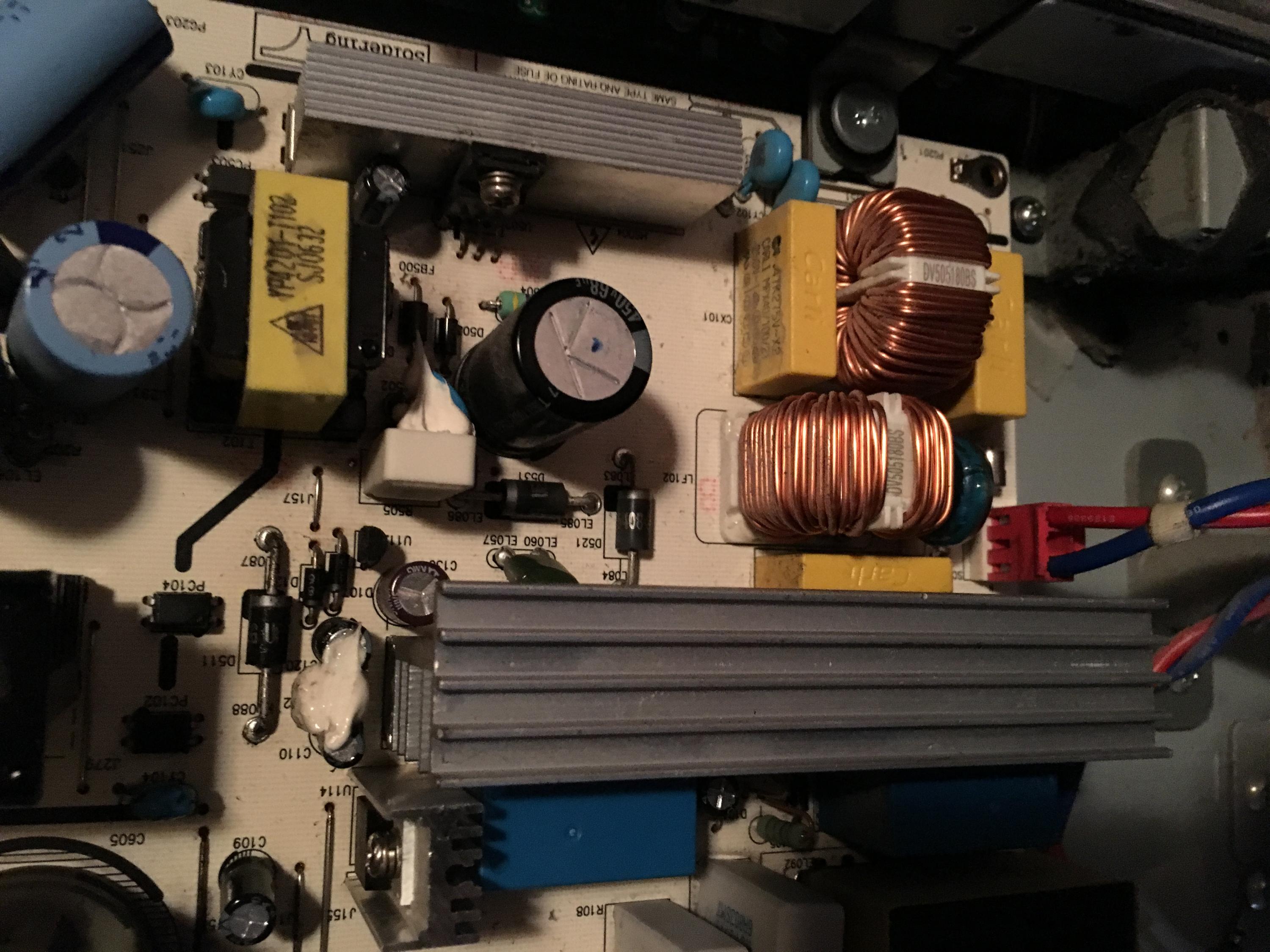

            Re: LG 42LC2D Power Supply Issue
            I had a similar issue. A number of the p/s caps were "pregnant." I replaced them with higher voltage values, and the TV has worked fine for years. But, it started acting up again. A couple of clicks after power up, and then nothing. None of the caps look bad.
            Now, I do not have the STBY 5 volts present. There was mention of the AC optocoupler issue and the (lack) of 5 volts. I cannot find that issue mentioned anywhere else. Nor can I find a schematic for the p/s.
            Could someone enlighten me on the issue? I see there are at least four (4) optocouplers. But, I cannot make out the part numbers very well.
            Thanks!
            Rather frsutrating!

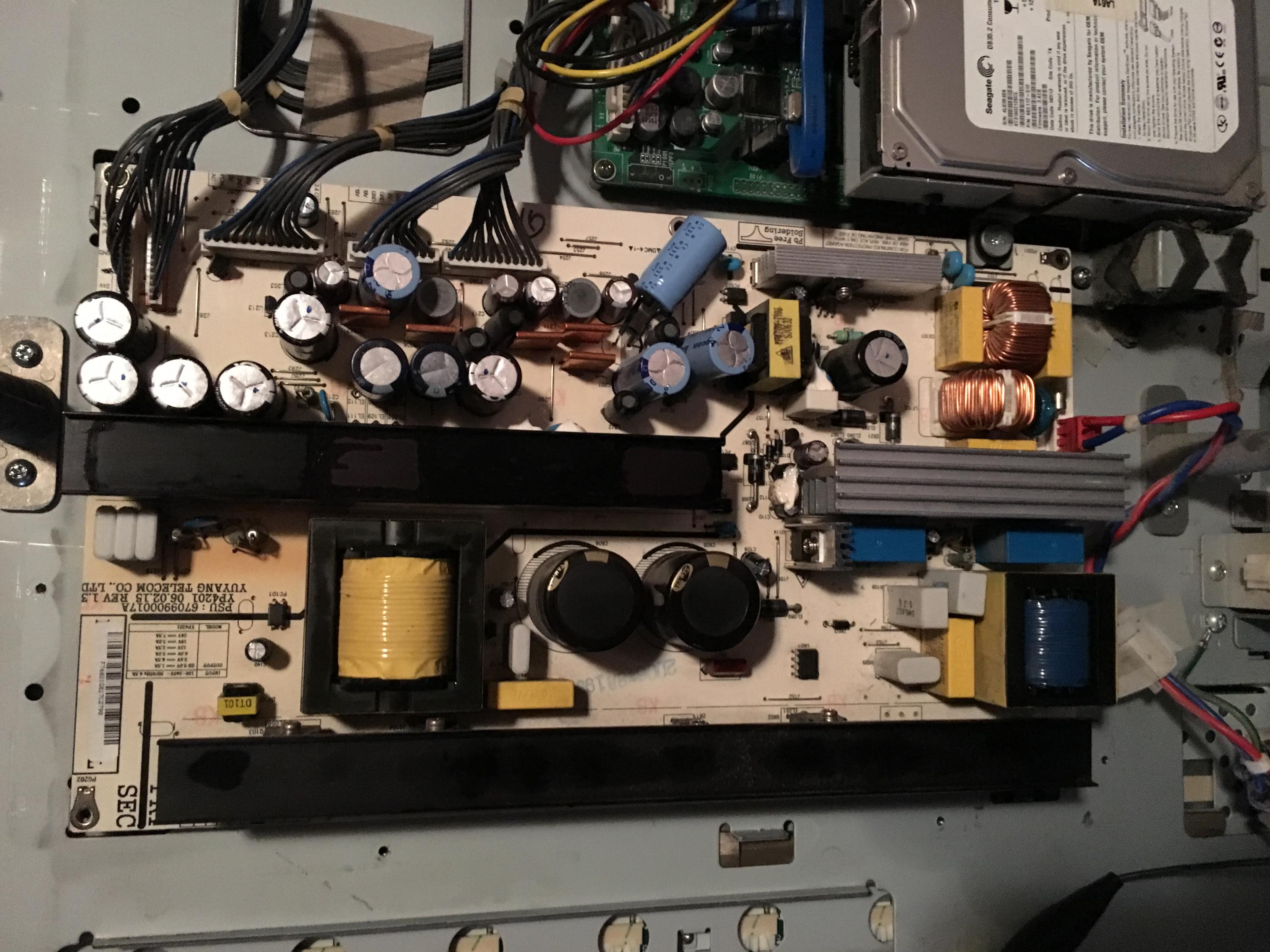

              Lets see good clear straight shot pictures of the whole top and bottom side of YOUR power supply board.
                Sorry about that. Same P/S, but for a LG 42LB1DRA.
                No 5 V with AC power. But, when first applying AC power, there is 5 V on P201 but for just a split second. Nothing afterwards.
                Thanks.
                    That I didn't as yet try. But I can do that.
                    • NJ1Q
                      • Sep 2019
                      • 4
                      I disconnected all the connections from the power supply board. Oddly enough, the only voltage present when AC power is supplied is the 5 V. There are no other voltages present.
                        I have this LG TV. The PSU is fine, but because HDMI port is not functional, I want to use another universal motherboard for this TV, using this PSU for display lamps. Can somebody tell me what pins I need to connect to power On this PSU ?
                        The PSU have this pins on connector P201:
                        1. AC
                        2. POW
                        3. 5V
                        4. GND
                        5. INV
                        6. ERR
                        7. Bri
                        8. 5V
                        9. GND
                        10. DIM
                        11. 6V
                        12. GND
                        13. 3.4 O/F
                        Thankyou!
