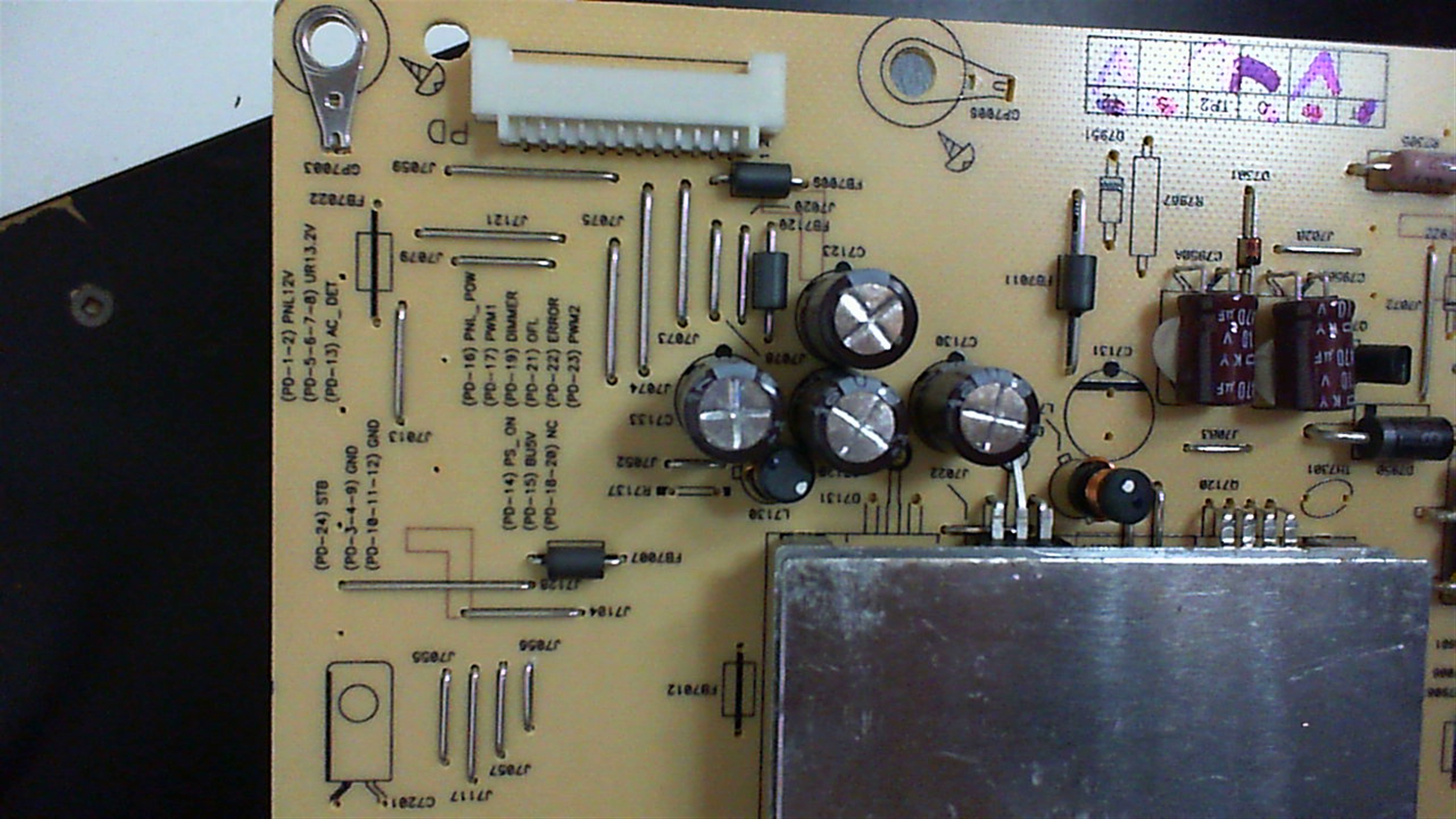

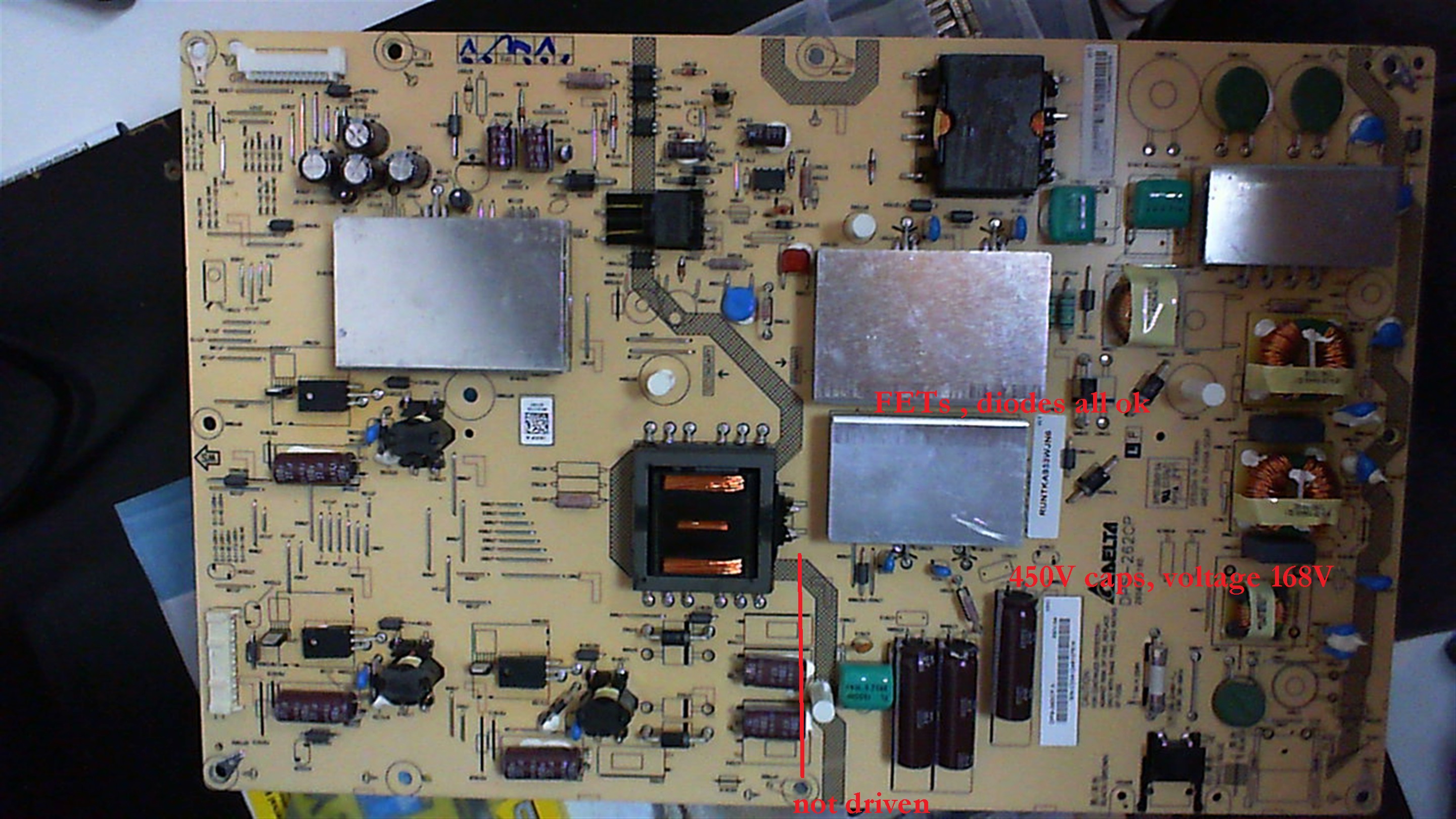

    It doesn't turn on. Front LED flashes long then short indicating an LED or inverter failure according to SM.
    Primary main voltage stays at 170V, no boost. LED transformer is not driven. How the mainboard knows there is a inverter fault if it doesn't even try to drive it I don't know...yet.
    Board is RUNTKA933WJN6.
    I have 5V nothing else...

    The PFC can be made working (goes up to 405V) by shorting PS_ON to BU5V on connector PD.
    Unfortunately there are som many signals it's hard to say which one would control the LEDs. There are DIMMER, PWM1, PWM2, PNL12V, OFL, PNL_POW.

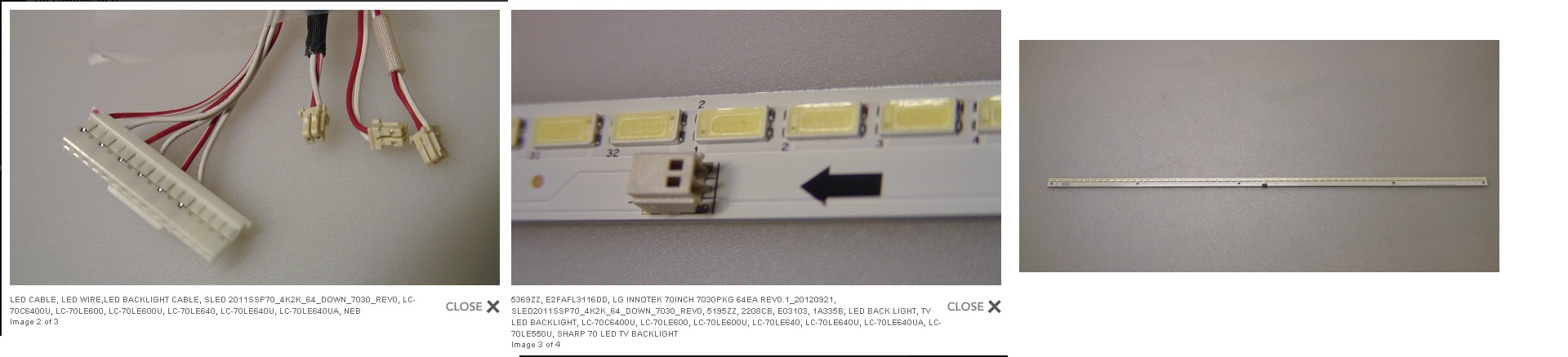

          How do I test those backlights? Just applying a high enough voltage (with current limit)?
          There are three sections. How much voltage would I possibly need? The two main secondary voltage caps have a rating of 200V and the other 3 electrolytic caps a rating of 350V...

                      Re: Arquos 70LE640u dead
                      The LED strings being sold have 64 LEDs on them , possibly 2x32 in parallel. There are 3 connectors on the wire harness, and there seems to be only one connector on each LED string.
                      Assuming they use really 3 LED strings, what configuration would that be? Two on top, one in the middle? One on the side? Weird.
                        Well each two wire pair will be approx 3.5V x 32 LEDs = 112V DC
                        You can start with a low current limit, and ramp up. Remember LEDs are current driven devices, not voltage driven. So always use a current limiting power supply, or a current limit resistor in series.
                        I wouldn't exceed 50mA total.
                        Not sure on the layout, that is odd. Possibly left & right strips, and one top strip? Weird...

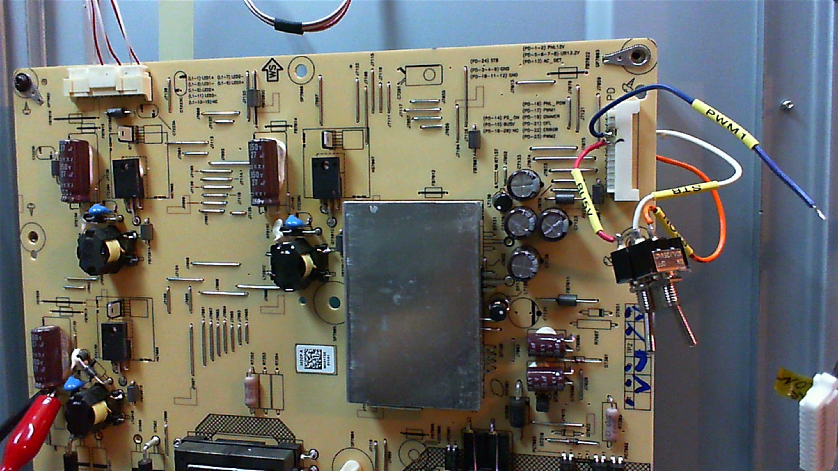

                          Even at 127V there is no current at all through them. Maybe they are all in series...
                          EDIT:
                          When forcing the LED driver chips ON the voltage established at the caps ranges from 194 to 184V AND the backlight turns on.
                          Needed is only :
                          Shorting PS_ON to BU5v
                          Shorting STB to BU5V
                          then
                          Shorting PWM1 to BU5V.
                          PWM2 and DIMMER are not used.
                          Still unclear how to clear the counter in the mainboard without having access to the service menu.....

                                Now, did anyone ever succeed in opening such a huge panel and repairing the LED strips?
                                I think it maybe best to remove all the screws that hold the panel together then holding the parts together with tape, flip the whole thing around so it lies on the front and then I could lift up the inner metal plate that holds the LEDs...
                                Will need to try it.

                                    • paulstef
                                      • Dec 2013
                                      • 724
                                      I managed to open it without breaking the LCD. The backlight is 3 strips with 64 LEDs each all on the lower edge. Apparently it's 2x32 LEDs in parallel on each strip. One LED burnt, half of a strip is dead. Shorted the LED, it works again and voltage is lowered, i.e. current regulation of the driver chip seems to work.
