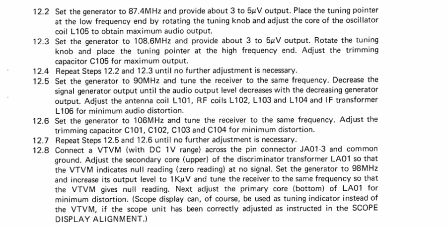

    I am not ashamed to say this is my first FM alignment I have ever done. I am well versed in electronics and repair. Been doing it for many years on Pro Audio Live sound equipment. Worked on Power amps EQ's musical gear and Large format Mixing Live consoles Etc. But now I can see this is a whole different world when it comes to tweaking this kind of gear. I do have the proper gear like the SENCORE SG 80 and HP Generators and Scopes Etc.
    Look below at Adjustment 12:8. The Null adjustment. I have a Heathkit IM-28 VTVM that was rebuilt and has new Burned in tubes that I used for this adjustment. It has a Center "0" Adjustment. The spec in 12:8 calls for "null reading (Zero Reading)at no signal On the DC 1 volt Range. So I grabbed pin #3 at the JA01 Board and it read up around 5.5 on the 1 volt scale from the Zero Mark on the left peg.
    I then turned the voltage down to "0" Volts or back to the left peg on the VTVM. What I am wondering is , should I have cranked the pointer on the VTVM up to to center "0", and then tried to "0" the pointer on the VTVM "0" center mark?
    I did the second part of the adjustment using the same left Zero mark. I understand the Term NULL... but to apply it here with this equipment and the way Marantz writes their Manuals is sometimes confusing. We all know that Marantz has made some errors' in their Manuals.
    So I'll leave it here and see what comes back. Click image for larger version
