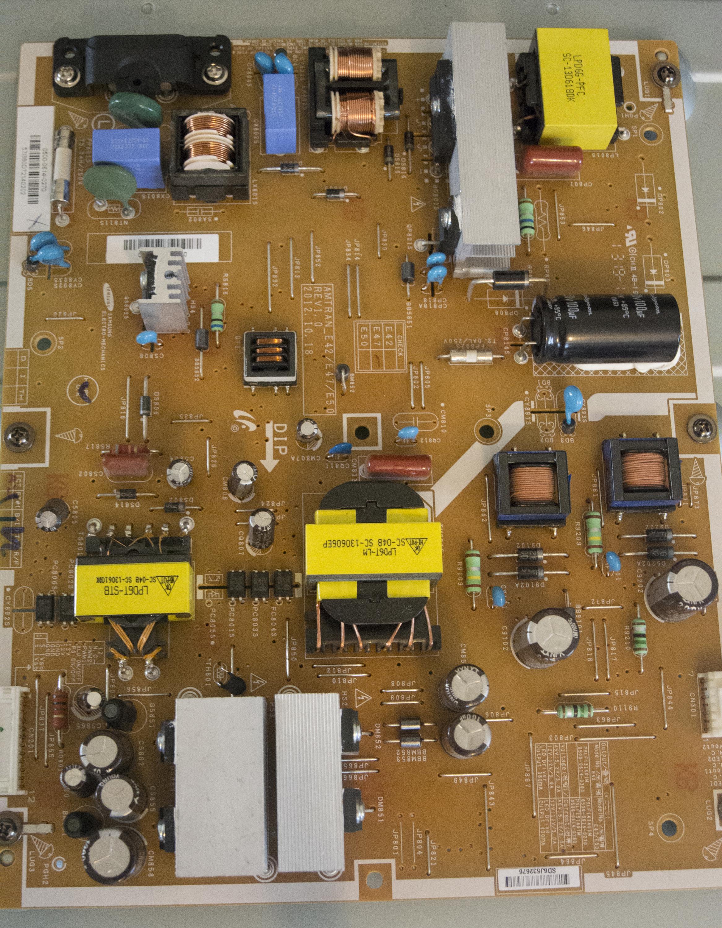

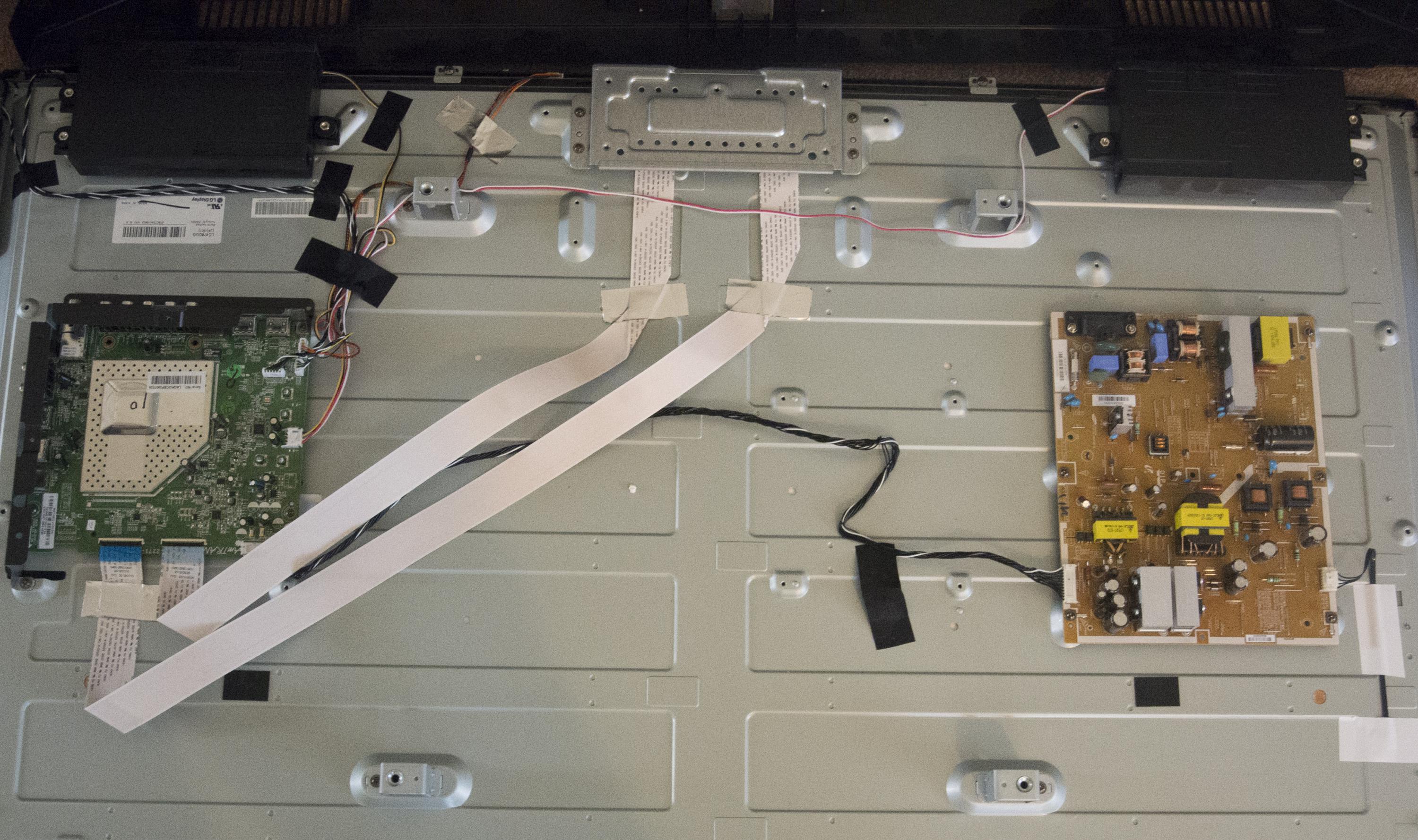

    Hi everyone,
    I've replaced the power supply board to no avail. Here's what it's doing...It sometimes will give a blue(standby?) light, but this light quickly fades to nothing(weird??!!). I've checked the pins on the connector...standby is at a bit over 5v, blu is 0(after the multimeter cycles down in numbers), and pwm1 and pwm2 are both at 0.96. The pson is also at 0 after cycling down. I haven't tried testing the main side yet, because I really don't know where to start. i've never tested diodes and bridges and whatever other thingys I keep hearing about, but I will give it a try. My multimeter doesn't give esr values, unfortunately, to start testing the caps. I didn't think caps would be the first priority?

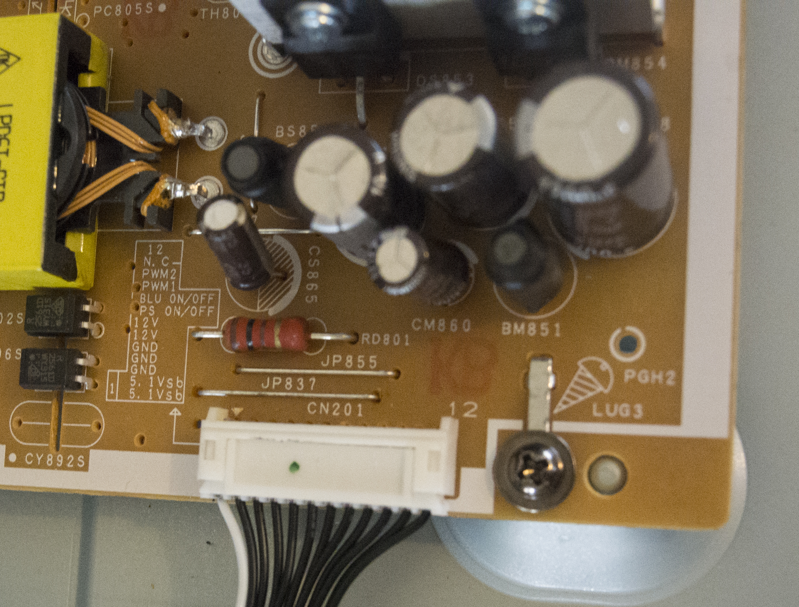

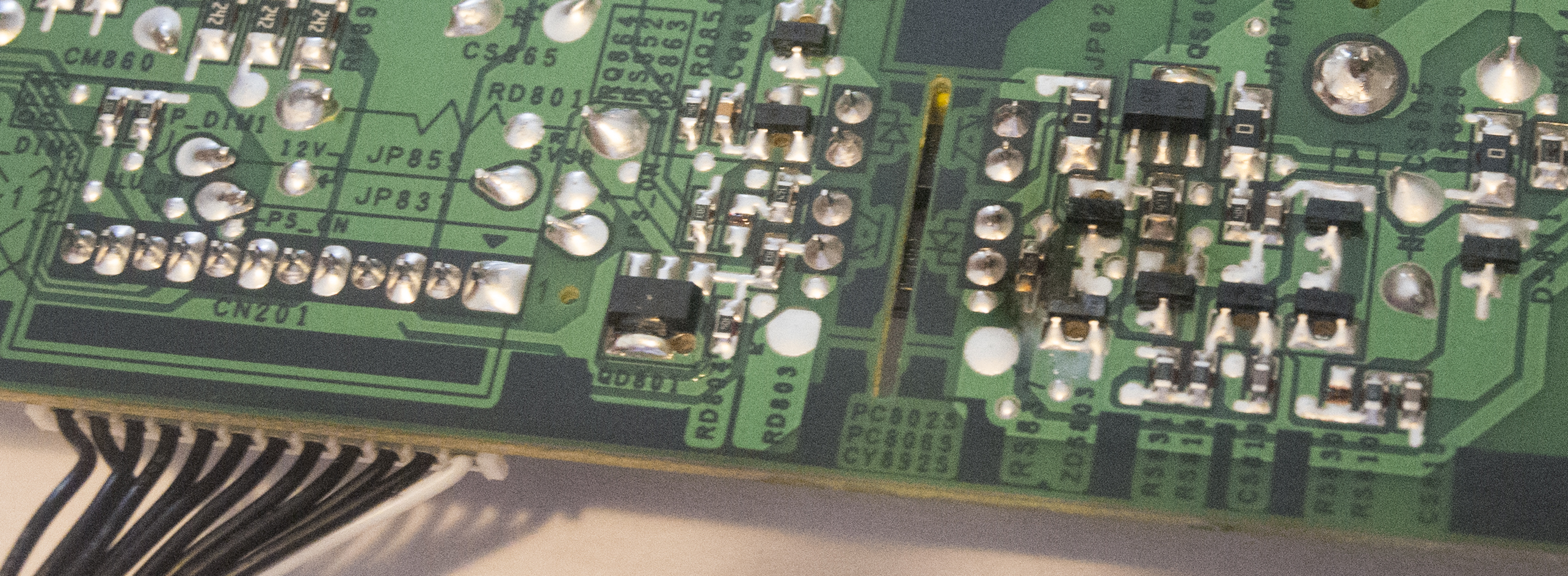

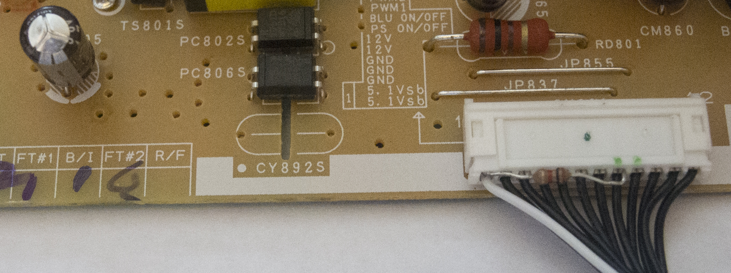

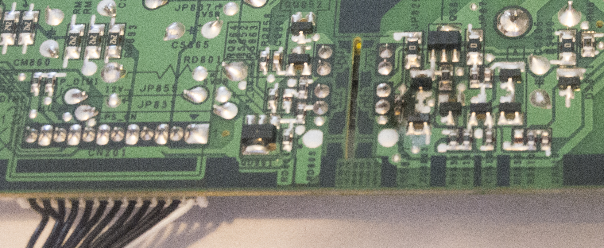

                                I got this started, but made a goof somehow, because a cap blew the second I touched the red probe to the 5vdc pin! I also found a blackened area nearby the cap, so I'm assuming I did some damage somewhere along the cap's trace? The cap is a 47uf 50v. That's the first time I've had this mishap, and it gave me a "come to Jesus" moment, as we say here in the South. Just to clarify, I was supposed to test dcv while the ps-on pin was jumpered over to the 5vdc, correct? I'm wondering if how I connected ac would have mattered? I used the tv's cord, which is only a 2-prong, but connected it using my 3-prong extension cord.

                                    Re: Vizio E470i no power
                                    Ok pics are very unfocused TBH.
                                    That's a SOT23 package transistor that's blown by the looks of it.
                                    Can you give us the part number off the PSU please as may need to find a schematic

                                      PN: 00500-0614-0270
